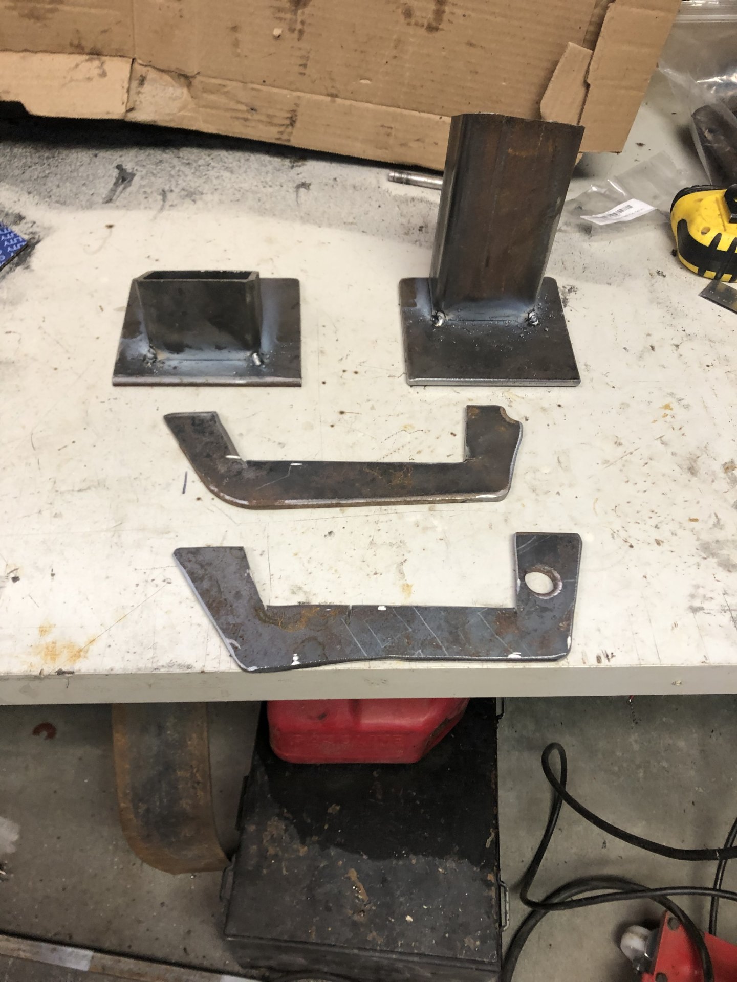

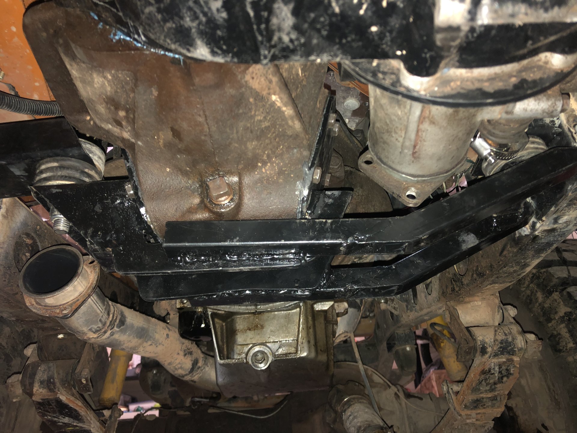

The crossmember was a pain in the arse when it came time to service the Tcase. Additionally, there’s the concerns of it weakening the case(coupled to a 5.3). So it was time to make something different and the Sm465 had these two pto plates. They are easily replicated in plate steel and that can be welded to a proper crossmember. Maybe that last part is a stretch as I made it from what I had laying around, but it’ll hold. I did reuse the AA rubber mounts at two frame ends.
There is probably room for improvement, but it’ll do until I feel like doing it again. The driver’s side needed to go above the exhaust and the passenger side had to go under the output and up to the frame mount.

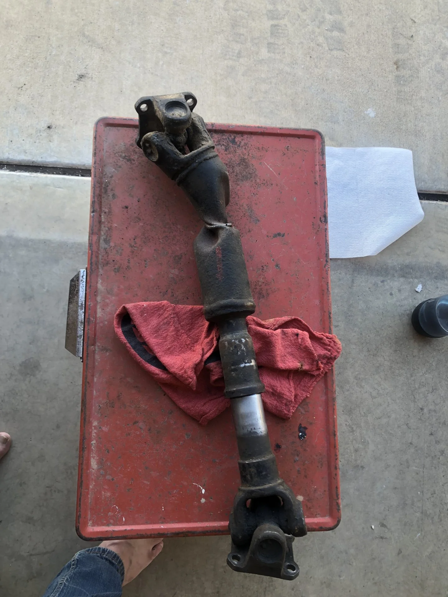

BANG. “Uh, could you look underneath while I hold the brake?” “Yep the rear driveshaft is hanging down hear.”
I gently roll off the slab and crawl under to access the situation- separated rear drive shaft. I can pull it off and reassemble and we’ll be on our way. Get the tools out, crawl under and look at the driveshaft- it’s a pretzel. Well this changes things. Oh and one more thing to fix later.
After hemming and hawing, we decide to continue on for a bit and circle back for my 40 on the way out. It’s now fwd, but operable.

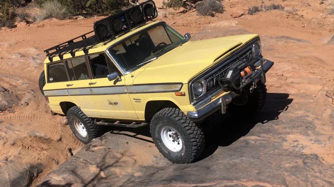

We continue in the LJ & SJ. The LJ is eating it up- I’m a bit jealous. Now the Wagoneer has a 360 and 35’s and I’ve been impressed at how well it’s doing. Until we hit some loose steps and from above we hear a whirring/grinding noise. No movement at all. After much fussing about, we realize this thing needs to be towed out- bum transfer case The LJ is the only one left to do the job. It took some rigging, but we made it out. Winches, tow straps and tree straps were used.

Next issue will be getting the driveshaft retubed. Sounds like stock was .060 wall and some people are going to .090. While I would like to have a stronger ds, I like the idea of it being the fusible link. What are peoples thoughts on bumping up to .090 wall tube?

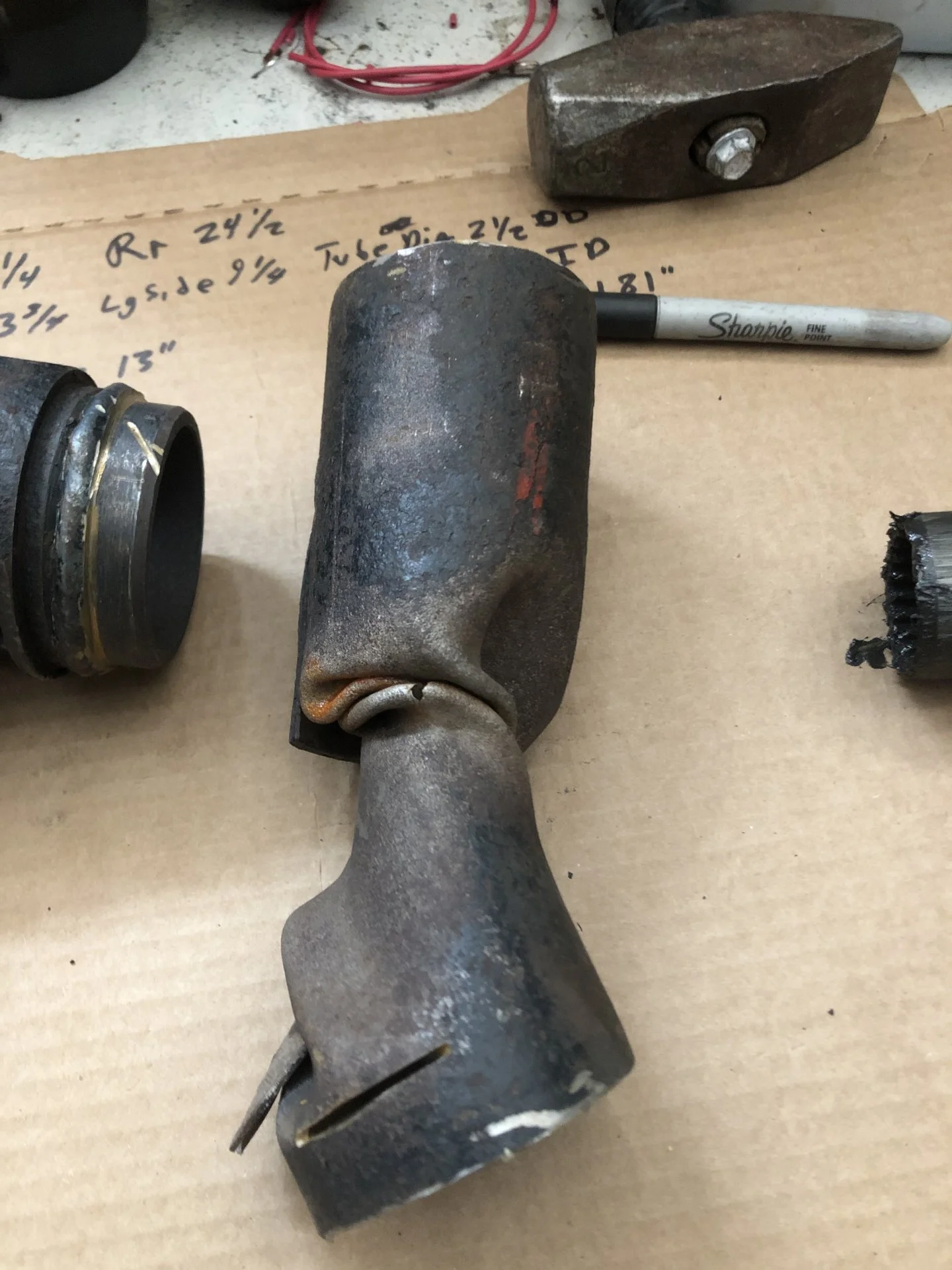

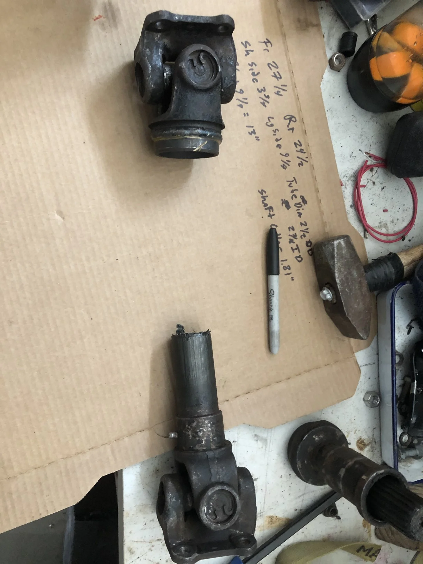

This leaves me with my old driveshaft ends
My current thought is to make a spare that’ll work for both the front and the rear. There is a ~3” difference between the front and rear ‘shafts.that’s more than the spline section will handle. This has me leaning toward a long travel square tube driveshaft that can be used front or rear.
I’m aware that it won’t be balanced and not recommended for high speed. On the up side, I’ll only need to carry one spare( and keep my foot out of the throttle).
This leads me to tubing choice; I still want it to be the “fusible link” in the drivetrain. But having never done this I’m unsure of what tubing to use.
The mating surface on the fixed end is ~2.6” and, if I eliminate the slip yoke, the small end is 1.81”. This leads me back to tube size. What size square tube is strong enough, but still weak enough to properly fail?

After I made that last post, I thought about how tight my driveshaft is to my oil pan. A square tube would potentially create more space issues. This led me to a quick investigation of a longer spline, but realistically that is more than I have to spend at the moment.
So I’ll drop off both shafts today and have them both made up for the rear. The stock tube measured out at ~.060. What do people replace that with? .090?

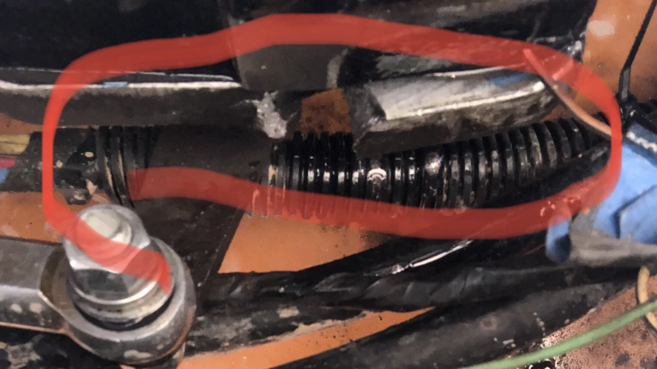

Pulled the transfer case today to fix the shift cover. Much easier with the AA propeller xmember gone, but still takes a minute. Once I get the case on the bench, I get a better look at the offending cover
Well good thing I bought a replacement from Valley Hybrids. Still mystified on how this happened….
They say a pic is worth a thousand words…
“So it took out the cover, it’s an easy fix. Wait a minute what’s that? F@#$K sticks”
So as much as I want to fire someone for this screw up, mine are the only fingerprints on the truck. So I screwed up again, good thing no one is paying me to do the work. I must have dropped a bolt in when I was fixing the popping out of gear issue( that does seem better). It looks like it pushed the corner of the cover out and then fragged the low range idler gear. Yeah!?!?!?
The other gears seem good and the assembly seems to spin with out any hesitation or binding. I don’t have a lot of miles on the gear set, think AA will set just idler gear set?

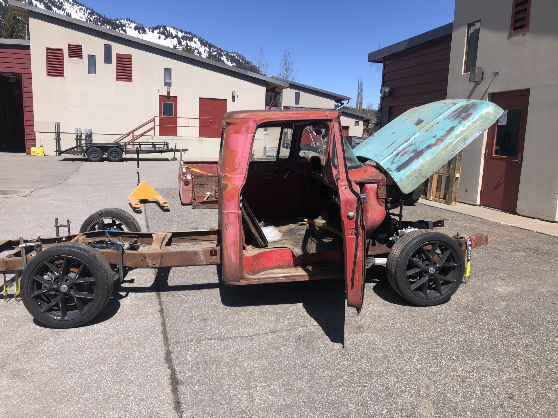

In unrelated news I broke the my f100 down last weekend. I slid the new suspension u set to get an idea of how it will sit. More distraction…

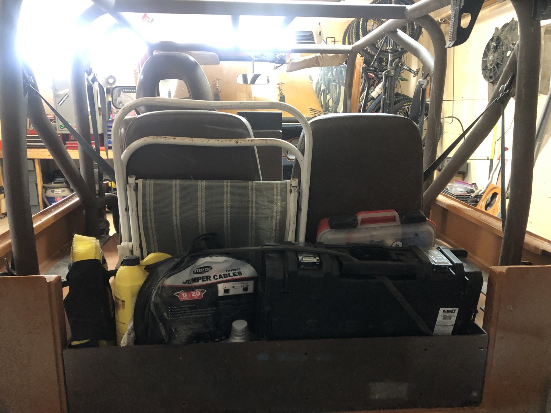

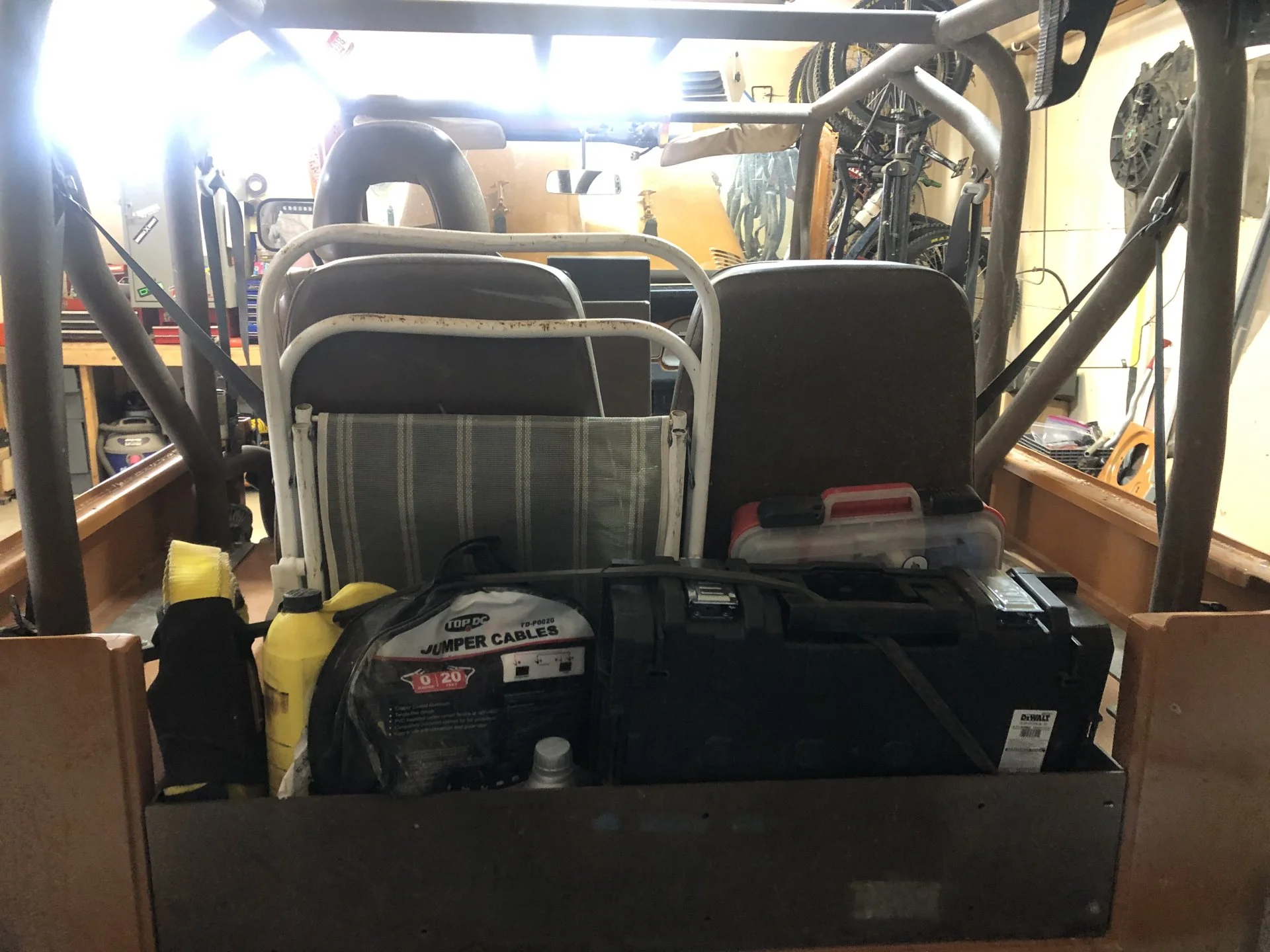

Next step was repack the trunk. Managed to to stash the spare drive shaft under the tow strap and coolan.

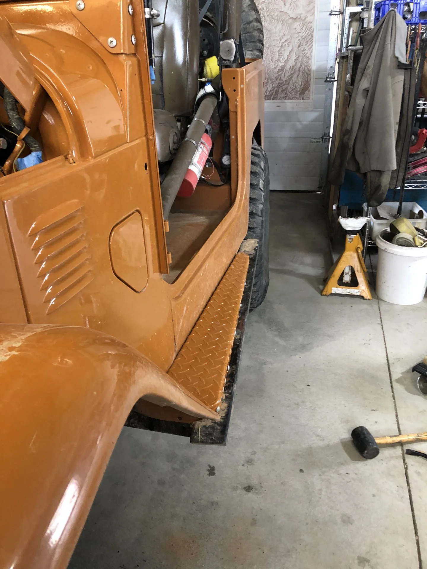

Last step was install the steps. Like I said sometimes they are small wins

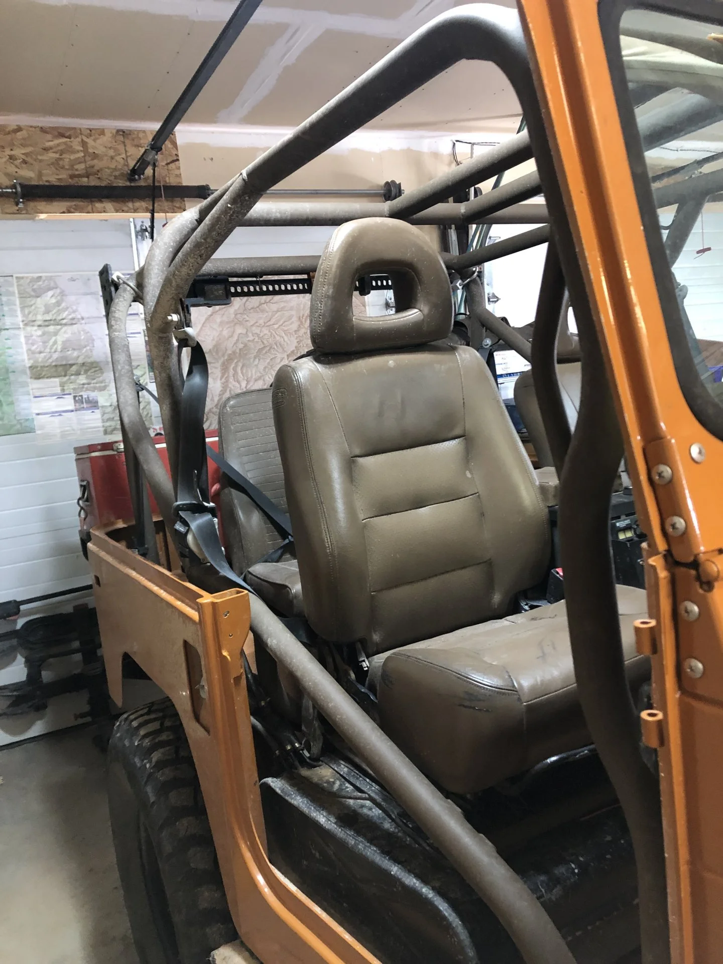

  1. Fixed the wiring for the drivers seat. Now wife can almost reach the pedals again. Seat heaters would be nice- I need to hook those up some day…

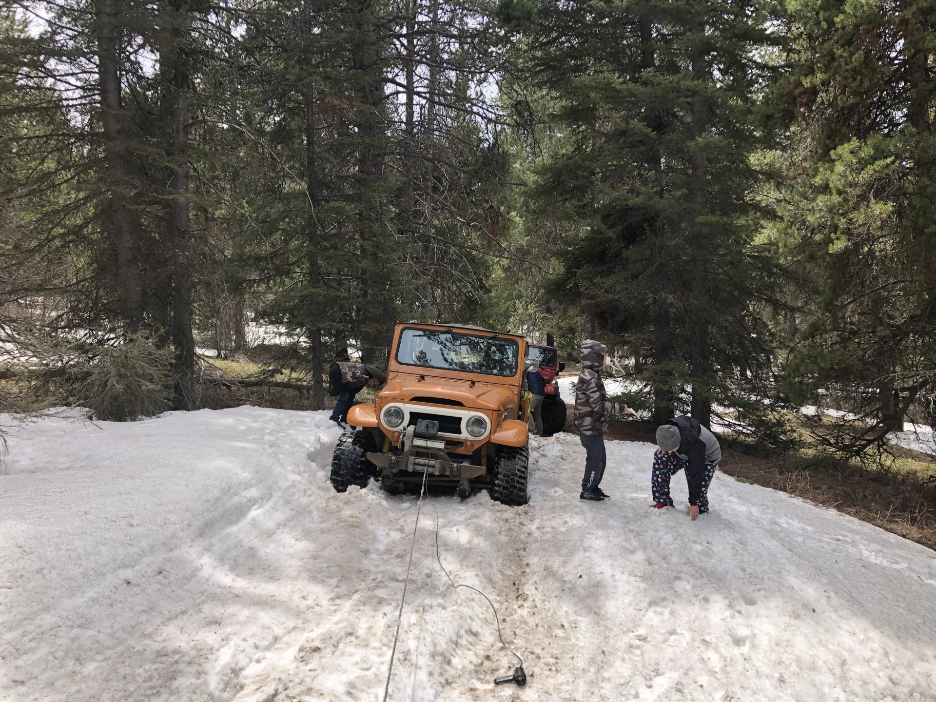

Took the monkeys out for a little trail ride. Had some fun with snow and winches.
Snow was to deep for the Jeep to pull me backwards, but the 8274 had no problem pulling to dry ground forwards. By then I had a nice track to come back on. Good times we’re had by all.
