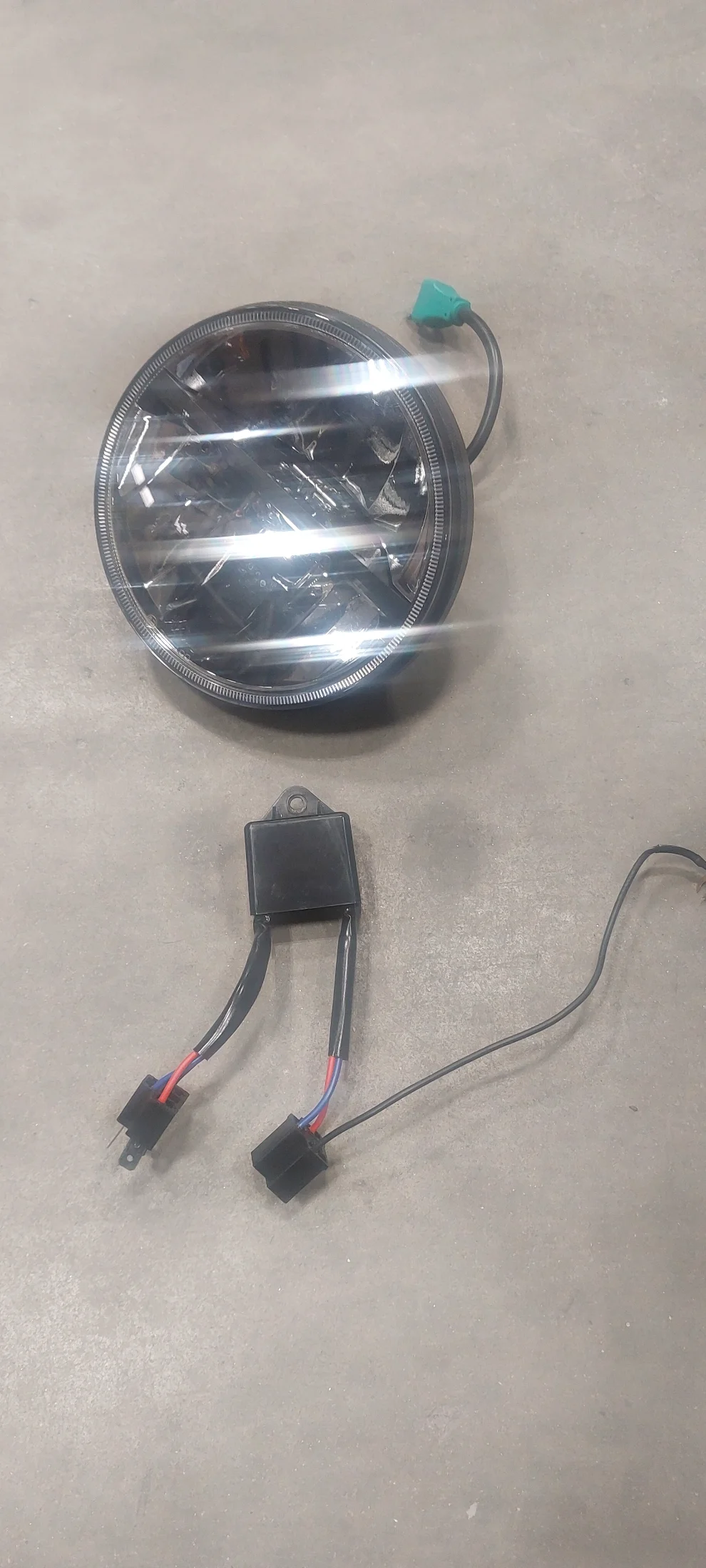

could they have been for previous LED lights?
Yeah I don't know, clearly they were hooked up at some point then they got disconnected and wires cut and spliced back together. Did you buy these headlights or is that something to other shop provided?could they have been for previous LED lights?

Looks like a ground switching module. Needed when some LED lights are installedAnybody recognize this little black box with the two three prong headlight plugs coming out of it?
Disregard all of the patch together broken wiring around it, that all get cut out and replaced but I need to figure out if I need those little black boxes, I have one on each side and neither appears to be attached to anything.
Thank you, I assumed it's a "anti-flicker" thing for LED's and might be needed for these installed lights but they were having some sort of issue and disconnected them at some point. I will look into ground switching module's also and see if we can solve this mystery box.Looks like a ground switching module. Needed when some LED lights are installed
Looks like the mystery box has been identified.Looks like a ground switching module. Needed when some LED lights are installed
I have spare Toyota light upgrade purchased couple months ago, I’m happy to share if Don wants em. Don’t need 3 sets. Purchased through dealership.Looks like the mystery box has been identified.

Question is do I need to hook it all back up?
I was hoping the shop used a name brand headlight, But I'm not that lucky and this looks like it could be one of the many knock off lights sold across the internet and has no markings identifying it.
Thank you, these look like quality lights. I was hoping they were Truck Lights or some other "name brand" and I could jump on their sight and look up the requirements and confirm we are good on the current wiring.I have spare Toyota light upgrade purchased couple months ago,
I couldn’t say for sure, but that’s what I remember the Cityracer LED lights looking like. Are they just a bit proud when installed?Looks like the mystery box has been identified.
They look just like mine from CityRacer, they plugged right in.I was hoping the shop used a name brand headlight, But I'm not that lucky and this looks like it could be one of the many knock off lights sold across the internet and has no markings identifying it.

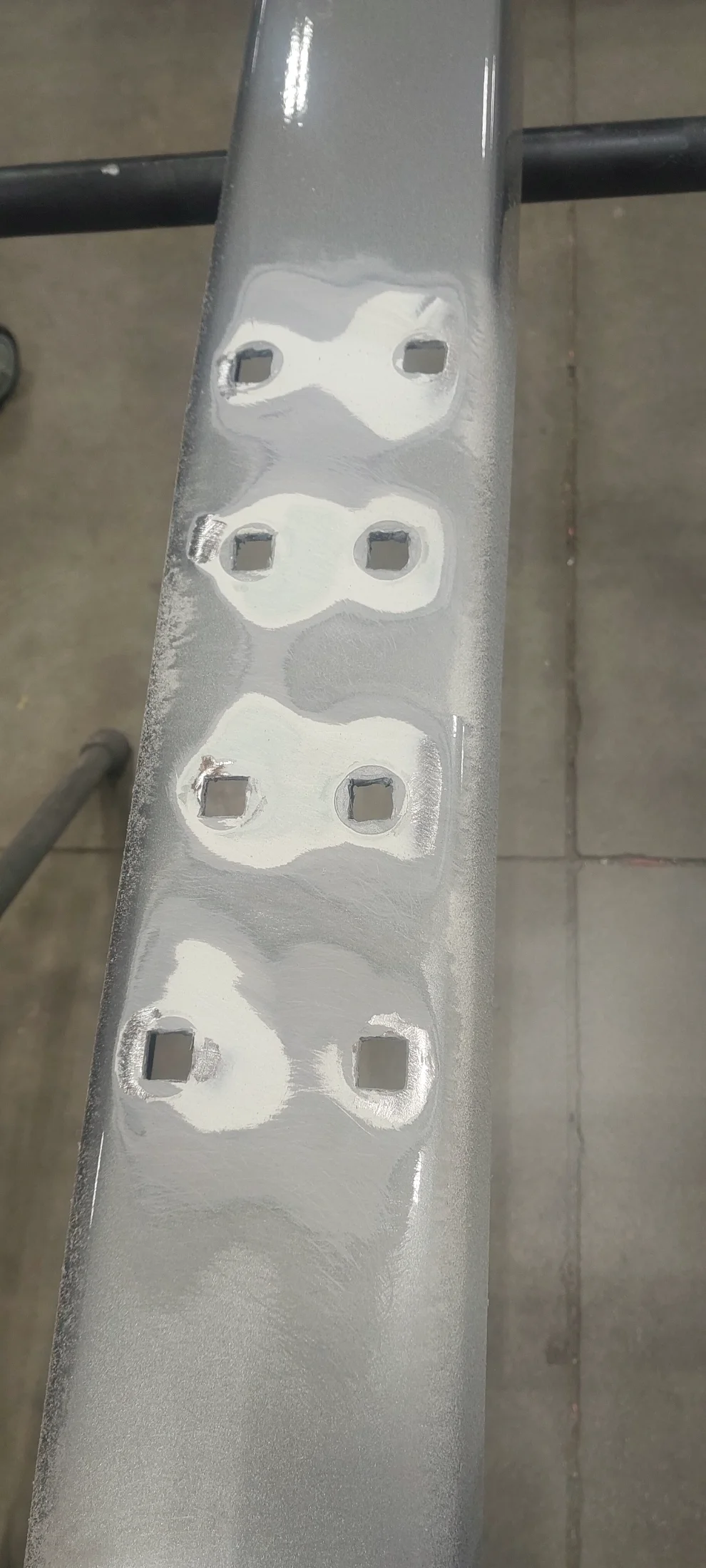

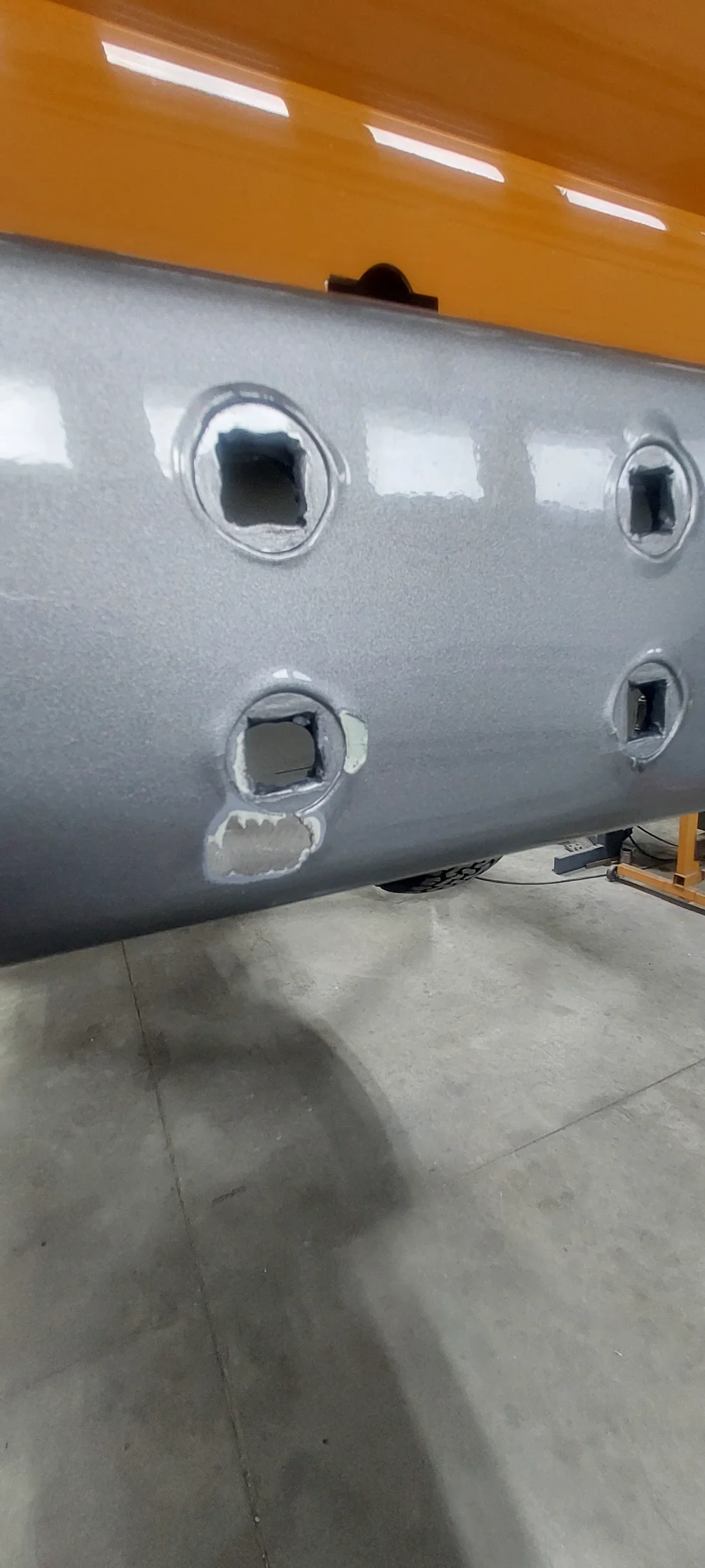

I’m starting out with some minor cosmetic issues while I wait for parts to start showing up. The rear bumper paint was bulging around all the bolt heads and the Pigeater asked me to address it.
I had originally thought the paint was applied a little thick and the bolts tighten a little too tight and this was going to be an easy fix….
But upon further inspection the bumper had been repaired with 1/4" of Bondo around the bolt holes and I was going to have to come up with a way to reduce the amount of compressible material at the holes or it was going to do the exact same thing to me.
View attachment 4085236View attachment 4085237
You can see it already started rusting under the Bodno.

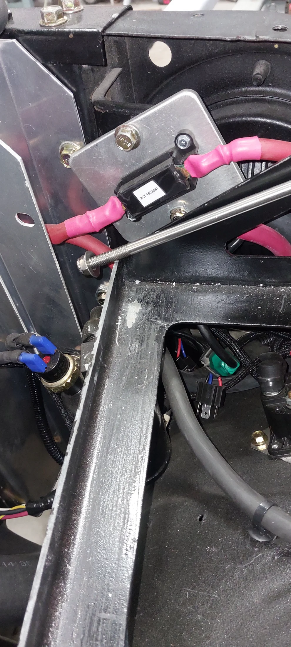

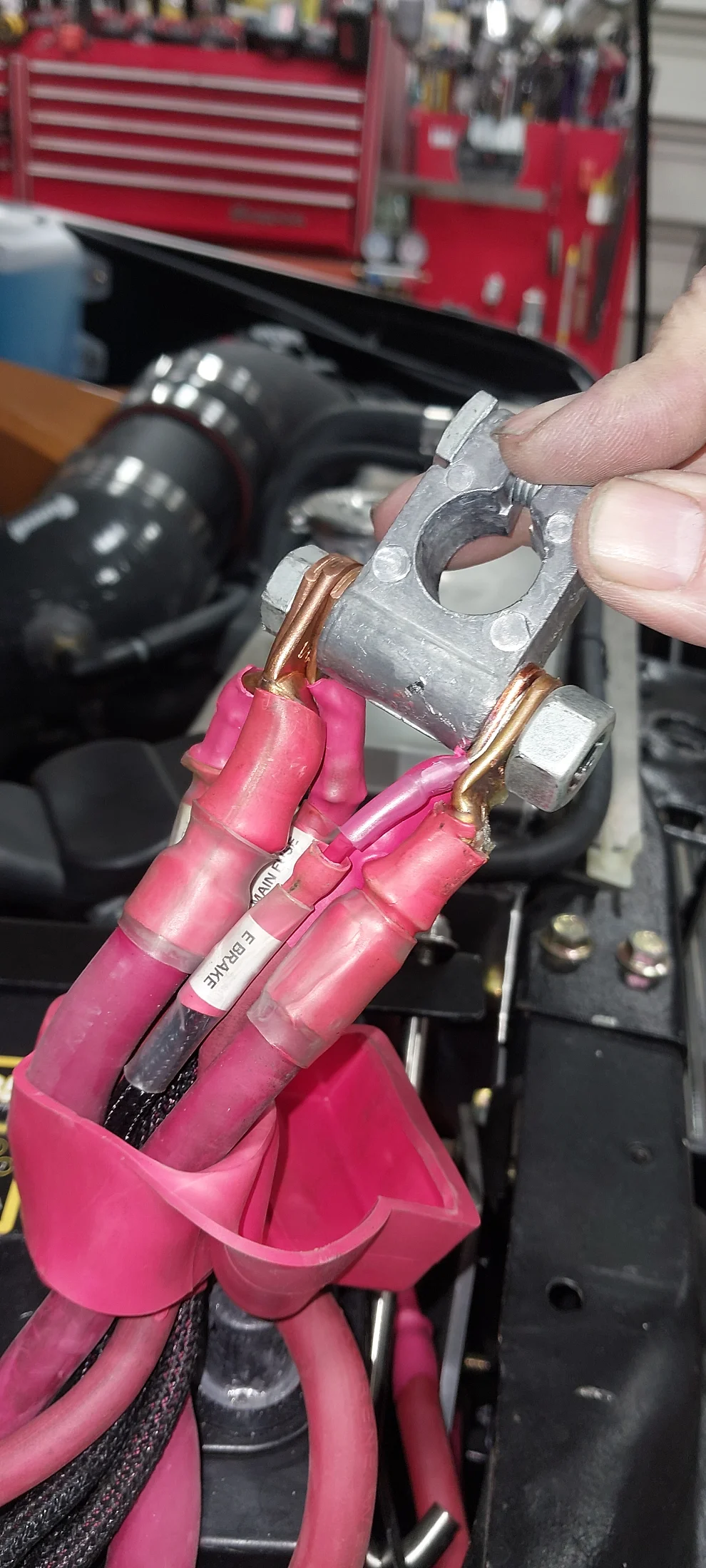

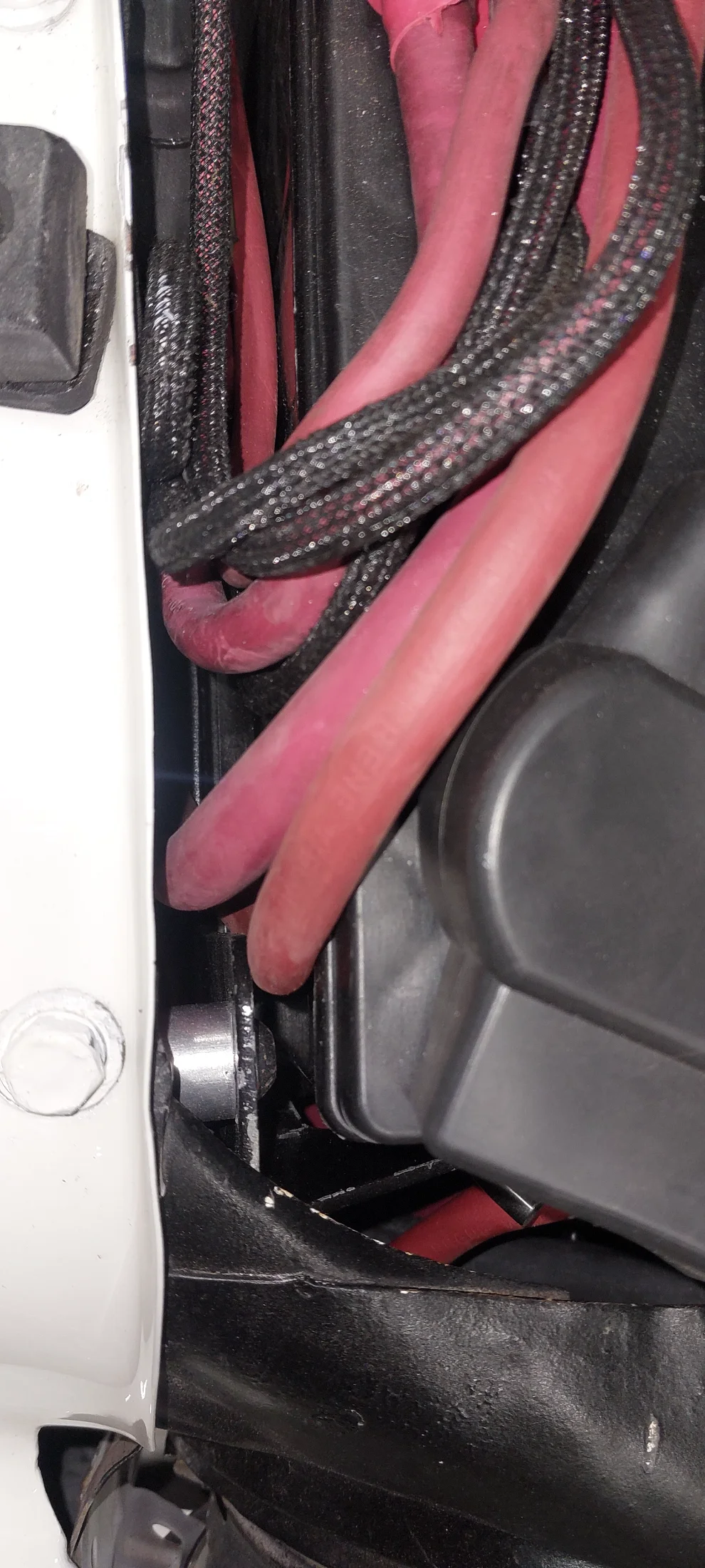

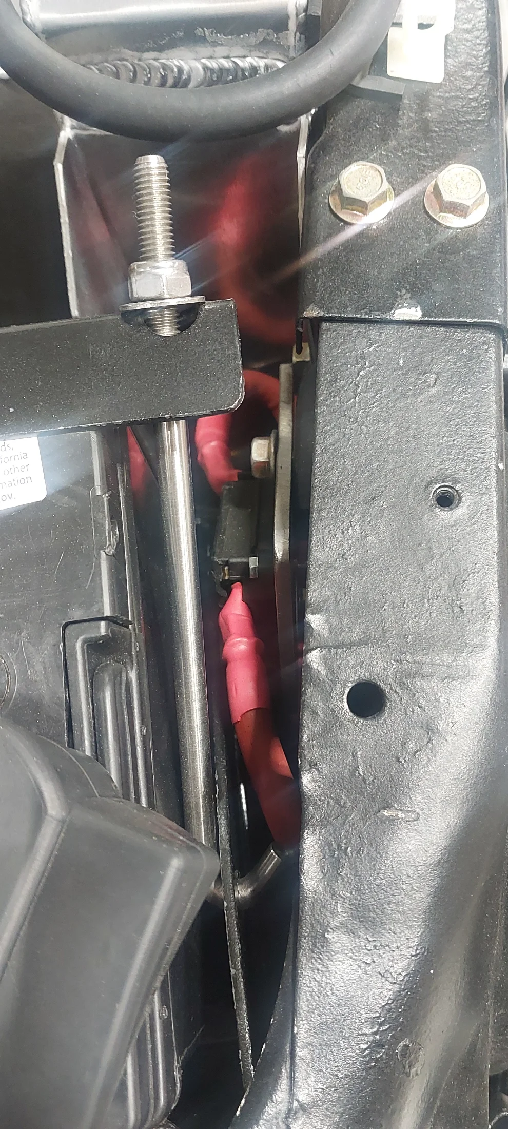

I want to see how this resolves.In the interest of not wanting to burn my shop down I've disconnected these batteries until further notice..
Yes the cables are sandwiched between the metal battery box frame.
View attachment 4085534View attachment 4085535
Lots of cables directly to the battery clamp.
We did have a fuse that you can't get to buried behind the battery but it's after the sandwich cables so it was unlikely to blow anyway.View attachment 4085537
I will still have several things to research like that random unplugged what looks like something for the headlights hanging in there..

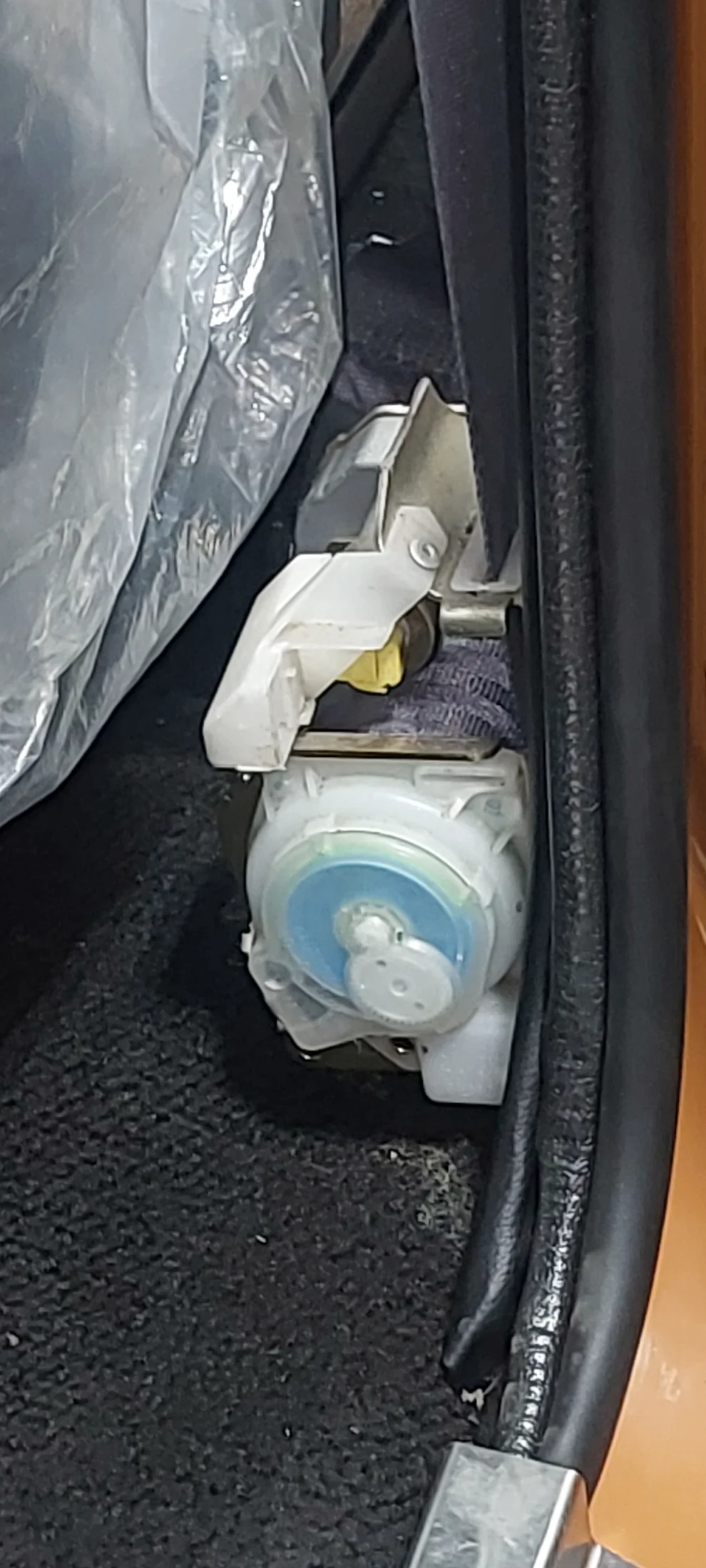

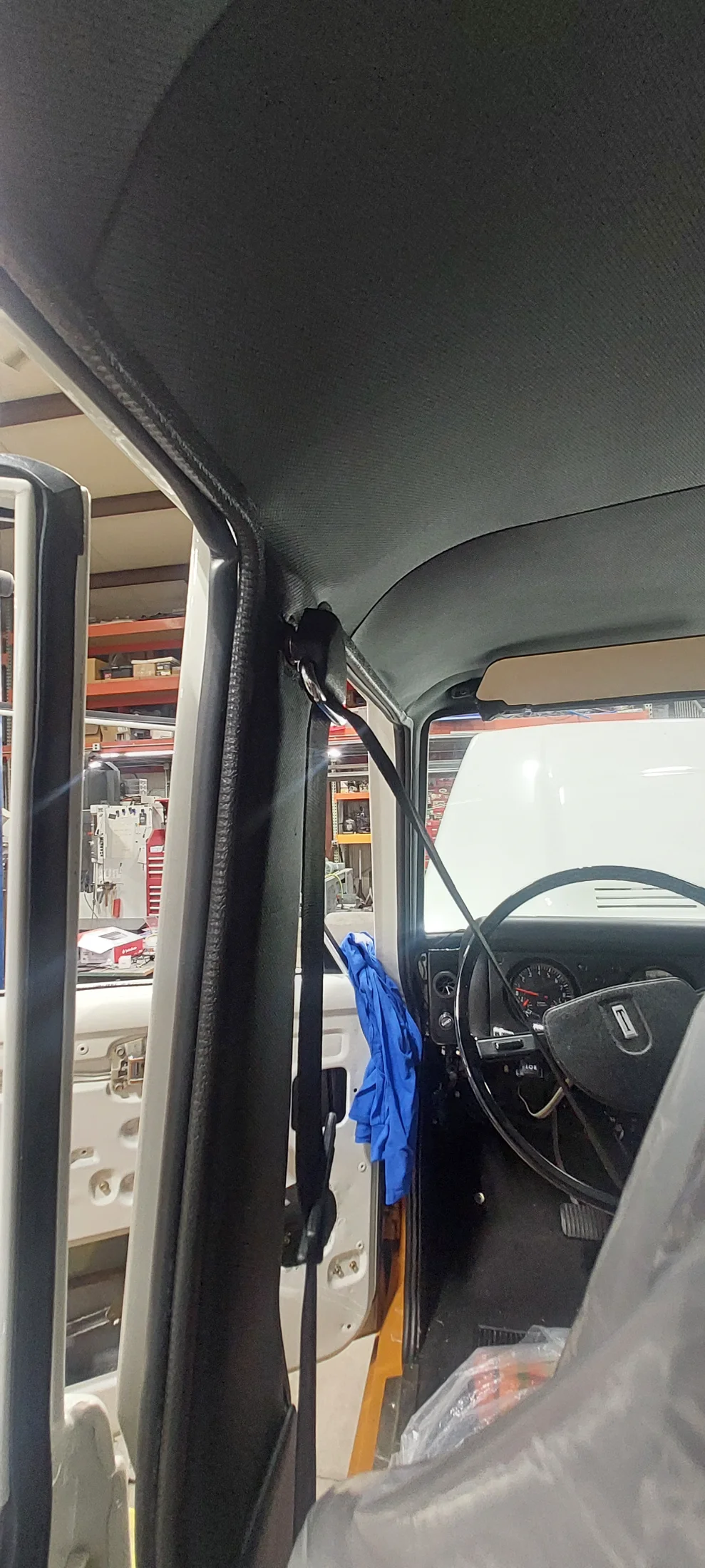

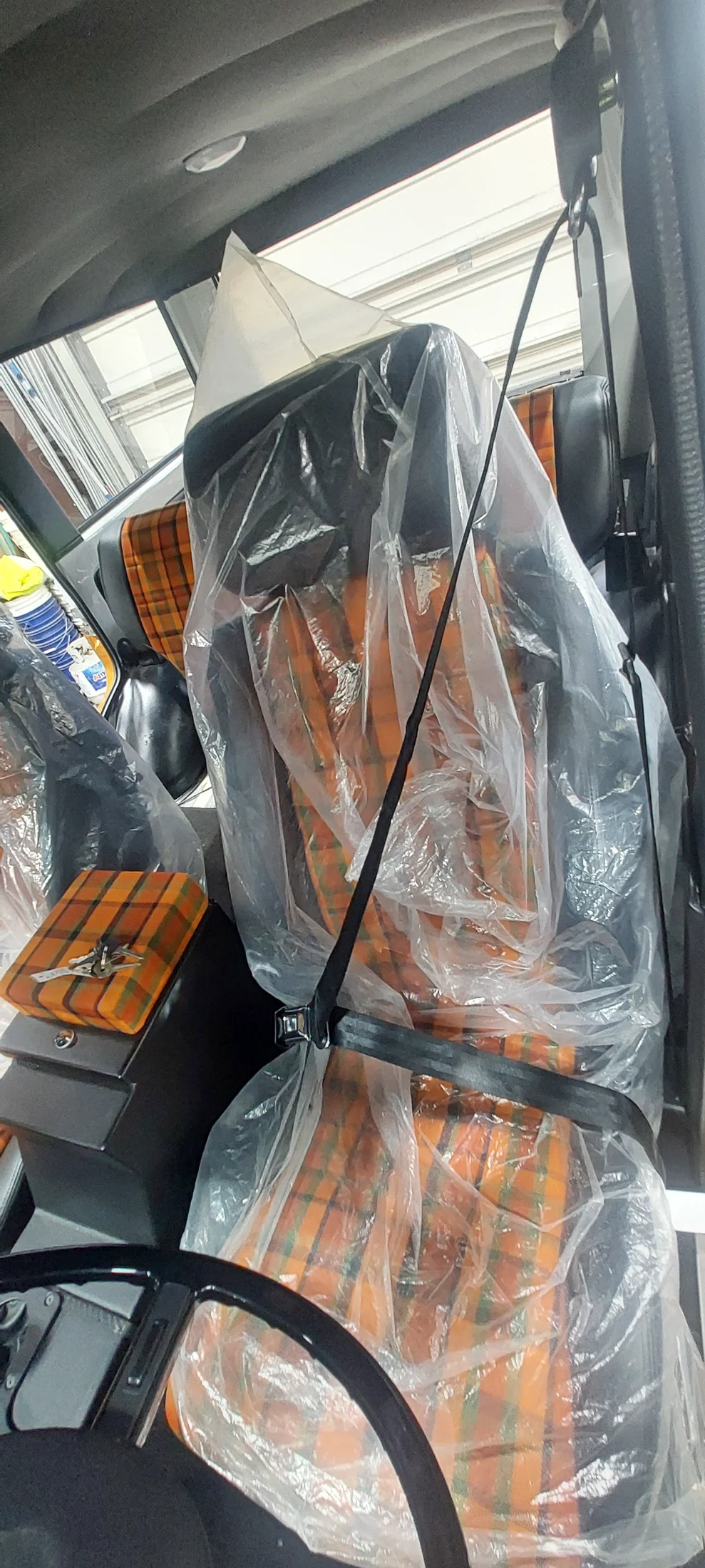

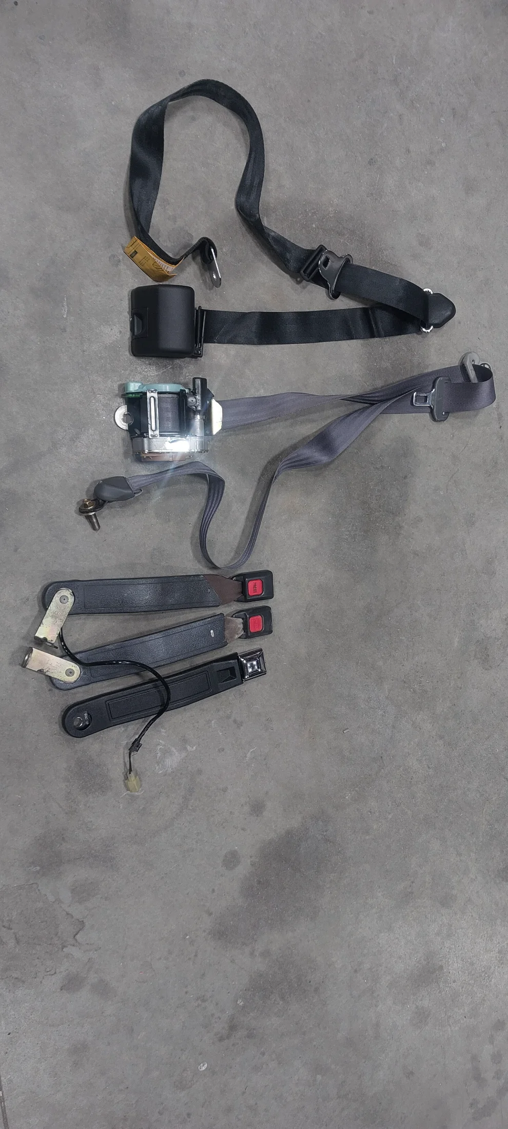

The Summit link doesn't go anywhere for me, anyone else?Seat belt day, Don asked if I could track down some belts for the rear ( none got installed on the original build) and do something about the front belts that did get installed on the original build..View attachment 4085764
Missing covers on both sides and dry rotted...
So I ordered some belts from Summit Racing and I think they fit well and look good.
View attachment 4085778View attachment 4085779View attachment 4085780
I still have a bit of work on the rear seat but I'll get some pictures when I get there.

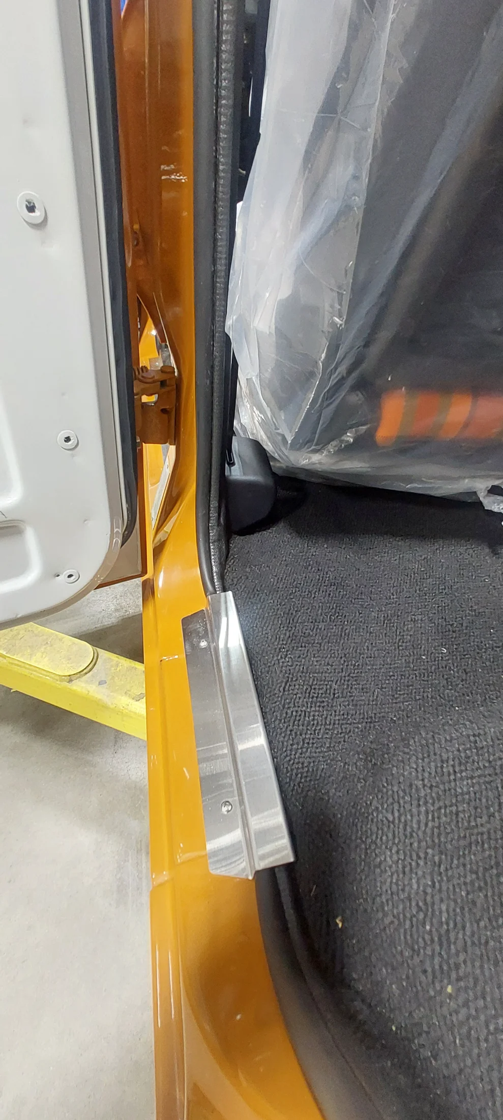

I was wondering the same!PN# or link to the seatbelts?
They look like a perfect replacement as long as the B-pillar anchor conversion has been done?
