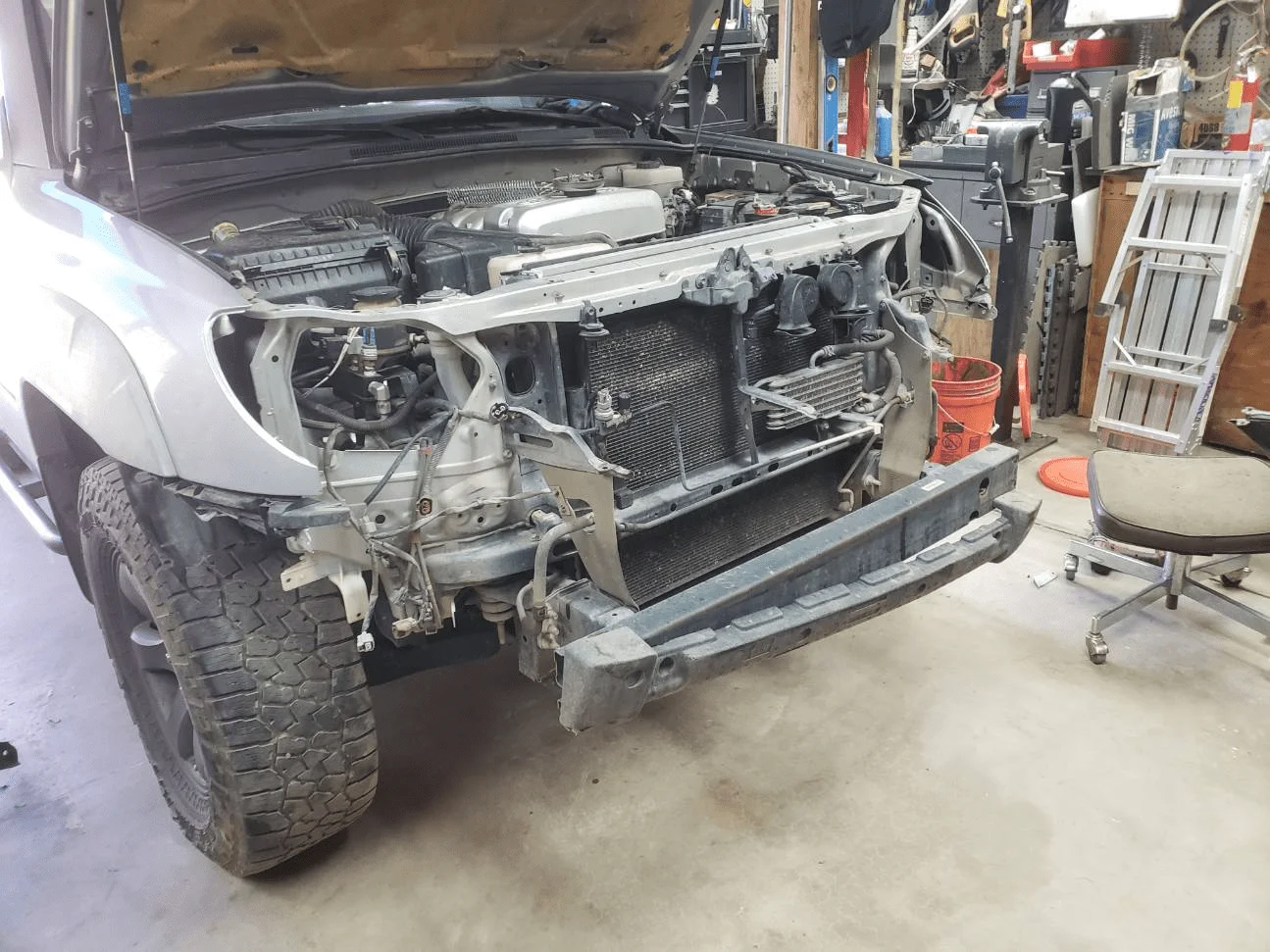

Ten hours into this 4runner front bumper, ready to burn in. Removing the OEM front bumper took about an hour but it was fun snapping off brittle plastic pieces along with a gazzilion trim things.
Now the big question is will it fit and bolt up. Or, be all wonky. :flipoff2:
Everything tacked on the vehicle so 98% chance she'll bolt back up :hmm:.
Hopefully it's done for the breakfast, I was between that and the coastal. I went coastal and love it, but yours looks really nice too. I like how open the winch opening is, the coastal doesn't have much room. Which reminds me I still need to buy a winch.....
Unless you warp it ...... Jk no bad juju, what are you gonna paint it with?
Ya, he will burn in the brackets and they will bend and nothing will fit.
Happened on my rear bumper. After that I lost interest. One of these days I will pull it off and finish it.
