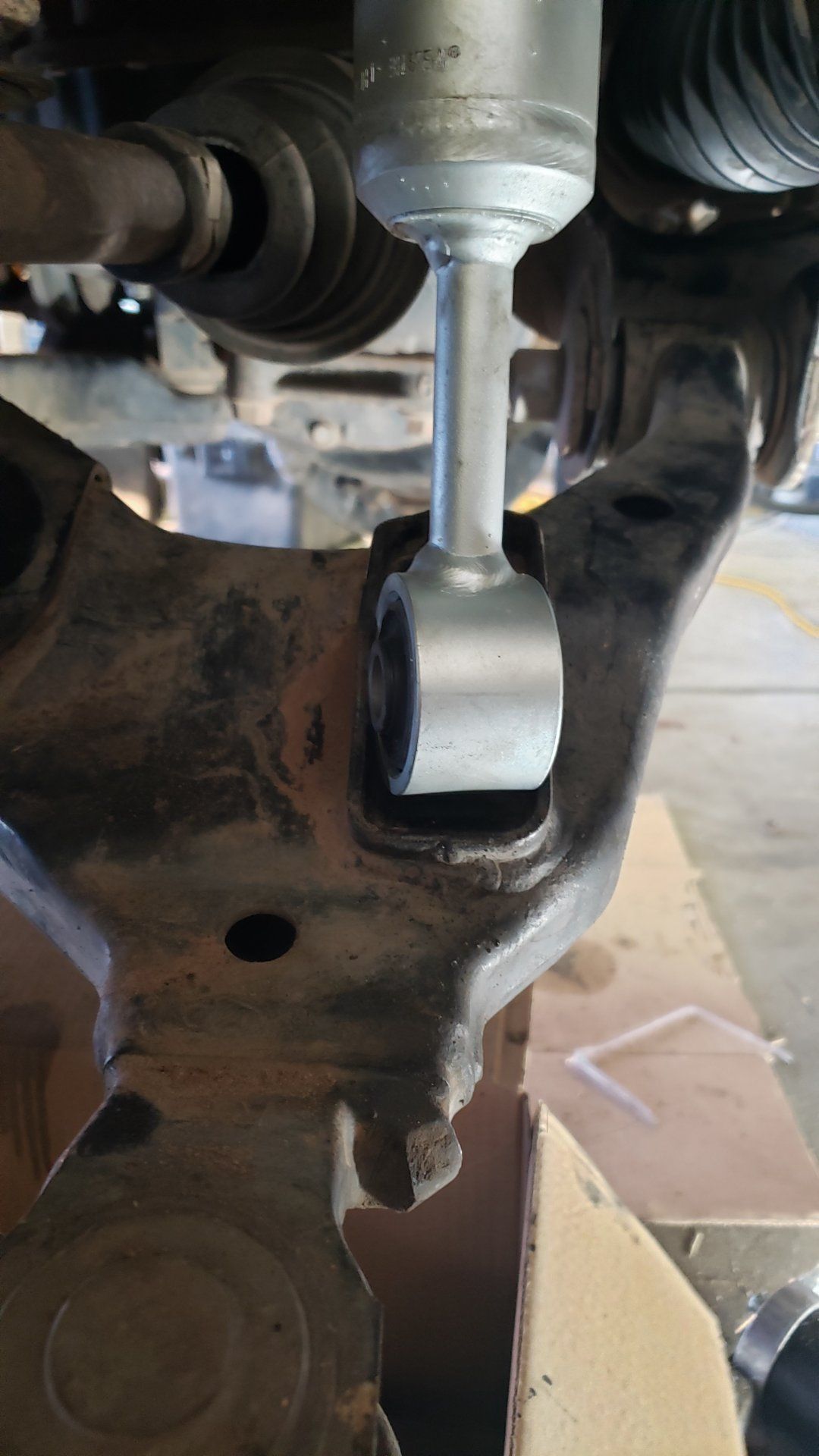

Hey guys, I'm pretty sure the shop that I paid to assemble my front struts before delivery did one of them incorrectly.
The incorrect strut won't fit on either side of the vehicle in any orientation where the top hats sit flush in the frame and can be bolted. At first, we thought we had the wrong strut on the wrong side. We got the other new strut and the driver side install went perfectly. It was a breeze.
Then we went back to the other new strut (the incorrectly assembled one) and it still doesn't fit the passenger side in any orientation. The picture I have is the closest it will get. If we flip it 180°, it sits even more perpendicular with respect to the control arm mount (and is obviously incorrect).
So we're at a loss. We've called it a night instead of getting the lift done for 4th of July. I'm not putting the rear suspension in until I hear back from the guy who runs this shop/website.
That’s common as it’s hard to get them perfectly lined up when they’re not on the vehicle. When I did mine, I just grab what ever tool I had laying around to put through the bolt hole and twist it into alignment. You’ll twist it a little extra and then it will settle into place.

That's what I did when installing my struts the other day. The passenger side was slightly off so I had to take a long screwdriver and twist it into place. Helps to have a second set of hands while doing that and lining up the hole in the bracket for the bolt.
Alright, thanks for the replies. I'm fairly annoyed by this as I paid a service for it to be done, and they advertise it as being a turn-key install. I'll deal with it.
Mine won't budge or turn with a pry bar. Do I have to loosen the top nut on the shock?

But I have a whole different problem now. The bolt for the lower shock mount rounded off the threads as I was tightening it. Thankfully I was able to back the nut off.
I'm calling it quits for the weekend. :bang:
Chase them with a die.
