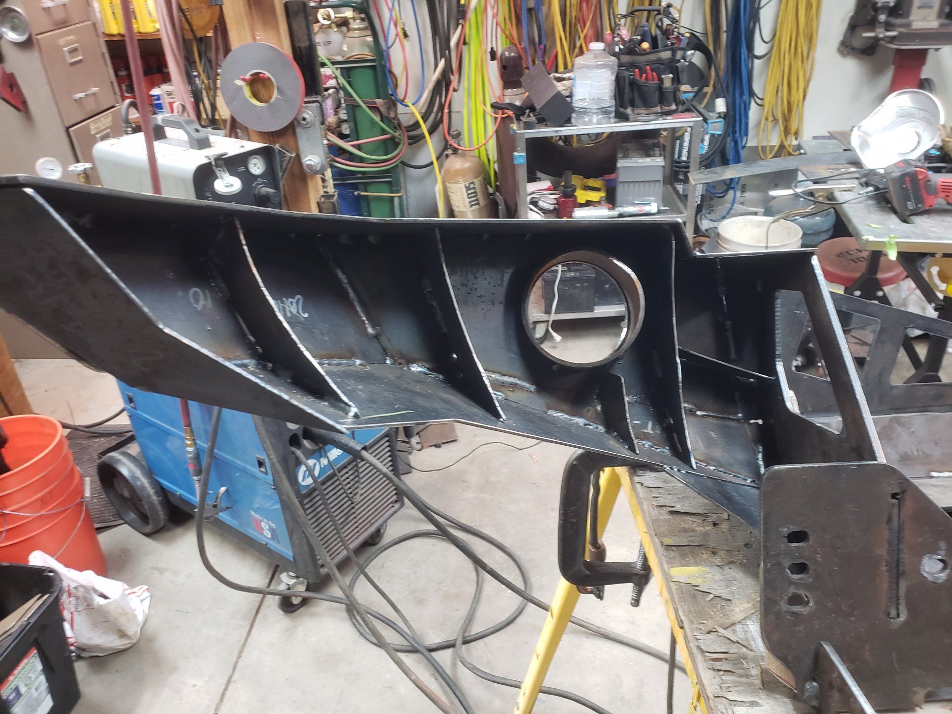

Ya, he will burn in the brackets and they will bend and nothing will fit.
You're gonna laugh but there ain't no more. What you see is what there is! The downside is that this design is severely lacking in proper gusseting and bracing of the wings but the main cradle is made out of 1/4" thick steel so it's rather beefy, to say the least. I'll re-design it to my specs this week then it's going back on the rig.
After the bumper is on the front, the front suspension comes totally apart and gets reconfigured for the extra weight with SPC UCAs+700# King springs. That reminds me, I need a winch :bang:
After the front is buttoned up, then I make a rear bumper and that one should go easier, I'm hoping.
I have seen the way Ali works. I have no doubt that the bumper fits. I bet he he's even lost sleep thinking about it. He don"t mess around.

Progress pics @alia176?
Not much new, at least visually. Worked on some internal bracing of the wings. Ran out of material for a complete boxing in of the face 😡
Looking good! What material do you need? Are you going to paint it or powder coat it?
I'm using 14g for the bracing and boxing. I've got plenty of 10g (1/8") but that's too much for this application.

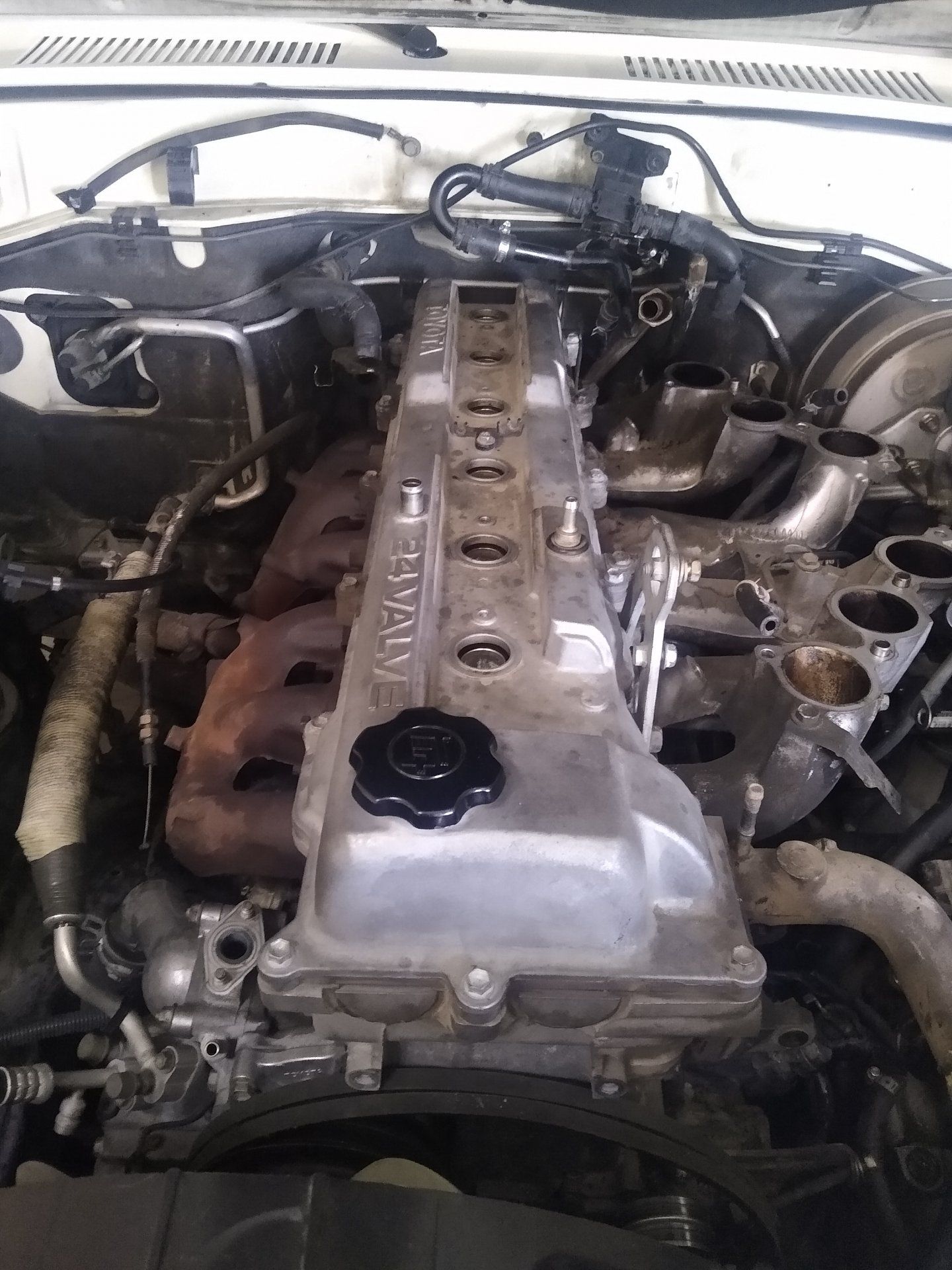

Started on my cylinder head removal on my 80! Gonna have valve job done. Valve stem seals are leaking. With 225k miles probably not a bad idea to do head gasket anyway. Also replacing the engine harness as mine was damaged near the EGR valve.
I will be following this, as this is coming up on my radar as well.
