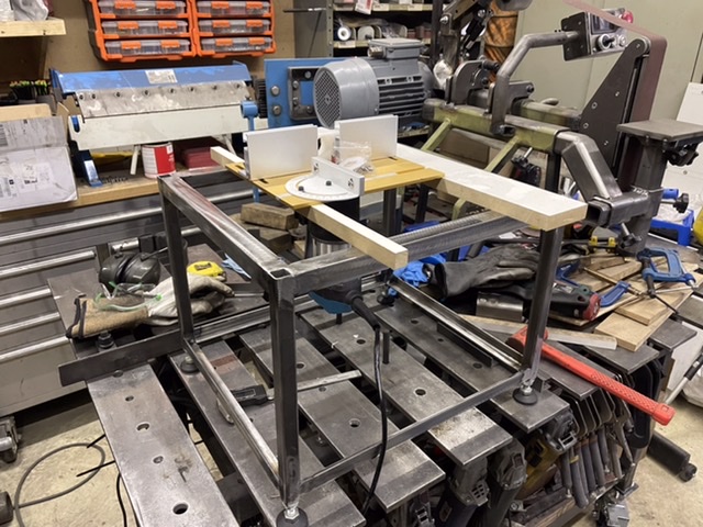

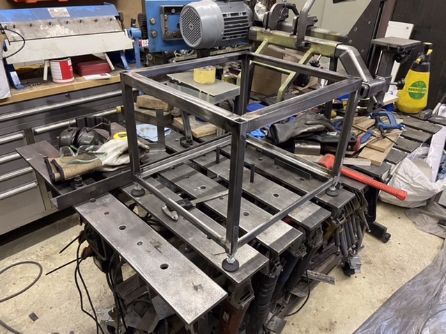

I needed a small router table.
Cut some steel.
Cleaned it and added nuts to the bottom.
Clamped for welding.
More clamping and welding
Here is the frame with feet.
And to give you an idea of its purpose.
Next I will be making a table top for it.

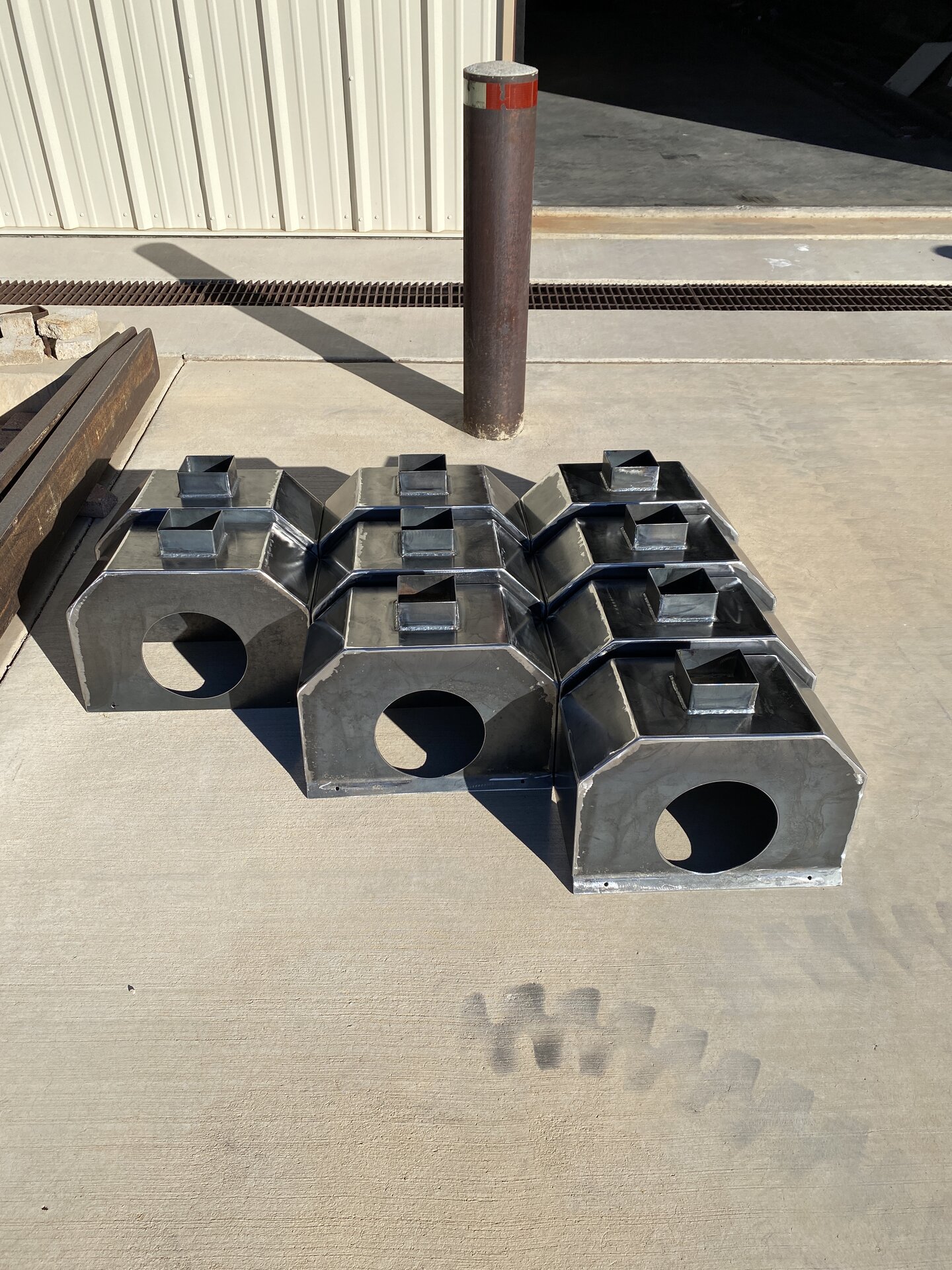

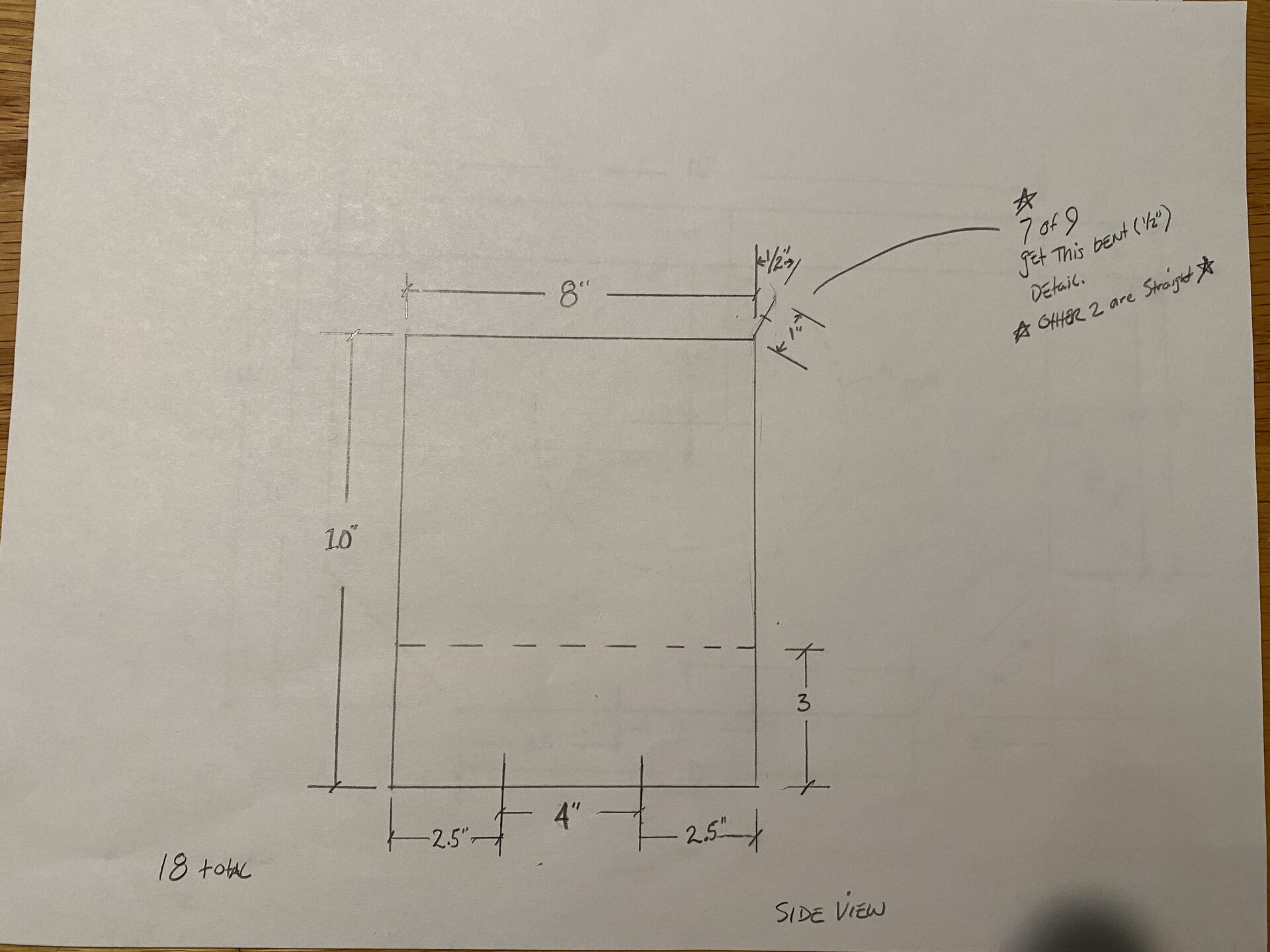

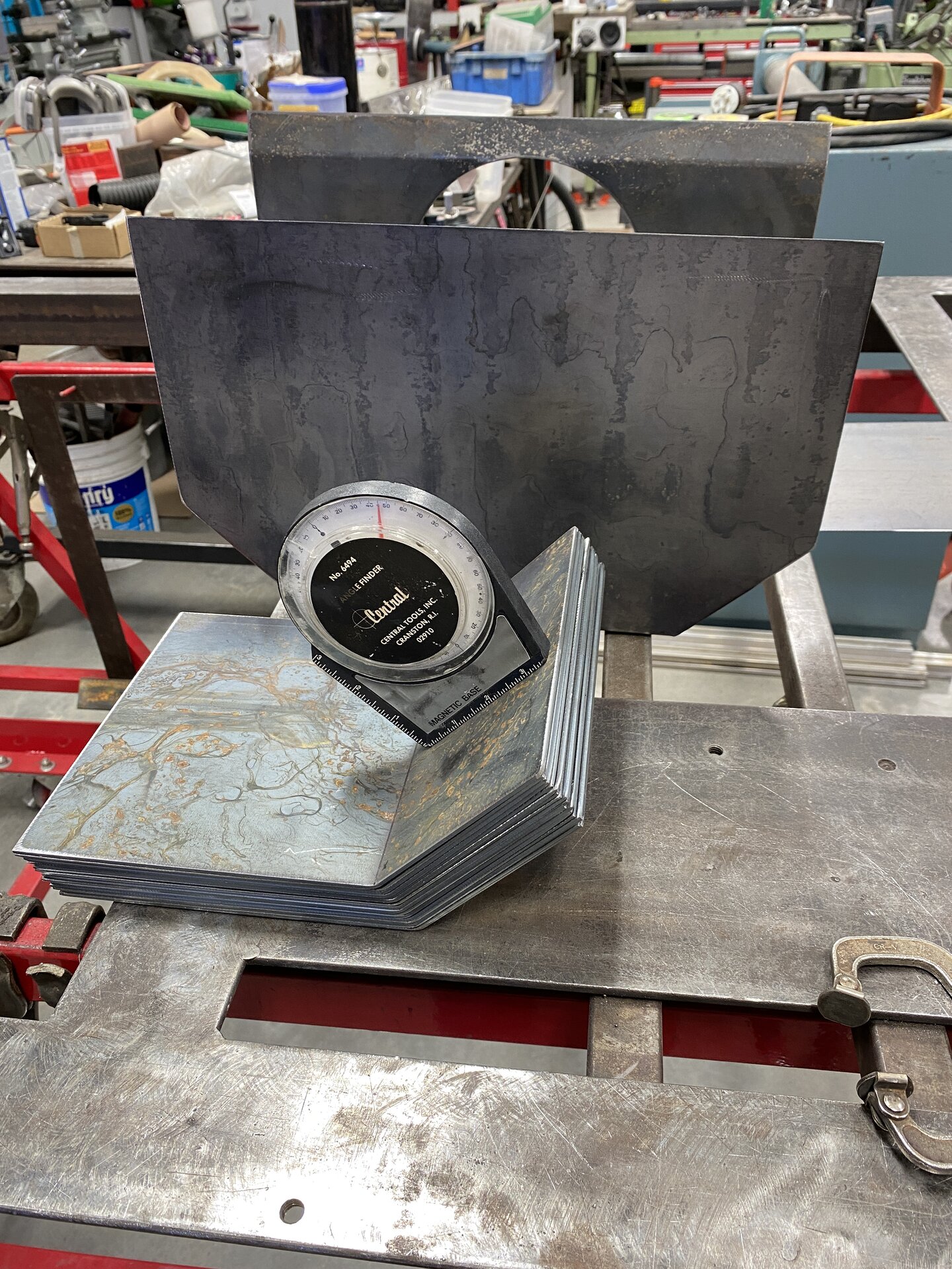

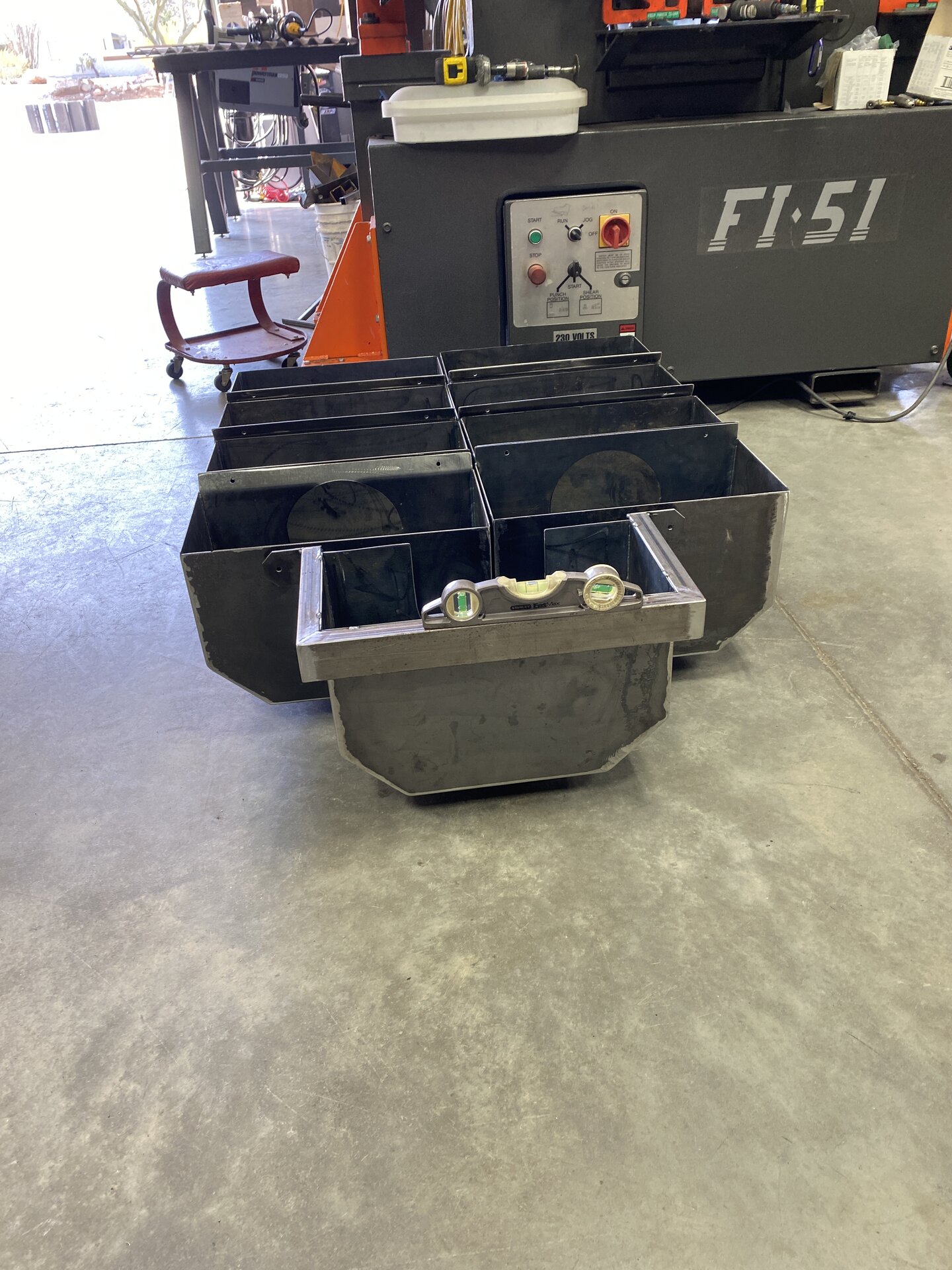

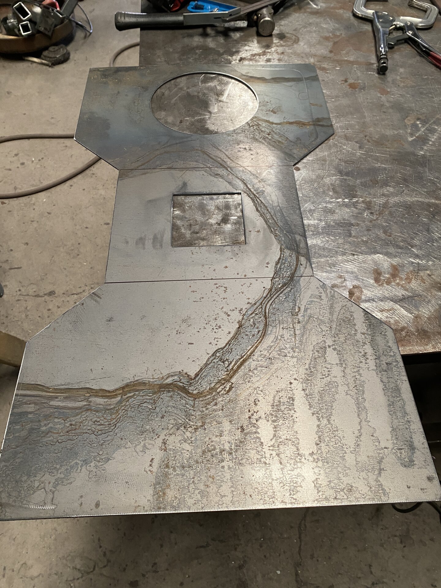

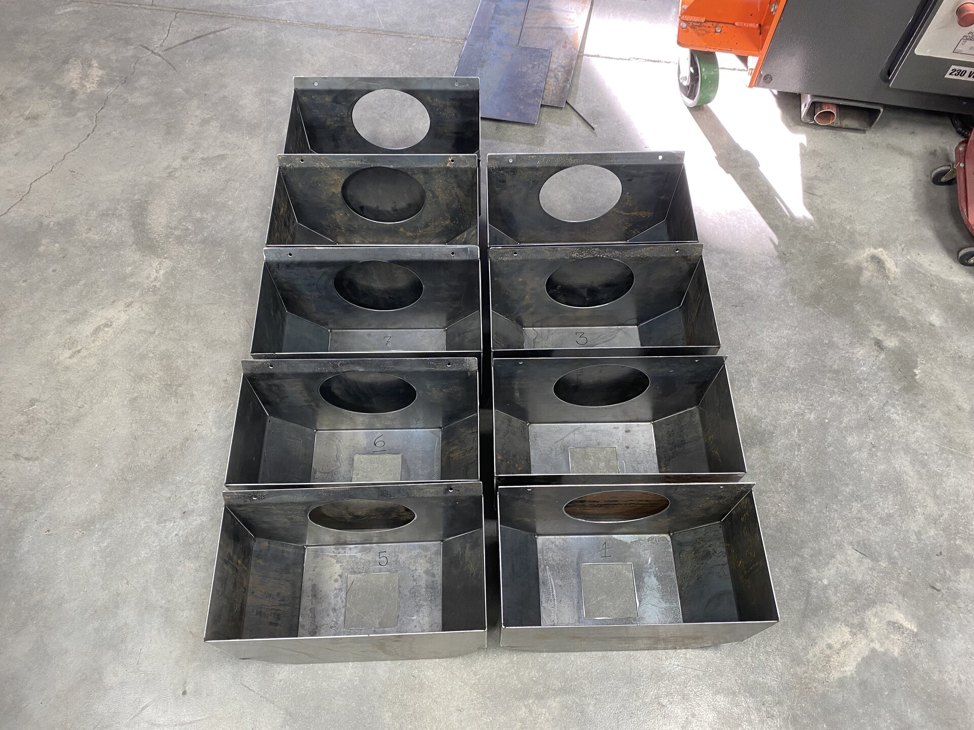

The downspouts will be 4”x4” 14 ga. so receivers were made and burned in.
All blended.

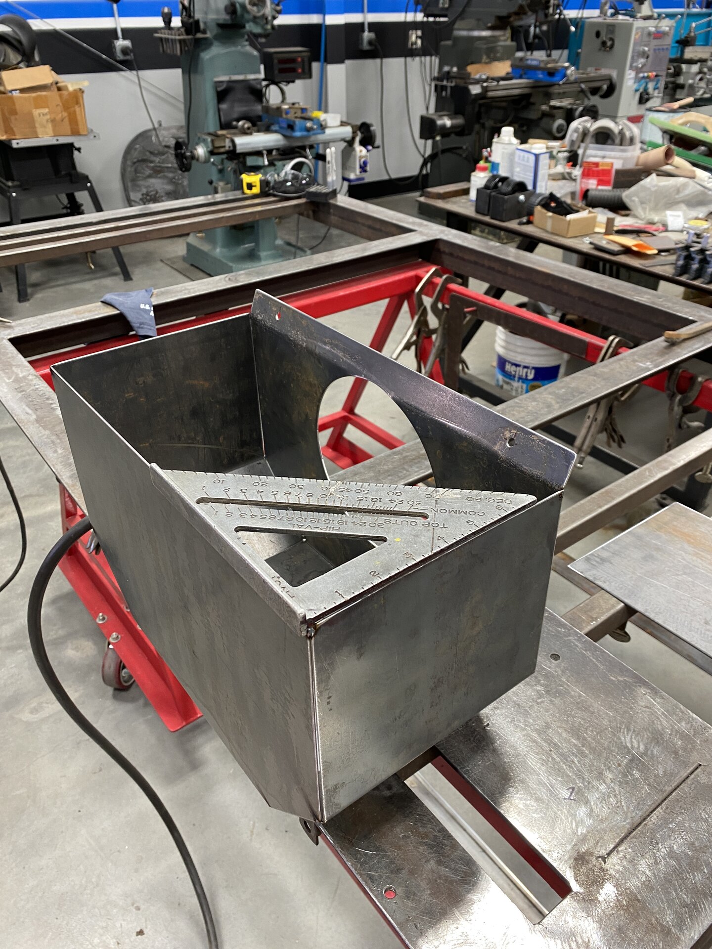

Making custom tabs. The 2”x1” give the box a classy look.
One down , eight to go.
On hold for the moment due to other projects.

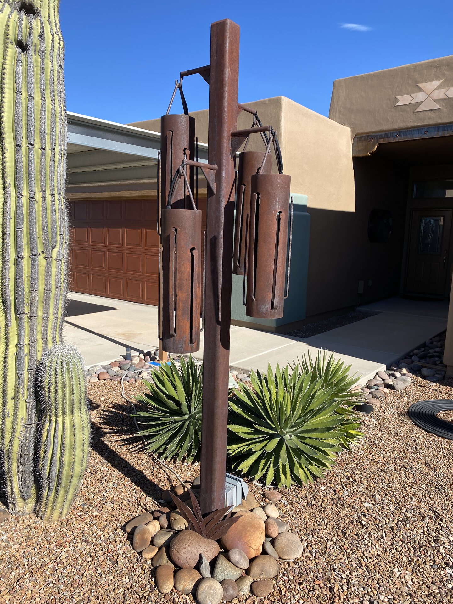

built this lamp in 89 as a Christmas gift for my family. Back in those days I was starting off on my own and was basically broke but with left over stock, I was able to come up with a lasting gift. Transplanted once in 98 and there she sits. It had been ten years since the lamp last lit because of bad wires and outdated electrical components.
The lamp design was inspired by a wind chime and uses four 6” sch. 40 pipe sections. Each section got a pattern cut using a cutting g torch.

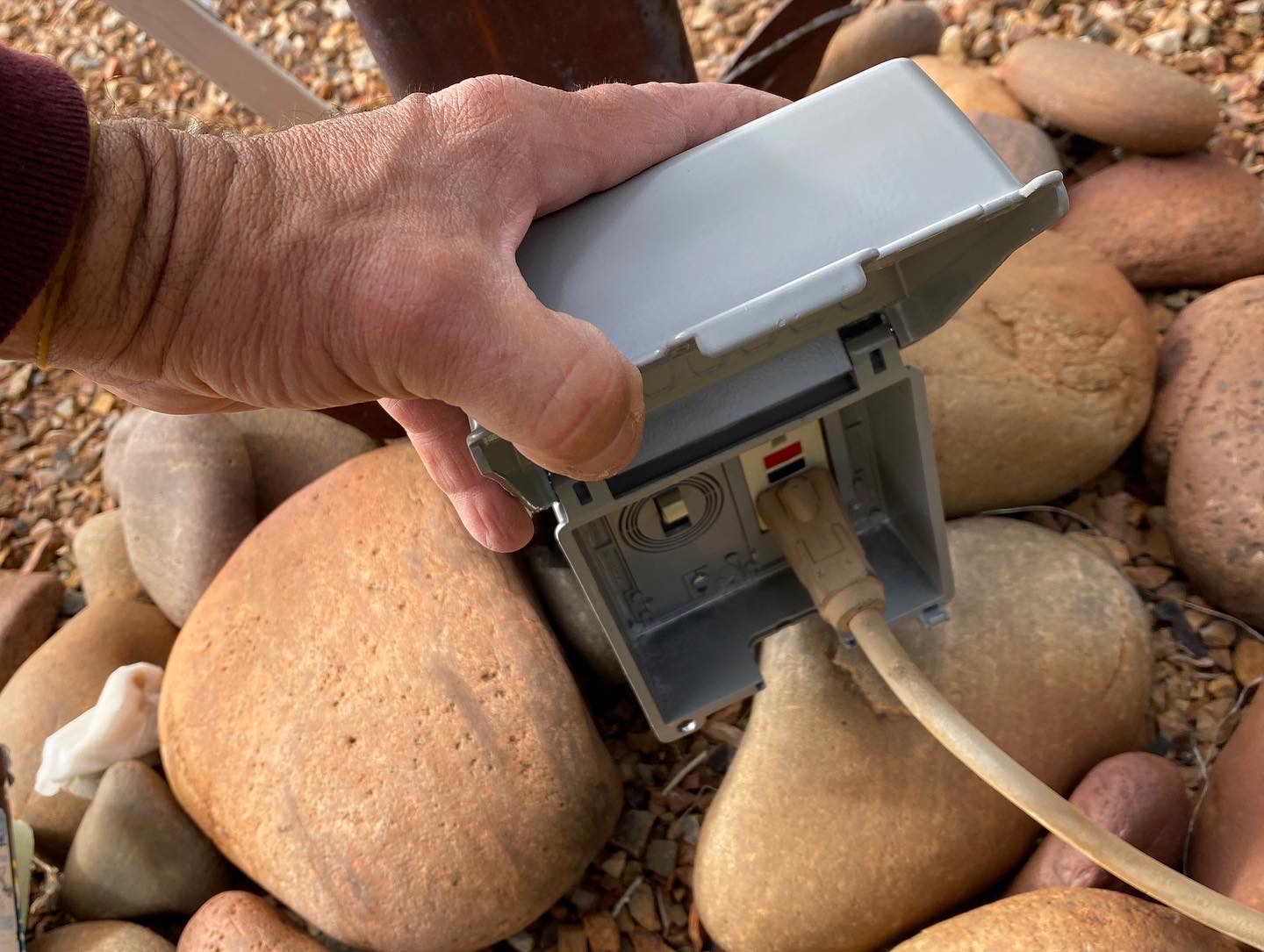

New wire were fished as well as a new switch, GFI, and weather box.

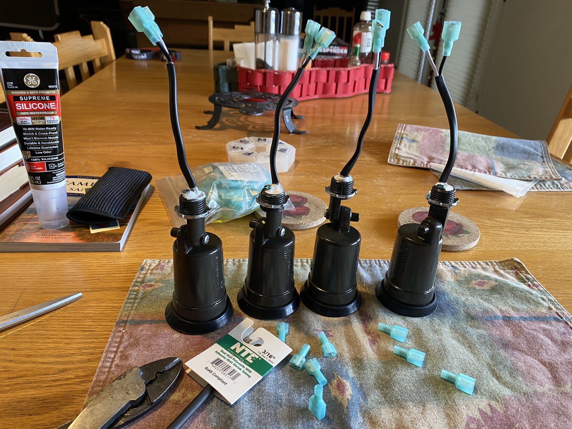

The lamp heads were also replaced and weather proofed with silicone.
The wires also were protected with marine grade heat shrink. Also added terminals to allow the removal of each section without cutting any wires.
The fixtures installed.
More to add.
A new box cover, GFI, and switch.
The top where the wires exit required UV protection so I’m trying out this loom designed for race application. The loom can take direct heat contact of 500°f so I’m hopeful the wires will last for a long while.
The shadows this lamp cast is pretty cool.
33 years old this Christmas.
