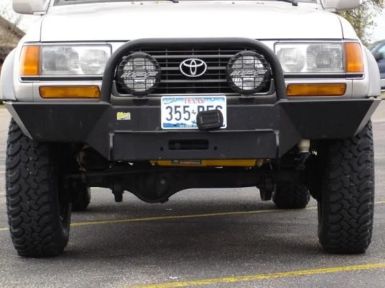

Thanks man,
I am pretty stoked how stock it looks. Most people don't notice at first...Then go "cool wheels...hey are those coil springs?" ...
I am stoked to finish up and get working on some trick bumpers...
As for tires I am either thinking 33s or 35s AT's BFGs...

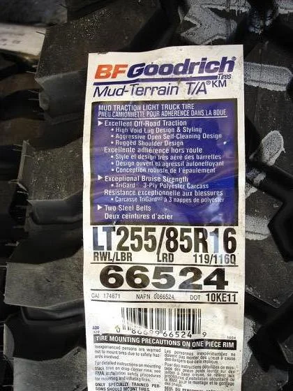

Hey where are your pizza cutters at?? Out of anyone of us that has them it should be you...You could always one up me and get the Interco 34 by 9.5s or are they 10.5s....Either way they are some big pizza cutters.
For the ultimate pizza cutter,
255/85 16's would be sweet.
Although these would require 16" wheels.
My next set of tires will be prob be the 33x.9.5 15" bfg.
