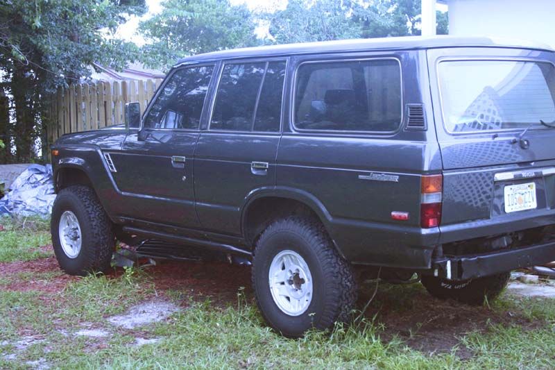

Tires got here today....
Took 5 days to get here from Cali....freee shipping turned out to be 484 for a set of 4
Gotta love pizza cutters (33 by 9.5)
Anywho...got some more work done. Started in on the exhaust....Super stoked, I found out that the stock size exhaust tubing fits in my tubing bender. Which means I am going to bend up a nice new exhaust system.
This weekend I will prob just spend removing the wheels and cleaning them up, Hopefully I will be able to find a tire shop tomorrow to mount and balance the new treads. The weather suppose to be crappy, I dont mind working in light rain but if it gets to bad I might not even get the tires on.
But....if ever thing works out well hopefully I will have some pictures of the new shoes on the fj68 tomorrow night..
Til then...
Heres a not so great picture...
Ill grab some better ones this week.
I cleaned up the rims a bit when I got them mounted...I really dig the look of it. Worth the money even though it was on my credit card and will take a bit to pay them off.:doh:
