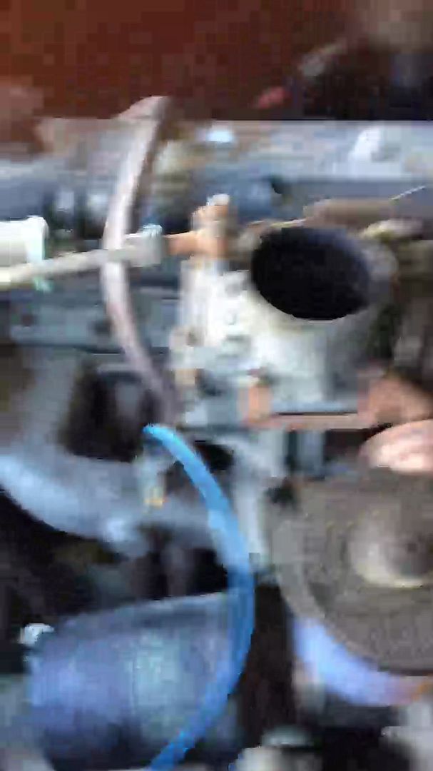

Well, can't figure out how to link the video....but the celebration is due to the Moviestar is running again, for the first time in 6+ years...
Has steering, but need to bleed the brakes and clutch before it moves....and some lights to hook up...and fenders to install....and seats....and headliners...and glass.....and.....and....and...
