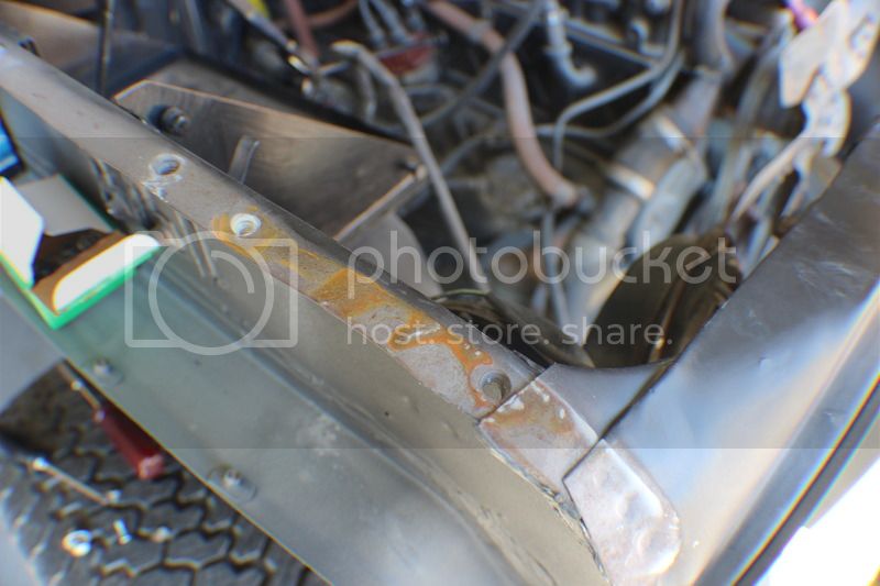

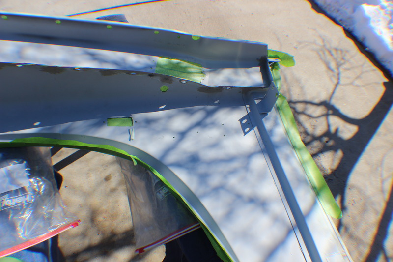

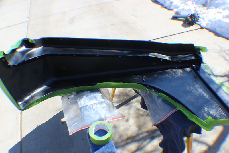

inside of fenders never got painted....why the hell would you not paint them before putting them on the truck?!? The entire purpose is to put this back together and prevent future rust as much as possible....unpainted?!? seriously? I'm going to lose a couple days...but fenders have to come off, get seam sealer and truck bedliner.....should have been done before going on the truck, and before final paint...

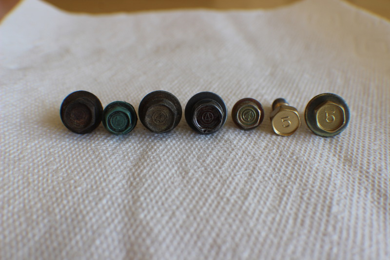

Question.....the three on the right are all 8x1.25 thread count (the other is a 6x1, but also has number 4), what do the numbers mean? I know 4 is the most common. Where do the 5 and 6 go?
Those numbers indicate relative strengths of your bolts. Guessing the fours hold things on like window regulators and perhaps the fives and sixes are used in the engine bay?

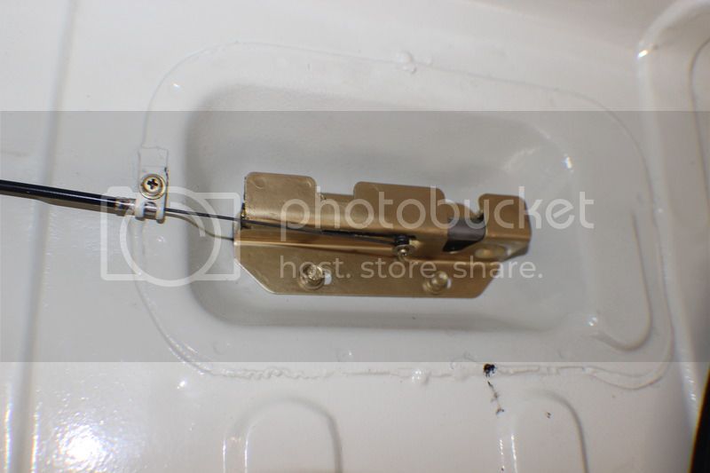

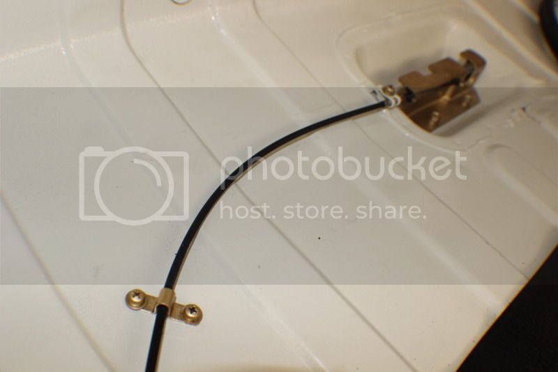

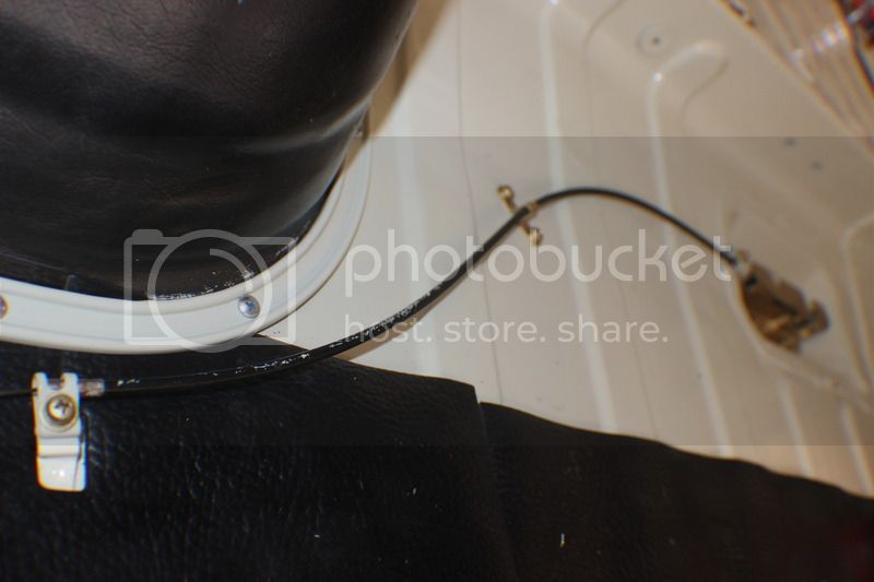

Got rabbit holed again today....rear seat latch. I was not going to mess with it, but could not get it to function properly...ended up dismantling the whole thing, sandblasting, refinish. The latch pin got polished and zinc electroplated. New grease, oiled up the cable, now it works as it should.

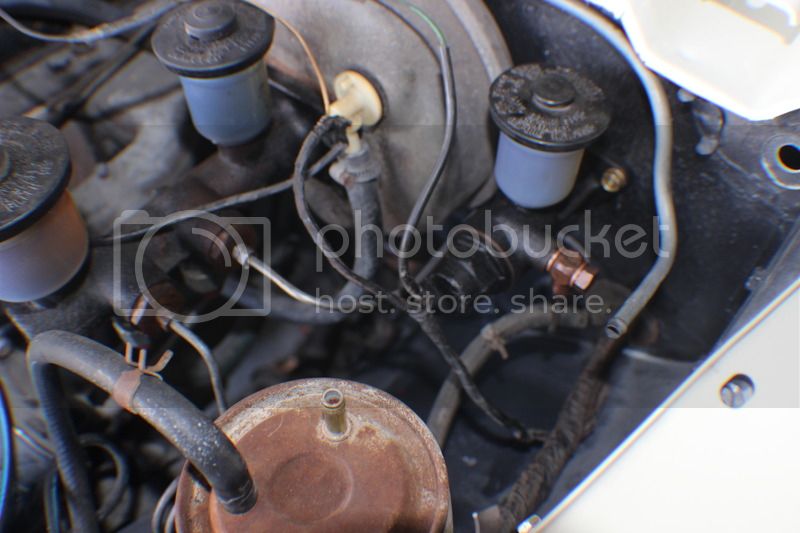

Bench bled and installed clutch master, hooked up all the hydraulic lines for brakes and clutch.

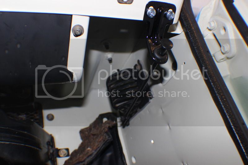

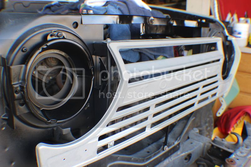

Put radiator support, hood latch support, headlight buckets on, test fit the grill.
Broke two of the plastic headlight adjusting tabs...bummer.
Same thing happened to me, so I welded in some nutserts and coated the threads with this product, so the adjusters don't back out.
