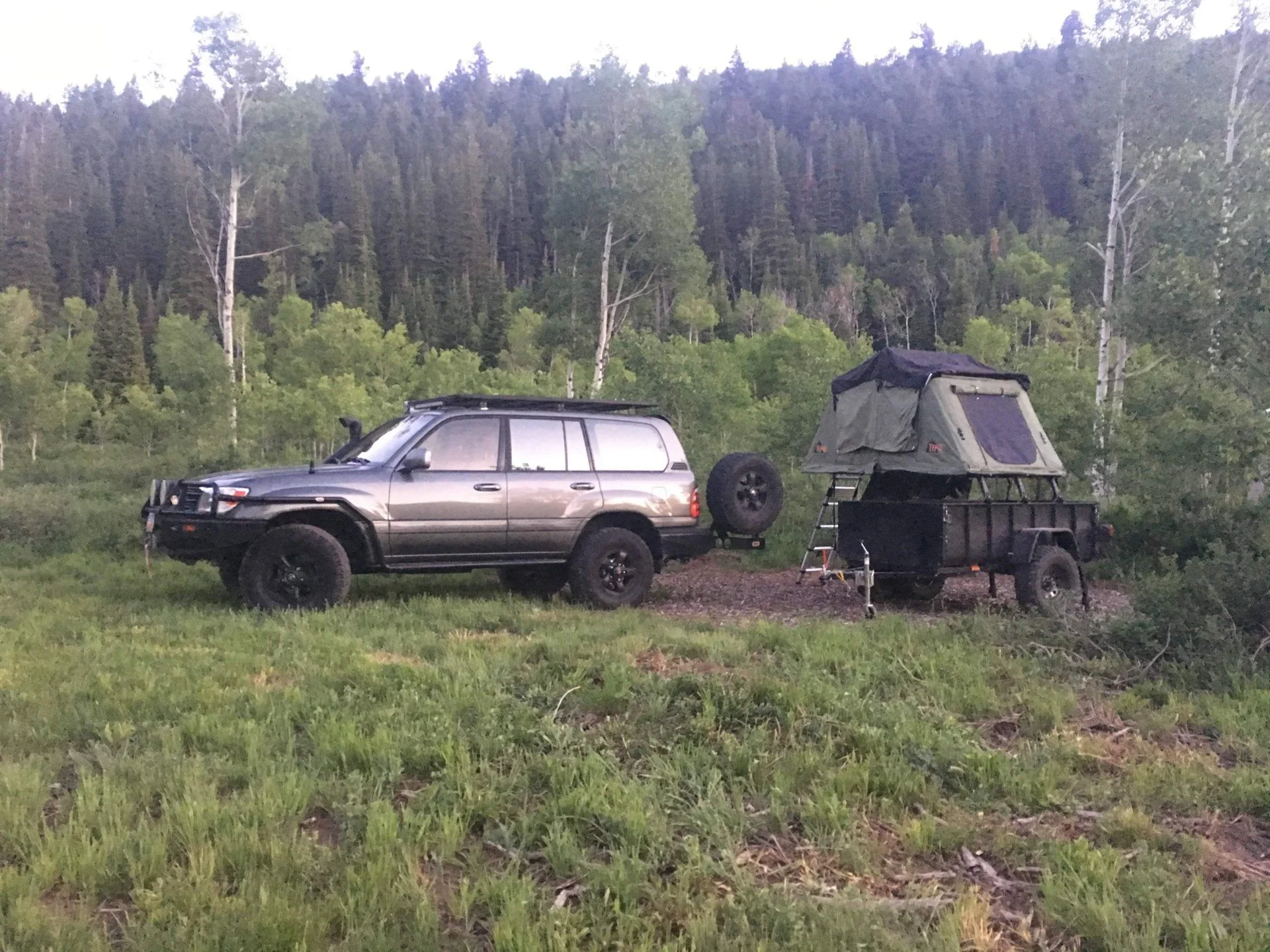

So I did a thing. I sent the Deathstar home with a new owner. It was HARD to do for a grip of reason, time being one of the big ones... it takes time to sell a vehicle even when I've had a buyer for the last 2 years :D
It seem like longer than 2 years... but I guess this makes it public now!

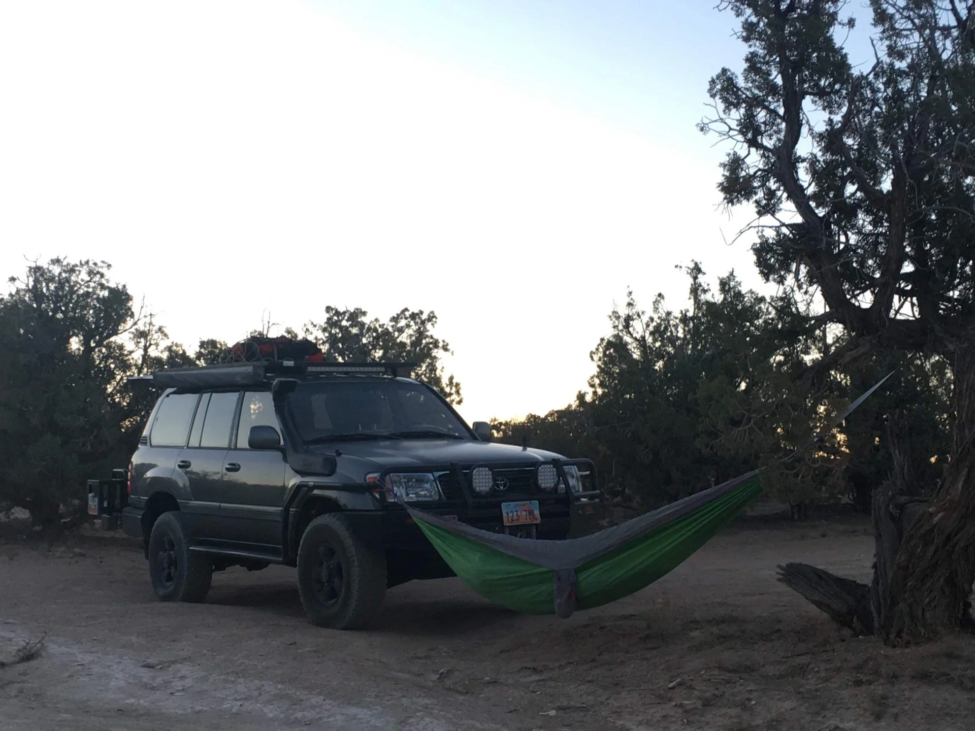

got it out a couple of time the over the past 3 weeks... mostly just camping. and the kids are enjoying it also.
Damn, and still on those tires :D
Glad to see her getting such great use!

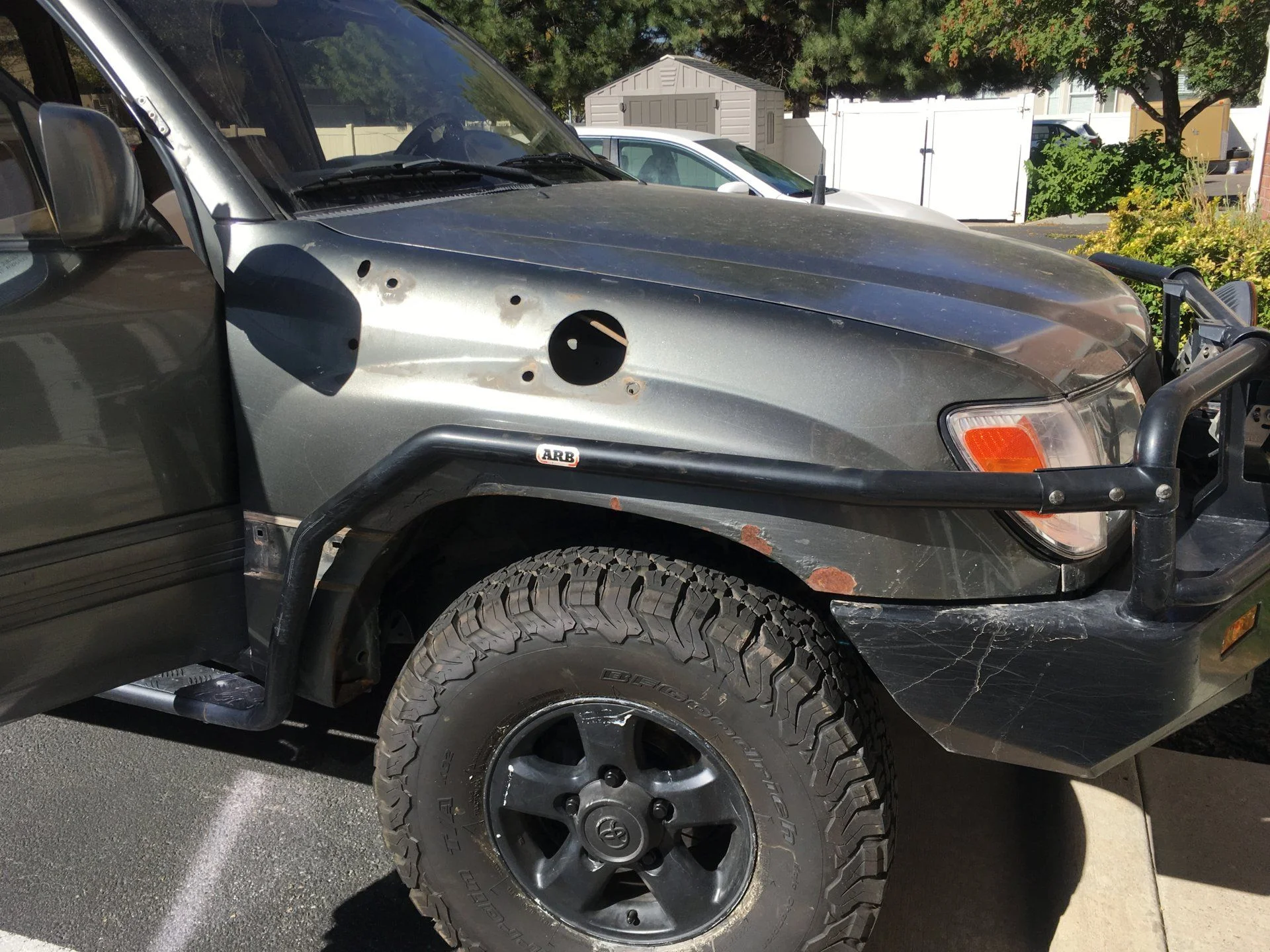

early on in July, the power antenna gave up and the retractor line broke. this lead to me picking up a good used one, this project has snowballed a little bit. when I pulled the old antenna out I found a hole in the snorkel so I didn't reinstall the antenna. I have pulled the snorkel off to repair it which freed me up to pull the fender and repair some rust damage that is a result of an accident early in this cruisers life.

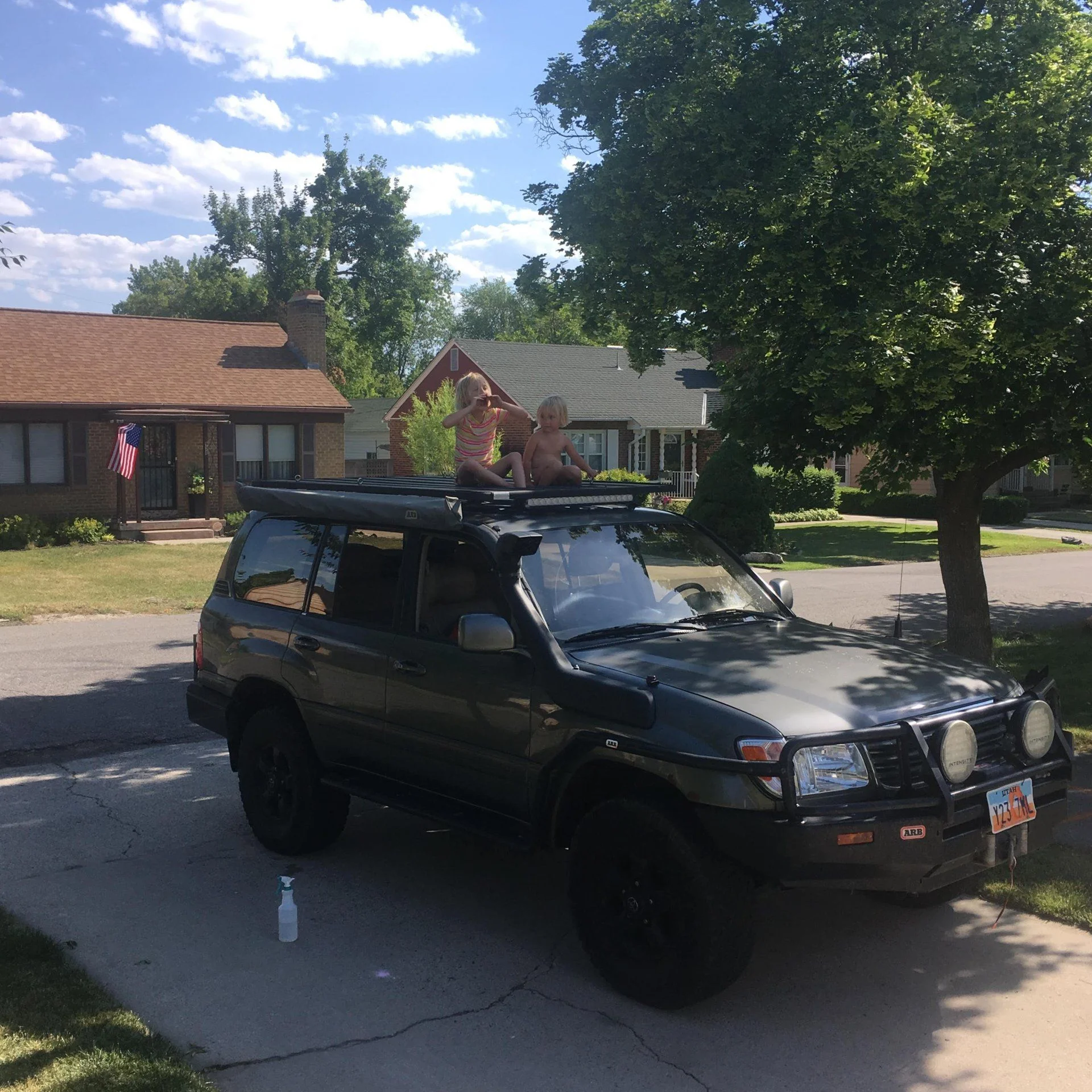

Up a few posts you will see a large raft on top of the truck when loading the boat my father-in-law stood on the bumper and a bit of the hood, he ended up touching the windshield with his toe and a huge crack propagated from a small rock chip that I was going to have repaired... so I ended up need a new windshield and now that the snorkel and fender are off I figured I would swing it in so the glass guys wouldn't have to work around the snorkel.

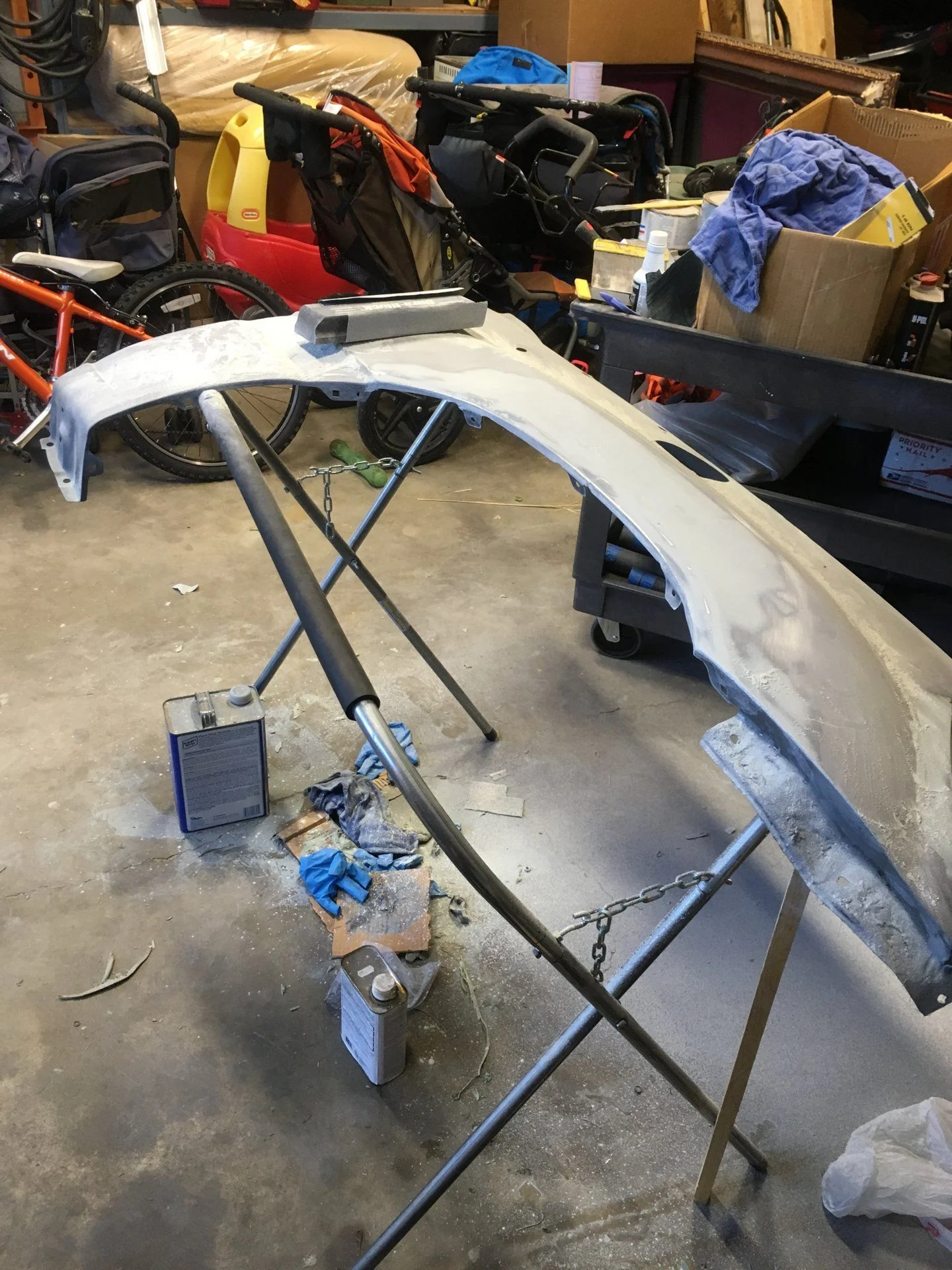

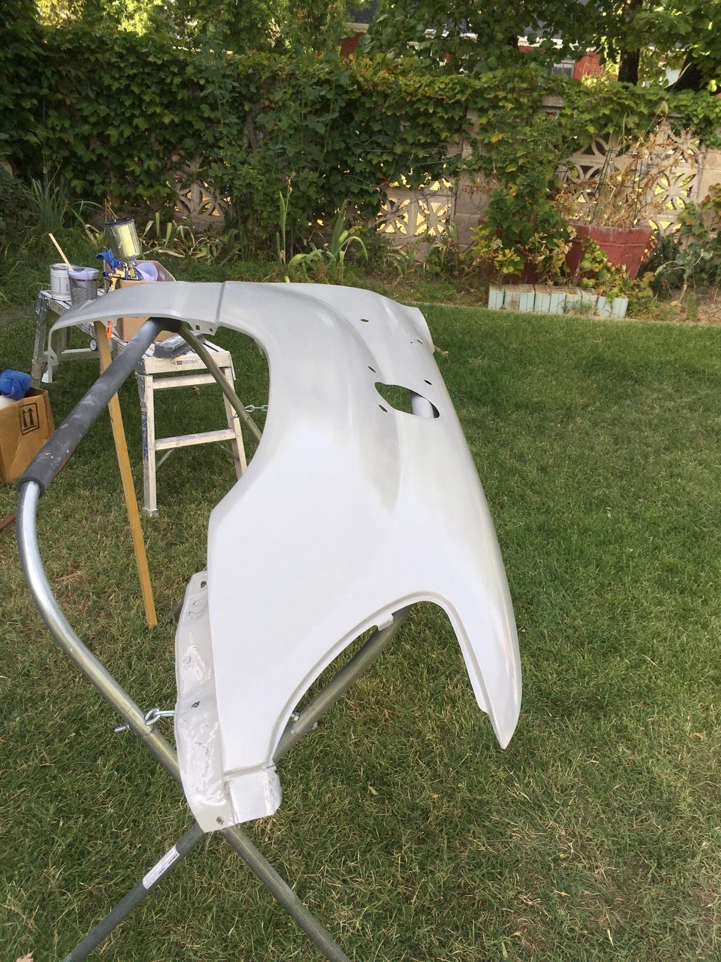

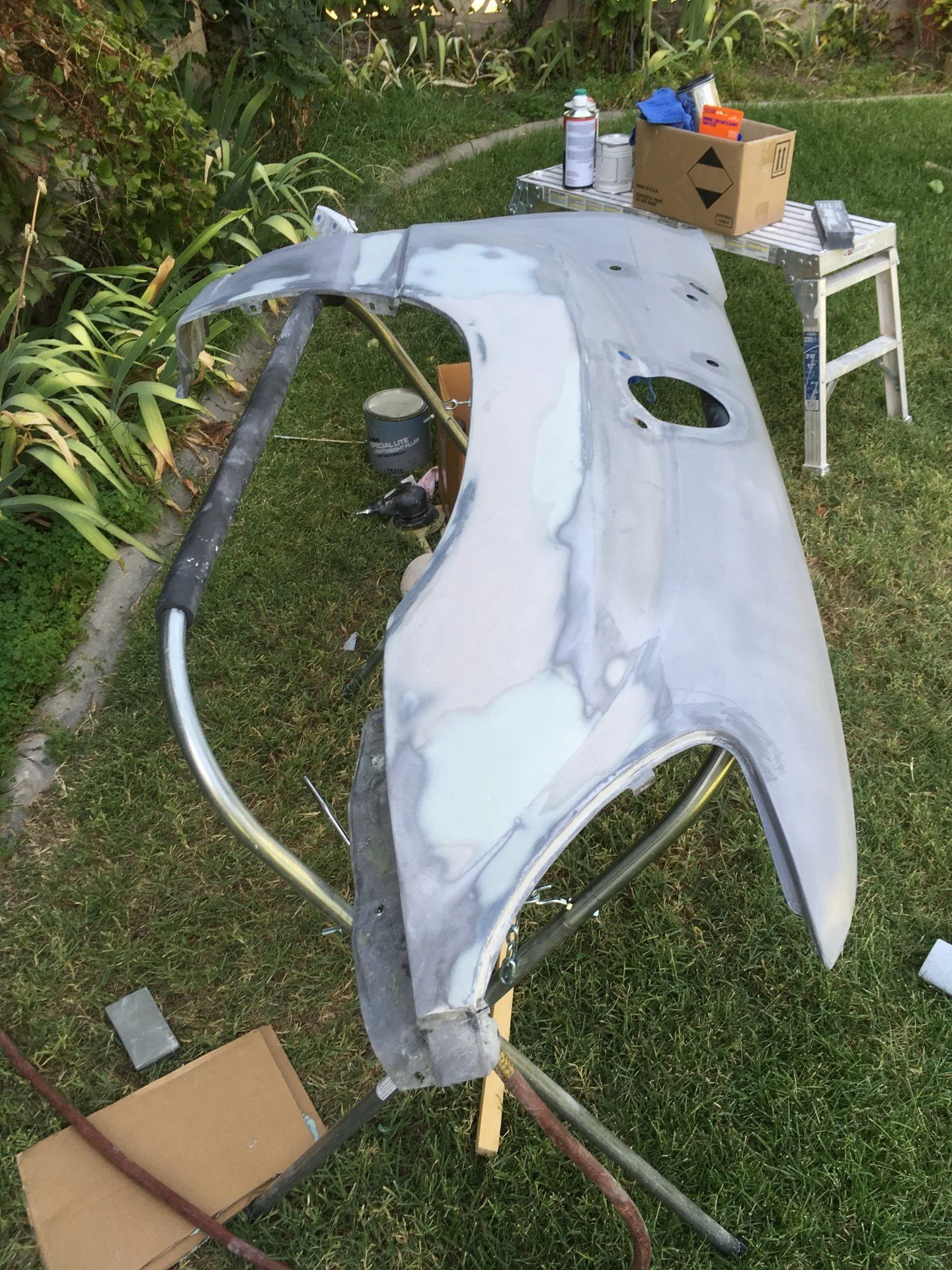

I have been pulling parts off here and there when I have some downtime at work and caught the sandblaster at the perfect time and he blasted it while I waited! he told me there was a fair amount of body filler in the panel along with a few cracks. last night I welded up the cracks and decided to ditch moldings so I fill those holes as well. rather than weld them shut and deal with warpage and everything I did it just like I did on my 80 when I deflared that and put a couple of layers of fiberglass on the back side and filler the front. it won't be a perfect body job but it will be good enough to hide behind a kangaroo bar.
once I have this side done and ready for primer I will pull the other side and get it preped ready for the base coat and so I can shoot at the same time. prior to the clear coat, I will wet sand the hood and then clear everything together. hopefully, it will all match! I am sure it will be good enough for me.

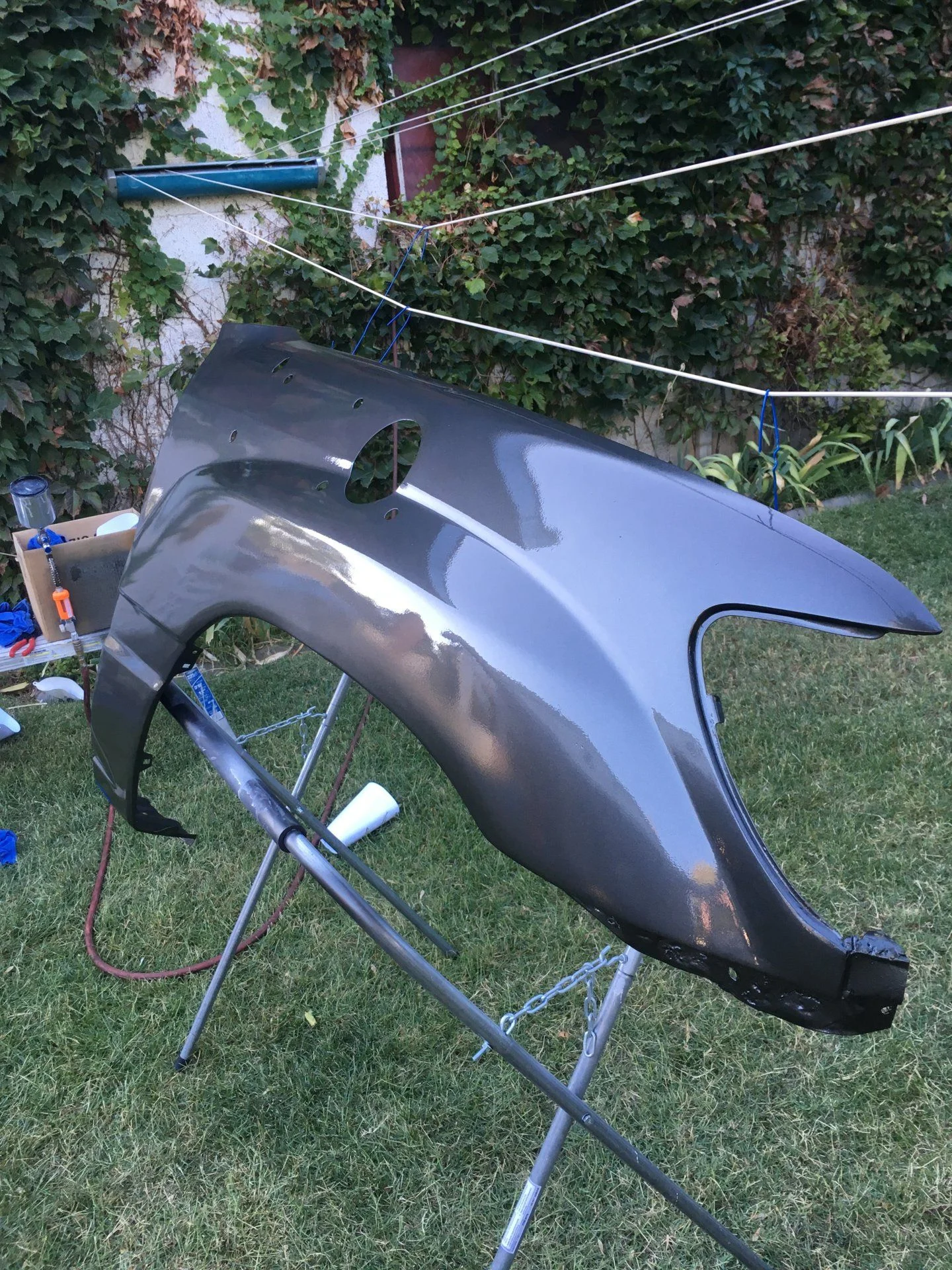

I was able to sneak some time in yesterday and mount the fender after letting it cure for an extra day. I think the paint is still a little soft and working around the roo bar was a pain, I tried to take to off but it was not cooperative. i took a few shots during the painting and then a before and after.
