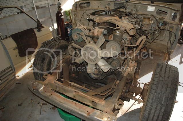

The front body parts removed, did this a couple days back.
The body is not connected to anything as well. Waiting till payday to get the hoist and remove the body, then on to a SOA, fix any leaks while body is off as well, probably rebuild axles while there out also.

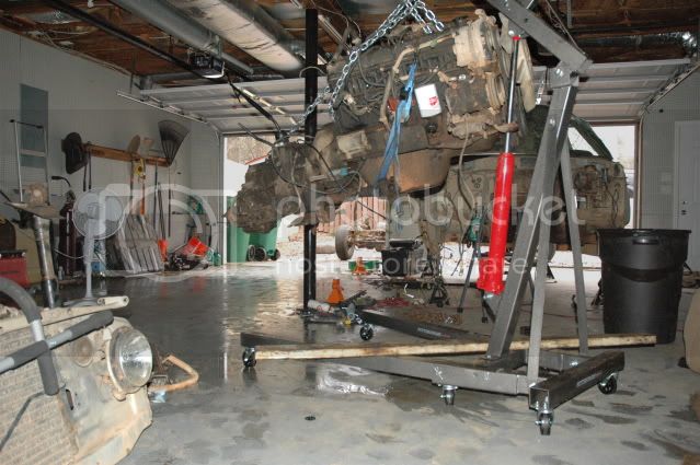

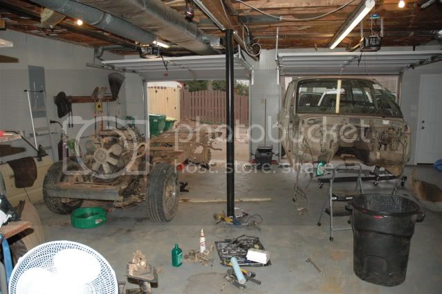

Well, the body is off!
Immediately after getting it off and out of the way!

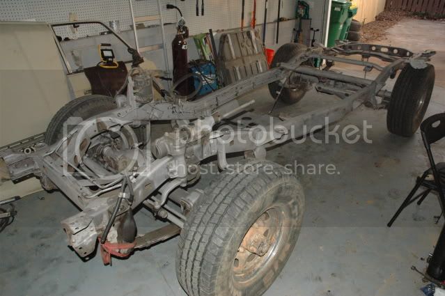

After Washing the Frame.
So, this is something that should NOT be done by yourself. It is clearly doable, but holy cuss it is no fun. So after getting it off and washing the frame, I gave the frame a good once over to look for any problem areas. NONE, the frame is in great shape, a little bit to clean off all the grease and then another coat of paint, itll be good as new. Then I took the front bumper off, as I'll be making my own. Then started in on taking pieces off the front axle to begin the SOA. Going to call ACC in Atlanta tomorrow to see if they have any of the parts I need to do it. If anyone is in reading this that lives in the Atlanta area and wants to come help. Id be more than happy to provide beer! Also, anyone need rear windows? I have two for sale.

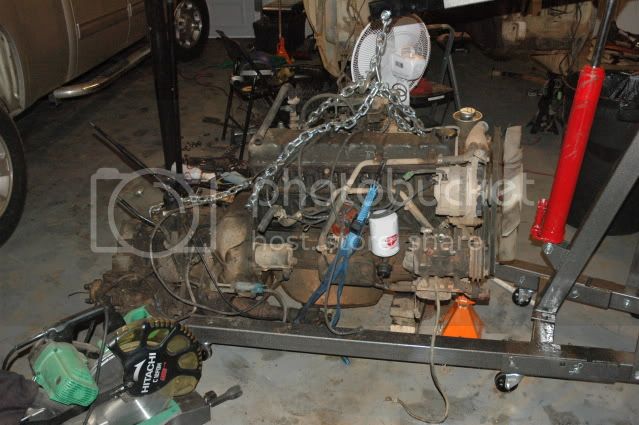

So I didn't get a whole lot done today. I fought with pulling the motor all day and finally got it at about 3pm. Then I began wire wheeling to clean the frame. That didn't last long as I am tired of using a grinder. I called the shop up in Gainseville that quoted me 150 for sandblasting and asked when the closed..... They were closing in minutes. But the guy offered to stay. I expected to be there by 6pm. Didn't make it till 720pm. The guy was cool about it the whole time so props to them. Looking at the stuff they had sitting there it looks like it will be money well spent. I'll let you know how it comes out when it's done. But that's all for today. Plan on pulling the valve cover tomorrow and possibly the head. We'll see. I'll post pictures tomorrow as well, because I can't do it from my telephono.

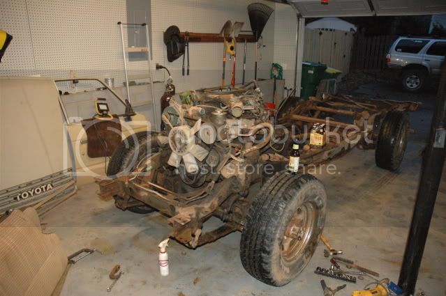

Then put it down, left to go find a trailer, and boogie over to the sandblaster in Gainseville. Snapped this just after getting the truck in the garage and heading in for the night.

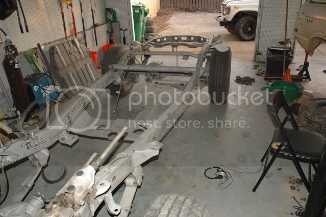

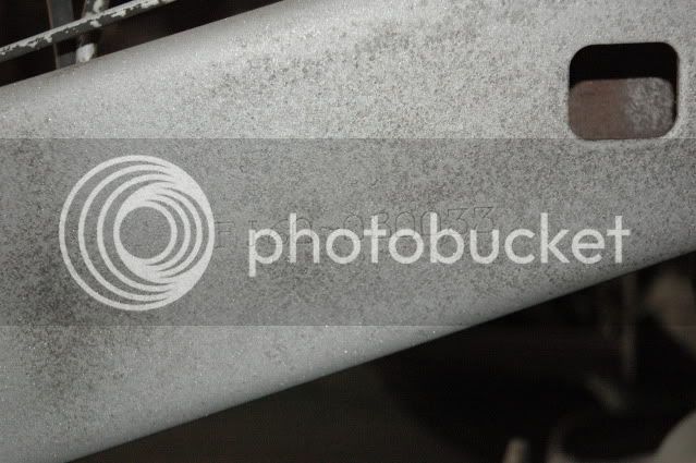

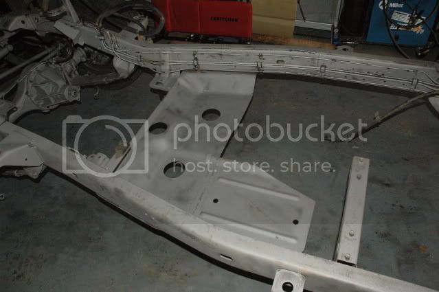

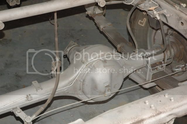

So, I picked up the Chassis today. I would first like to say that the guys over at Alison's Sandblasting in Gainesville GA are pretty awesome. One of them waited until well after 7pm on last friday for me to show up, then told me they would have it done sometime mid next week (this week). Then on monday at about 2pm they called and said your chassis is ready, wow that was fast. Then I figured out my trailer situation and went up there today to pick it up. Thanks to Don a friend from church (if you ever read this) for the lending the trailer. The chassis turned out real well. There were some spots that could have been a bit cleaner but for the price, it is awesome. So, if your looking for a blaster in N. Georgia, I highly recommend them, oh and they qouted me 400 to do the body. Now I apologize for not having any real good before pictures but heres what I have.
Before
And After
