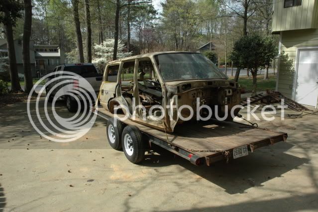

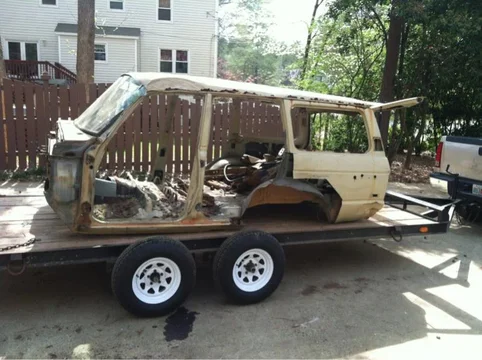

Yesterday was a relatively big day, I cut out some patches of rust free metal, and then carried away the body.

Realistically, it's not as big a milestone, but I think for the psyche that moving out that body is a big step forward. Congrats on the progress!

RJ, your absolutley correct it isn't a real big milestone, but damn it feels good to have it gone, it was doing nothing but taking space. Yea I'd probably have been around this weekend, next weekend maybe not though, we have a race on saturday and then church activities on sunday morning. Actually we may be free both afternoons. Let me know on Friday, and I will as well be able to tell you yes or no. Also, Im home most days of the week so if you want to swing by in the week thats cool too.
Now for the pictures of the body going away and the places I cut out the new body patches.
On the trailer to a better place :)

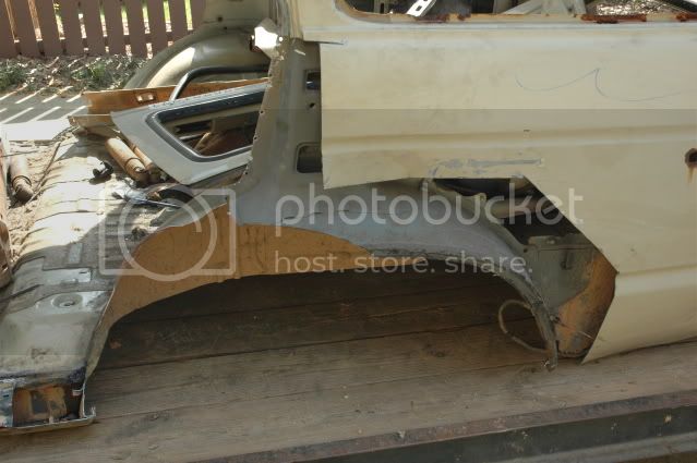

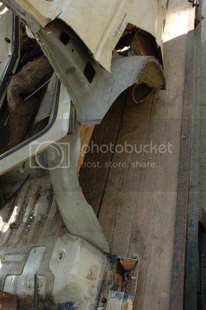

Passenger Side Patch hole

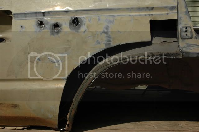

Driver side patch hole.
The driver side is a bit large, but the body has some serious ugly on it right there :crybaby:
