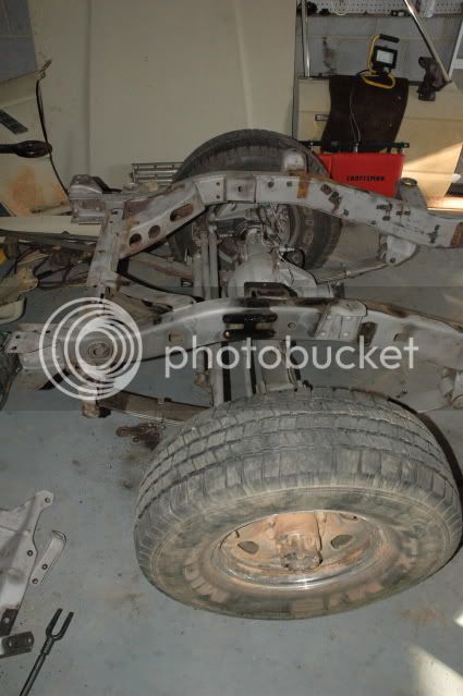

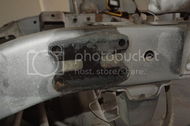

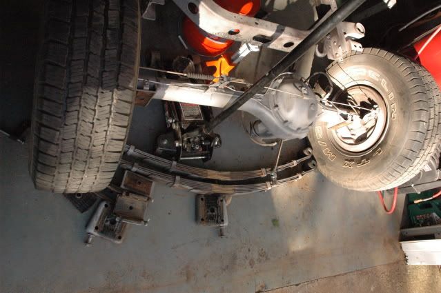

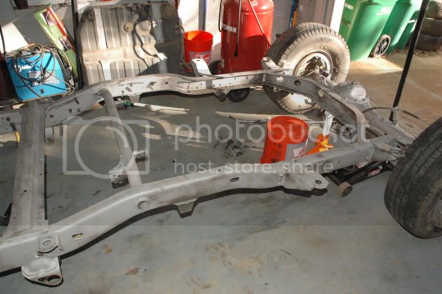

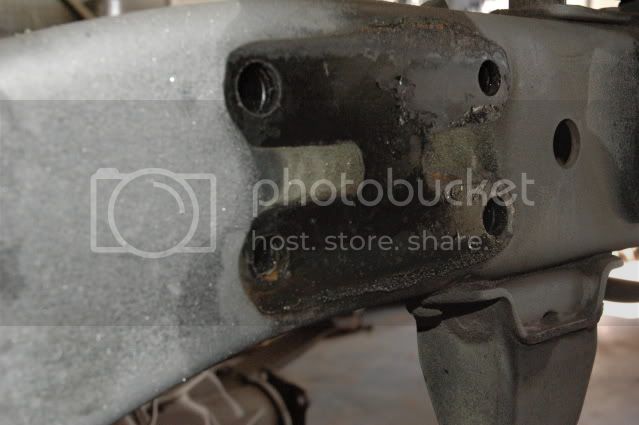

Now for an update. Saturday afternoon, I begin to finish strpping my frame (does that make sense:confused:), the only thing left on but the bolts are half out, if the front axle. When pulling all the pieces off, I was amazed to find parts of my frame with original paint. It made me extactic to see that, and the frame at those points was beautiful. Which, helps me know that this truck is AWESOME. Anywho, heres the pics, and I will be getting the front axle off today. Then waiting til wednesday and then its paintin time :bounce: at least for the frame!
Everything except the front axle removed
Shots of the perfect frame spot
Front end
My end result for the few hours of work on Saturday

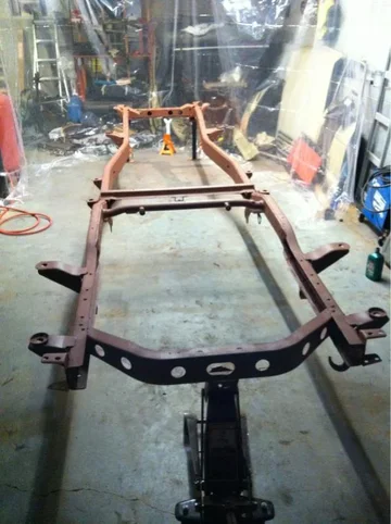

Well, today was productive! For starters Kem Kromik from sherwin Williams, two thumbs up. Ask me in a year answer may be different but the application of it and the out come of the first coat is awesome. We started by cutting the two diagonal pieces off the front of the frame so they too could be cleaned and properly painted, as well as that portion of the frame. Then we ground the hell out of the remaining areas that needed to be cleaned, it was looking good. Last step was to give it a good degreasing bath (still find it odd to wash metal with water). I used some TSP from sherwin Williams as well. It worked wonders. Now began the fun part spraying, something which I have NEVER done. It went well. Tomorrow I'll put on another three coats of primer, then a top coat. I decided on an industrial top coat enamel from sherwin Williams. It was a good price and it's readily available. I'll post more pics tomorrow, as I'm on my phone, but here is one I took!
This is after the first coat.
