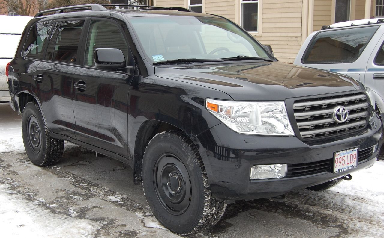

exactly- whats up with that Bumper missing? just what are you doing up there in blizzard country
your black accented front grill looks nice
@bjowett
Did I miss the reasoning for building the steelies? Load capacity, size and or offset advantage. Or just for the personal desire?
Probably to get the 200 to look sexy ;)
The bumper is partially designed. I need to order more parts/material and then take a trip to the water jet cutter.
I've always enjoyed the utilitarian look of the original 15" cruiser steelies…. so it's really just a desire to connect this vehicle to its past.

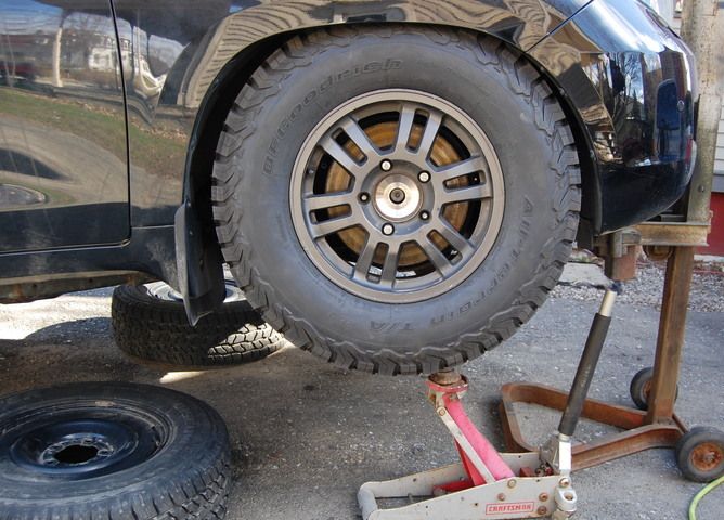

The Tundra arms are bolted in. With the TRD Rock Warrior wheel and 34/10.5r17 BFG AT KO2, the tires just tuck into the fenders on full compression. Will it clear with the wheel turned? Ehhhhh, probably not, but I may have a solution for that. Anyway, close to 12" of travel is very do-able on this truck with the right combo.
Pics or it didn't happen ;)
Looking forward to more info!
