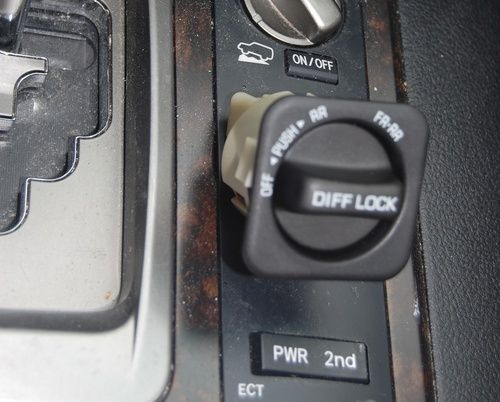

The braking of individual wheels is also the CRAWL system.
Yes, CRAWL is like a low speed cruise control, but it regulates the amount of slip allowed at each wheel.
When that allowable amount of slip is exceeded, CRAWL brakes the slipping wheel and directs torque to wheels that are not slipping.
All that within a certain speed range selected by the five position rotary switch.
Most videos of CRAWL in action show a LC200 making it up a rocky slope at a steady pace with the driver having to do nothing bu steer. While this is certainly one use for the CRAWL system, I think it seriously understates the capabilies of the system and misleads us into thinking of it as something a neophyte might use.
In my view, the greatest advantage of the CRAWL system is in freeing a stuck vehicle. When totally bogged down in sand, for example, engaging CRAWL mode will allow the vehicle to free itself when, arguably, it could not have done so in the absence of the CRAWL feature without the help of another vehicle or a winch. It does this by controlling the amount of torque delivered to each wheel independently based on the amount of wheel slippage at each wheel.

And, you guys are all correct about the CRAWL. It basically uses all the other systems in the truck (ATRAC, Traction control, ABS, etc) to assist with rough terrain or to get the vehicle out of a situation like the sand. It's well beyond my technical ability to fully explain how it works but it does moderate throttle and use brakes on individual wheels to accomplish this.
And it works awesomely. I got stuck quite a few times in the Imperial Sand dunes near Glamis. Each time I activated CRAWL control and sat there while the truck un-stuck itself each time. I didn't get to use my shovel or Maxtrax ;)
