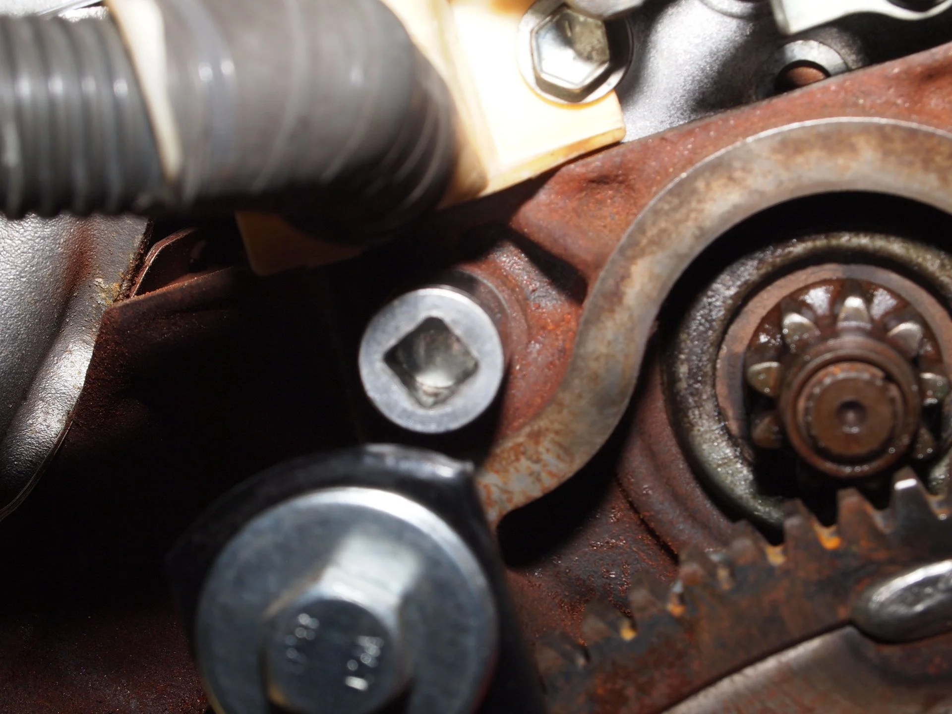

So I used one of those cheap scope things to take a picture of the driver side starter bolt. There isn't enough room to get a quarter underneath the bolt so question is did you guys just use a crescent wrench? There is no way even a thin walled socket is going over that.

I used a socket.
Unless you've a non standard transmission (which I doubt) a socket will fit.
Notice it's and extra long head on the bolt.

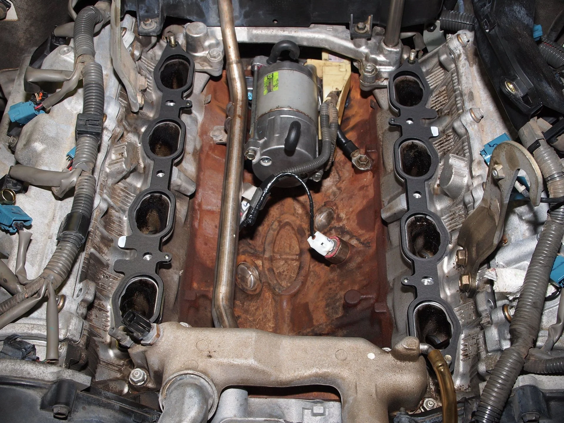

I don't have a transmission on at the moment, in these two shots. But you can see a 14mm 3/8 & 1/2 sockets on the bolt.
Take a socket and reach back there and put it on. It will fit!

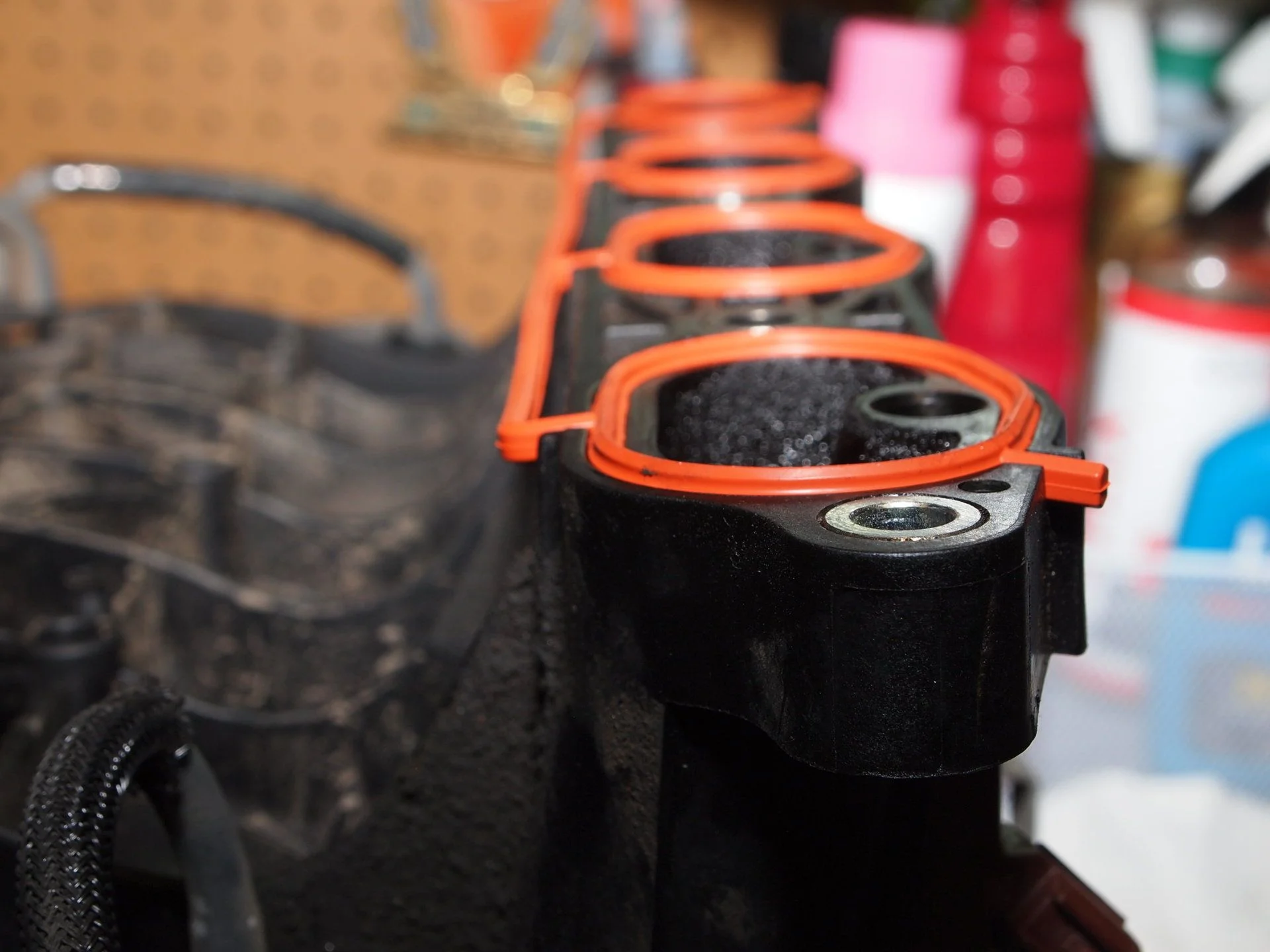

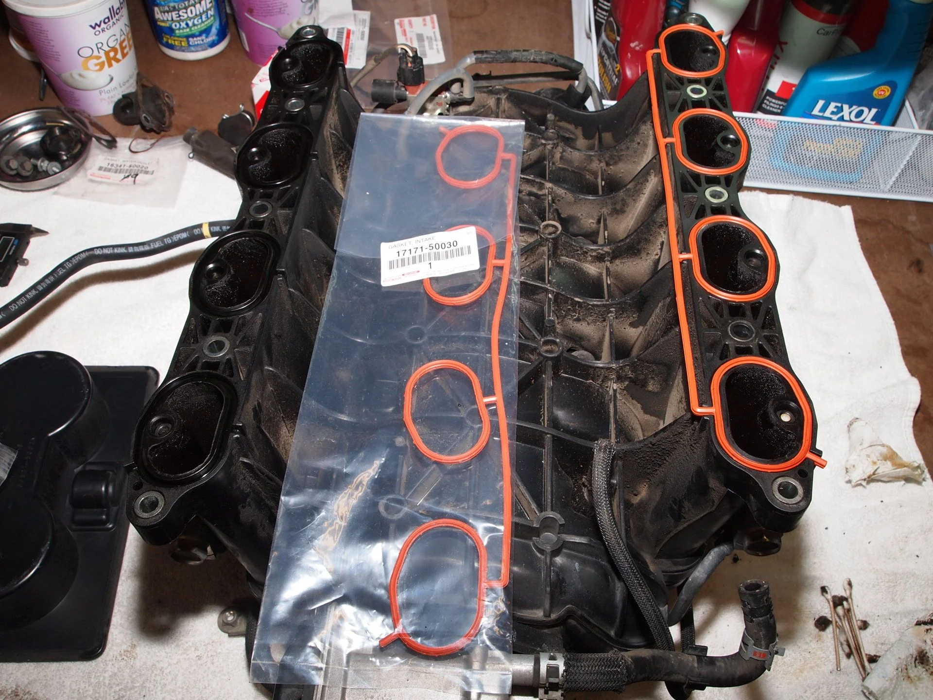

The 06-07 VVTi 4,7L use a plastic intake manifold with a rubber gasket that fits snugly into manifold.

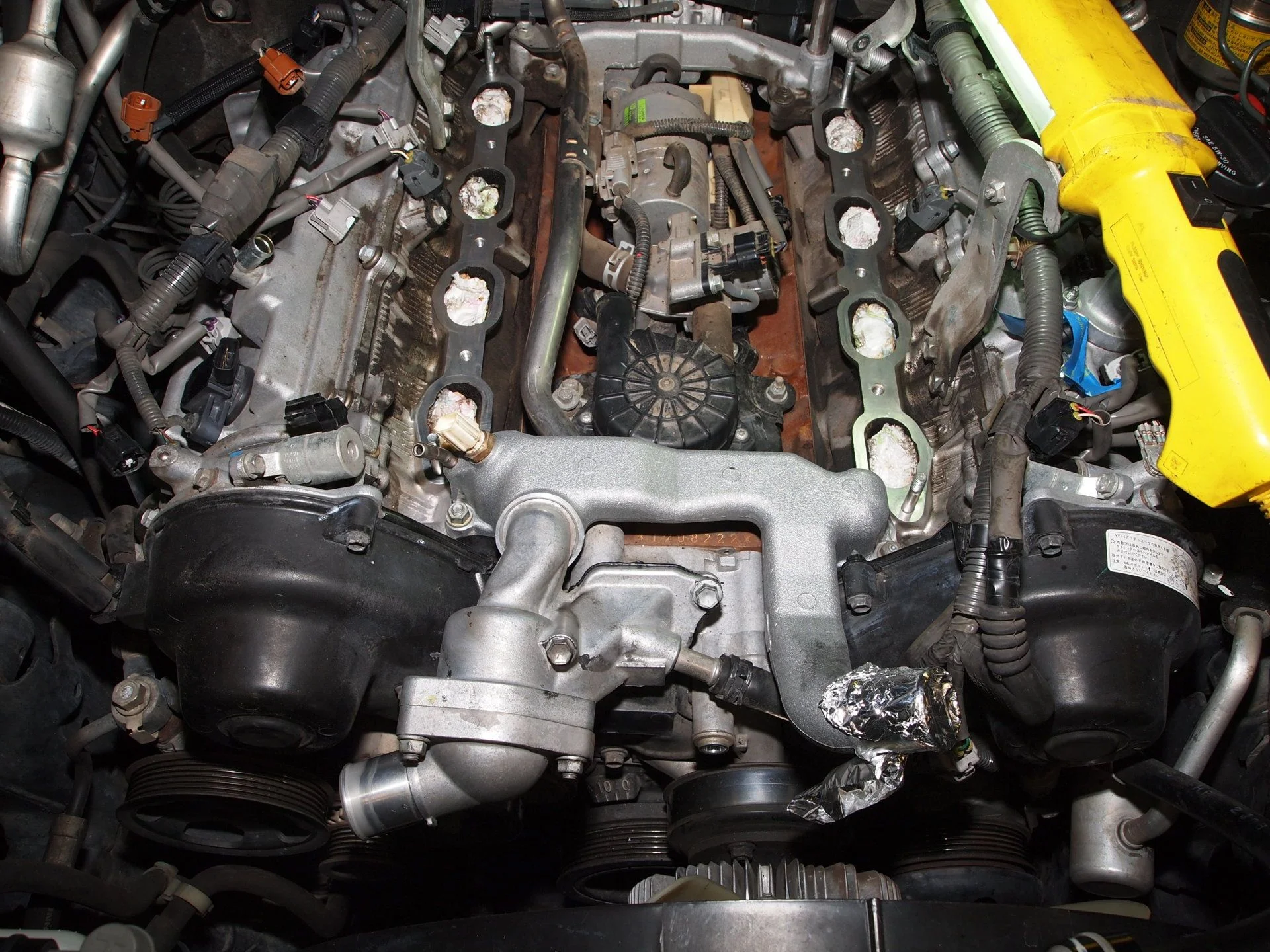

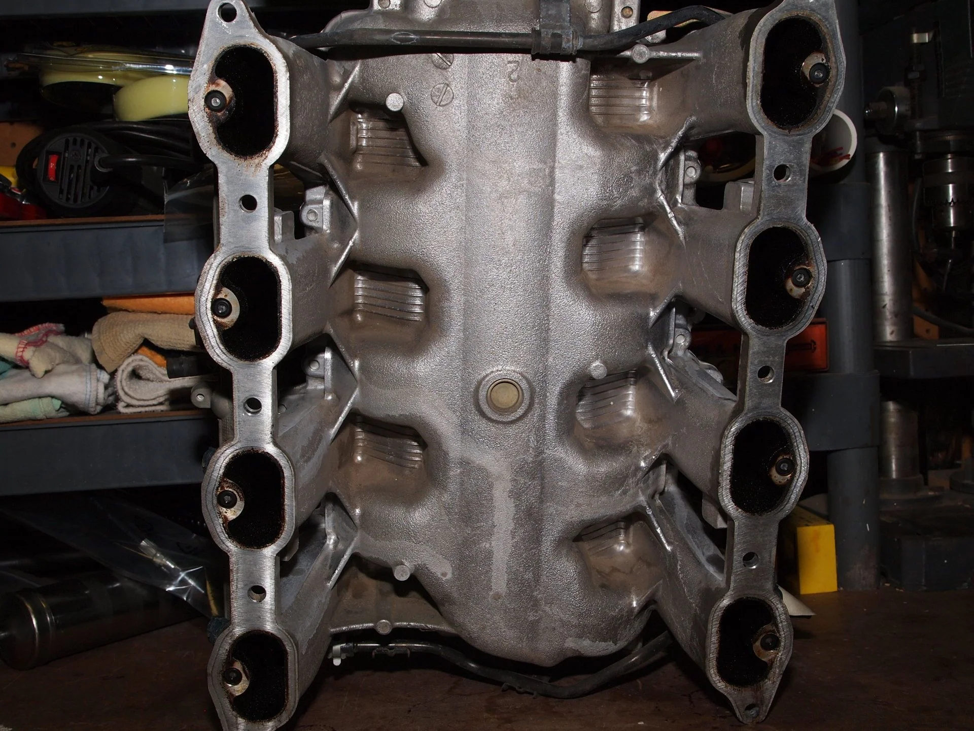

98-May 05 have aluminum intake manifold that uses two hard gaskets, one on left the other on the right (3 piece, plastic/composite samwitched in metal)

Intake manifold has two gasket one on left the other right. No need to buy extra!

I should have been clearer. I got two sets of gaskets (each set has two gaskets - one for each side) in case I pinched one or otherwise damaged it trying to lower the manifold into place. Turns out that was an unfounded worry, as the installation went smoothly.
