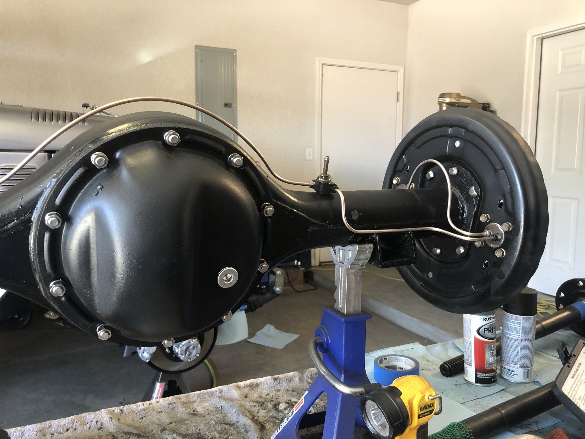

My rear axle is almost ready to go back in the truck. Stripped down to bare metal with a wire wheel, primed and painted. All new studs, nuts, bolts for the diff and diff cover. Made new brake lines out of NiCopp.
New wheel bearings, seals, and Nitro semi float axle shafts to replace the corroded originals. Should get back on the truck tomorrow....
Damn!! Those brake lines look great! What did you use to bend them up? Did you get yourself a flaring tool as well?
Edit: see the flaring tool in the pic now.
I actually got the idea to use NiCopp from one of your posts. Most of it I carefully formed by hand. For the tighter bends I used a 1” socket held in a vice to bend the material around. I have a HF flaring tool that works good. NiCopp is so easy to work with that it makes you look like a pro, lol.
