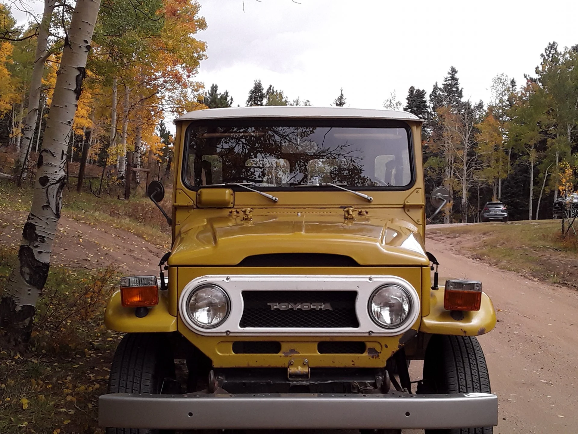

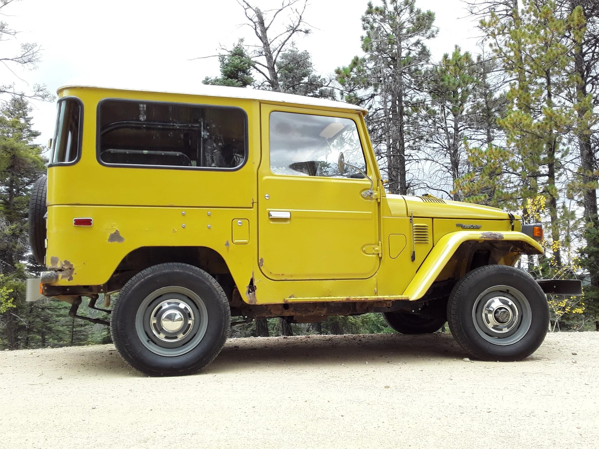

Color balance.
Same camera, same day, same truck, below.

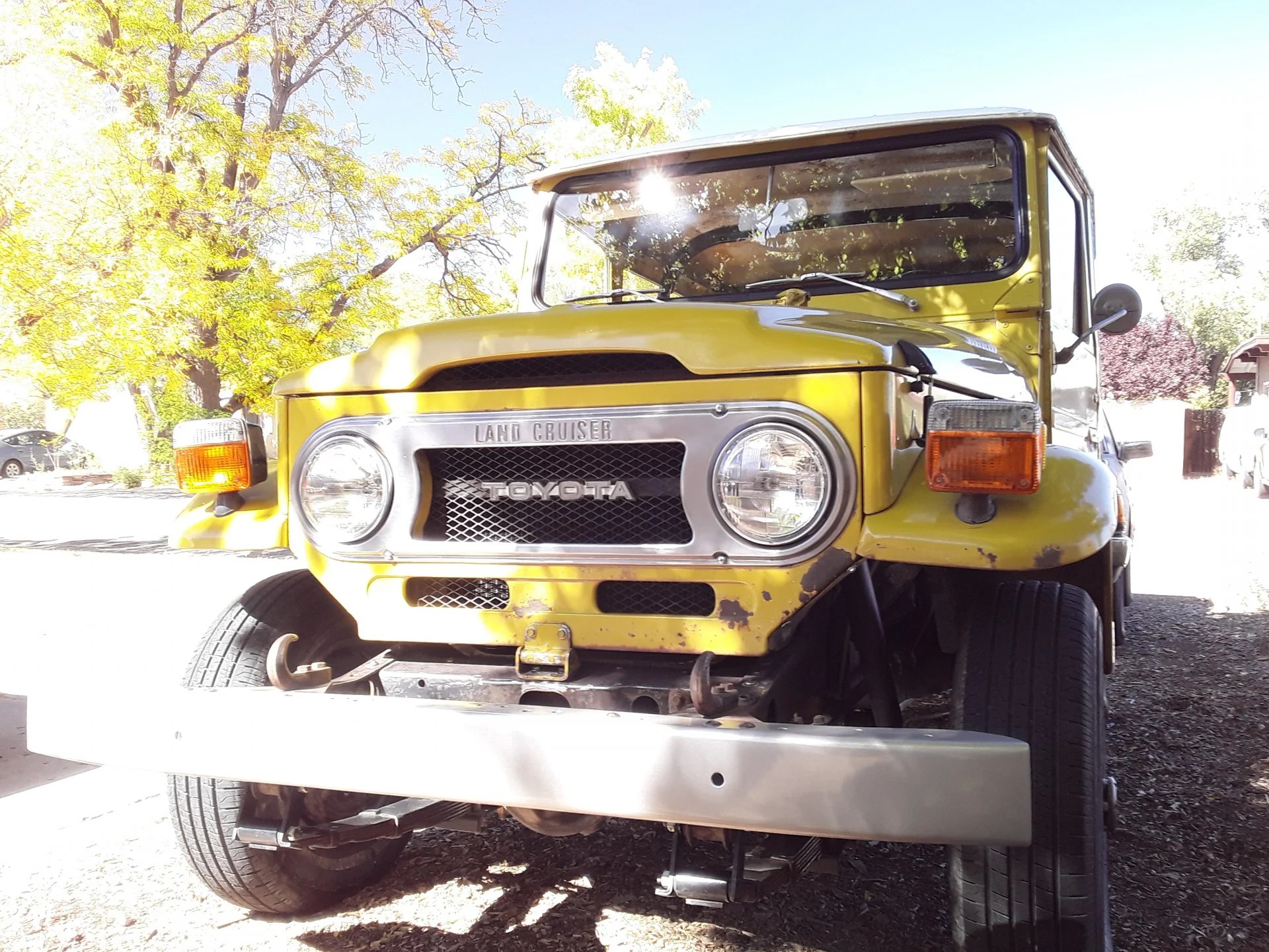

I thought that I'd share some science with this thread. My bezel is too white when I bought the 40, something is off.
So, here is a reproduction stamped steel bezel. I just finished removing all of the green paint that it came with using 220 wet/dry paper, some wire brushes, even a razor blade and a file at times. After stripping all the paint, I applied Boeshield first, then I got a can of Fluid Film, at O'Reilley's, applied that with steel wool and a paper towel. I'm going to maintain it in a shiny state, but, that doesn't mean that I won't let it rust a bit.

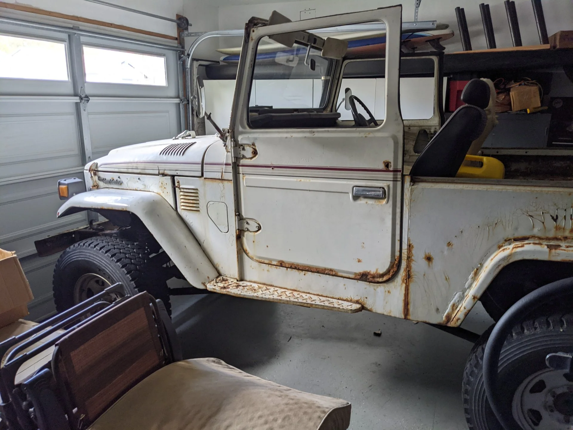

@ wngrog …on post # 5 you treated this window area. I have some rust coming in on the dash and other areas surrounding the wind shield frame. Im going to drop the windshield, replace the rubber and treat the rust. CLR scrub then Penetrol on inside dash. penetrol outside.
im thinking a combo of fluid film and Penetrol in the joint where the rubber gasket goes.
your thoughts?
If your pulling window and rubber might as well fully treat it, i.e repaint out to the rubber edge.
I am not pulling the window, I am folding it down to inspect the cowl/window frame junction anticipating rust based off what I have seen in the photos above. I live on the beach in a salt air environment which I realize isn’t the best. I love driving a 40 and am very much interested in keeping this one preserved. While I did paint the hood, bib, fenders that was primarily to have a color matched vehicle. Also gave my son some experience with paint and body work. End goal @wngrog is much the same as yours …..mechanically sound beautiful, blemished, Landcruiser

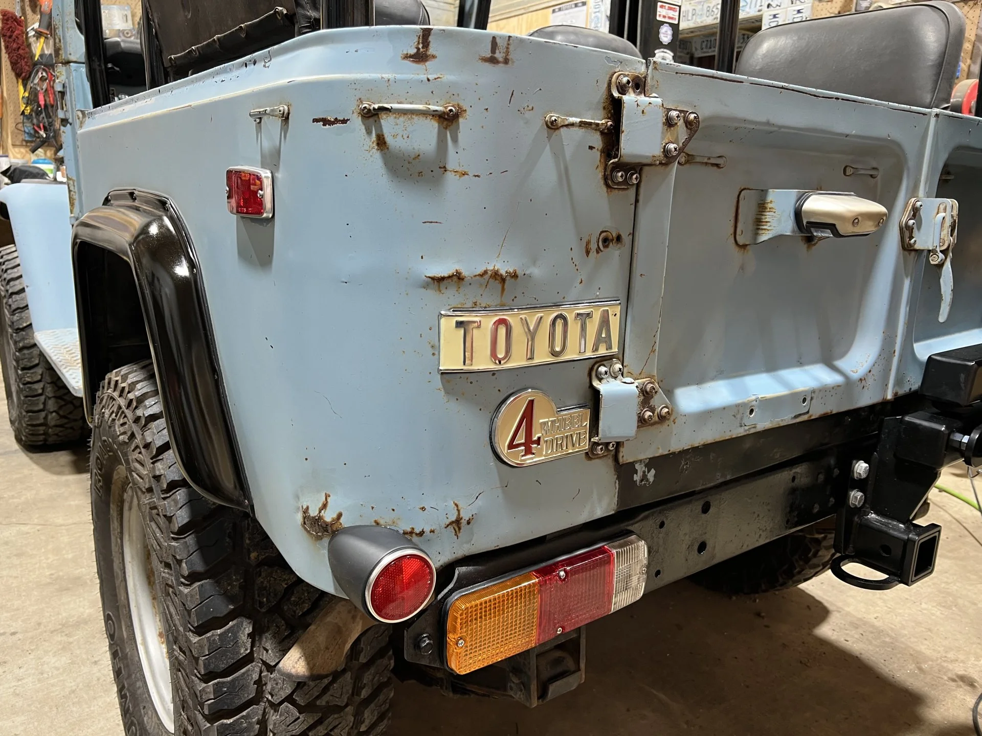

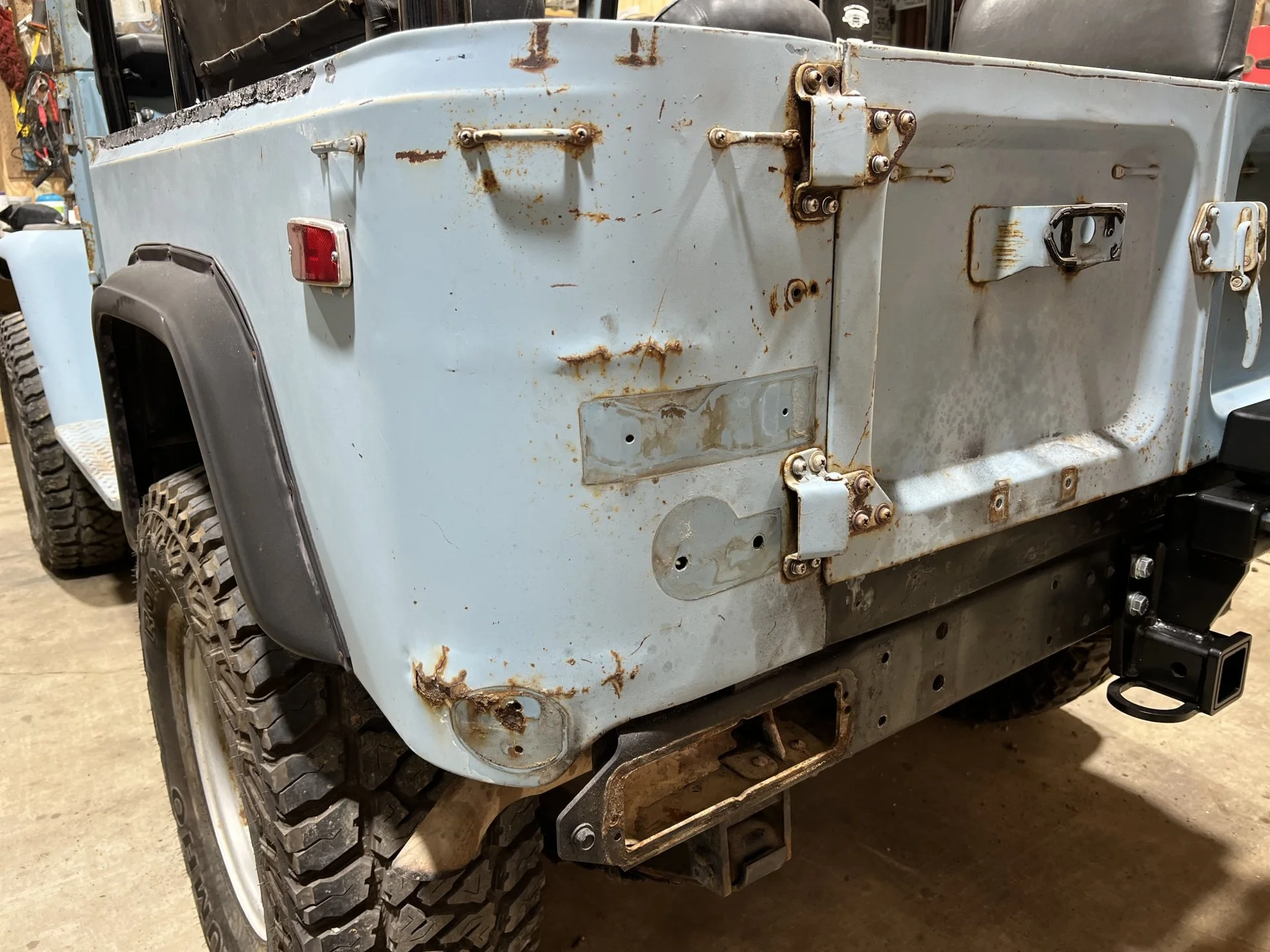

New challenge. Prior owner said they “clear coated” over the patina but whatever this s*** is it’s got the texture of sand paper. I was able to get it semi smooth with CLR and scotchbrite. Only did one fender. I’m dreading the rest of the job. I’m going to bite off a little at a time.
Build thread is Powda Blue 74
It isn't rattle can, right?
Try acetone?
Yeah. I’m working through my arsenal. So far it laughs at all the chemicals but yields to elbow grease
I’m not able to get all the way to the OEM single stage but the CLR and OO steel wool are able to get it smooth to take polish and wax. I’ve got the tub all done.

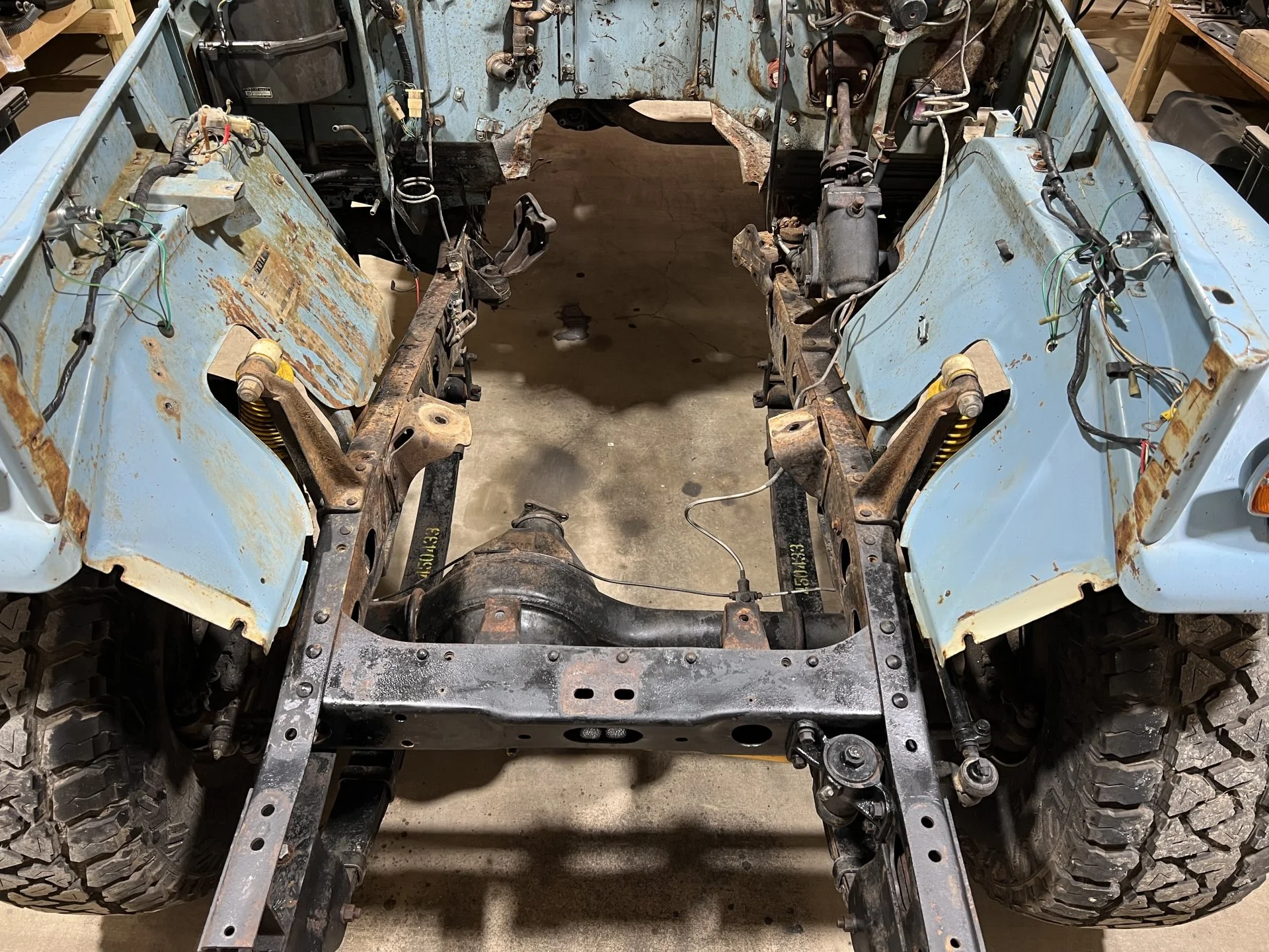

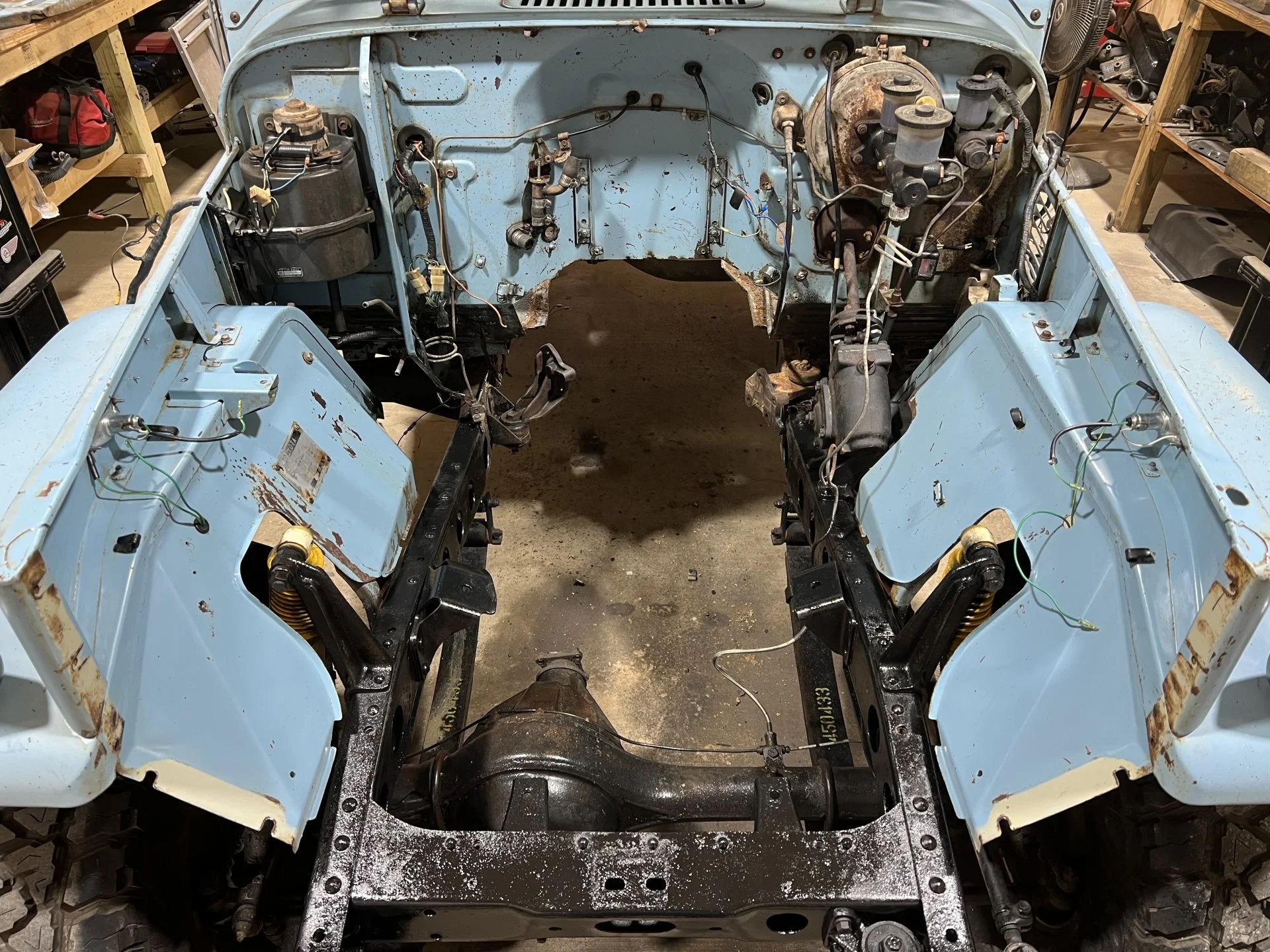

@wngrog : Question for you. If I use rust converter and then use one of your oiling versions, with this affect the ability to media blast, weld, and then prime and paint the tub in the future? I have too much rust in spots to be called patina, but I do want to stop any progression until I can commit to taking the body off and reparing correctly. Any thoughts or insights you have would be greatly appreciated.
oh yeah... I was more concerned with stopping any more cancer until I fully blasted the body. Thanks for the info... I didn't want to make the refinishing harder in the near future when I was planning on taking the tub off.
