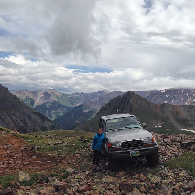

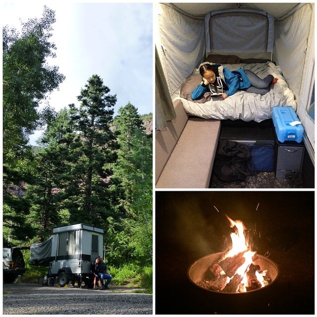

Camping in Ouray at Amphitheater

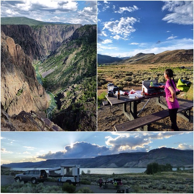

the black canyon and camping @ blue mesa reservoir
