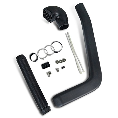

I am planning to prepare 44 for fording streams, etc. and am trying to determine just what I need to do.
First: I'm planning to install a snorkel... Using information posted by Alex (@SouthBostonFJ40 ), the actual snorkel installation will be pretty straightforward... Except: 44 will be driven primarily in the desert and primarily on dirt/gravel roads, or off-road. Many snorkel kits include both a Ram Air Intake Head and a Precleaner or Pre-filter and, yet, they suggest you install the Precleaner, in place of the Ram, if you drive dusty, dirty locations. I'm trying to figure out if there is any reason I can't take advantage of the Ram Air Intake Head (on top of the snorkel) AND the Precleaner. If I have room under the hood, I prefer to install the filter and the PreCleaner under the hood and the Ram Air Intake in top the snorkel. Is there any reason I shouldn't do that?
Second: I know I need to raise the differentials' breathers. That's pretty straightforward too... I'll route the two breathers a T and then to a single location, with a filter... Like the top of the engine compartment, where the stock air intake scoop is mounted. Anything wrong with this plan?
