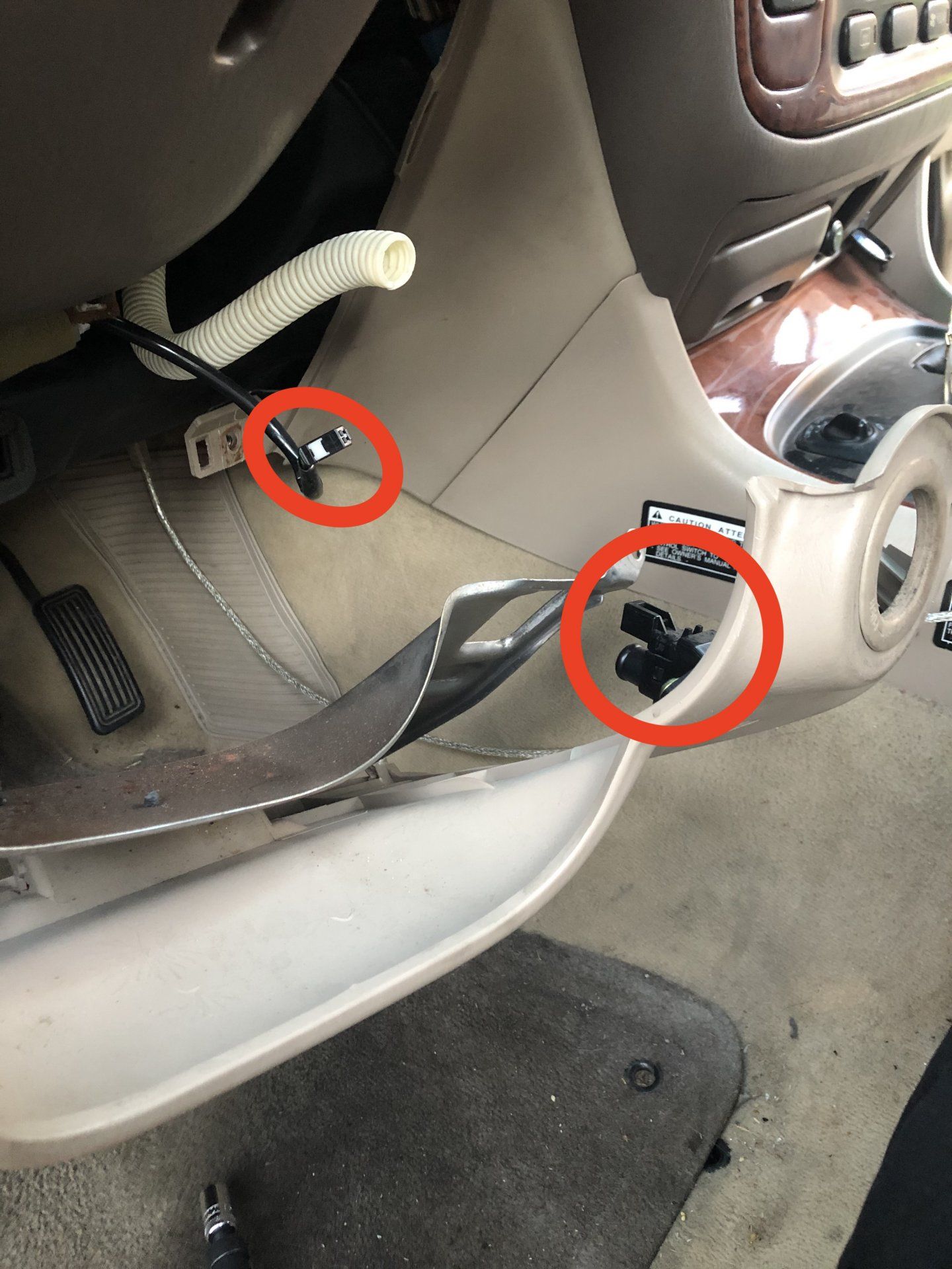

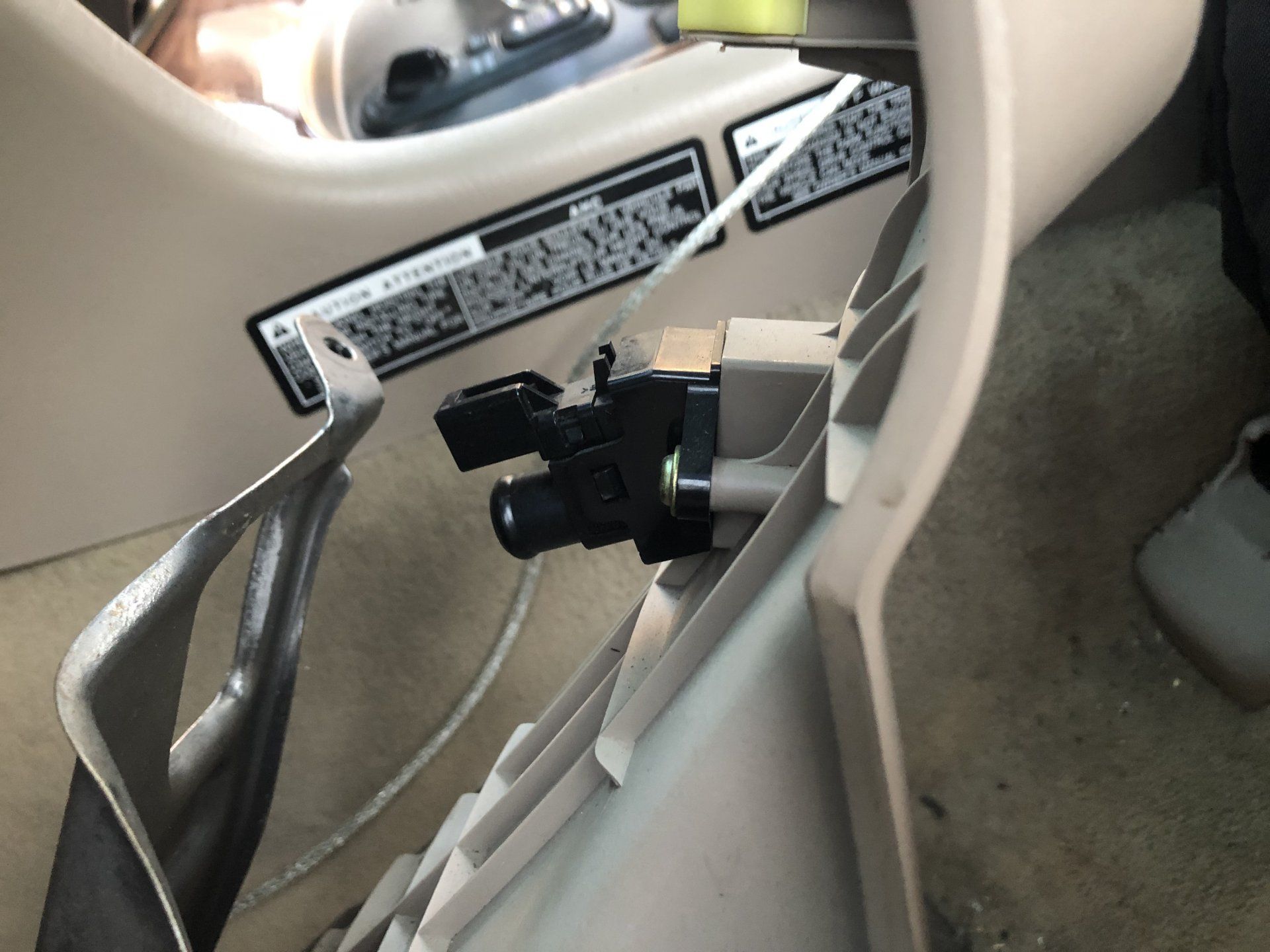

Success! Took me a while to finally get around to addressing this issue we seem to all have. Turns out my issue was that the inside temperature sensor was not connected. I disconnected it when I was replacing the master cylinder and must have forgotten to reattach the clip when I was putting the dash back together. I took some pictures to show the sensor and the wire. Maybe you guys have the same issue. Free fix!
