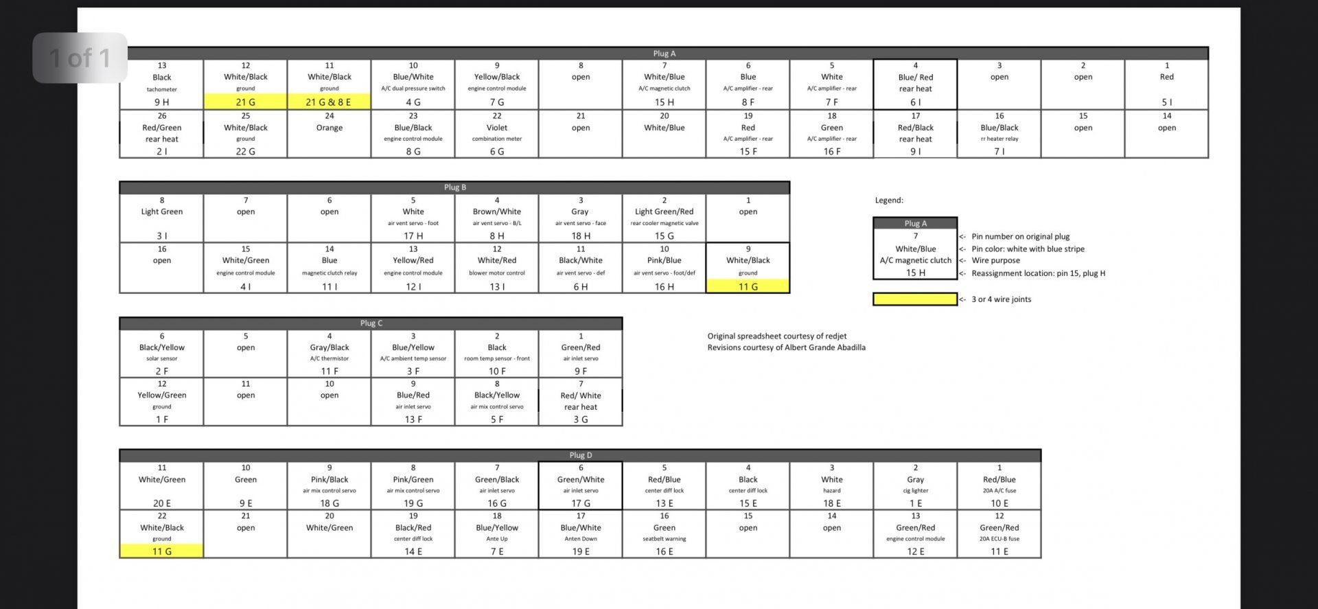

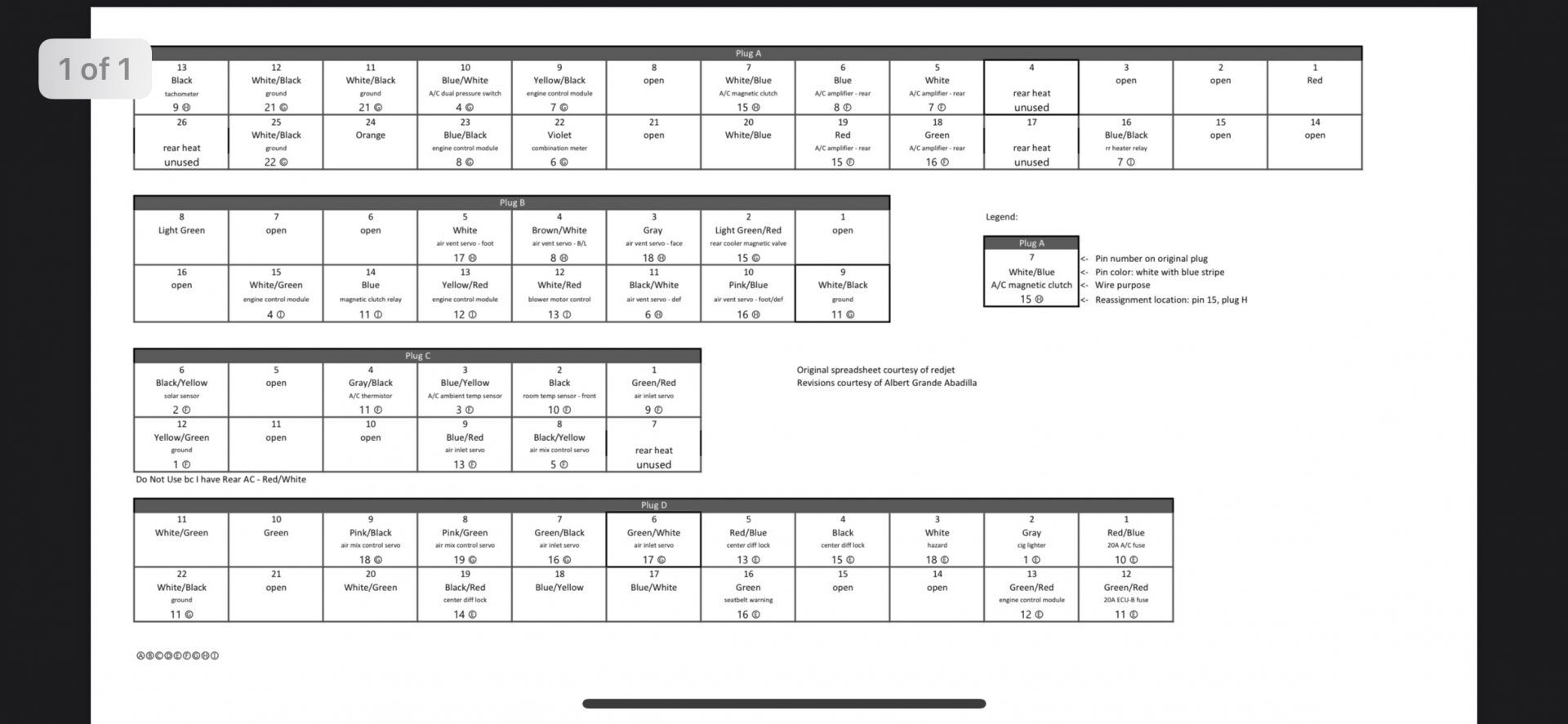

What problems from the initial diagram prompted a revision to the pinouts?

From what I remember, when I updated the Pin out, it wasn't to fix problems anyone was having, it was that the previous one had some hand written marks on it, so I was just cleaning it up and clarifying the 3-4 wire joints.

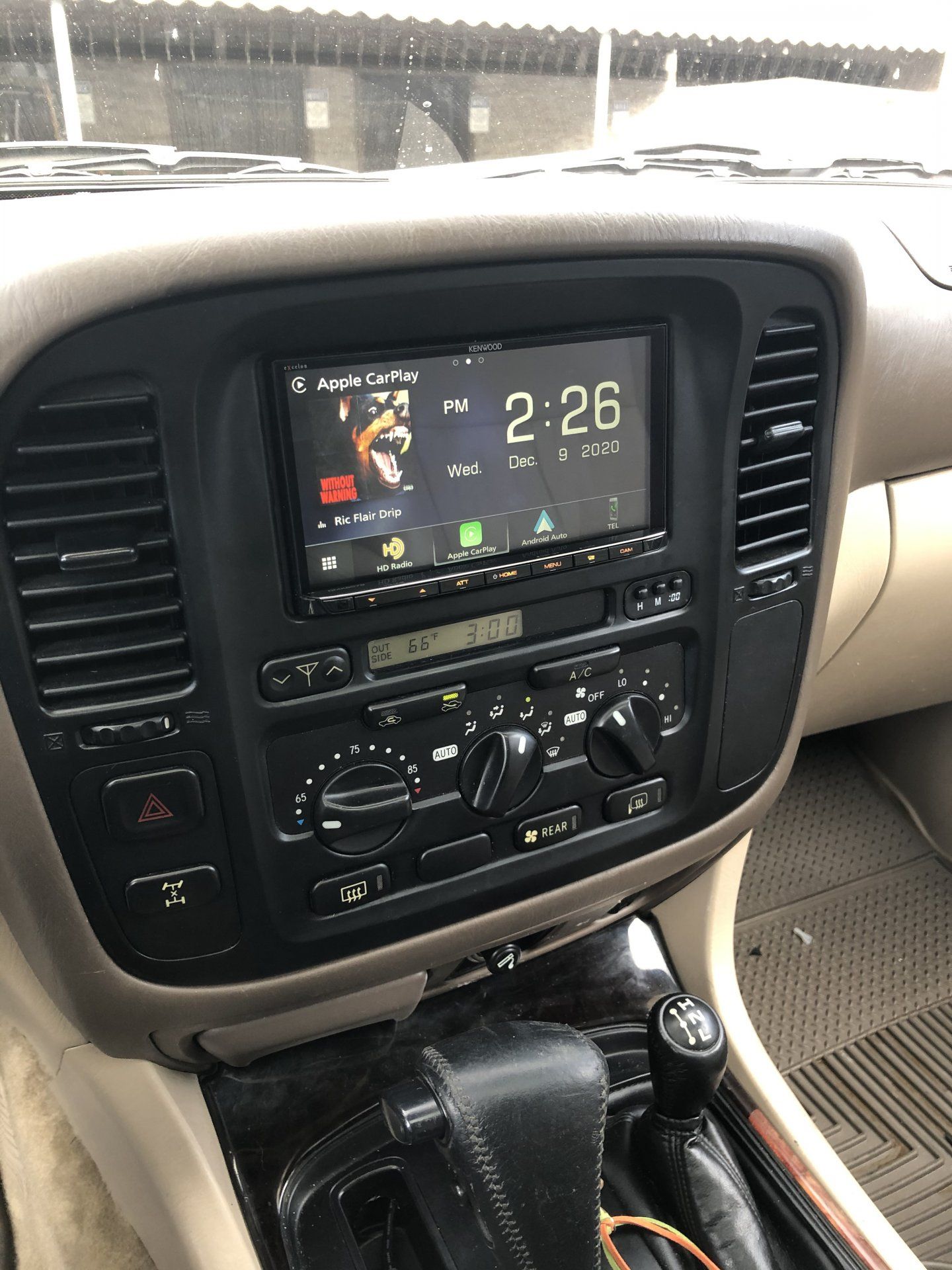

New to the mud crew. I gotta give thanks to the guys that paved the way to make this delete possible. I just did mine in a 2001 LC. I scored it with 150K 1 owner and garaged it's whole life, driven by an old couple. After driving it for a day I knew that old Nav needed to come out. Little google and stumbled on this thread. Called a salvage yard, they had the A/C controls and pigtails I needed. The control had wood grain, after removing the wood plastic and cleaning it up it was ready. Using the Pin diagram was easy and great. I did one at a time so I didn't get confused. After soldering all wires it was ready to test, everything worked right off the bat. I installed a Pioneer DHM-4660Nex for the HU and it works fantastic. AppleCarplay is unreal, I can't believe I lived in the Stone Age with my other radios. The Pioneer paired with the Metra harness was easy and straightforward. All functions worked including the Antenna. I recommend doing this delete, much easier then I thought and so much more functional. Thanks again to TXSunDevil and Patassa for helping and answering all the questions.

Do you have any before and after photos?
What was you cost outlay for the controls and for the radio, if I may ask?
