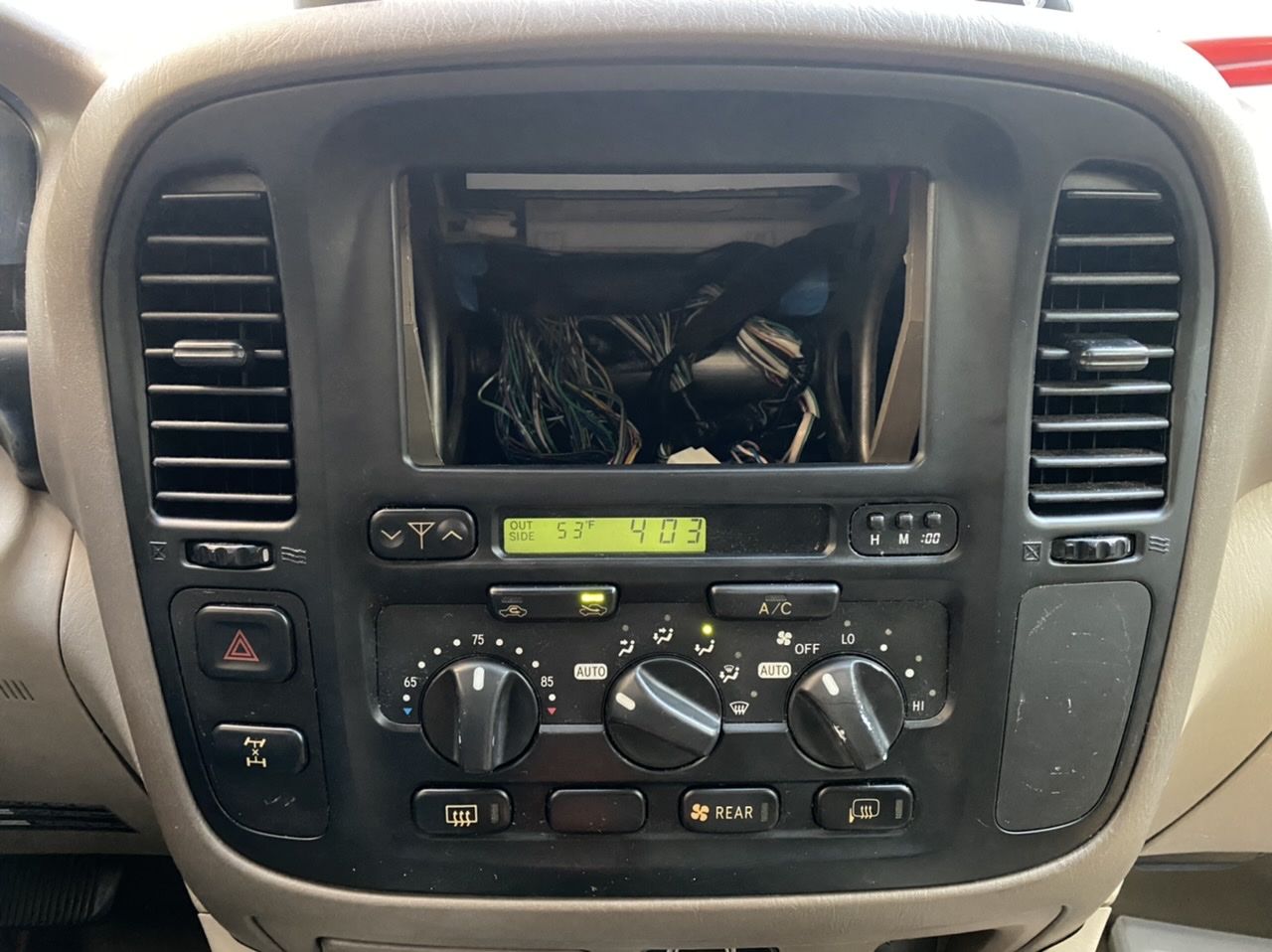

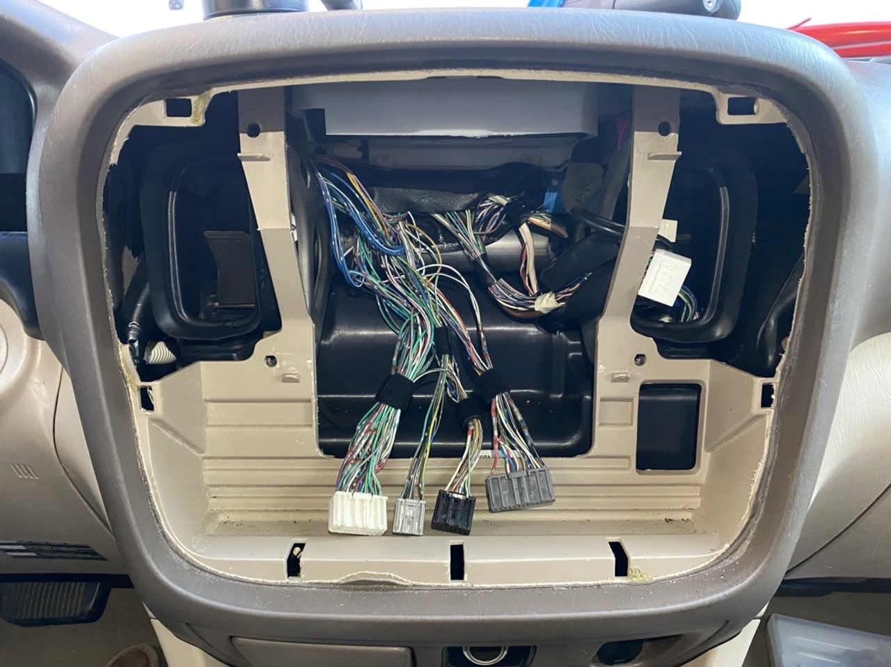

Yes, thank you for the reality check, I had it coming to me for trying. I will likely live with this for a little while and start the hunt for another. If anyone has a wiring diagram for the LX "E" plug lmk as a one switch difference is brutal to accept - See pic of E plug in LX. Meanwhile - defrost will act as my AC. - And let these comm's serve those in the future = you MUST find a matching control as stated previously by others. And if I find a way - I will share it with an update.

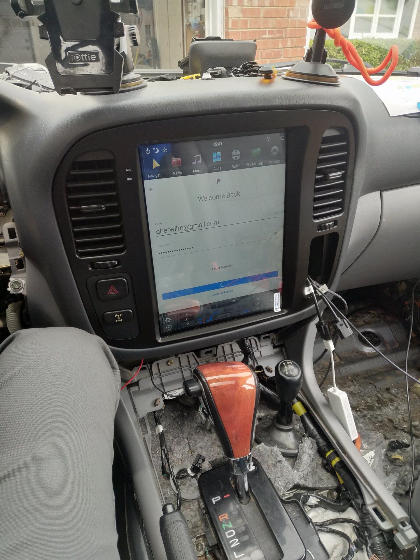

Hey @BillZ260 ! Im new to the website. I saw your pictures and if im reading your comments correctly you switched from a Nav system of an LX470 2002 to the Tesla style screen is that correct? If this is true man I sure hope I can steal a couple of minutes of your time and ask a couple of questions.
The fact is, since I bought my LX the screen was never working which got me to this thread after months of searching. So since I started reading from the very begining I figured that if someone was able to switch to non nav screen maybe someone was crazy/genius enough to switch to the Tesla Style. I even contacted the guys from Rhino Radio but once I sent them the image of my dash they said it couldnt work. (im guessing its due to the fact you first had to switch to the non nav wirring).
Basicly wanted to know if this is true (if I can purchase the radio from Rhino radios and make the swap). I figured that if buying the climate control on ebay plus the head unit was going to sum up to the same as the Rhino unit, I'd definetly go for the last one as you did. What are your thoughts on the radio? Any chance you could upload a video? Thanks for the help!

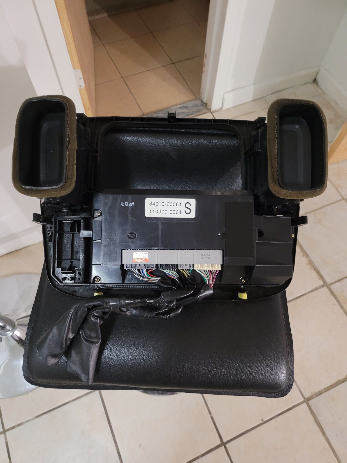

I had a friend help me who has the tool to remove the taps from the connectors and reconnect them to the spot where they go in the new connector. Made it so much cleaner and only had to splice a few of the wires as needed or were different sizes.

Answered my own question. It is pretty easy to extract pins with the right tool.
I know I will still have to splice a couple, but this should be cleaner than soldering every connector.

That was easier than I thought it would be! Still had to use about 10 solder connectors (including grouped grounds), because a few pins had different widths from old connectors to new connectors.
Everything is working great except the clock minute button (might need cleaning), and the A/C switch. Tomorrow I will double check my wires related to that.
For anyone interested, I ended up using a 0.9 mm extractor tool from Cycle Terminal. There might be a better tool, but I was still able to release the pins with this one after some trial and error.
Hey Mark what tool did you use to place them back? Did it give you a hard time? Is everything running good? BTW nice job you, really clean!
After you extract the pins using the tool, they just slide right into the new connector and snap into place.
There is a plastic “bridge” bar that locks all pins when you are finished with the entire connector.
Pay close attention to the pin width. If you look at the back of your new control panel pins you’ll see what I mean.
I followed the spreadsheet swapping pins, but a few “skinny” pins ended up in “fat” slots.
Those are the ones I had to reuse the original pins and do the traditional solder splice for.

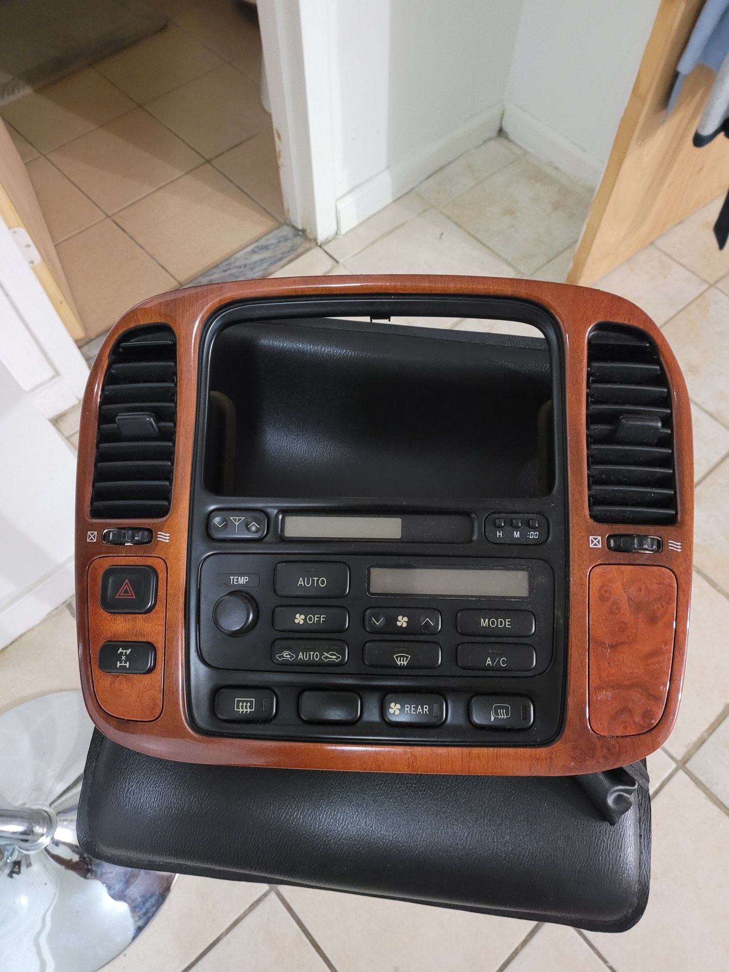

Nice! Good luck @dmark84. Also where did you find the wiring harness? Or did you happen to get it along with the dash panel? Looking for the wiring pigtails only but not easy to come by.
No, just get one that matches the buttons you currently have on your bezel
