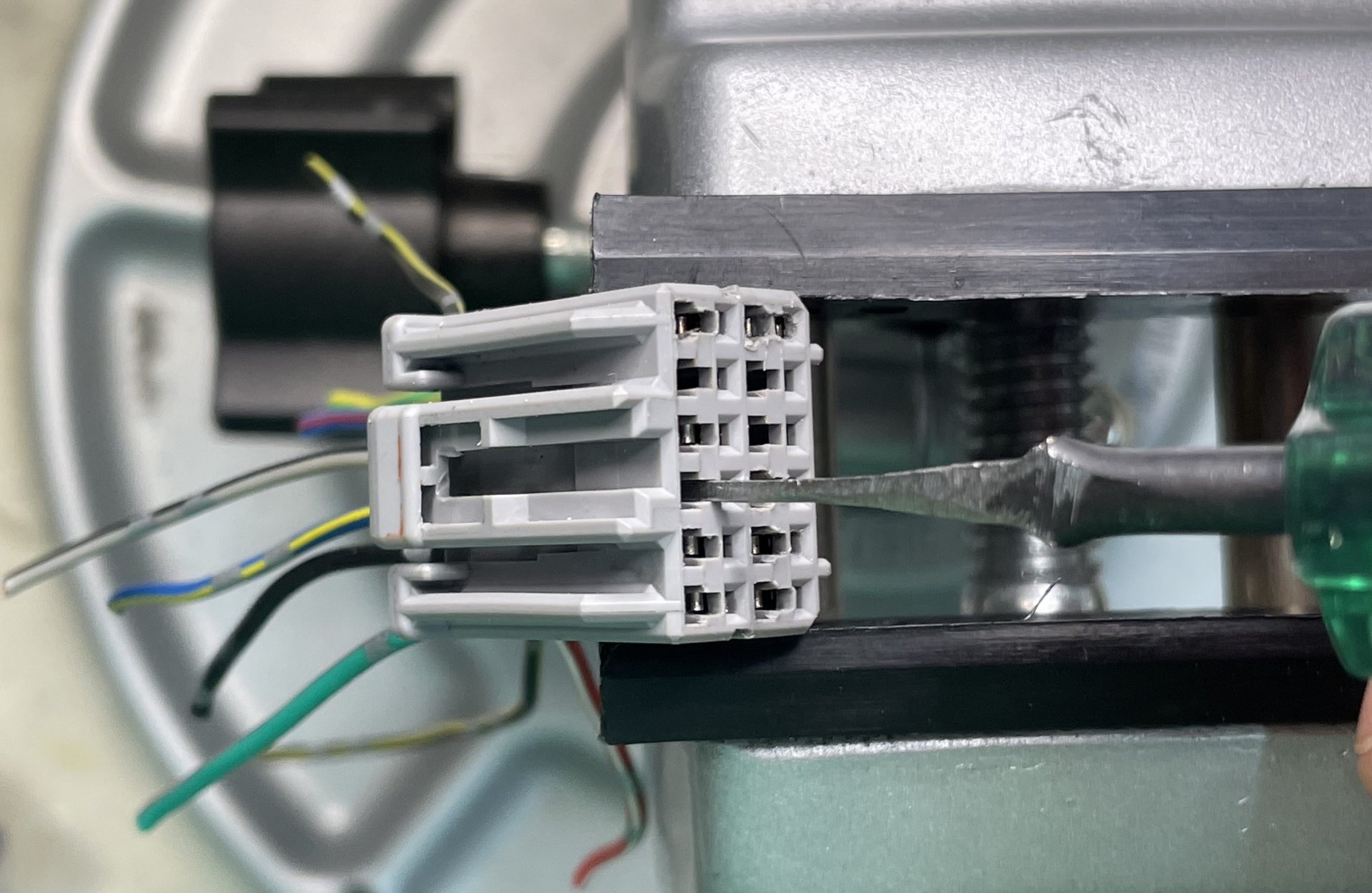

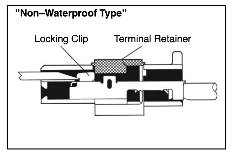

For those that have done the pin extraction method (@dmark84), do you have pictures (or video) of how to remove the pins from the terminal?
I've spent way too much time fiddling with the extractor, but can't find a reliable way to get the pins to come out.

Yes. Here's the connector opened up. Can't remember which one this is. This should make it easy...
Thanks guys! This is the diagram that unstuck me.
I was able to press down slightly on the visible metal portion, then pry up the "locking clip" to release the pin.
