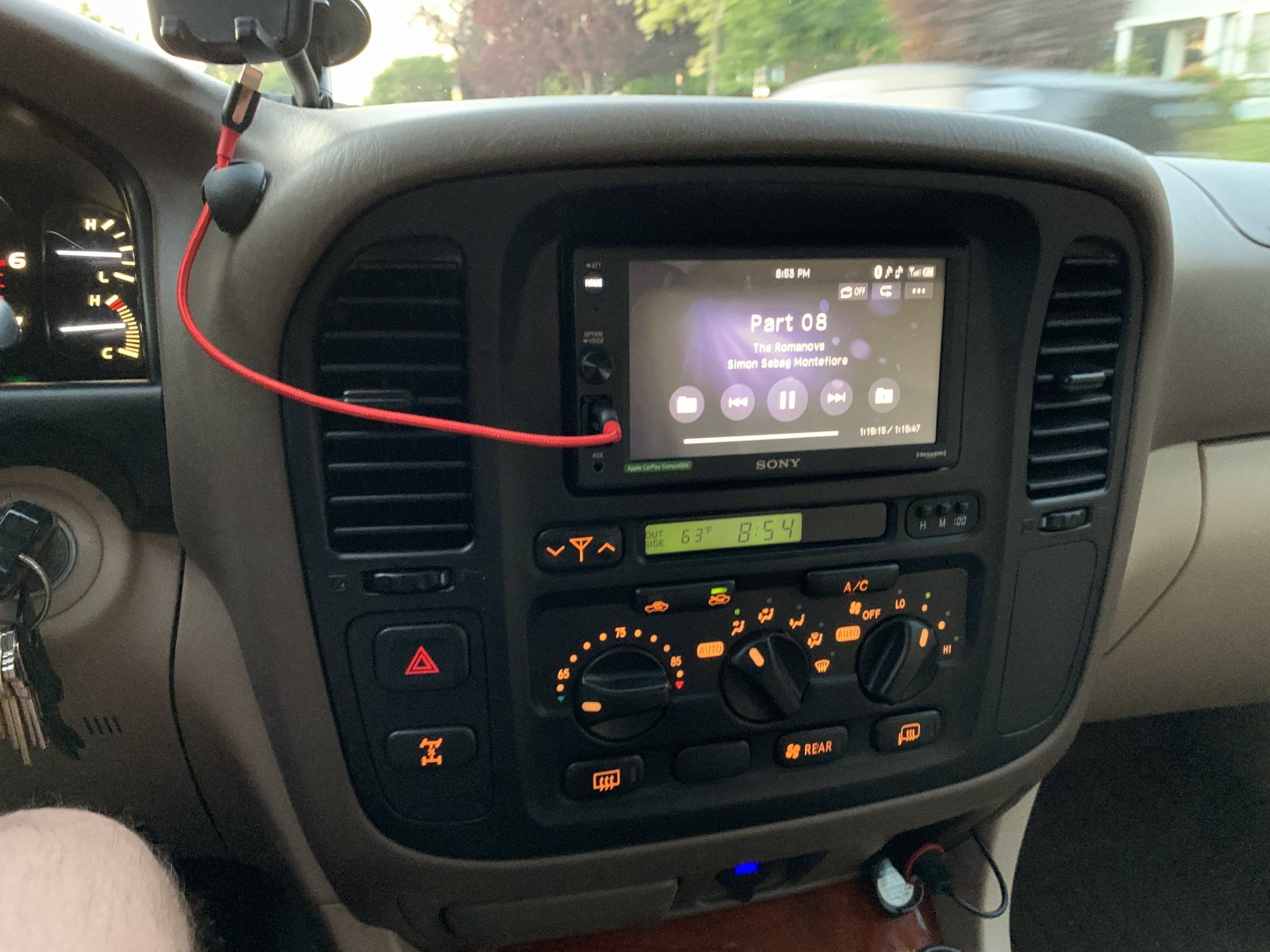

So my project is complete - successful - but a little more involved. There are a lot of great write ups here so I will try to just add to and not repeat anything. First of all I want to underscore what was written in 360: the Mark Levinson factory amp was unable to respond to my new head unit, and required a significant departure of plan for me, but the outcome was better than I had planned!
Here’s the money shot:

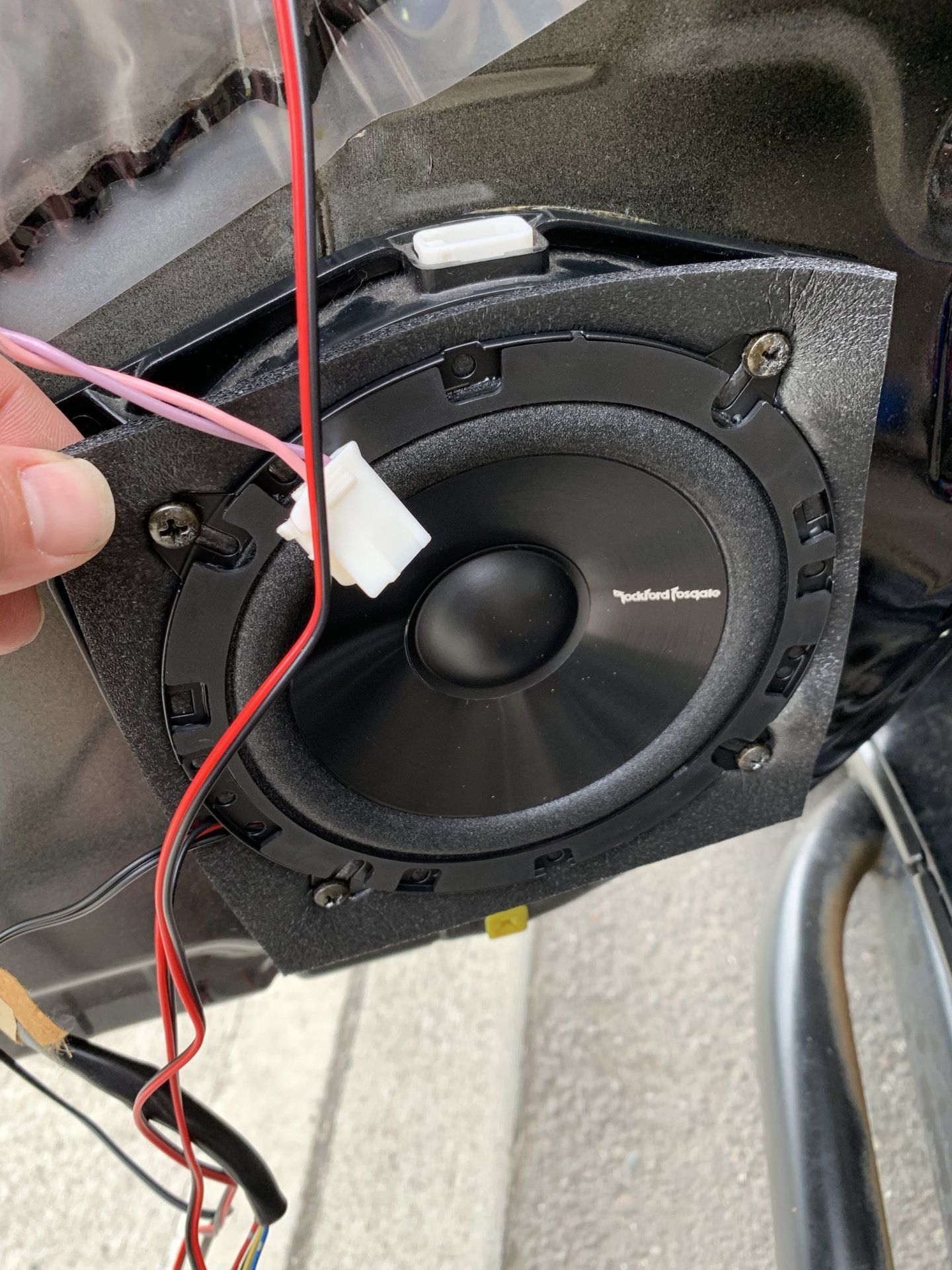

The foam speaker baffle installed behind the speaker. Creates an air tight space? Is that important?

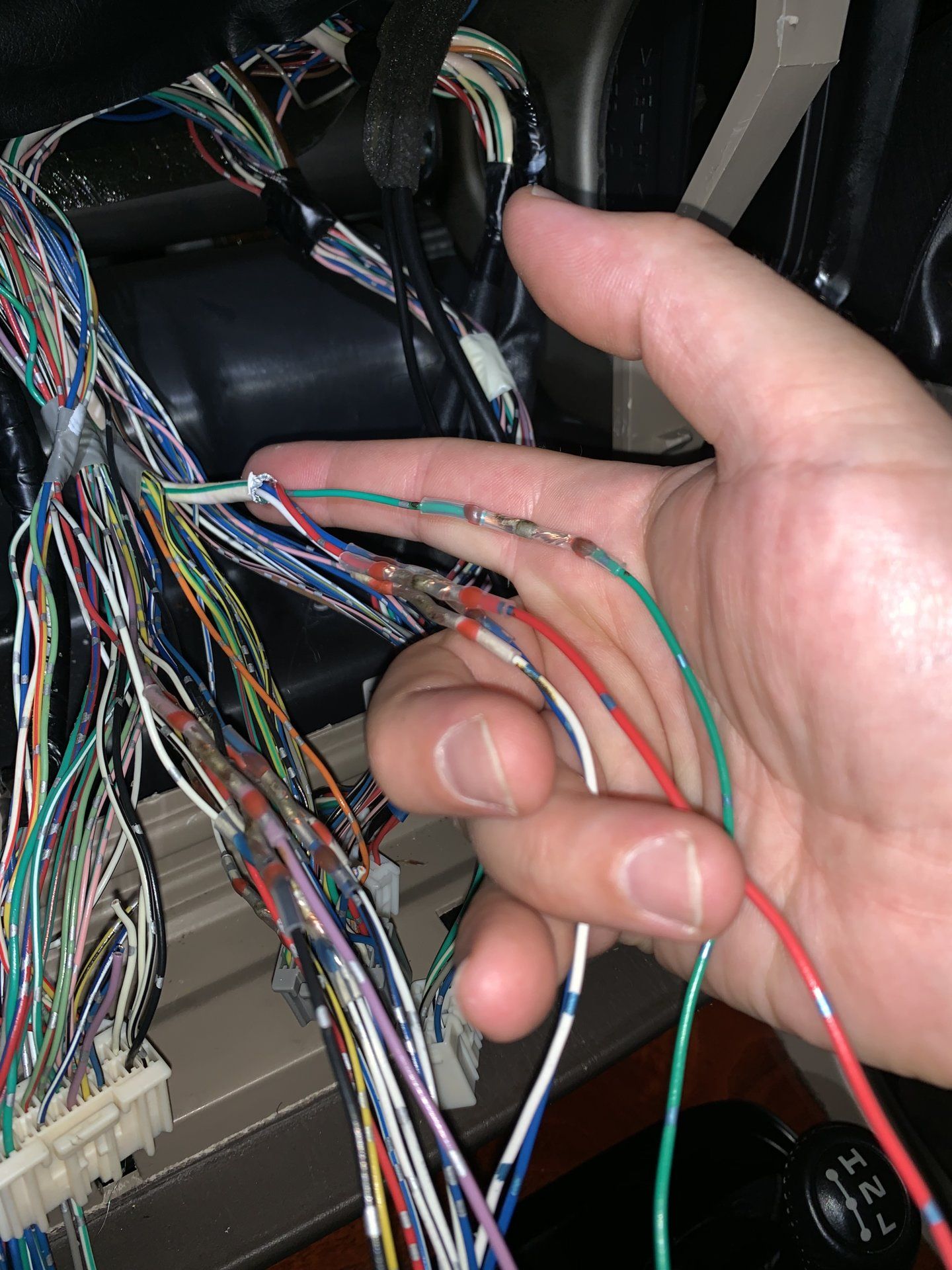

I didn’t notice until later that these four wires, which needed to be switched around following the wiring pin out map, were wrapped together... anyways I went to the hassle of stripping that white and green wrap around the four wires, and basically could’ve left it, so that was 2-3m of time wasted.

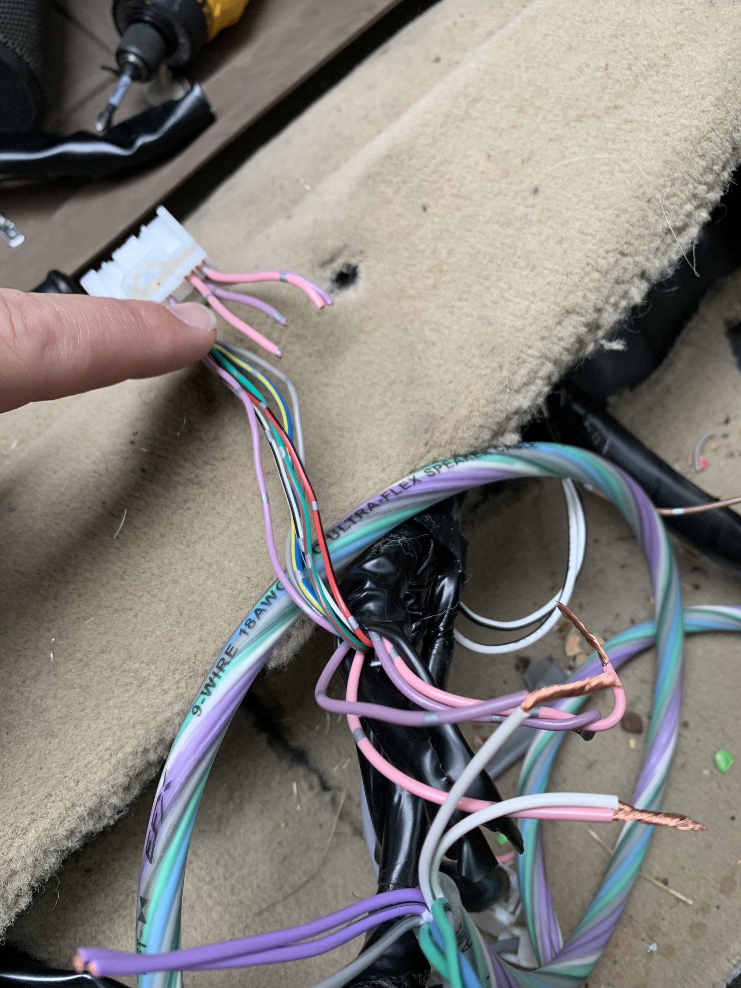

There’s some vague language in here about “grabbing the left door speaker” from the Nav DVD drive plug - that’s true! Basically the factory Mark Levinson w/Nav setup sends sound: head unit -> amp -> speakers EXCEPT the front door sound goes from amp -> Nav DVD -> Speaker; so you are looking for two pairs of pink & purple wires by my finger in one of the Nav DVD drive plugs, and you’ve gotta pull those through the bundle to find the 2’ Section that goes amp -> Nav, and the wires that go from Nav -> speakers. This whole thing is assuming you want to use the existing speaker wires in your new setup. As you can see here, I connected the 9wire bundle from my head unit to the existing speaker wires. That worked super well. No reason to run new wires. I used solder seal connectors here after confirming everything was working properly.

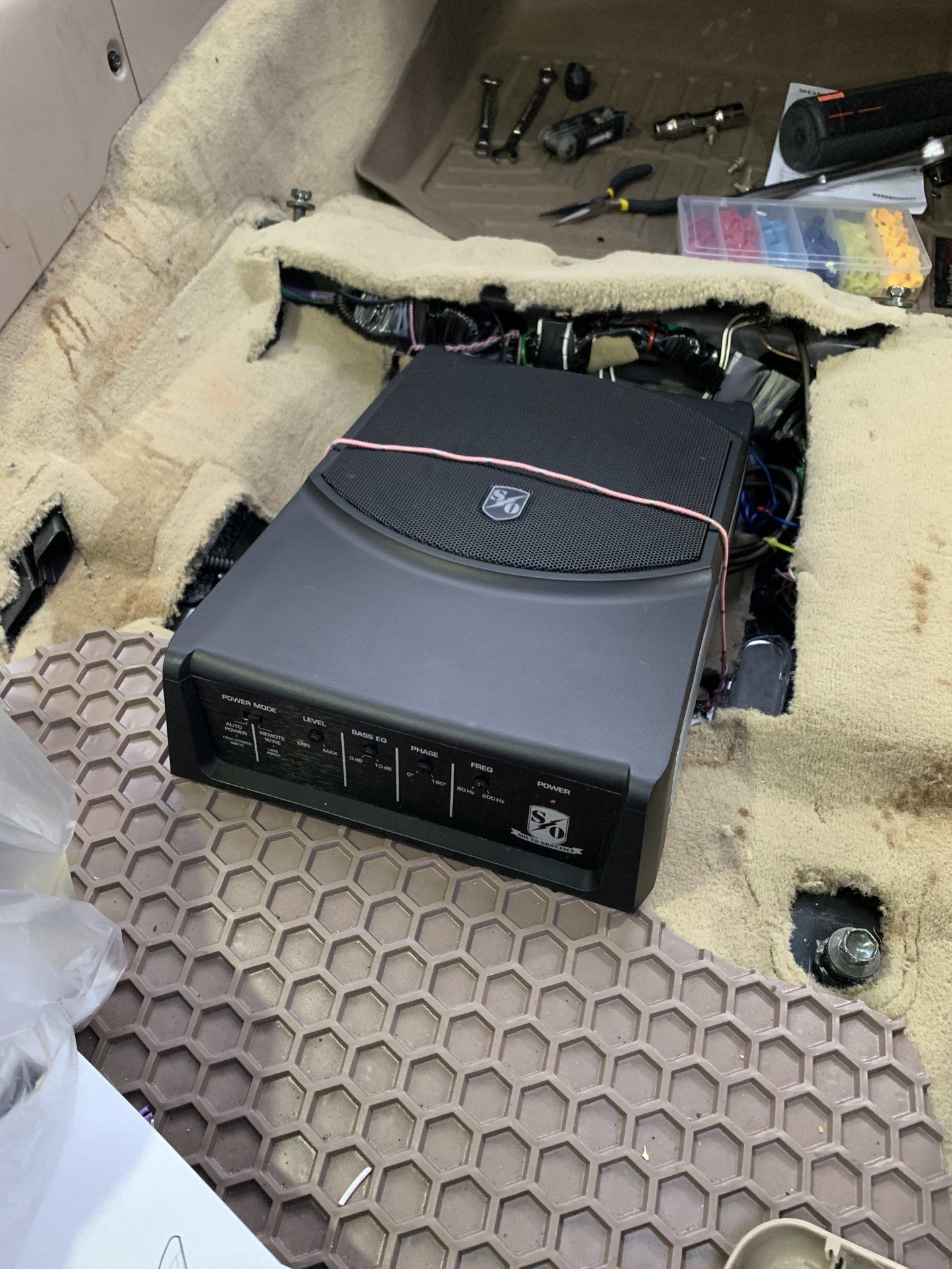

This thing is great! I hate how it sits in there, but there isn’t a lot of options unless I move it to the back or I start trimming carpet around. I ran the power through the driver’s firewall, behind the pedals under the carpet, and up under the gear shift trim, then under the carpet there where the awful stain is on the carpet. It’s a little janky of a setup but the wire shouldn’t shift or rub, and isn’t being pinched.
So, that’s the tale of my Nav Delete! Removed the factory amp, new speakers, etc... the sound is amazing, and I love the conversion to manual climate knobs. So much easier. I do not really know what I am doing with this, and I made it work, so anybody can do this.

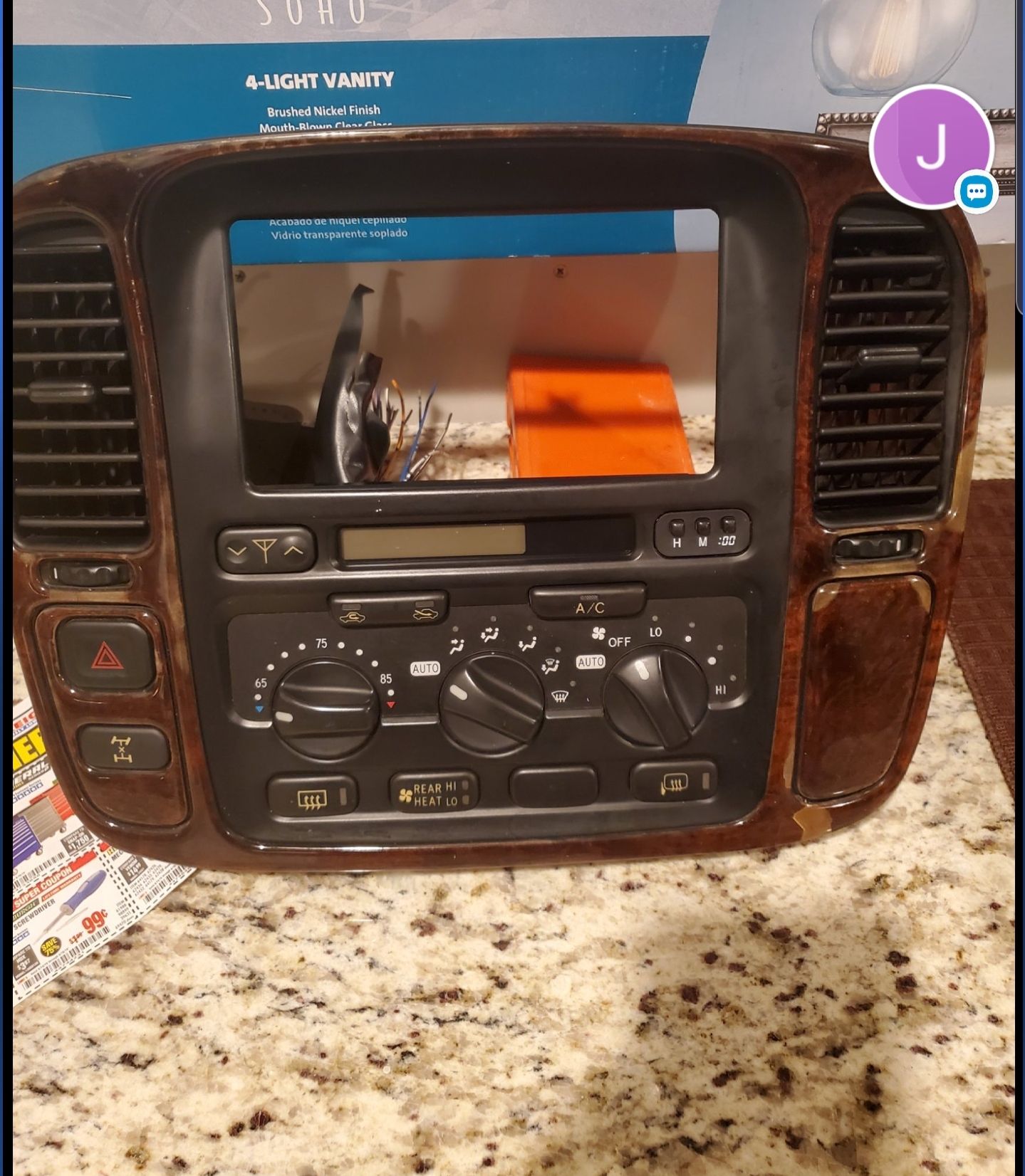

Uggggghhhh! I'm an idiot. I bought the 3 knob with pigtails thinking I got what I need and I must have totally overlooked the whole rear heat button crap. I thought I read where someone did the "REAR" button to "REAR HI/LO" button mistake like me and held the button down for 30 seconds and it worked. Has anyone successfully made my purchase mistake and made it fully functional, or do I just need to sell and try to source another one? Or is there a way to hack it?
Well, the good news is you have the pigtails, and that's what people tend to have a hard time sourcing. Now you just need the LX digital controller. Sell that unit and keep the pigtails. The LX unit will also match your dash as is.

Will the pigtails for my LC manual control work with the LX digital controls?
Pigtails should work just fine. The digital and manual have been reported to be completely interchangeable
