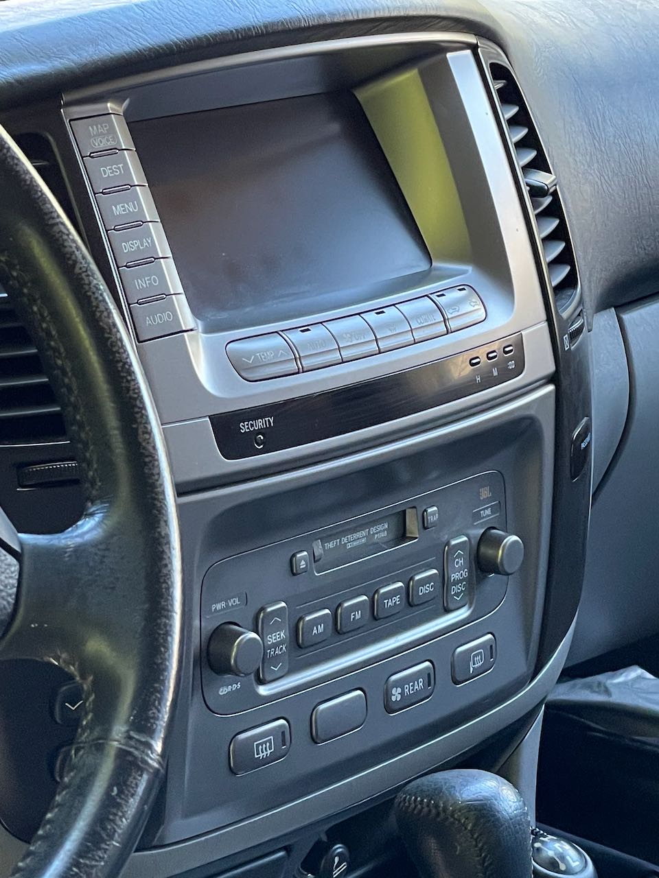

Has anyone here installed this Pioneer AVH-3500NEX? It popped up on my youtube playlist. Description mentions it retains factory nav (i realize most people here want to delete it). Looks like it just replaces the casette player, and would need a custom trim piece. Maybe a custom harness? I may reach out to crutchfield.
I have an 02 LX with factory nav, and really don't want to bother with locating another climate control unit with pig tails. I'm also happy enough with the Mark Levinson audio.
Thoughts?

Hey Guys. I'm just about to start the Nav delete upgrade on my '03 LC. As much as I hate to lose that cassette player I think it'll be worth it 😉. Just bought a Pioneer AVH-W4500NEX from Crutchfield. The configuration of the '03 LC looks almost identical to the '02 LX470. This thread is pre-'03. Should I start an '03 and later NavDelete thread so others can find it easier? Or should I keep my progress updates here?
Have you looked through this thread? post 2003 nav delete how to. - https://forum.ih8mud.com/threads/post-2003-nav-delete-how-to.1036722/
