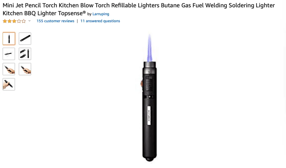

Be careful with a heat gun. It is tight in there and you can easily burn other connections. I used a small butane lighter. If your head unit doesn't work with the amp you can just grab the speaker wires from the amp output and wire into your head unit. You may have the impedance on the speaker and HU off but I am not a big enough audiophile to know if that makes a difference.

Like a cigarette lighter? Or mini torch type thing? I wondered about a heat gun blasting all over the place ruining other connections.
Here is what I used. $11 on Amazon. I think any small lighter available at many gas stations will work. I thought the old school BIC lighters would probably take too long to heat up.

Thanks for the suggestions - I ordered a pencil torch and will see how it works. The heat gun guard is a great idea too, you can find anything on Amazon!
