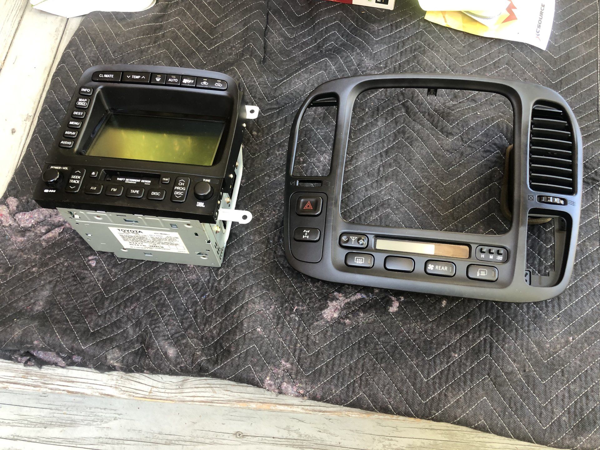

Well, the good news is you have the pigtails, and that's what people tend to have a hard time sourcing. Now you just need the LX digital controller. Sell that unit and keep the pigtails. The LX unit will also match your dash as is.
While I'm here, figured I'd make a list and part numbers that I used to do my nav delete and install a new AA/Carplay unit in a 98-02 LX470. Hopefully it helps someone.
Scosche MDAB 1988-05 GM Micro/Delco Antenna Adapter; Tip only
XCSOURCE SKAA-26 1 Male to 2 Female Auto Antenna Adaptor Cable Aerial Car Stereo Radio Splitter Y Shape MA598
Mount Bracket - Toyota (86211-60071)
Mount Bracket - Toyota (86212-60071)
DKMUS Double Din Radio DVD Stereo Frame for Lexus Lx-470 2002-2008 Toyota Lc-100 1998-2003 Dash Trim Kit Fascia Inner Size 173*98mm Black
ICESPRING 2 Ports Dual USB 3.0 Male to USB 3.0 Female AUX Flush Mount Car Mount Extension Cable for Car Truck Boat Motorcycle Dashboard Panel -(3 Feet)
Seadream 2Pack SuperSpeed USB 3.0 Down Angle Male to Female Extension Cable - Down Angle
AUTO-VOX Cam 6 Rear Reverse Backup Camera License Plate Parking Rearview System of 170-Degree Wide Angle for Cars Truck & RV with Waterproof Night Vision
100 pcs Solder Seal Heat Shrink Butt Connectors Electrical Wire Connector RED
Steinel Reflector Nozzle - for Soldering and Bending Pipes or thawing Frozen Pipes, Nozzle Diameter of 1.30 inches, Formed from high-Grade und Polished Stainless Steel, 07051
Metra 70-8116 Amp Bypass Harness
APPS2Car Parking Brake Bypass Video in Motion Interface Module for Select Pioneer Stereo Radio DVD Receivers - fits All Pioneer AVH AVH-P AVH-X MVH DVH and NEX Video Units
Pioneer AVH-W4400NEX
Metra 72-8104 Speaker Wiring Harnesses
Metra 82-8148 Speaker Mounting Brackets
Rockford Fosgate R165X3
