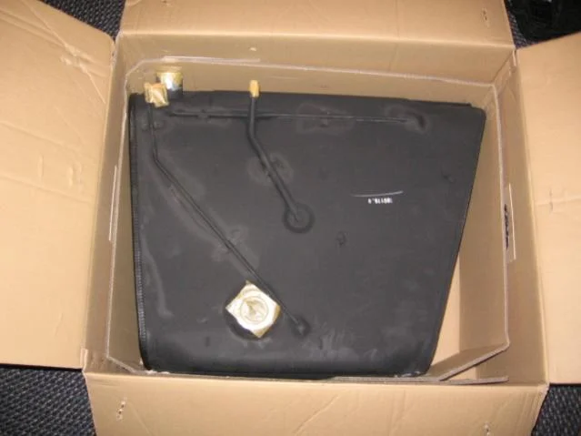

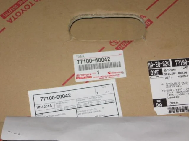

Go with a Toyota Tank from Cruiser Dan
I just went through this decision process this summer for my '76. Went through all the options (plastic, refurb the original, or OEM tank, etc.) and came down on the side of getting a Toyota tank from Cruiser Dan. It was less than a refurbishing either of the existing tanks from both of my 76 FJ's and I believe that the OEM tank will last about 20-30 years with no issues.
I wanted to remove any doubt about quality and durability and go with OEM.
