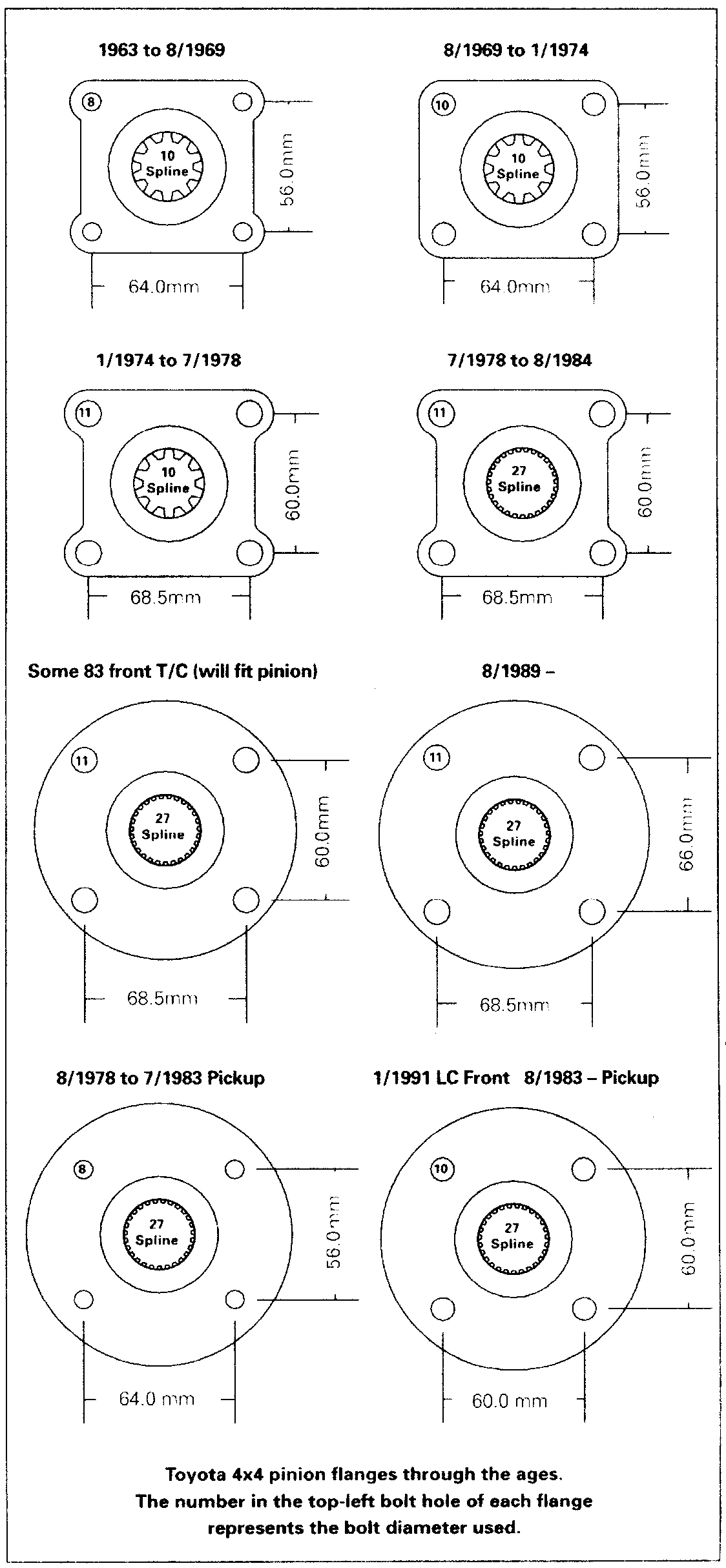

Shafts should be similar, but the bolt pattern of the flanges on the t-case, shaft, and 3rd member likely will be different...
Looks like they went from 10mm bolts to 11mm as well:
Good info. Thank you. Since I will be putting new u-joints in, I might get lucky and be able to use the flanges from the '76 and the '70 shaft (?)
I hope to get lucky here $$ wise because I'd rather save for an H55/split case swap, which will need driveshafts modded then.
Worth a shot! I do not now if the dimensions on the yolks changed? You could look up the u-joints and see what years they cross...
I feel you bro! I would like to acquire the same.
The sickness doesn't stop there. Ideally would be a Holley super sniper with a blow through turbo (cute little fella sized) in front of the H55.
@FJ60Cam is ready. Just gotta fund it.
The easiest thing it to reuse your 76 slip yoke on the 76 shaft
Then you can grab the flange off a third on your parts truck to match shaft or use the 76 pattern when rebuilding the ujoint.
