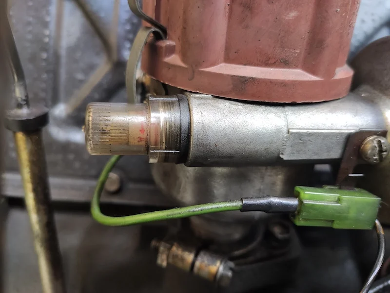

Hello everybody, I was searching about this over the forum but since I have a non US distributor (and cruiser), I decided to give it a try and ask. Sorry but no part numbers stamped on the distributor, the rotor or the cap, I suspect cap and rotor are not OEM and will look to replace them as well.
I am looking at the moment to replace the point with a Pertronix kit, (as well as the coil), nothing wrong with what I have now but I am looking for more reliability.
Here some pictures of the distributor hoping to get a confirmation on p/n and where to buy it in the US. Dont know if the electronic distrinutor available on eBay and other places is a valid option or should I keep the stock one with the kit upgrade.

That looks like a 19100-61080 distributor. The similar US market distributor has a different breaker plate and points. The mounting holes on breaker plate for the points on the US market distributor are different due to the points differences. I have one of the early US distributors with Pertronix on the shelf in my garage, a spare breaker plate for it, and a breaker plate like yours. I'll check the fit later this afternoon. The breaker plates can be swapped out in a couple of minutes.

i wasn’t aware that the points were different! I just had a Non-US 43 come through a few weeks ago and I threw regular US-market OEM points it in not realizing there was a difference and it ran just fine, do you know what the exact differences are?
The Pertronix for the US market distributors is their Part Number 1665A, here is a link:
The center-to-center mounting holes are different by 0.5mm (closer together on the breaker plate like yours).
It fits the US type of breaker plate for use on early F engine distributors. I have several like-new breaker plates that you could swap out, and a used Pertronix 1665A. PM me if you're interested. I can post photos if you'd like.
The non-US small cap distributor uses the same points as the 1/75 through 9/77 US market 2F points. The earlier type F engine points for the US market fit the 3/69 (?) and earlier distributors with the different breaker plate.
