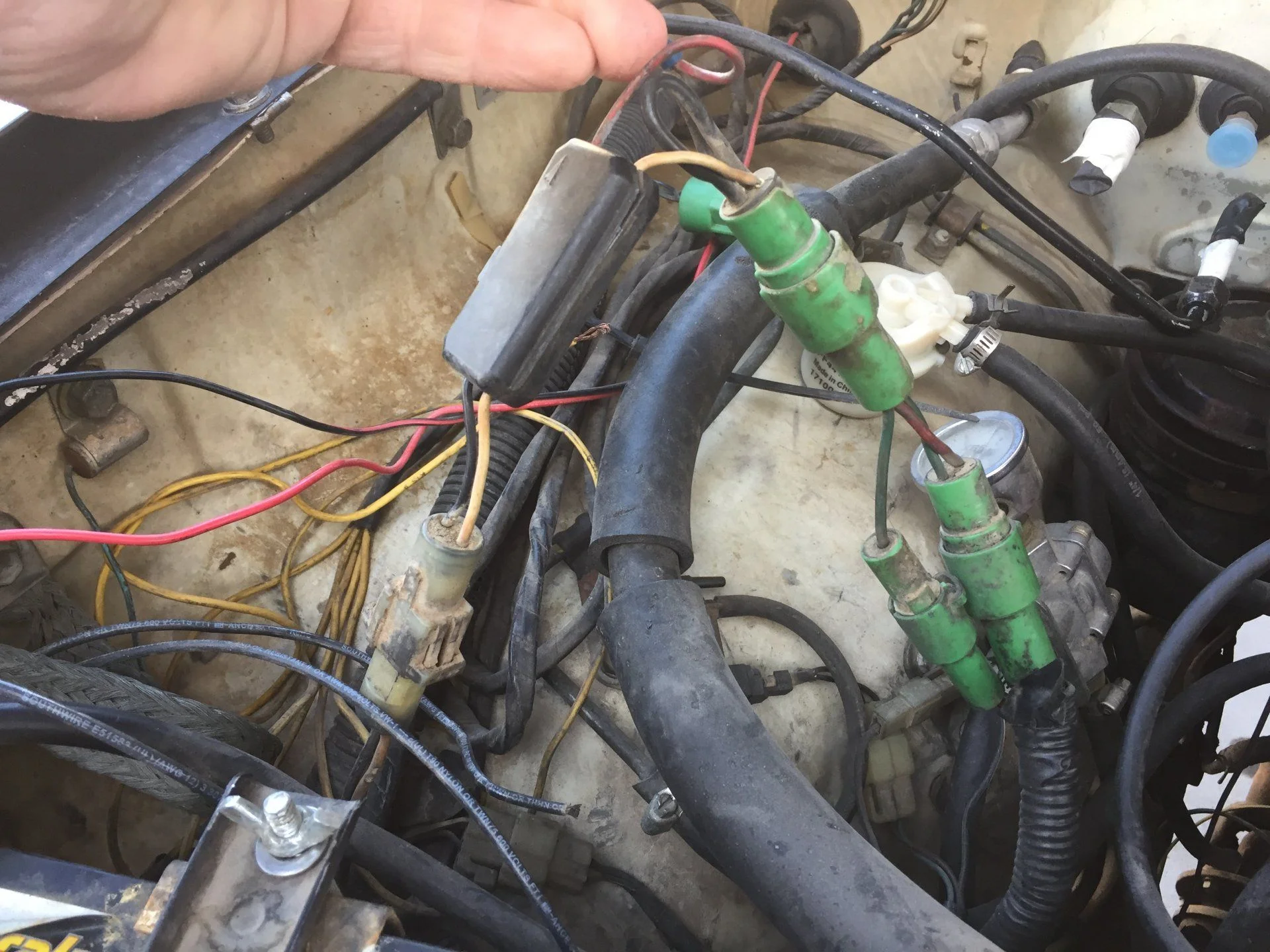

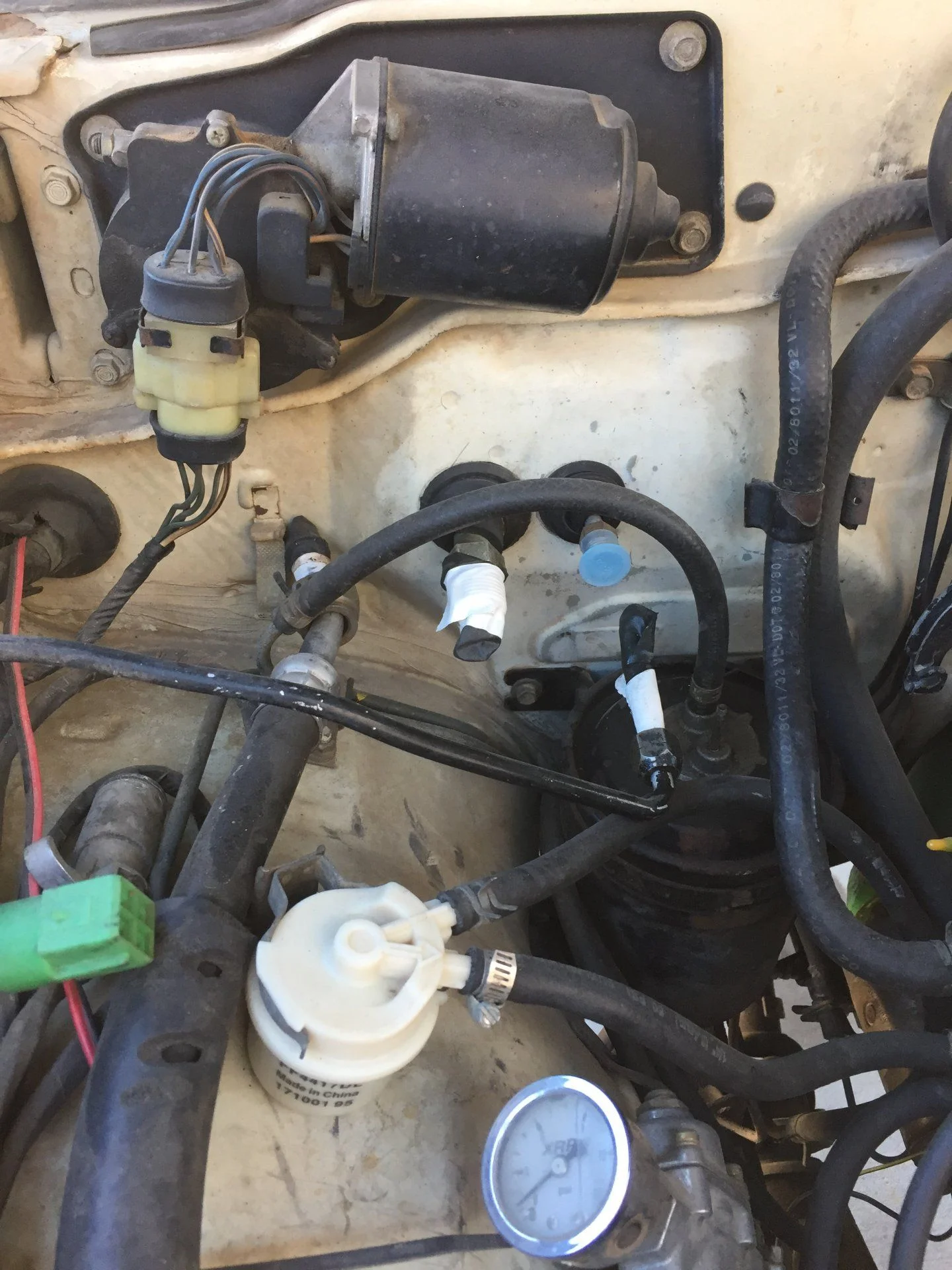

Here is firewall on 1980 Toyota 4x4 truck.

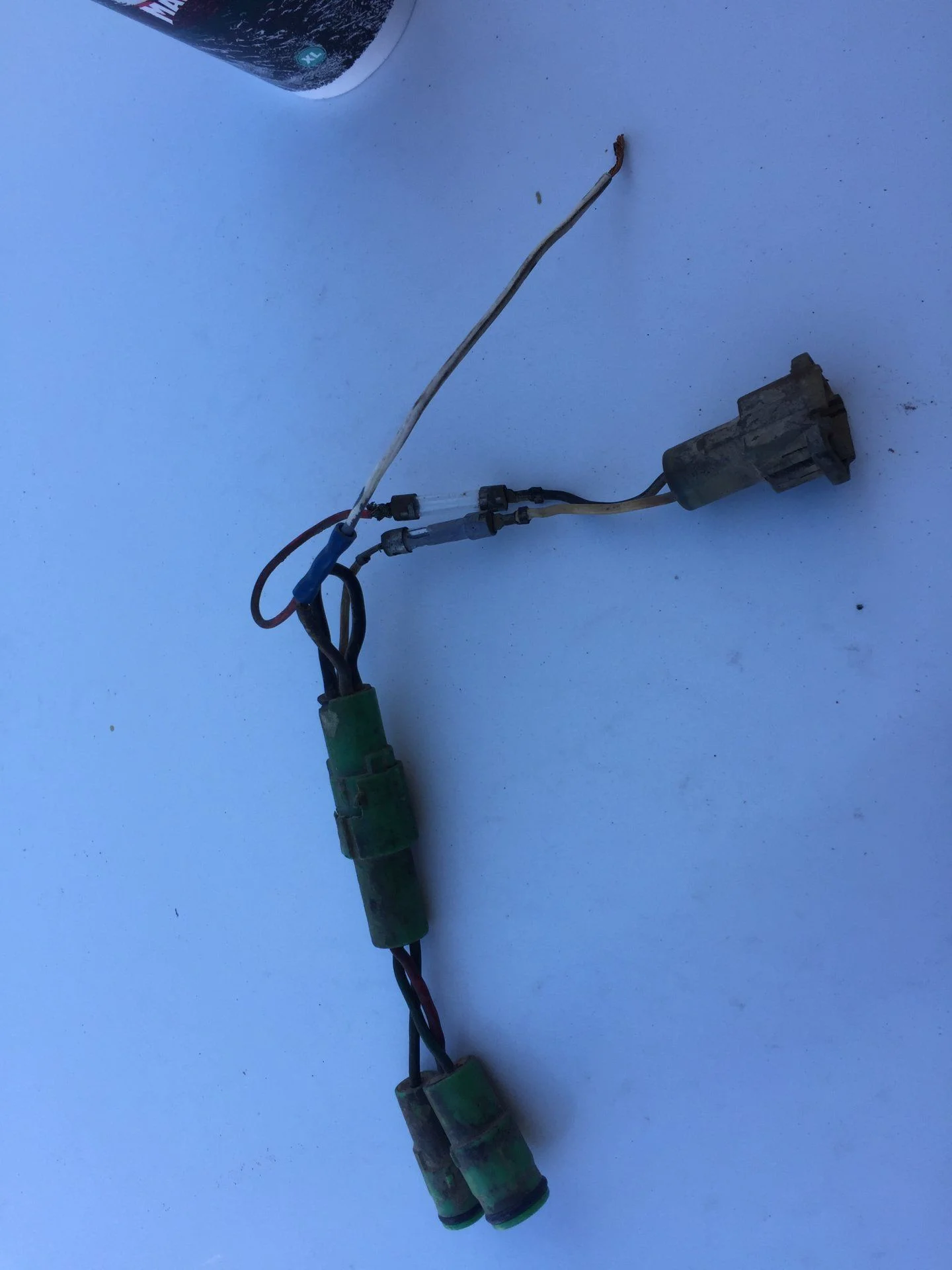

Also a fusible link setup I got from a junkyard a few years ago that I’m putting in the truck.

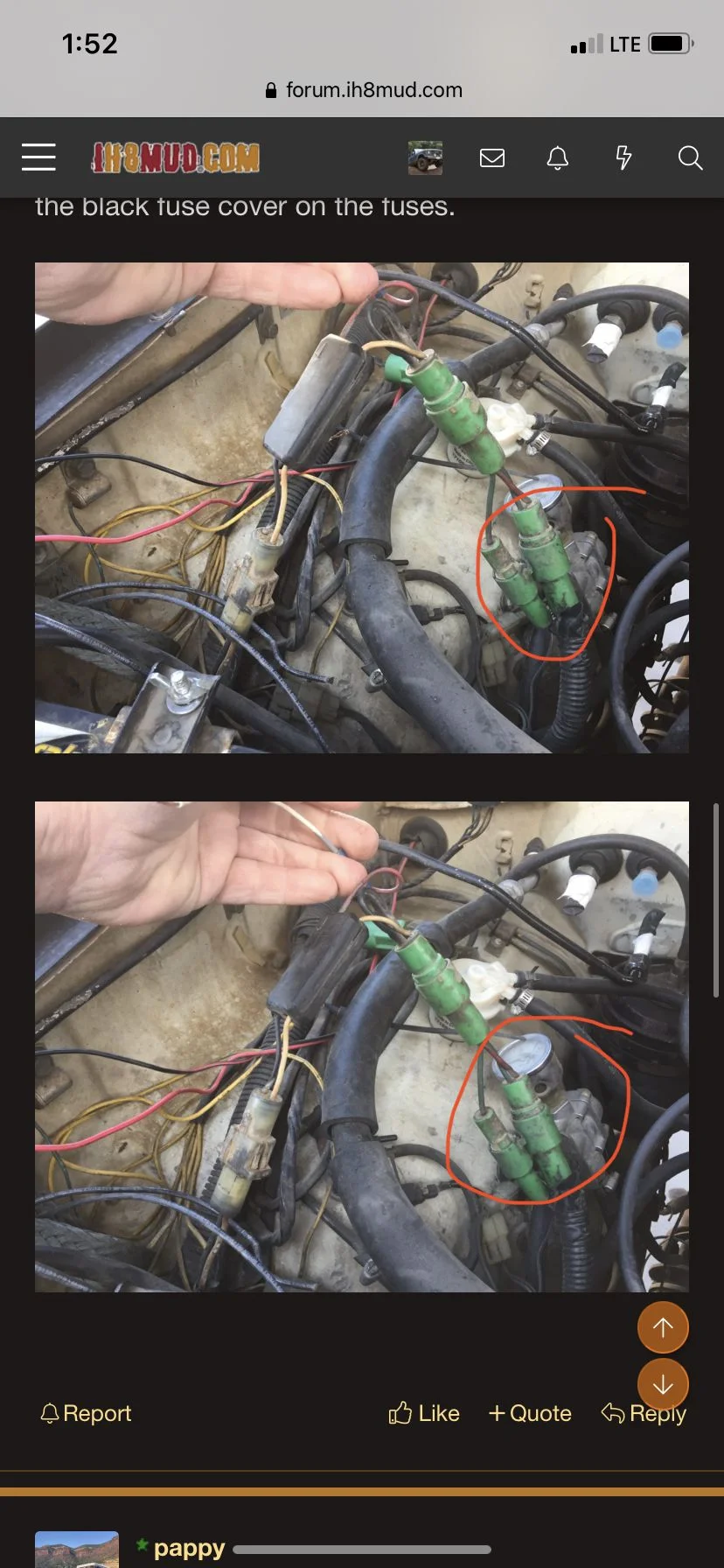

So is the fusible link pictures what it looks like on the truck? Or is that from another Toyota? I’m trying to figure out if I still have the plugs on the vehicle harness.

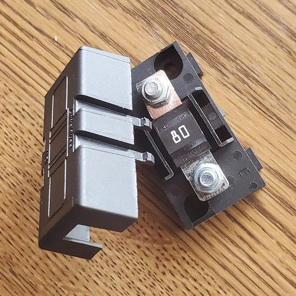

For my 3RZ project I need to do a little rewire of the truck's power off the battery. I found a "solution" that I think will work. Bottom line is I need to partially bypass the factory fuse block and fuse links, which on my truck are just big fuses. My "solution" was to use one of the MIDI fuses, hoping that they are a substitute for the 80A fuse link I currently have. Originally I was going with the 70A alternator found on pre-2000 3RZ trucks. Those trucks have 80A fuse links. But, I found a 80A alternator from a 2000+ truck, so I will need to upgrade to a 100A fuse link. Pic of the 80A MIDI fuse in the holder.
Link: MIDI® Fuses - https://www.delcity.net/store/MIDI%C2%AE-Fuses/p_819005.h_819004
I think this idea might work for rewiring your fusible links. You just need to decide on the fuse amps. The fuse holders do snap together which would make wiring the three fusible links real clean.

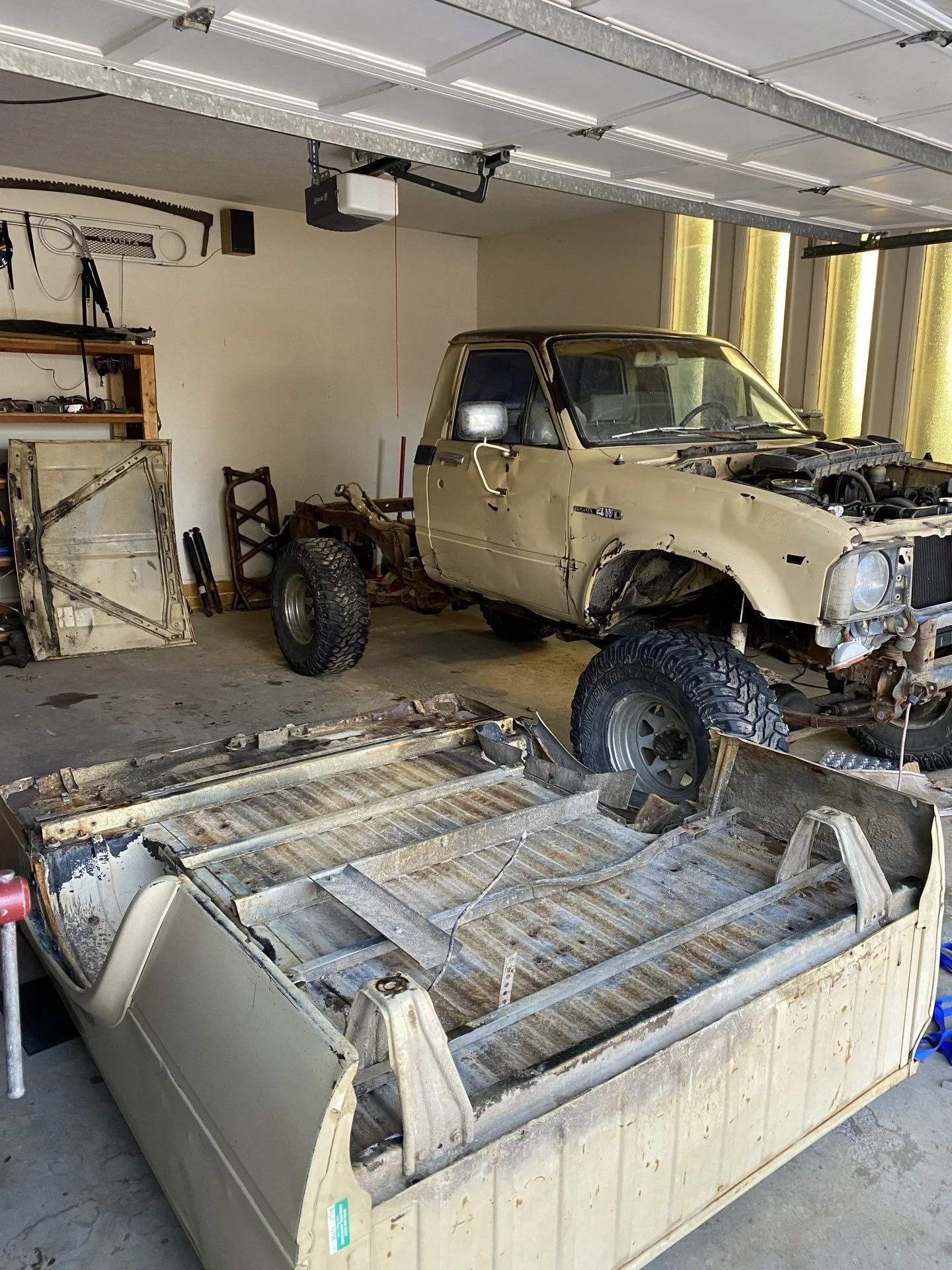

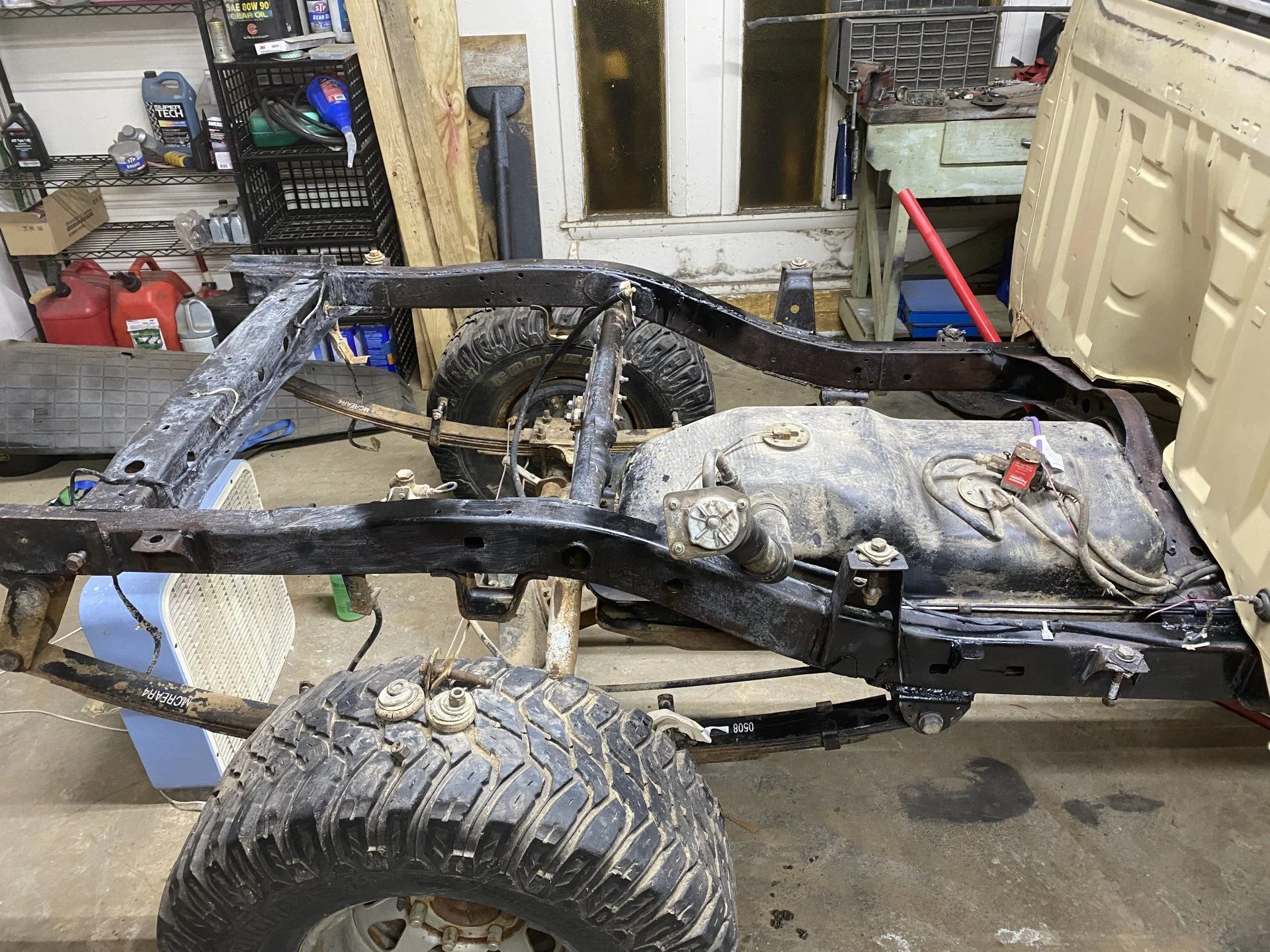

Got the bed pulled off. I still haven’t found any surprise rust which is pretty cool.
I’ve found lots of other surprises like frame cracks and fender cracks and bent body mounts. But no rust! 😬

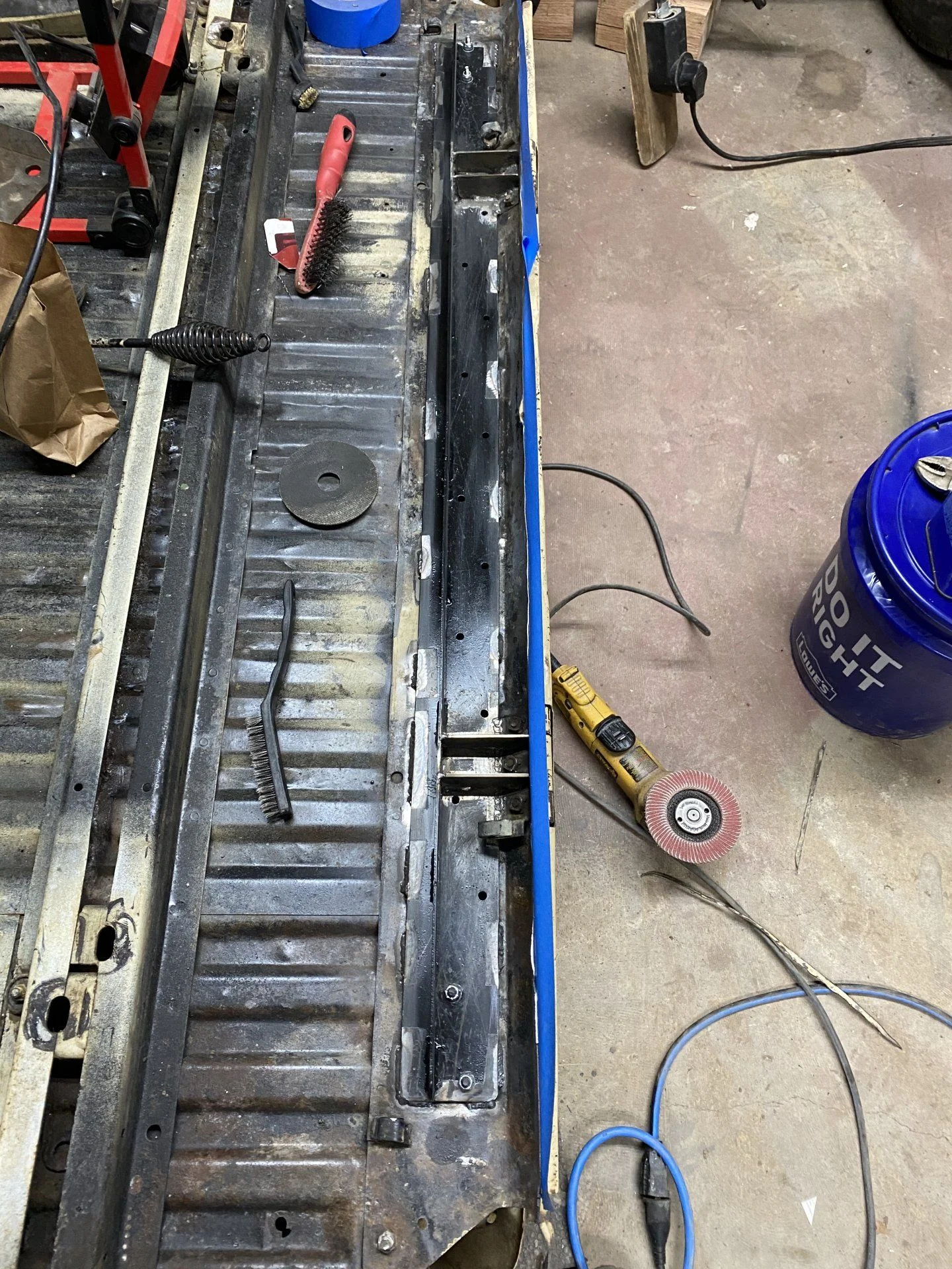

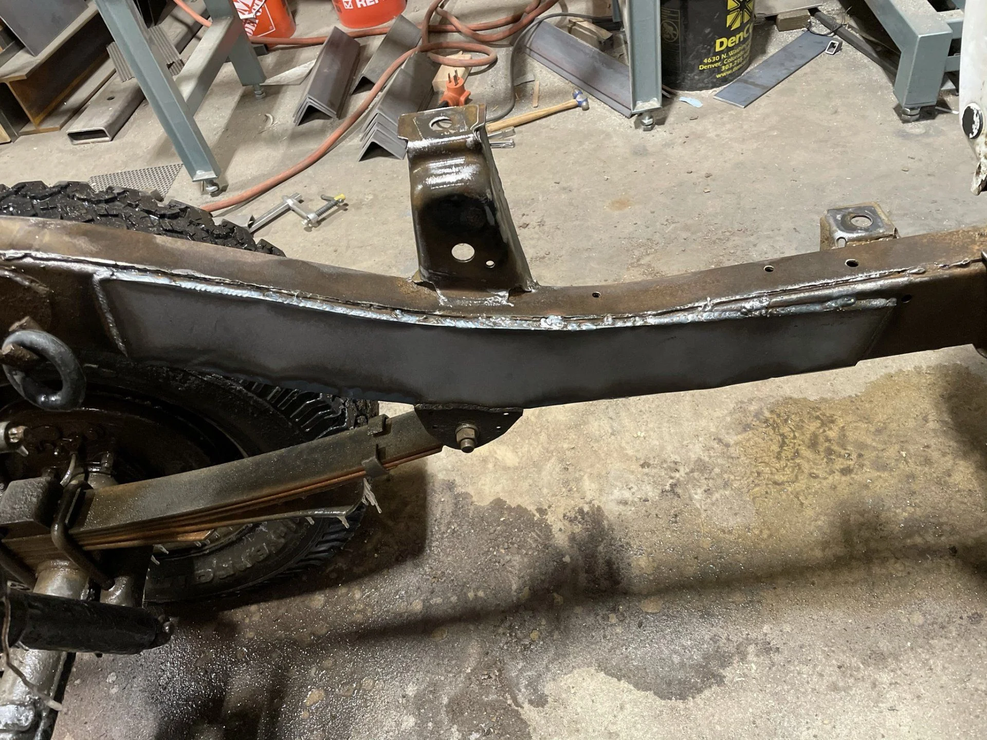

Been making progress. Rear frame is all cleaned up. Decide not to paint it, but I wire brushed it and wiped the whole thing down with rust converter. Final plan is to blast it with Woolwax inside and out.

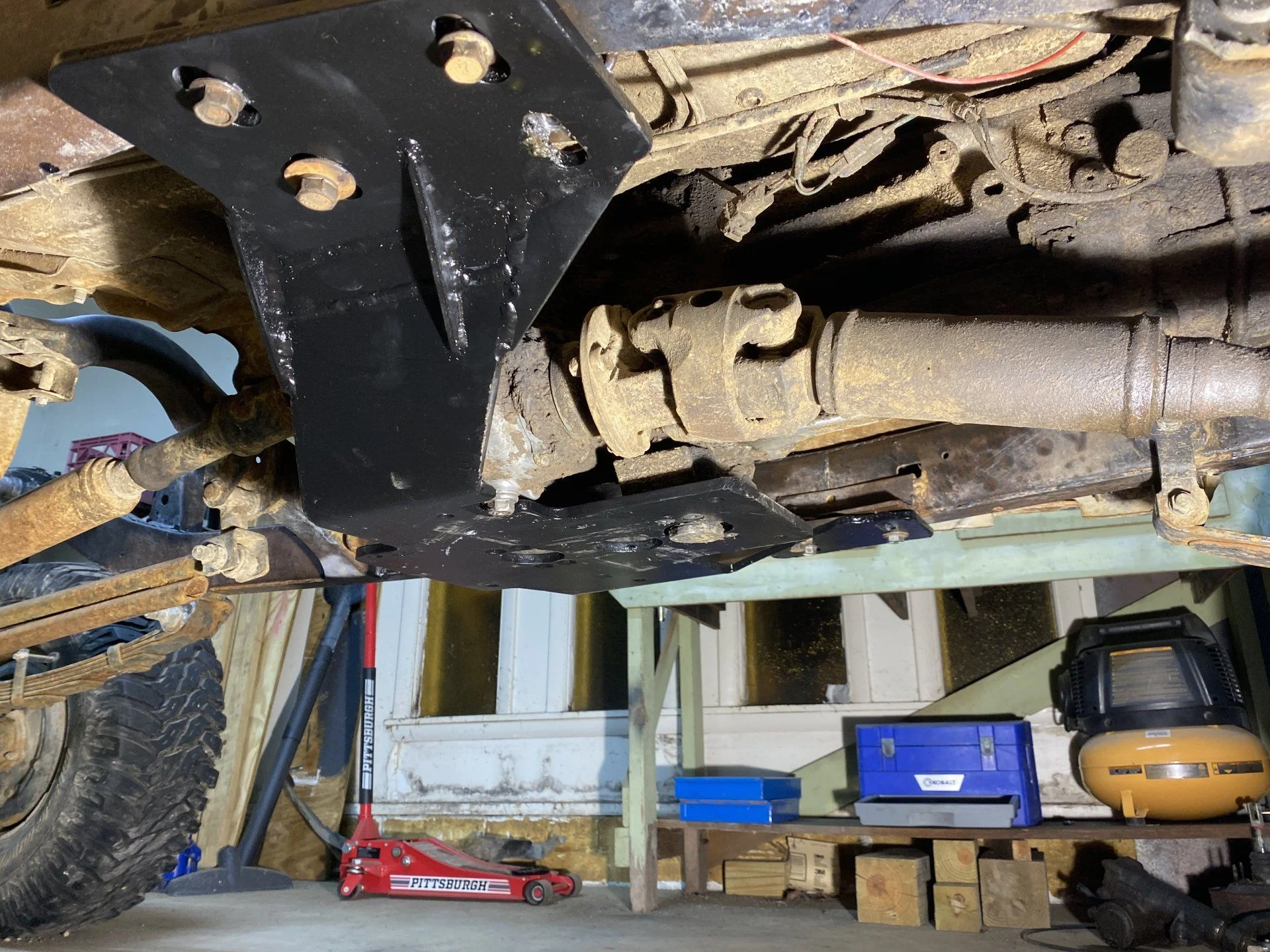

Frame portion under cab is cleaned up.I oiled the top while I could reach it and then pulled the body lift. For some reason the transmission/xfer would not clear the body as they sat. They were pushed over to the PS about an inch so I used an old crossmember/skid plate I had to build a new mount to get everything centered in the transmission tunnel.
Picture of the cut crossmember awaiting reinforcement.

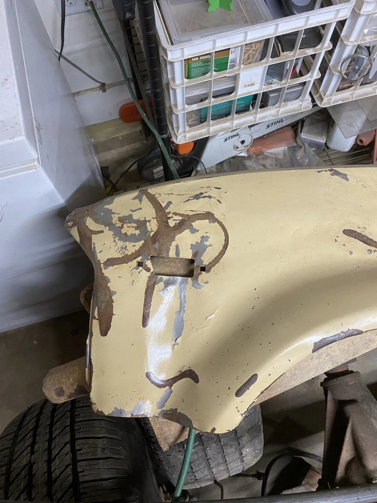

Finally - I banged out the crumpled front fender so I can fit new headlight bezels and a side marker light. It doesn’t look great, but it matches the rest of the truck...

Replaced smashed factory crossmember with this skidmember I had from a part out. In order to remove the body lift I had to shift the trans/xfer over about an inch to the drivers side. I cut and welded the skid to accomplish that. Pictures are terrible.

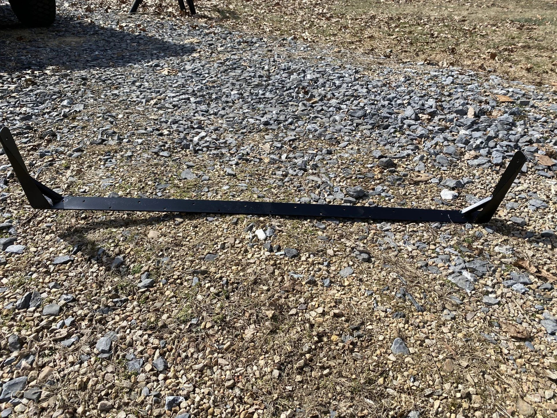

I’ve also been building this bedside/tailgate brace to support everything in back. When the bob/chop was completed they cut all the structure out of the back which caused the tailgate mounts to bend upward about an inch and the sides to be pretty floppy.
Not very exciting, but here’s the piece that bolts Inside the bed. There will be a corresponding piece underneath the bed that welds to the sheet metal and the tailgate mount plates. This top piece will bolt through the bed to the bottom plate and through the taillight housings on the sides. Hopefully this will keep everything in place.
