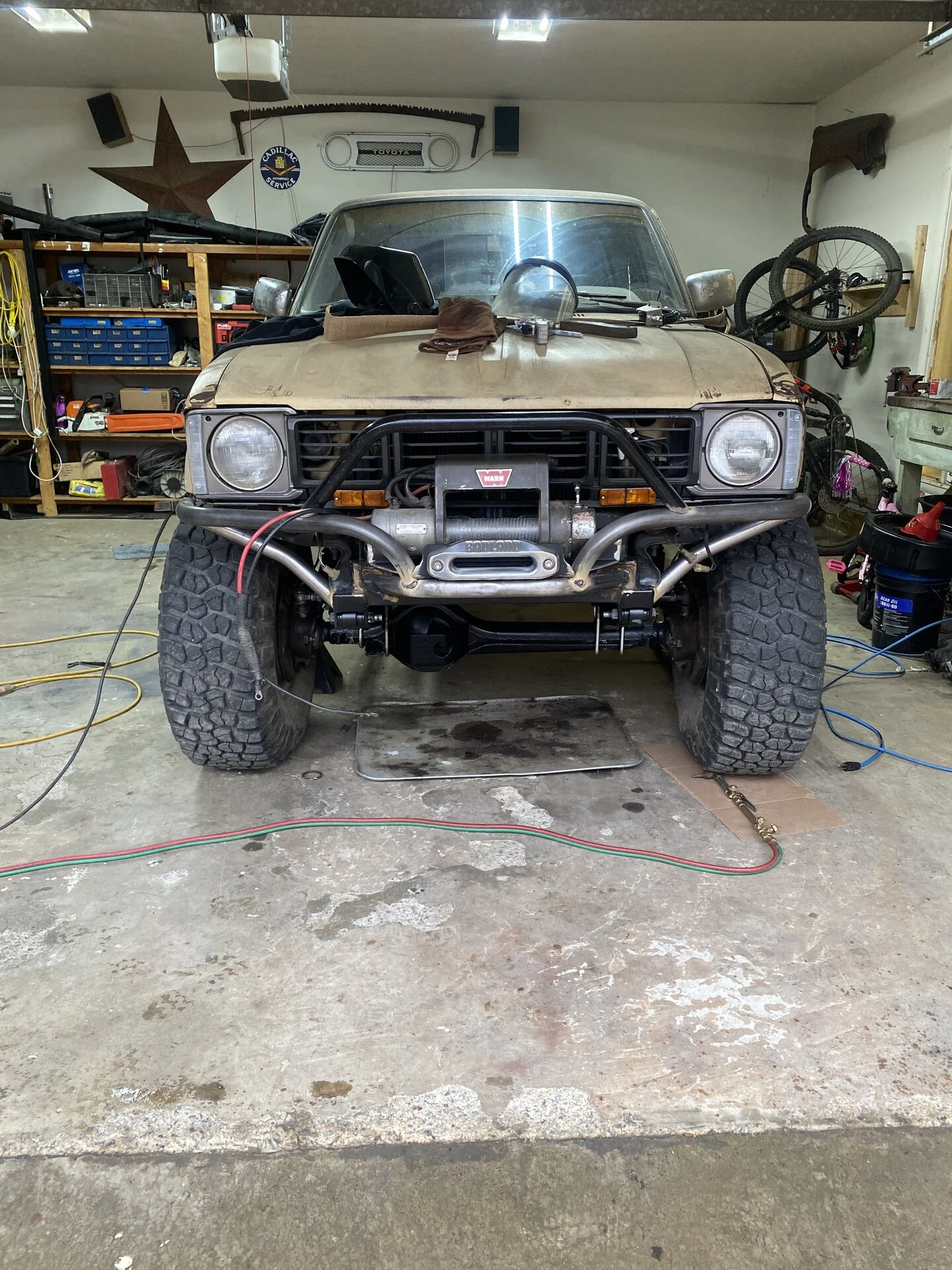

I’m in the process of building a front bumper:

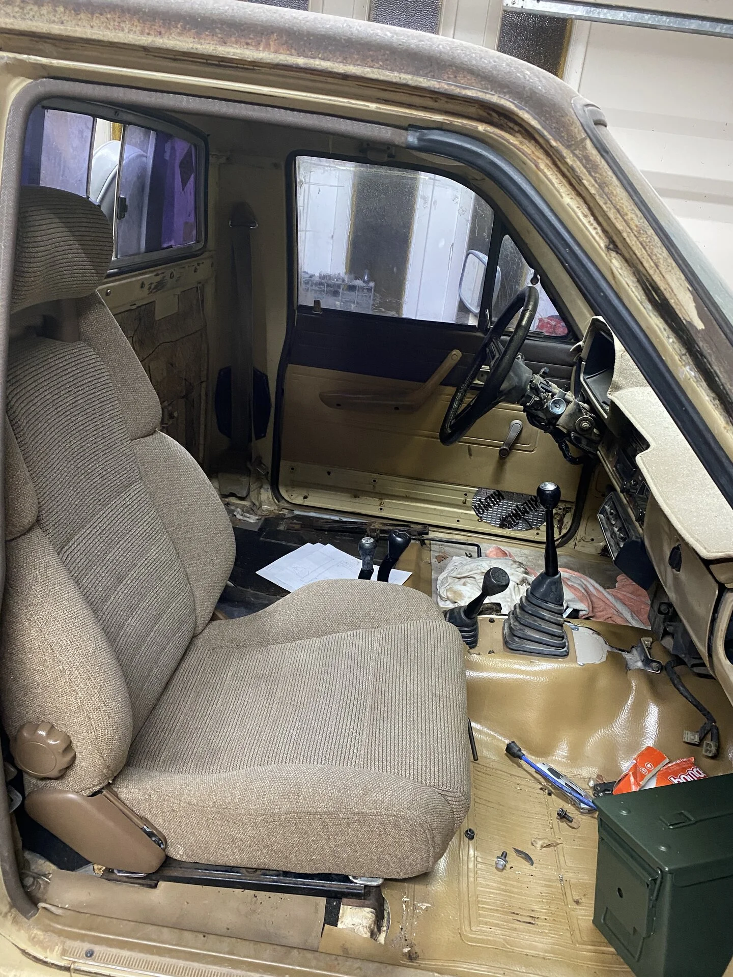

I’ve only gotten the passenger seat in. It was pretty easy. Just adapted it to some Toyota sliders.

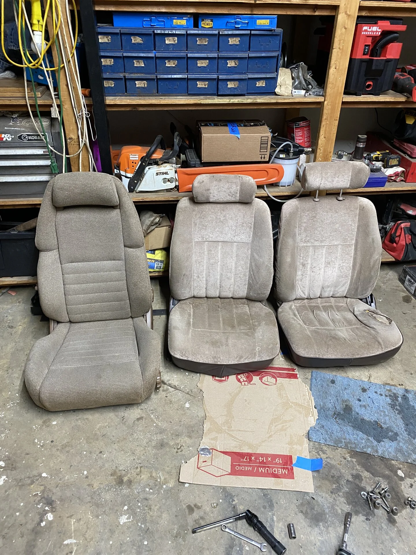

The seats are sweet. Drivers seat has about 5 different mechanical adjustments and the seats are nice and small. I’m tall and thin so distance between back of seat, and seat bottom height were critical for me. Foreign coupes seemed to be the best seat option. I happened to see these on marketplace.
Comparison of the Toyota (I think) buckets vs the 300zx seat. The Toyota seats were unbelievably shot. I was basically riding on wires. This will make the truck feel a LOT better on those long trips to the dump and the hardware store.

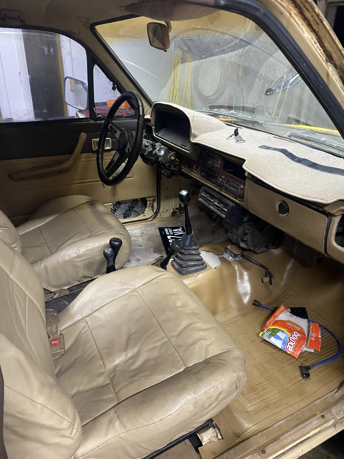

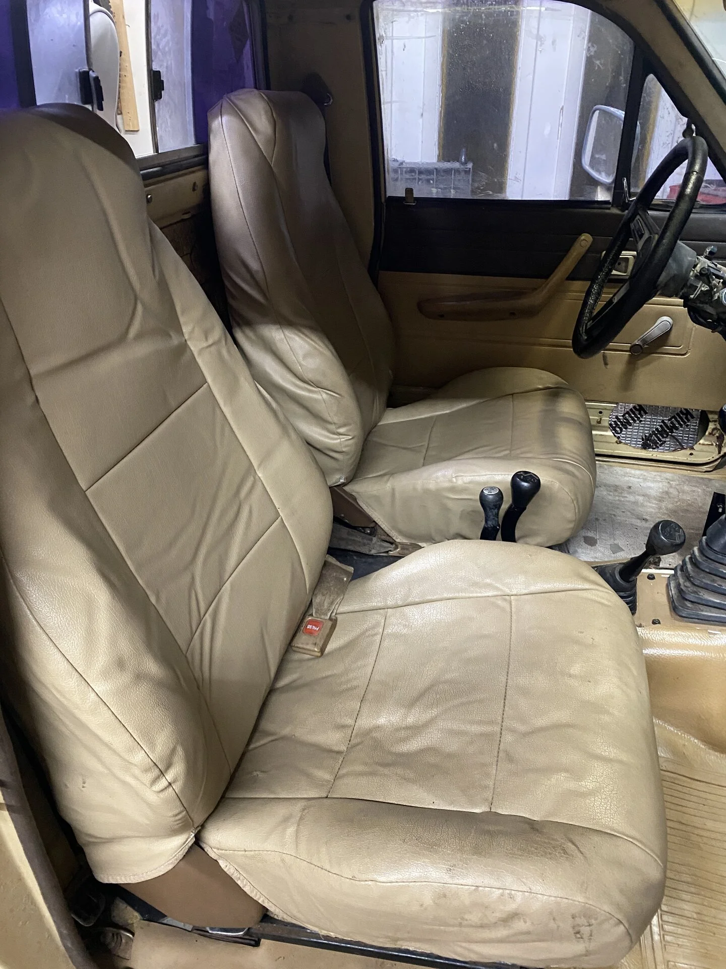

Here are the seats, with some old seat covers, mounted in the truck. Super comfy and they are about the same size as the Toyota buckets that were in there.
They leave me about 8” between seats so I *think* I’ll be able to get some kind of center console in here.
Try fitting an ammo can.
Yea, I actually think the ammo can may be the best option. I had gotten a new one from harbor freight when I had my old seats. It’s tiny though. Need to find a bigger one now that I’ve got more space.
All the Jeep consoles are too long to fit behind by rear shifters and I’m not real excited about spending $100+ on something to immediately cut it up.
