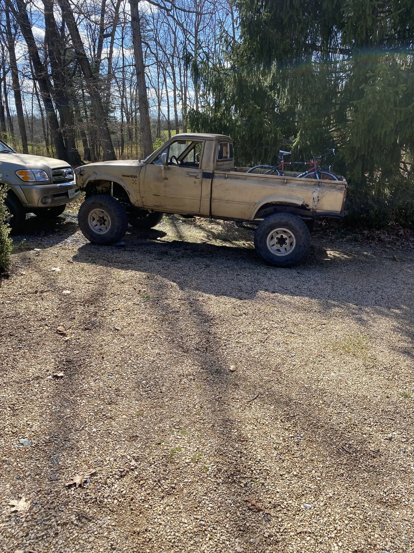

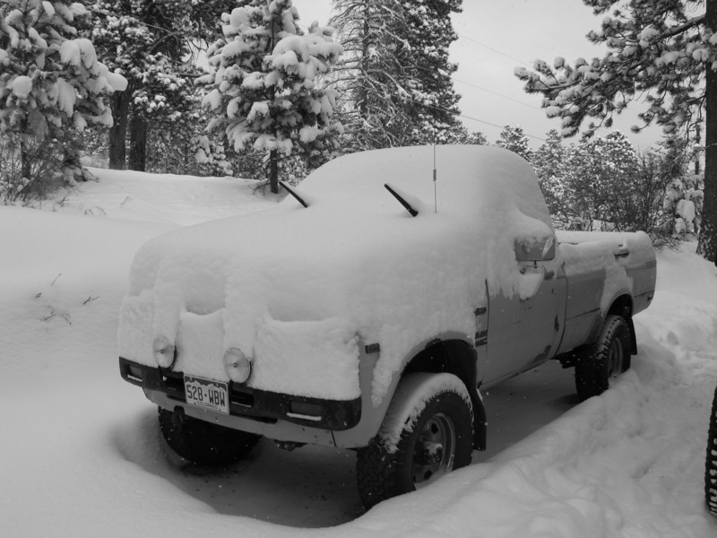

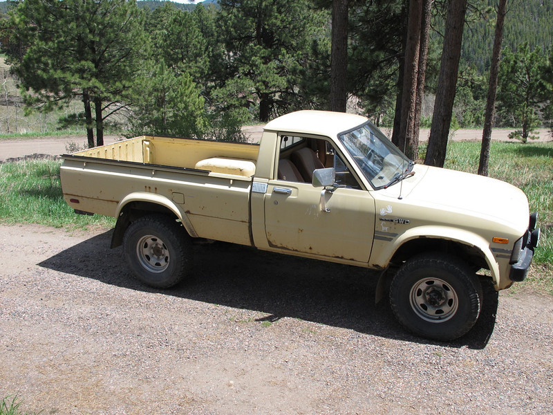

Patty - A 1980 “Long” bed.
Well the leaks are fixed. I can hear the motor now and it sounds pretty decent.
Quieting the exhaust leaks down allows me to hear all the other clunks and bangs.
You guys think the rear spring bushings had another ride in them?
Pulled it out of the garage and drove around the house some. Hauled a little wood. Admired the truck.
This thing is so friggin’ loud on the road. There are overwhelming vibrations coming from.... everywhere. It’s like I’m inside a subwoofer. Thinking new motor mounts and a transmission mount will help. And I’d like to get the exhaust dump out from under the cab.

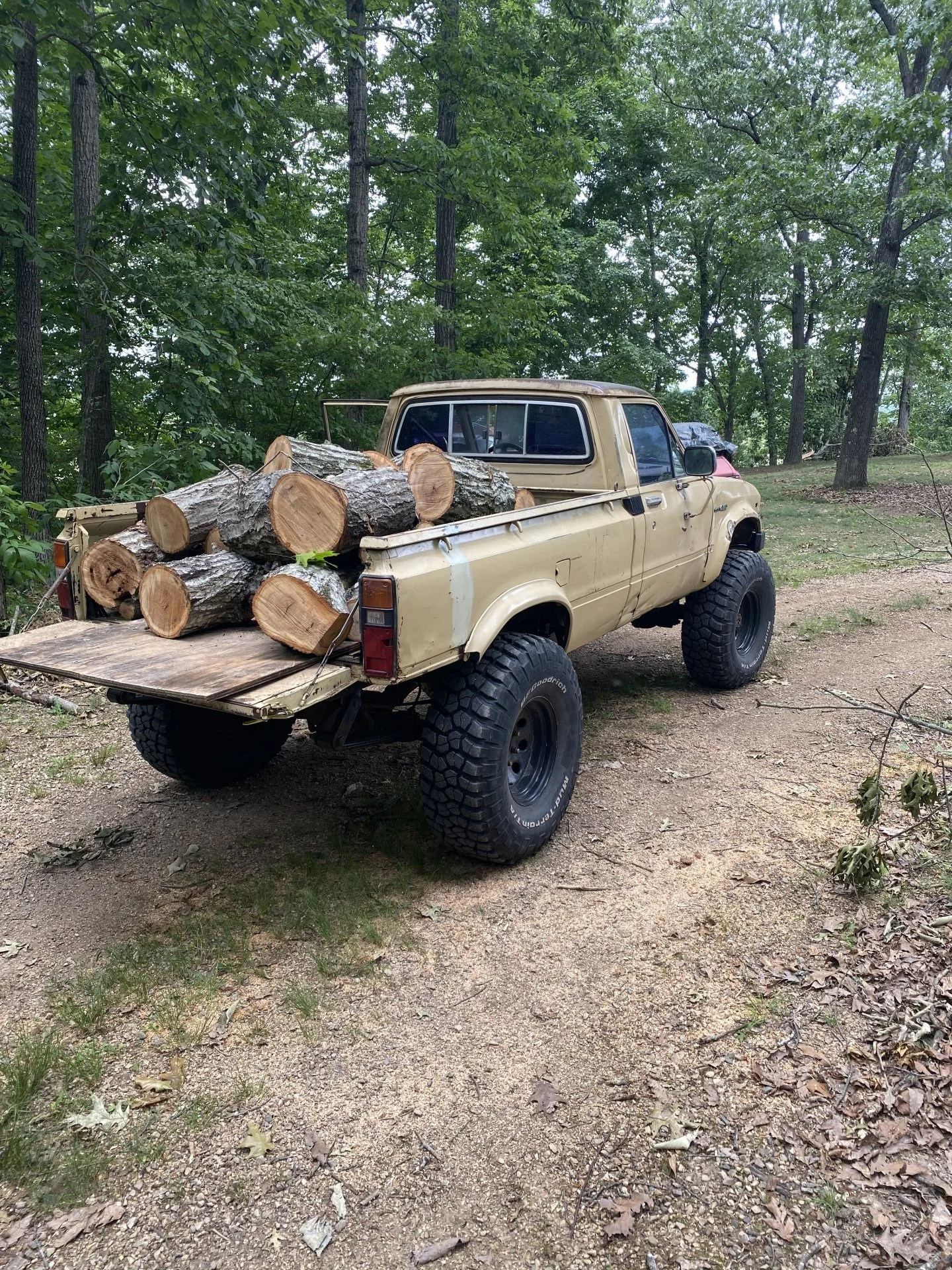

Replaced motor mounts and added some sound deadening and a vinyl floor mat and this thing is quiet*** now. I drive it to the dump and was almost civilized. Stupid slow, but not too sketchy.
Hauled some wood around

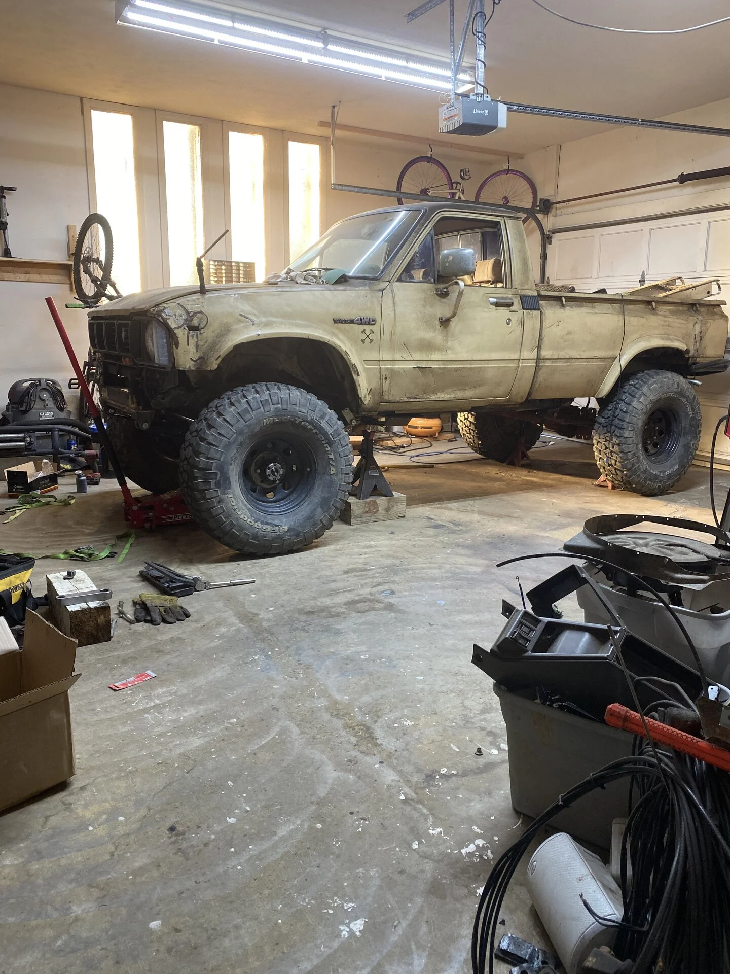

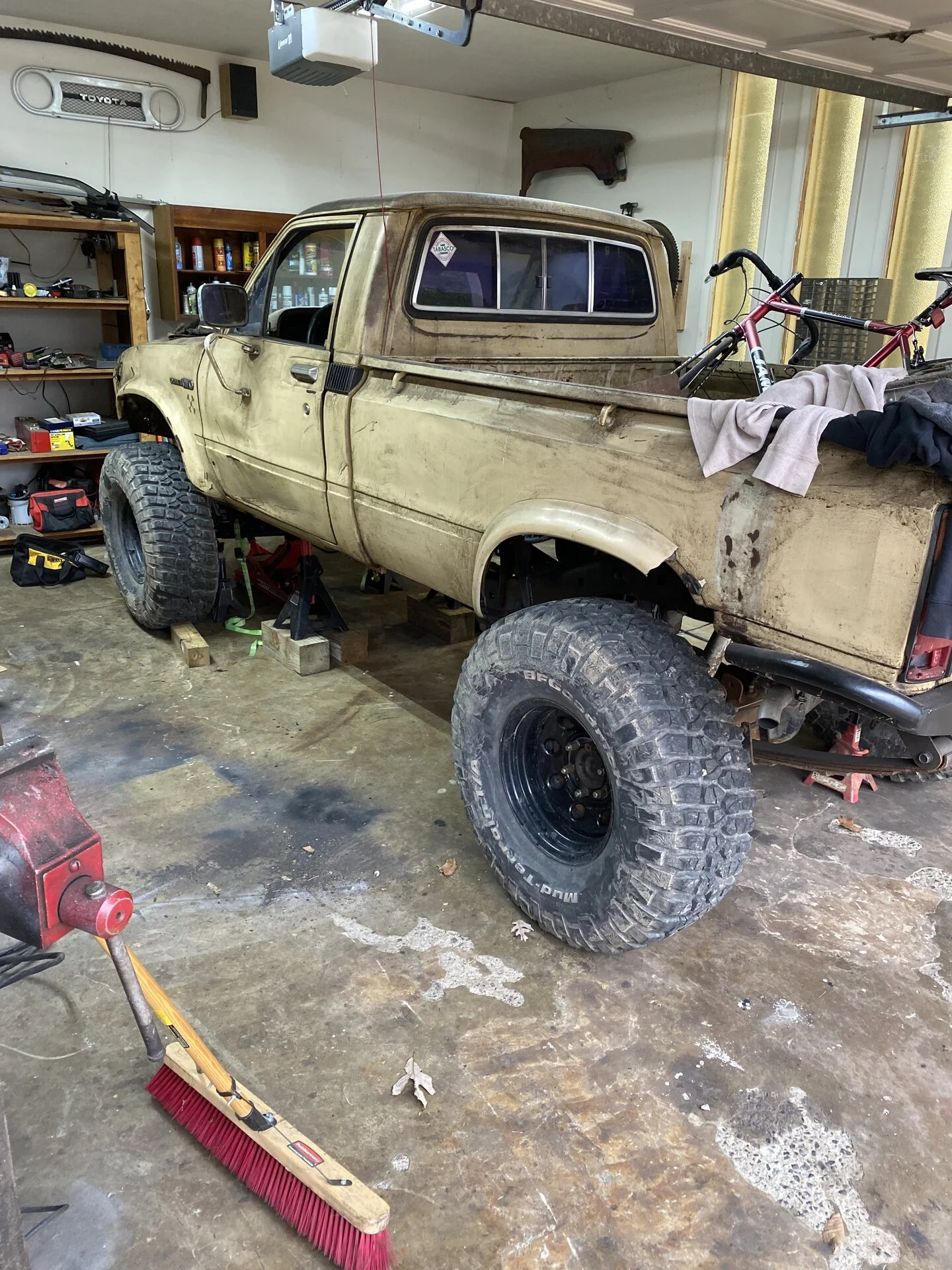

I just reworked the rear packs and dropped it about 1.75” in back. Hopefully I softened up the ride a little too - It couldn’t get any stiffer.
I’m in the process of replacing brake lines, and doing shock mounts in back. Then onto clutch hydraulics and finally rear main seal, w56 swap, RUF, front shock mounts, high steer and some kind of gearing.
Do you currently have power steering? If so, how does it handle the taller tires?
Feels fine to me. I haven’t had it in the rocks, but it was wheeled for many years on 33x12.50s with this push/pull setup. It has a pretty substantial drop relay rod on it.

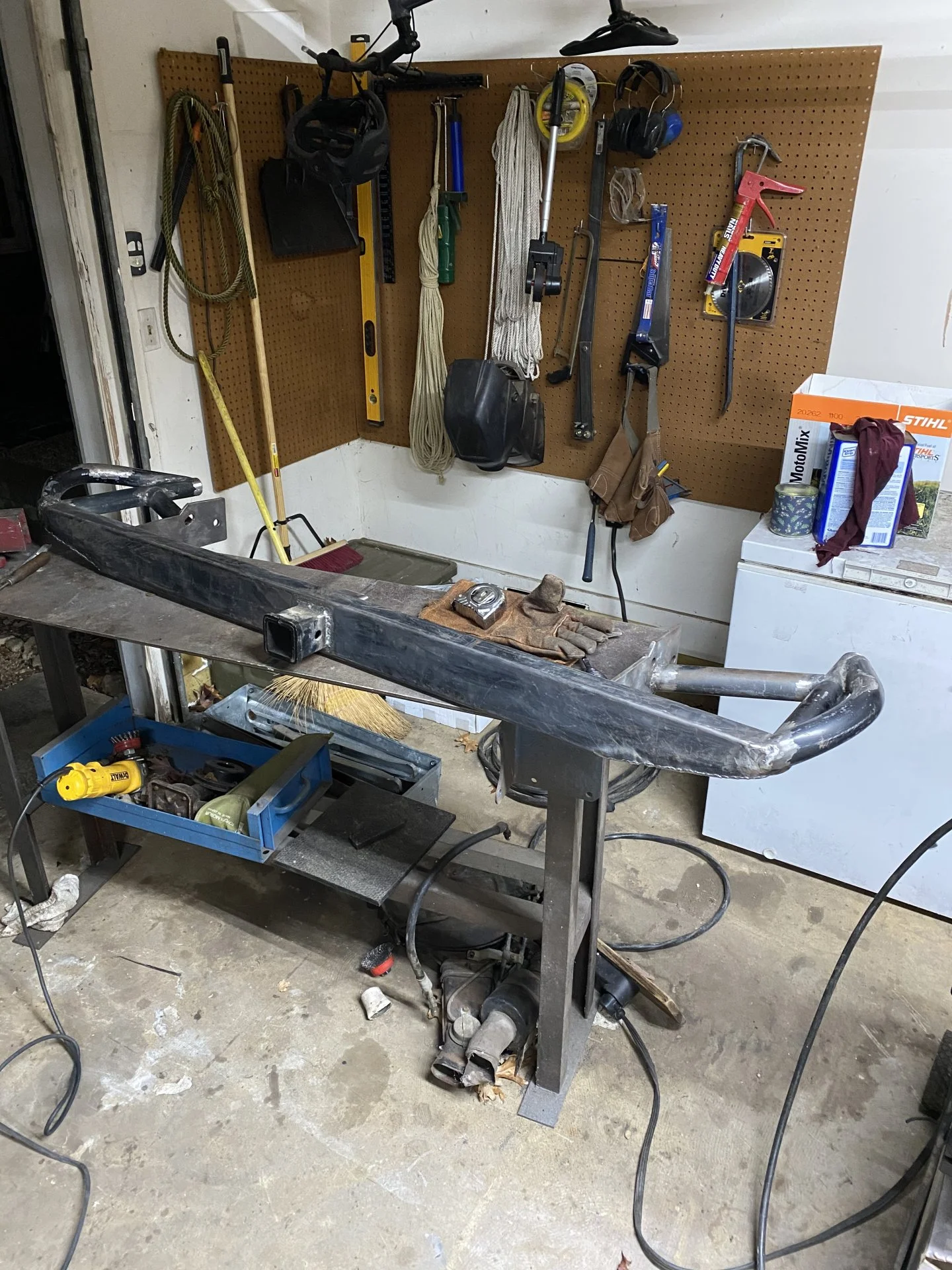

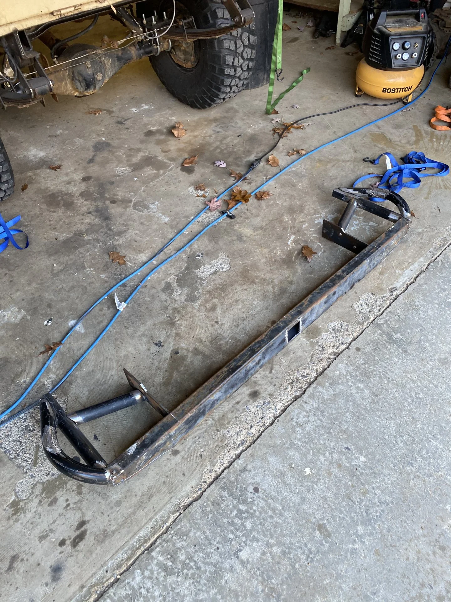

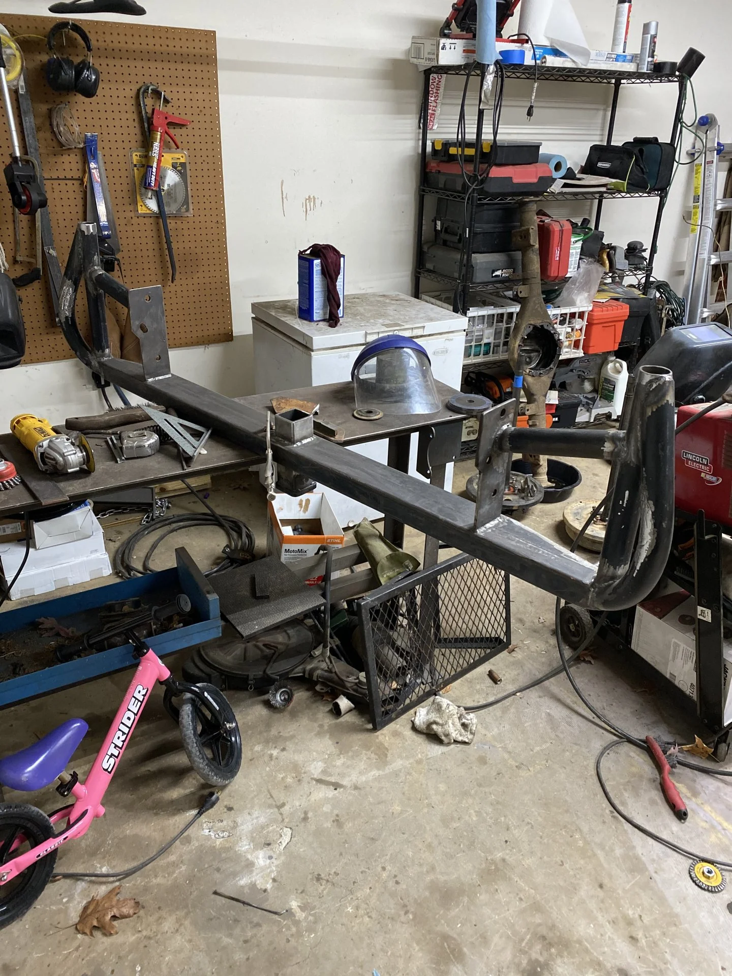

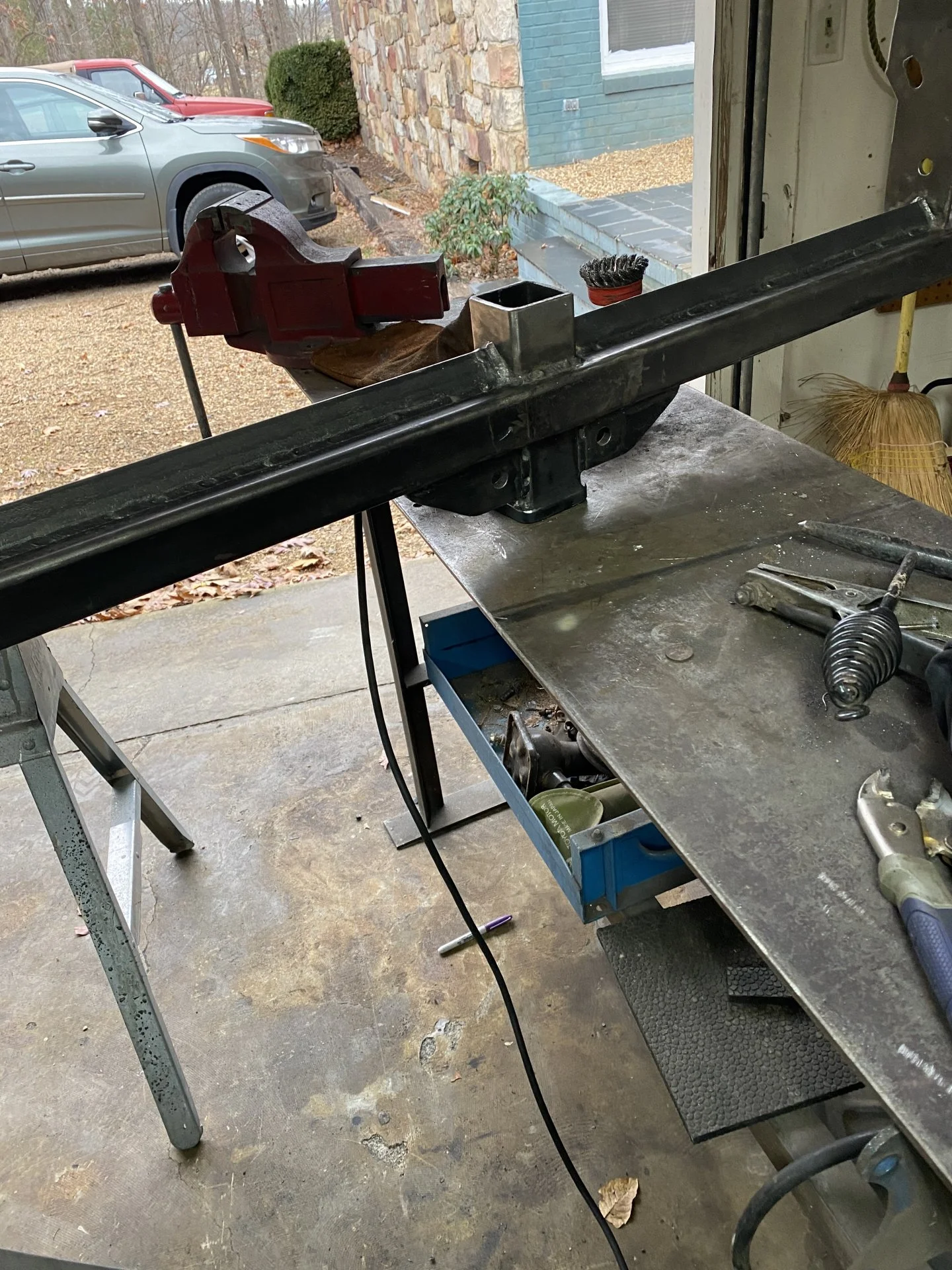

I needed a “fun” project so I decided to build a rear bumper.
The main square tube section is 2”x4” x1/8”. The receiver goes through the square tube and is welded on both sides. I’m never going to tow anything, but I might put a bike rack in the hitch. Main purpose is to use the receiver as a recovery point. I’m going to add gussets between the mounting plates and the 2x4 on the outside of the frame rails.
Question: do you think it’s strong enough the way it sits or is the 1/8” thin enough that I should add reinforcement to the backside of the bumper? I’m not an engineer, but I did stay at a holiday inn express the other night. My gut tells me more bracing/reinforcement of the hitch would be mo’ better.
Looking good man!

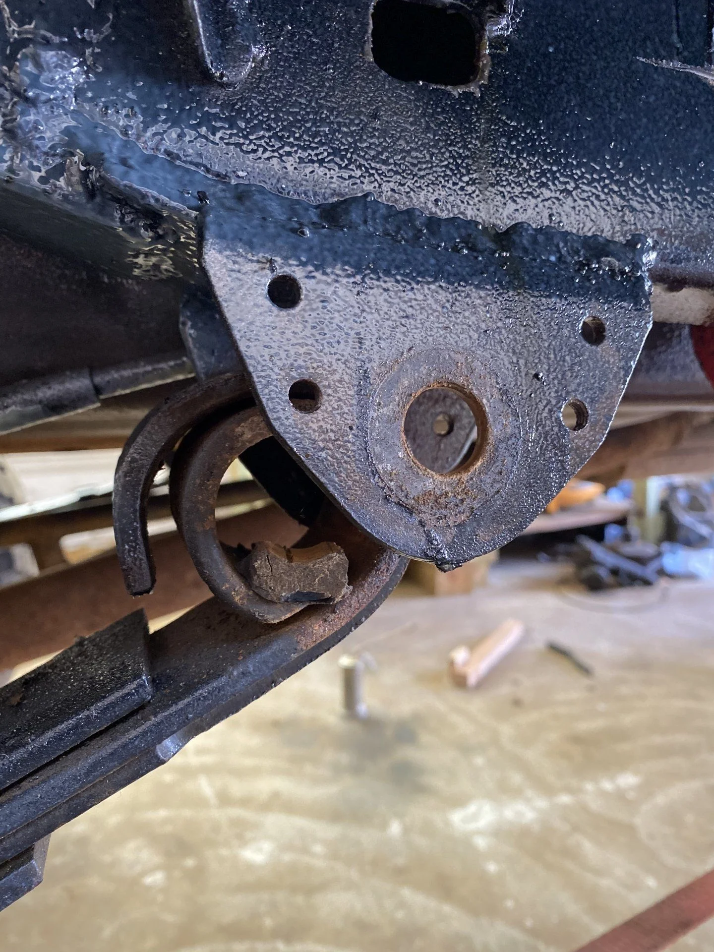

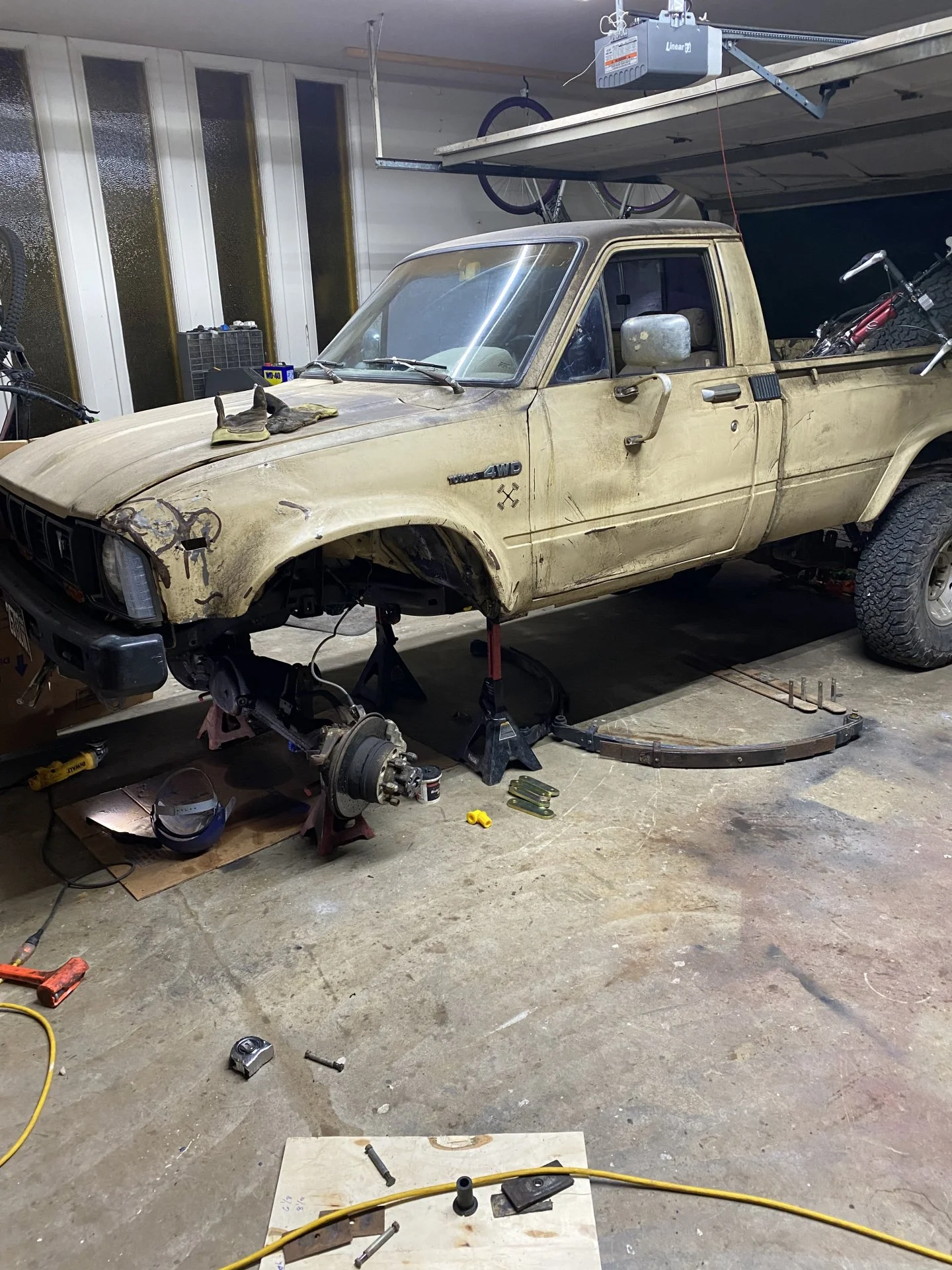

Started the addition of high steer with RUF. I built a homemade pack from some OME rear springs and some cut down factory leaves. It may end up too tall, but we won’t know for a couple months at the rate I work.
Bought the Allpro standard front hanger and shackle kit to mount the springs and a Marlin steering box mount.
Other plans are to install dual cases since I’ll be needing at least a front driveshaft after moving the axle forward, replace rear main seal, install a w56 with a new clutch, and new driveshafts. Look for me on the roads and trails in 2024 if gas still exists.
One crappy photo to keep everyone happy.

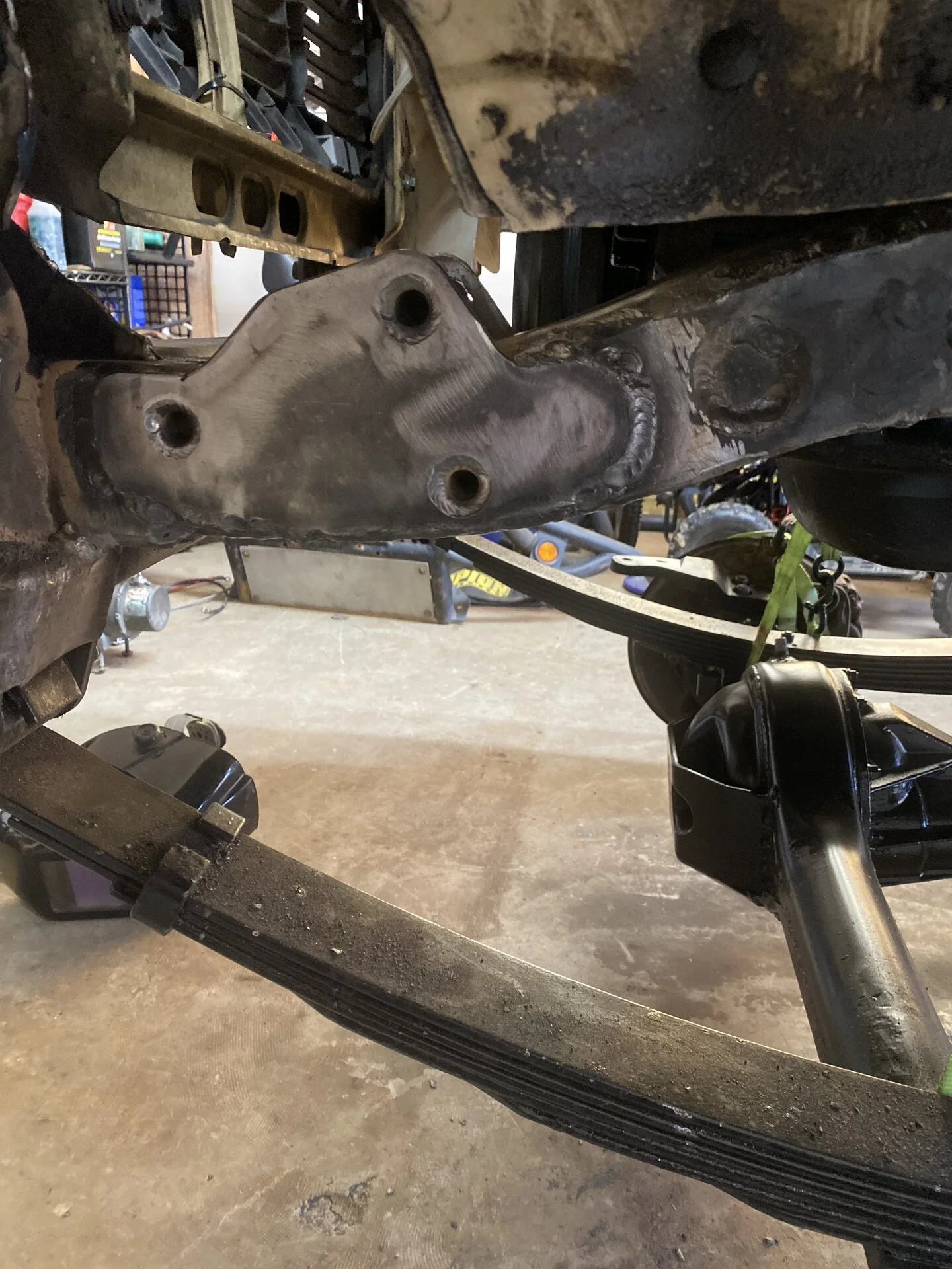

I cut all the old bracketed off the front and found lots of frame cracks and patches. Cut it all off. Welded up the patches and added full plates from the front hanger to the body mount under the cab. Then added my Marlin steering box mount on top of it all.

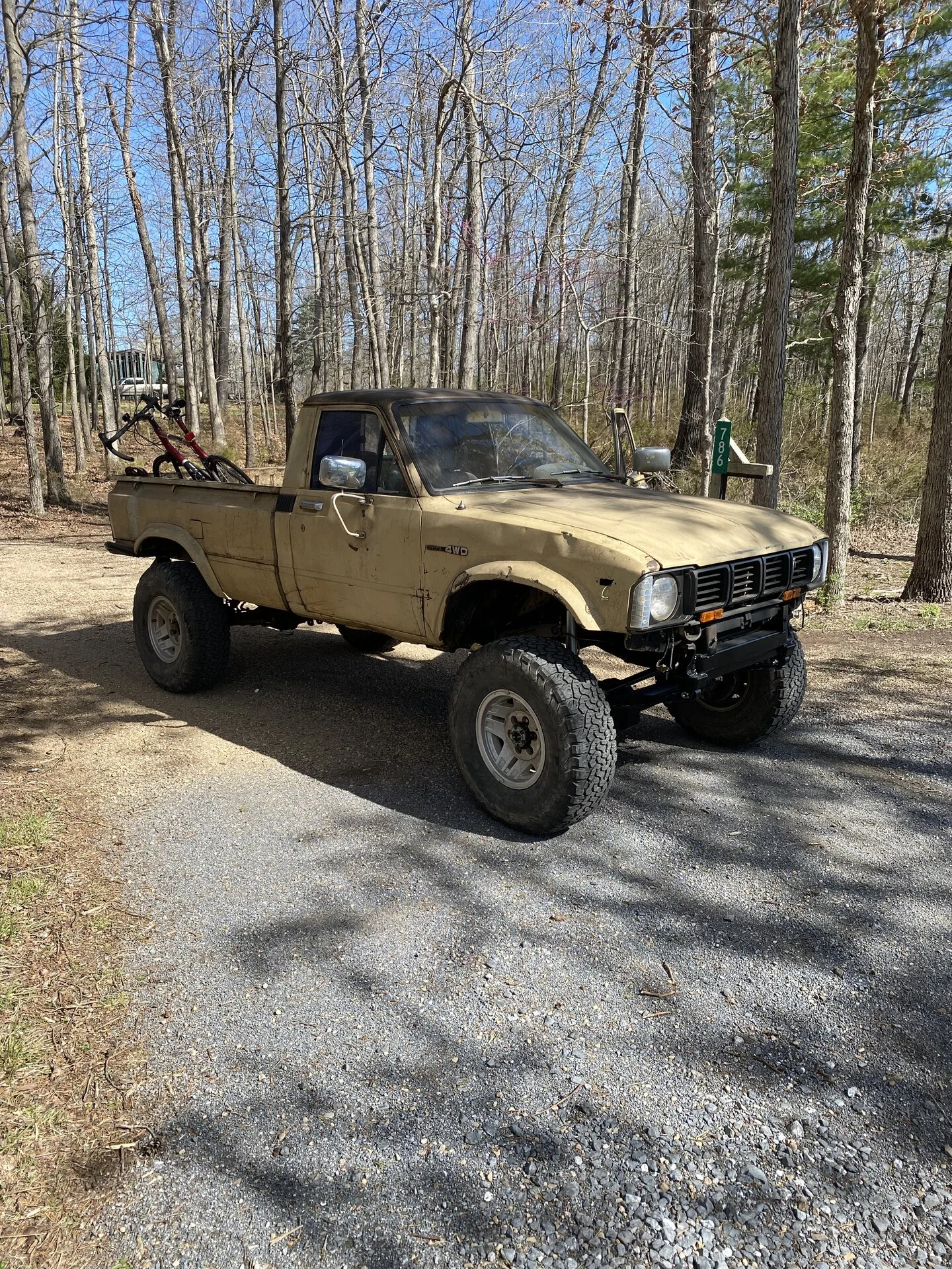

Puttered up and down the road with the kids and drove around my yard.
The splines in the rear shaft are trashed so I get some pretty good vibrations over 30mph and the exhaust hits the crossmember and a shackle bolt. Other than that it’s semi-civilized. Not trying to road trip it anytime soon, but it’s getting closer!

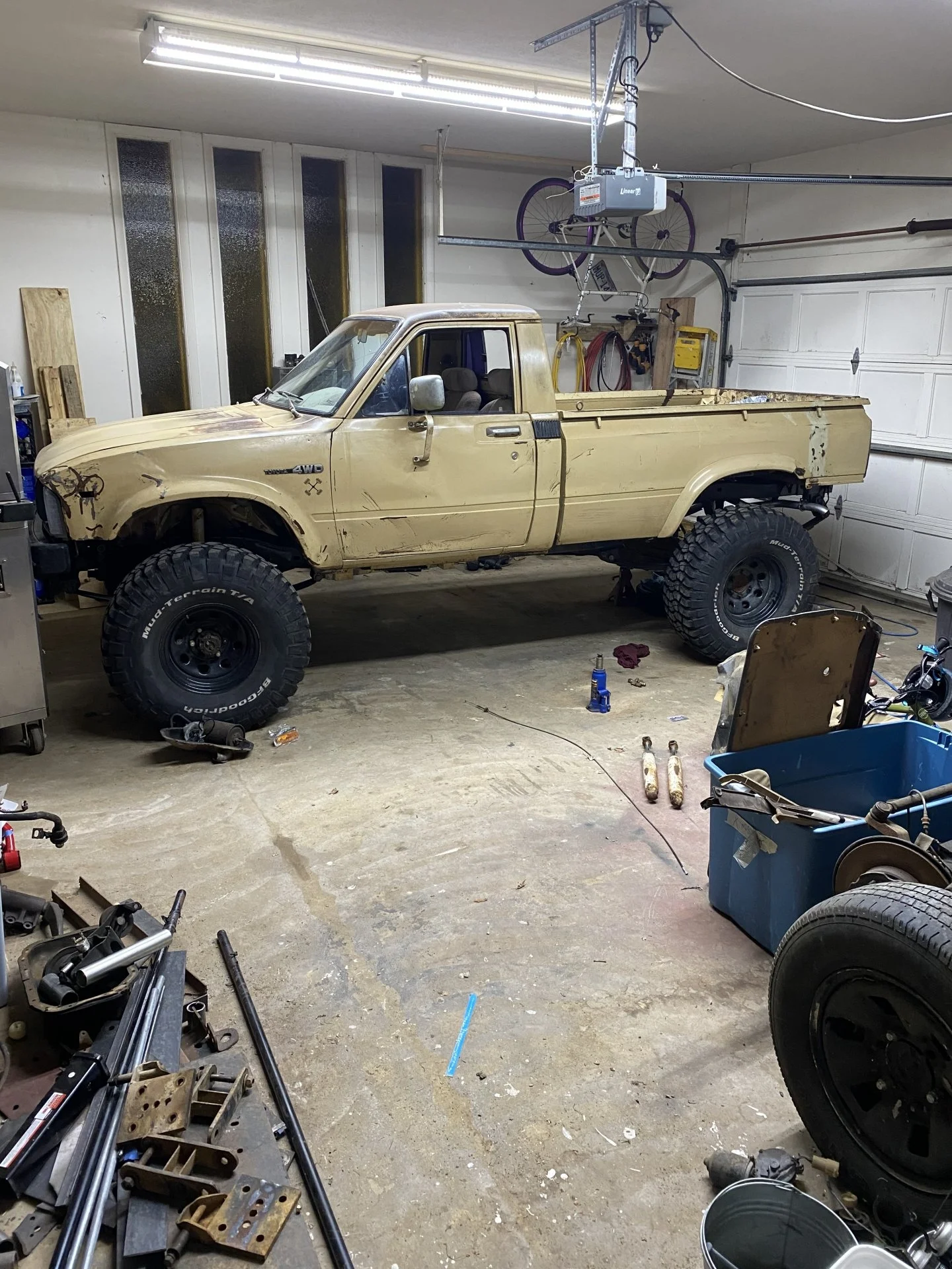

I’ve done some stuff, but I didn’t take any pictures of any of it.
Installed a new rear main seal. The old one fell out when I pulled the transmission. No wonder it was leaking…
Replaced the clutch and pressure plate.
Installed a W56 transmission mated to a dual case setup with 4.7 gears in the rear case. Rear case has a Tcase brake on it.
A tundra DC shaft fit perfectly in the rear and I had picked up a custom, long spline front shaft for a dual case setup.
Held it all up there with a dual case crossmember.

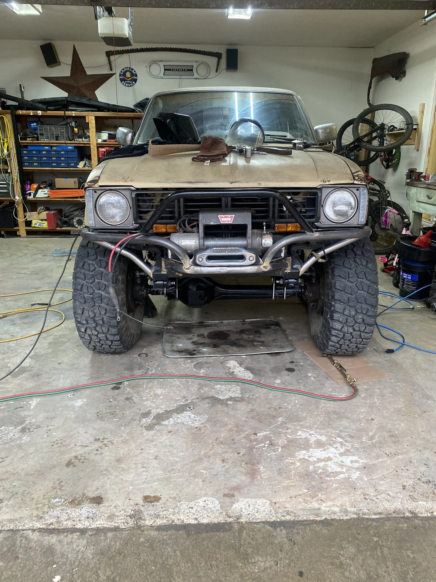

I’m in the process of building a front bumper:
And I picked yup some really sweet seats out of a 1990 Nissan 300zx. They fit the truck great and have tons of manual adjustability.
Front bumper looks killer! Is it too late to ask if I can have this one back?
