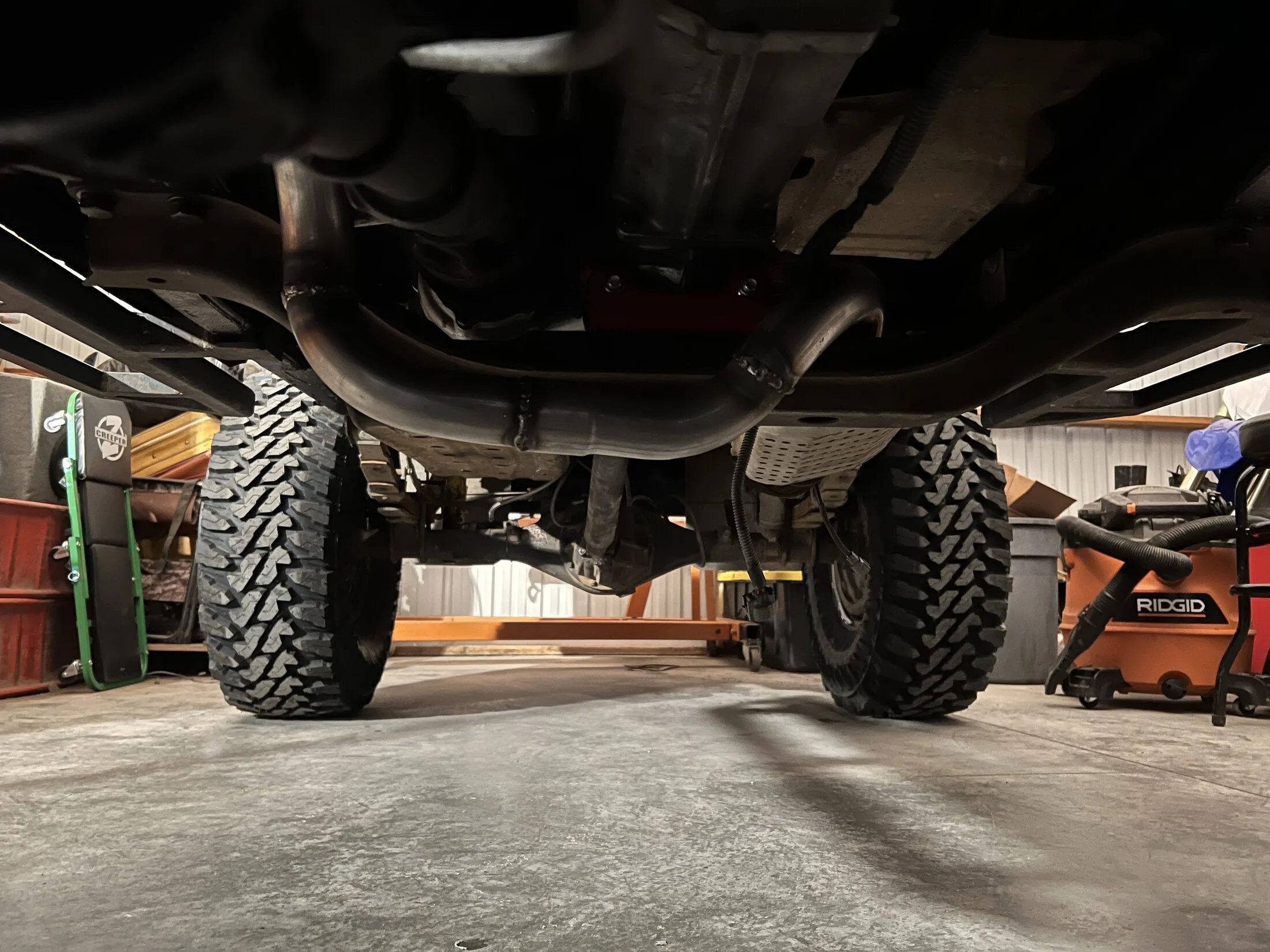

One issue I had was with the exhaust. I run a high-pinion diff out of an 80-series. The cross-over pipe smacked the diff. Solution is to go back to a low pinion. Fortunately, I have a V6 diff in the garage. I just need to regear, and have the ARB I have installed.

How about running the exhaust back around the transfer case? That's how mine is largely for smog reasons here, but I also love my high pinion and wouldn't ditch it unless I had no other option. It will make removal of the trans easier in the future as well. Although prob not a concern with a R151 and fresh clutch.
When I was at the muffler shop we looked at running it behind the TC. I can't remember why, but we couldn't make it work. As far as tranny removal, I had them install a flange at the cat to make that piece of pipe removable.
This is how I ran my exhaust. Flanges on both ends as well so it can be removed easily to stop the transmission if needed.

Here's my routing for reference. By the time you have it regeared, setup kit, install done it may be about same cost to just reroute exhaust if it can be done like mine and keep your HP. Just throwing ideas.

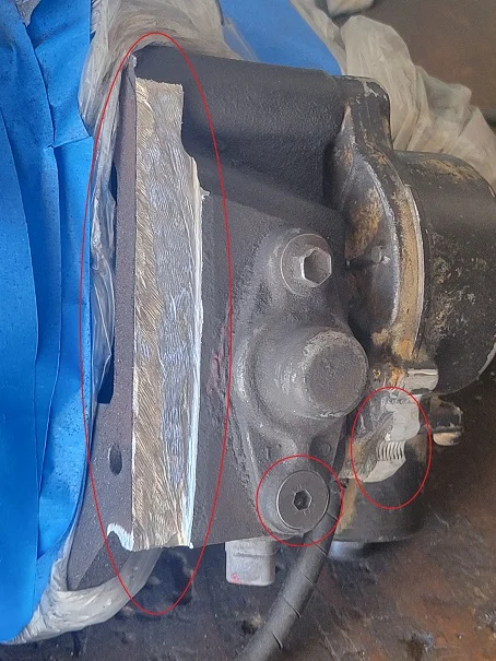

A few updates. I was able to source an elocker out of a 4Runner. It's well known that the axle housing needs to be modified. But, so does the differential housing to work in the front. There is interference between the housing and a u-bolt, and the spring hits the actuator. One bolt hits the spring and the solution is to countersink the hole. The second is an ear that hits the spring. That can be removed. Last, the edge of the housing needs to be ground to clearance the u-bolt. I've done some grinding, but I suspect I will need to take off more. I'll wait until I can test fit before I take off more.

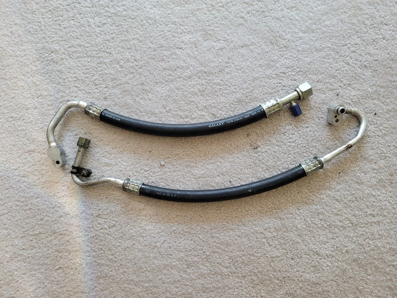

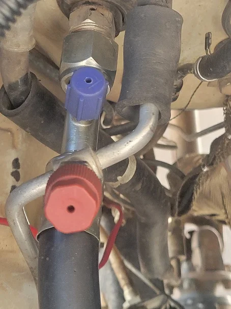

I boneyard sourced an assortment of compressor fittings that I thought would work. Because my 1985 had the service connectors on the manifold I needed to add fittings inline. The hard line from a 1988 4Runner was the ticket. I also used the low side evaporator fitting from the same truck. Both had service ports. I mocked up the hoses, then took them to a local hose shop. They made me new hoses. The shop actually had the evaporator fitting with the service port in stock, so they gave me back my old one.

Service fittings at the firewall. The port with the blue cap is the fitting the hose shop stocked.
New hoses.
