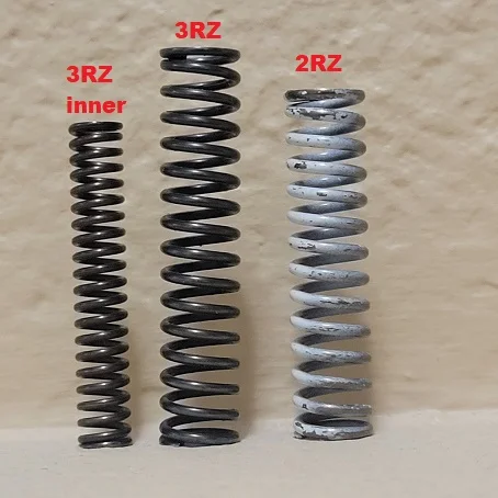

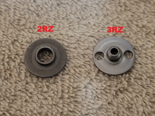

Back at it. I sourced the 2RZ oil pressure relief spring from Toyota. It's the same diameter as the outer 3RZ, but half way in between the inner and outer in length. The retainer was also different. At some point I will install the 2RZ spring and see what happens.

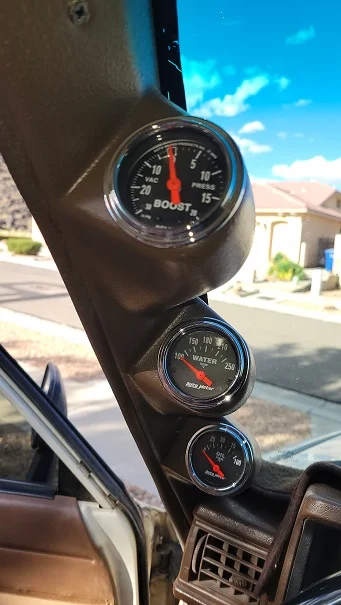

Since it indirectly came up, here is what I did for gauges. I used Autometer gauges, Boost, Oil, Temp. The gauges are mounted on a 3-gauge A-pillar pod. This pod was sold years ago, and is no longer available. It looks like the fella is still selling a 2-gauge pod through LC Engineering.

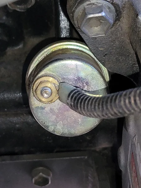

For the oil pressure sender I used a metric adapter to screw the sender in the factory location. The only thing I needed to do was clearance the AC mounting bracket. There is a sender used on 1990-1995 trucks and 4Runners that is supposed to work with our gauges. I did source one from the boneyard, but decided to use the Autometer instead. Note that the donor trucks are all idiot light and didn't have gauges for the oil. You cannot hook up the idiot light sender to our gauges.

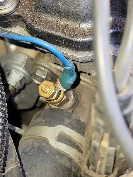

For the temperature sender I also used the factory location, but I didn't use an adapter. The threads on our trucks is metric British pipe thread (BSP) where the Auto meter gauges are National Pipe Thread (NPT.) I sourced a water outlet from the boneyard (in case I messed up) and ran a NPT tap through it. I didn't bother to drill since the outlet was aluminum. The sender went in tight and doesn't leak.
Gauge pod.
Oil pressure sender.
Temperature sender.
