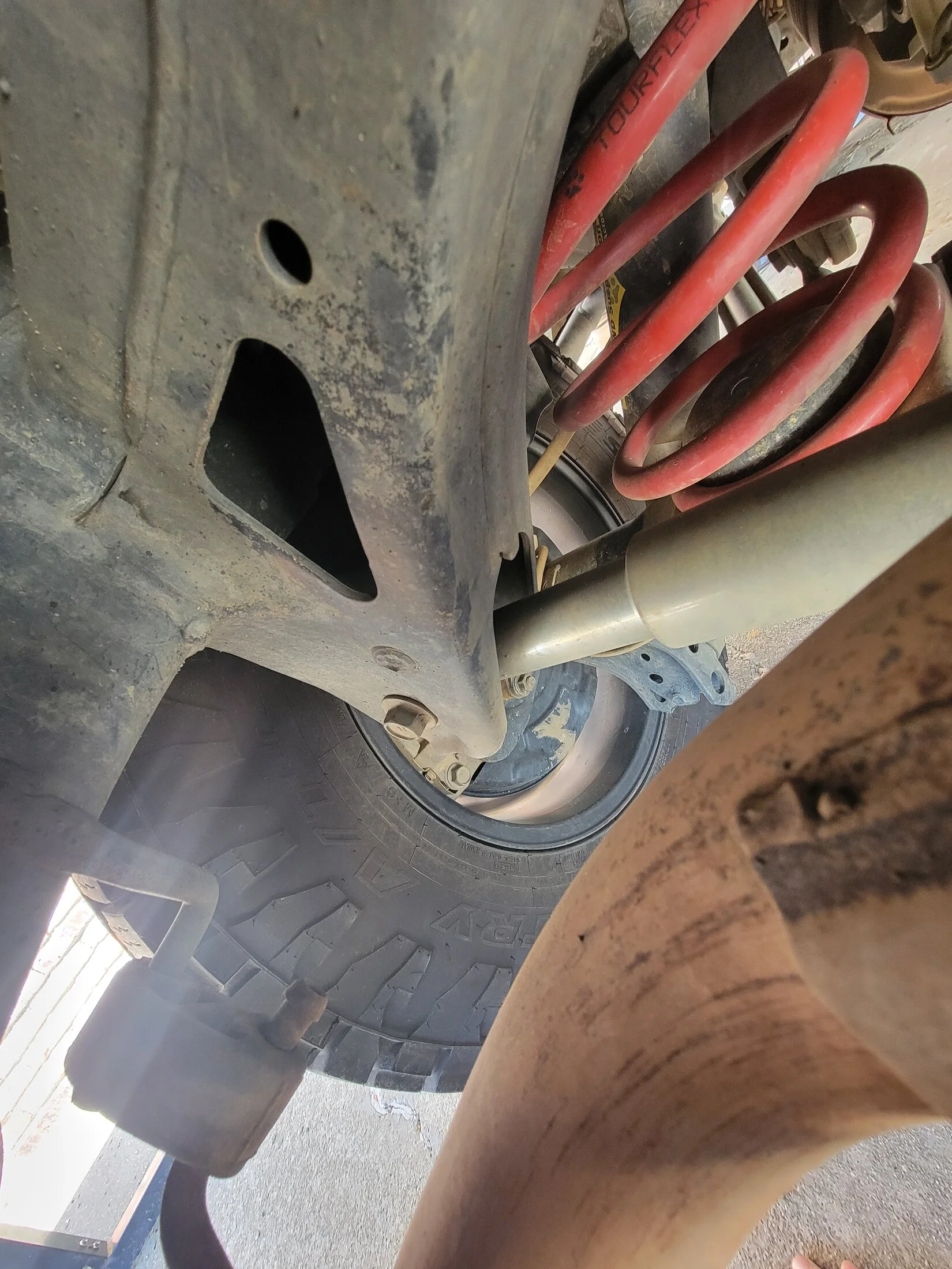

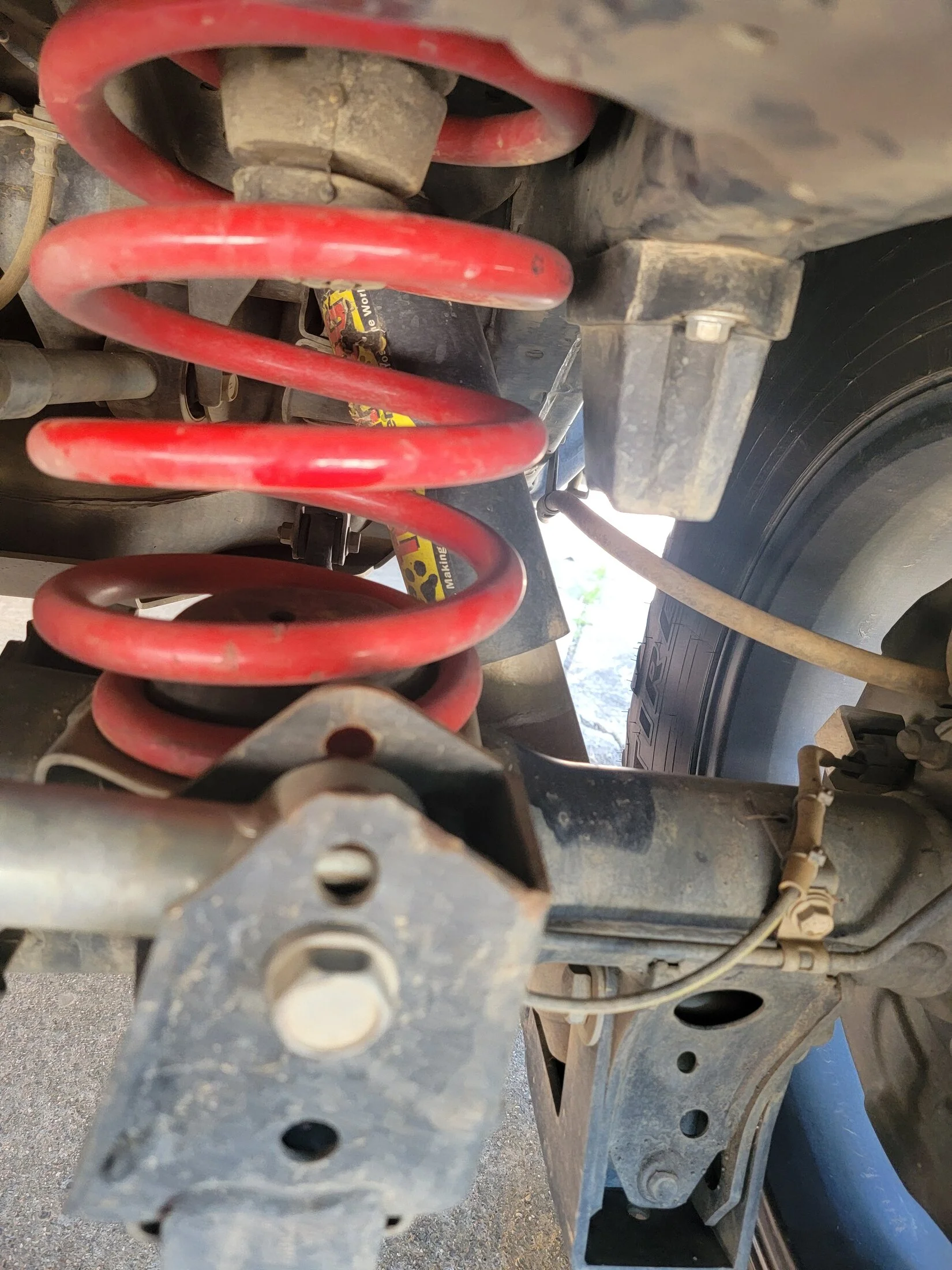

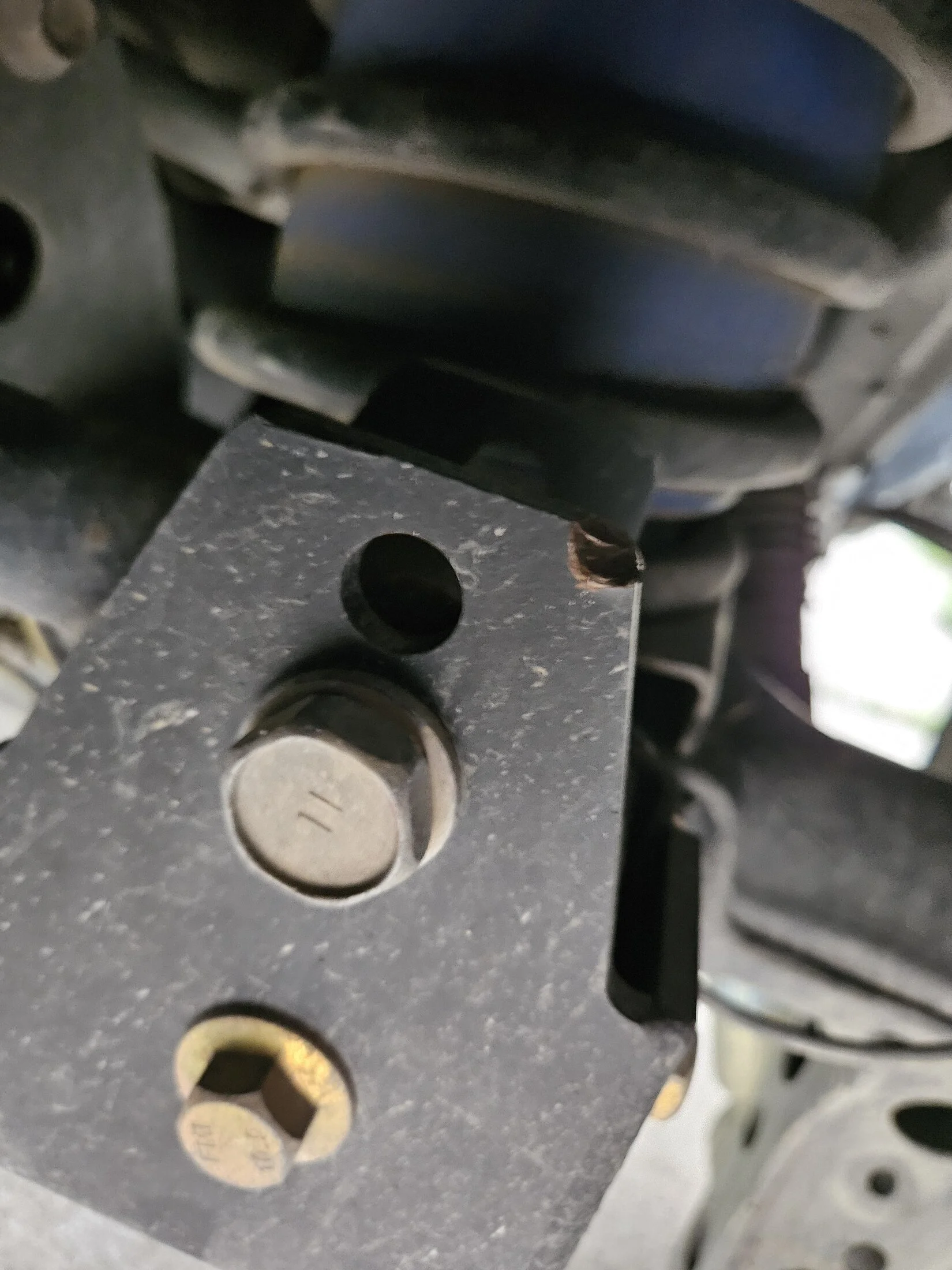

Is this the type of BOTCK damage you're talking about? I have not been riding mine hard by any means, this is pretty much entirely from coming out of a parking lot with a big dip and driving at a certain (low) speed and angle, so the rear end sort of bounces itself a bit extra (kind of like a kid bouncing another kid on a trampoline). When that happens, there's a definite hard metal-on-metal hit (jarring both physically and audibly). I think I'll need to trim the top off mine even for daily driving.
Yea that definitely contact. Mine is so bad from jumping the LC 🫣🤦🏻‍♂️!
This is why if you don’t have a really high lift , I have the short version.
Got it, thanks for the quick response. I will trim mine down to shorty stature.
For reference, in case anyone else is wondering if their tall BOTCK might make frame contact, I'm running a 2" lift (Bilstein B12 rear springs that claim 1.75" but give 2.0").
No sign of contact for me so far, but I’ll be watching it closer now
Unless one is running a taller bump stop limiter, this seemingly should be critical to address, whether there is currently contact or not.
It's a liability waiting to happen. Damaging the frame or axle bracket definitely should be avoided. Then there's concerns for a severe and unmanaged bottoming out event resulting in the loss of control. Yes, bump stops are not ideal either, but as least they are an engineered stop.
