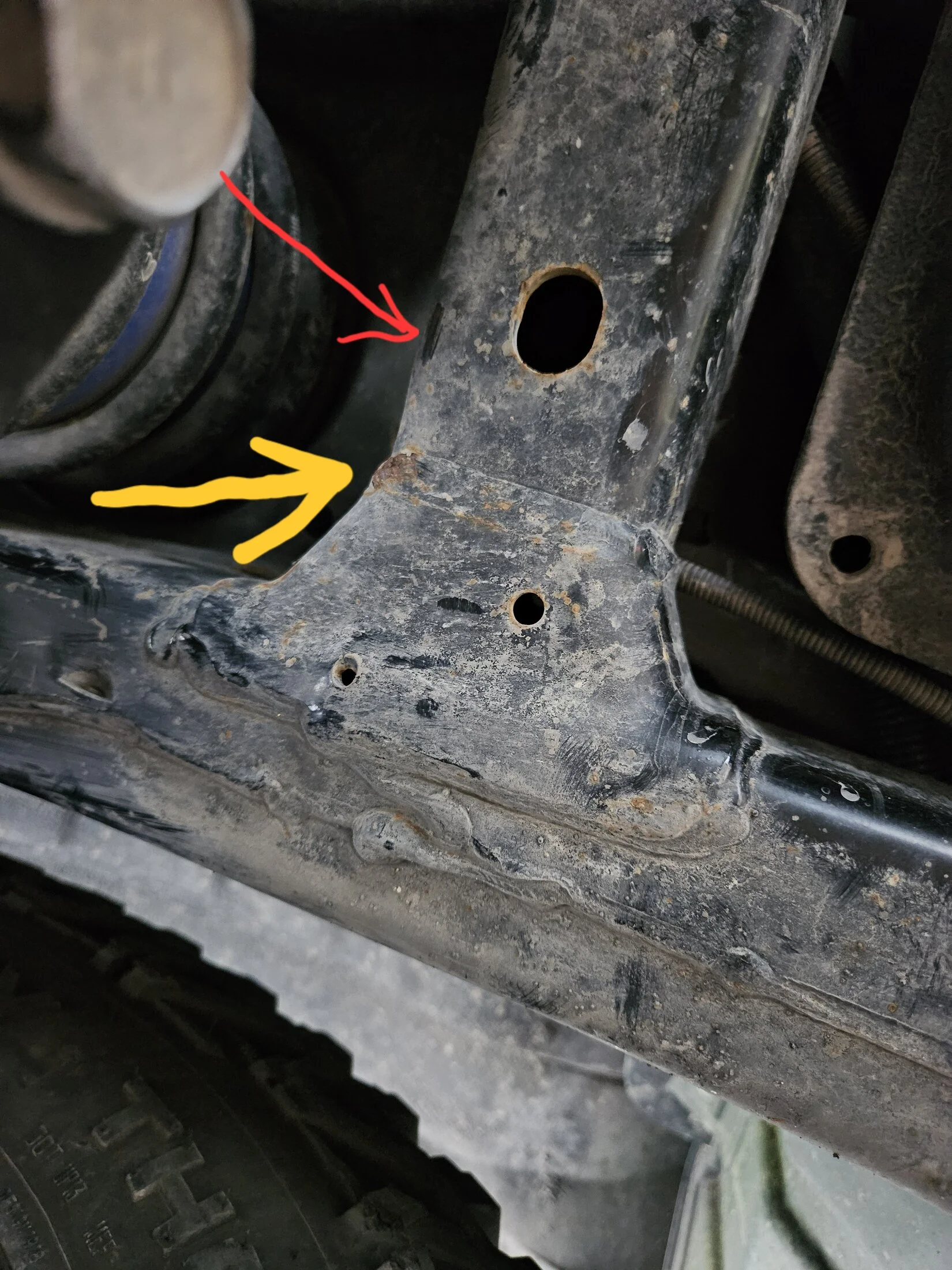

Ok here’s the damage report. Lol also yeah I kinda exaggerated the frame damage 🤣🤦🏻‍♂️. For some reason the last time I looked (baja and super dirty ) I guess it was just real dirty. There’s basically a ding. I fully used the bracket as a bump stop over many many miles down in baja with confidence based off data in the jeep, ram and 4runner world. We have sold prob over 25k brackets or more. s*** I’ve sold about 5k 4runner brackets in the last 1.5 years !! It’s truly been a blessing !!

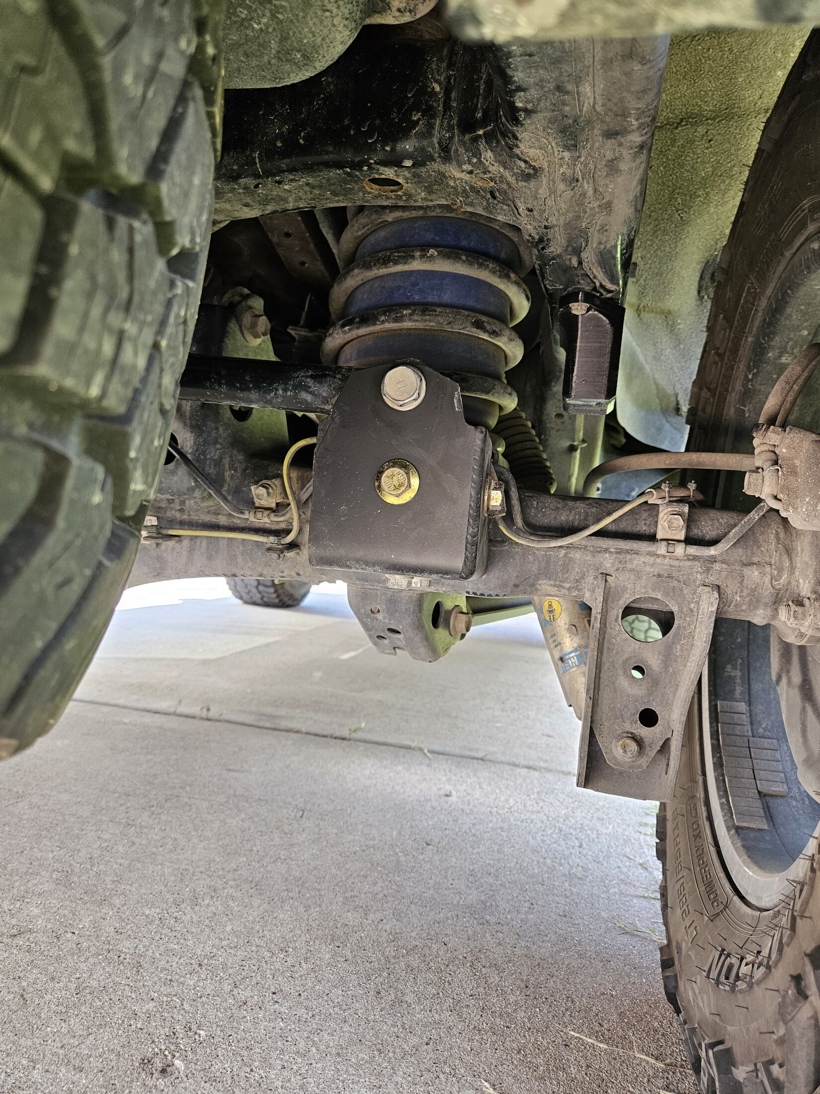

The bracket has been great, appreciate the R&D to bring this to the 200 series, as it's a niche market in comparison to the other 4x4 toyota platforms. I never even new it was making contact, no noise or anything to report. I came across the contoured top incidentally during some other suspension maintenance.
No limit of travel, my 34" tires are making contact with the fender well at full compression/articulation on both sides.

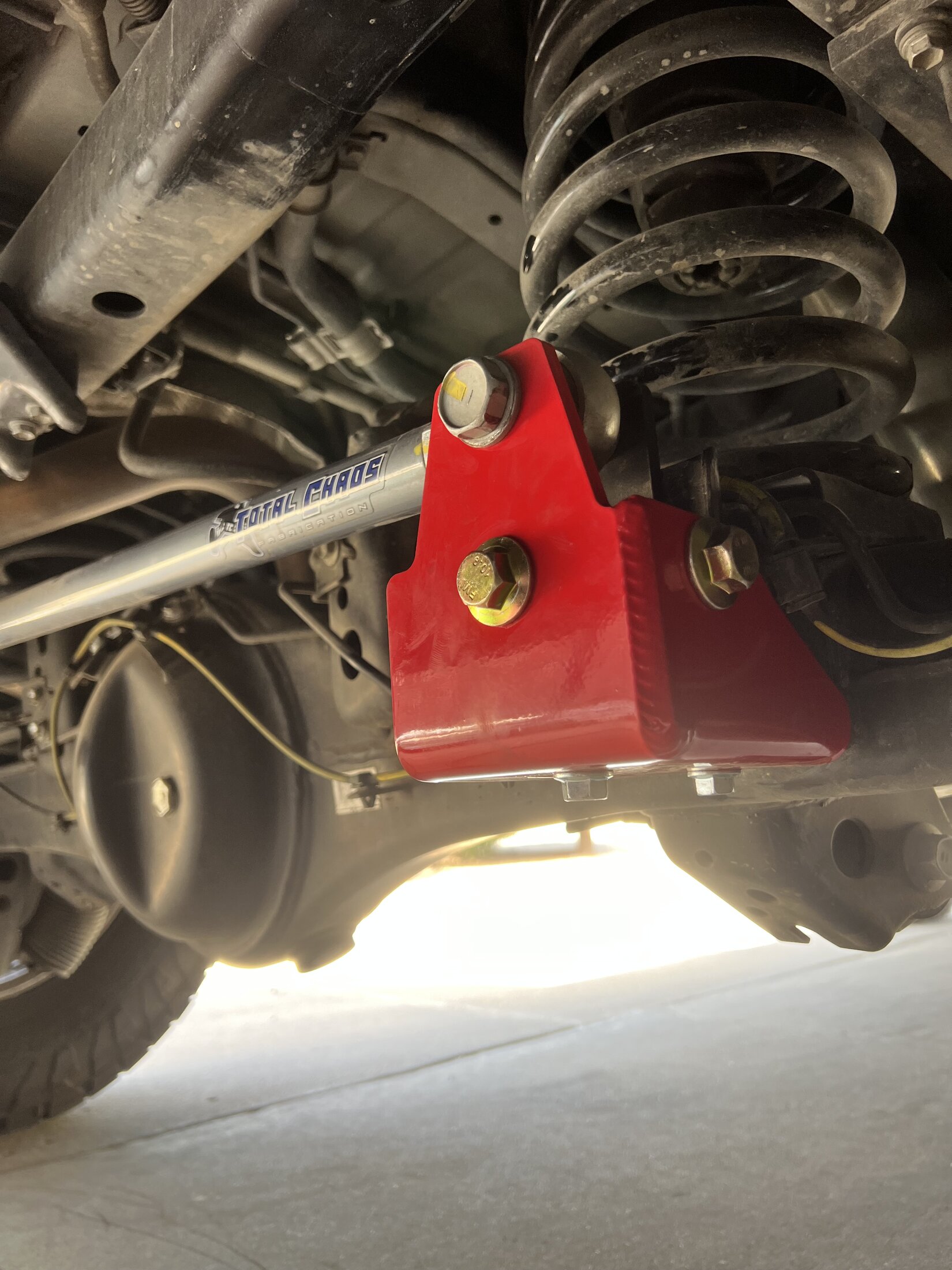

Installed one of the Dr KDSS brackets after binge reading this thread, I feel like an idiot for not doing it sooner. Absolutely cleaned up that weird little "wag/wiggle/instability" I was feeling and brought it back to that factory planted feel. For those debating, I'm on an OME nitro charger setup with the shim spacers and 34s, used the top hole as I don't run super heavy most of the time (not towing much anymore), just some ADGU drawers in the rear.
If you're on the fence, strongly recommend, truly the best ~$200 I've spent in a while on the truck.

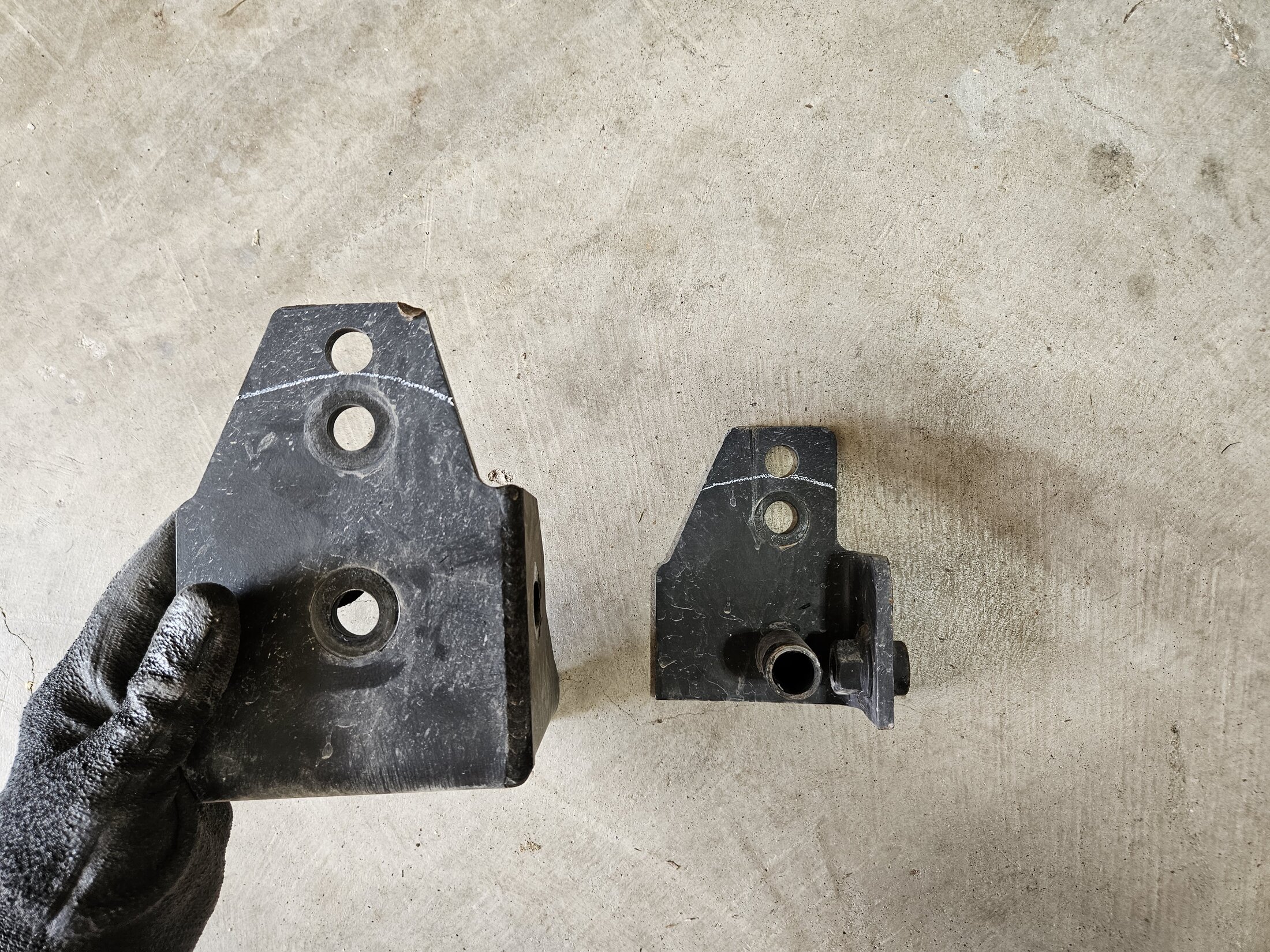

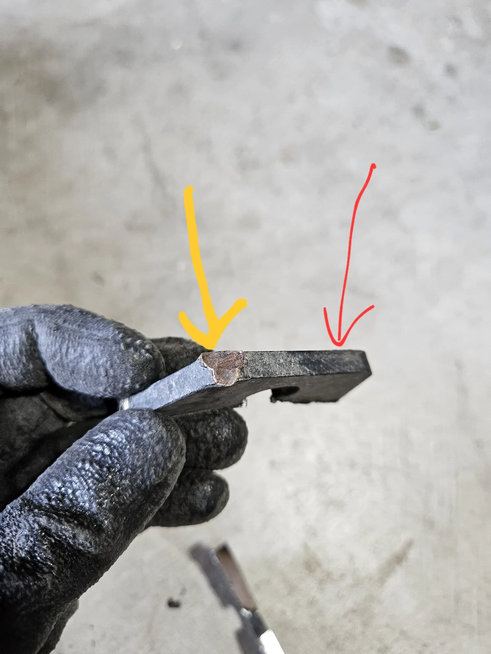

Trimmed and painted my BOTCK so it would no longer make contact with the frame. You can see the witness marks where contact was happening (one major, one minor, right next to each other).
Thanks for posting this.
So is this basically the “shorty” version of the bracket now?
Placing an order shortly
Yes, I basically cut mine down to match the "shorty".
