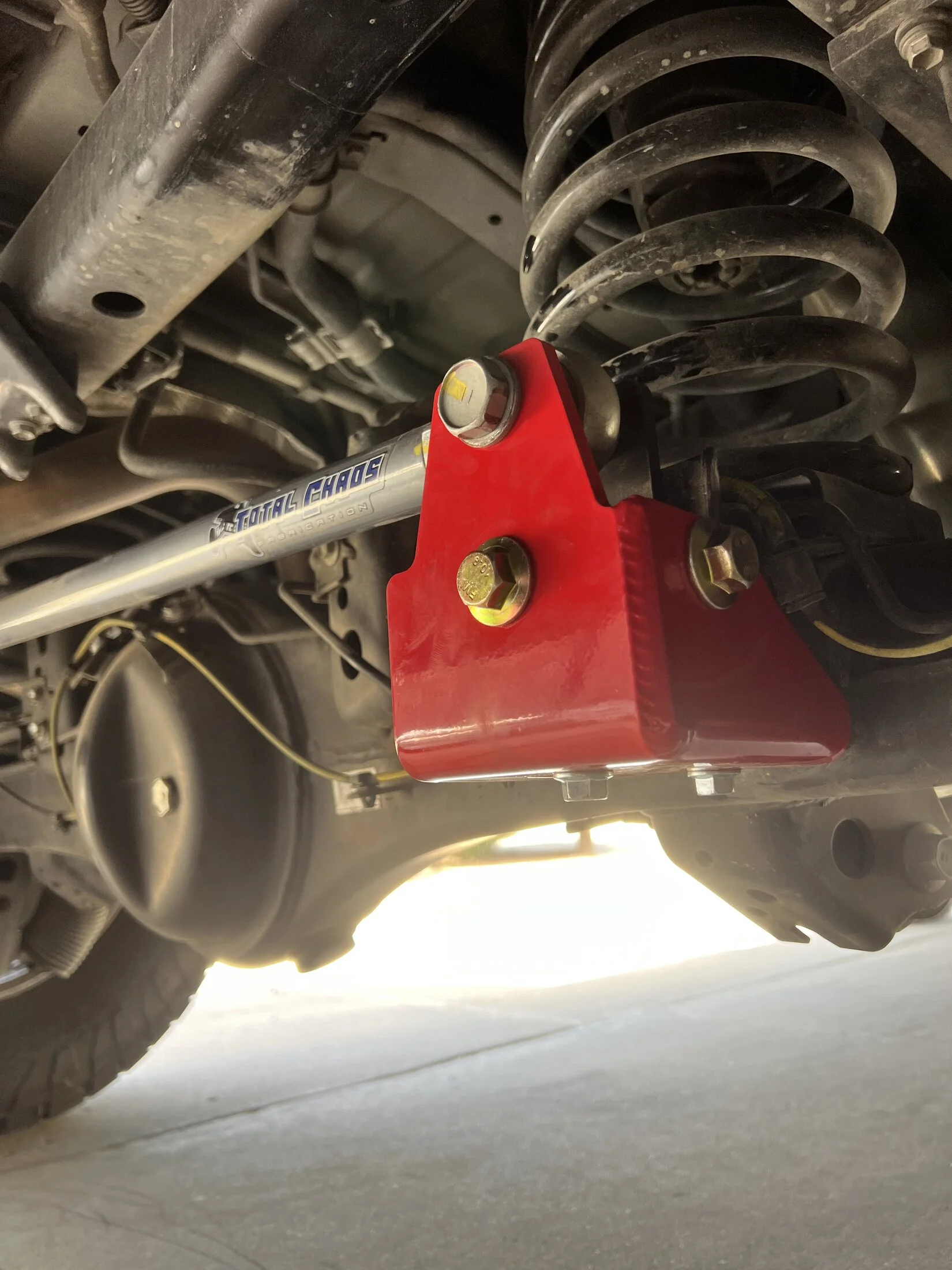

My drkdss bracket arrived a couple days ago and I installed it this morning… coming to this thread to comment on my install and I see @drkdss himself, posted, after my bedtime, some details I wish I had read before completing installation, more on that below.
Install with the 40 gallon LRA is possible but you have to get creative with your jack and attach the track bar loosely first thing or you will not be able to get that bolt in later.
After some trial and error I got everything loosely installed and torqued in the order shown on the install video. Based on post #420 of this thread I did that calculation and was over 3, 4.25 in fact, so I used the top hole. Track bar is now reading level on a bubble level. Based on @drkdss after bedtime post (#425) I may or may not want the track bar level and a post install drive could be confirming this as my steering wheel is now slightly turned right but truck seems to track straight. This could also be completely unrelated due to an ongoing alignment saga which currently has my caster set 3.3 on left and 3.0 right. I know, I like to complicate things 🤦‍♂️

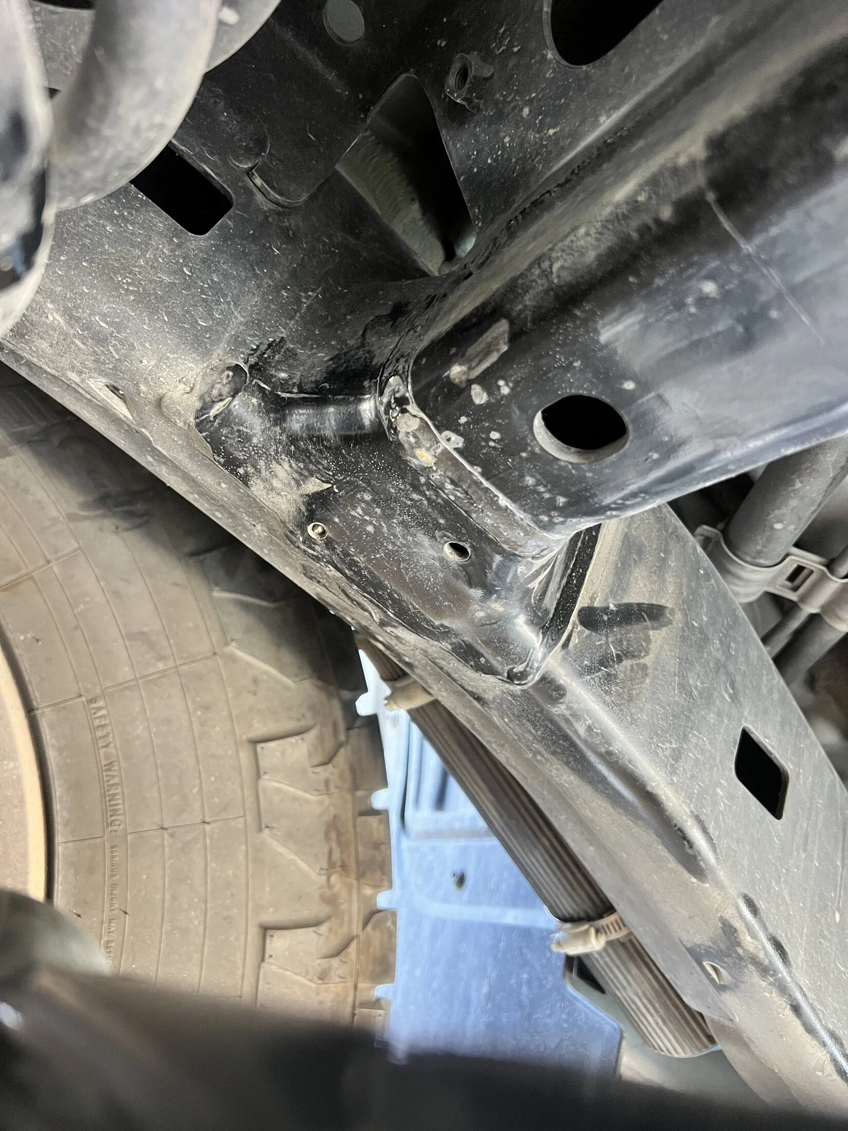

Ok here’s the damage report. Lol also yeah I kinda exaggerated the frame damage 🤣🤦🏻‍♂️. For some reason the last time I looked (baja and super dirty ) I guess it was just real dirty. There’s basically a ding. I fully used the bracket as a bump stop over many many miles down in baja with confidence based off data in the jeep, ram and 4runner world. We have sold prob over 25k brackets or more. s*** I’ve sold about 5k 4runner brackets in the last 1.5 years !! It’s truly been a blessing !!

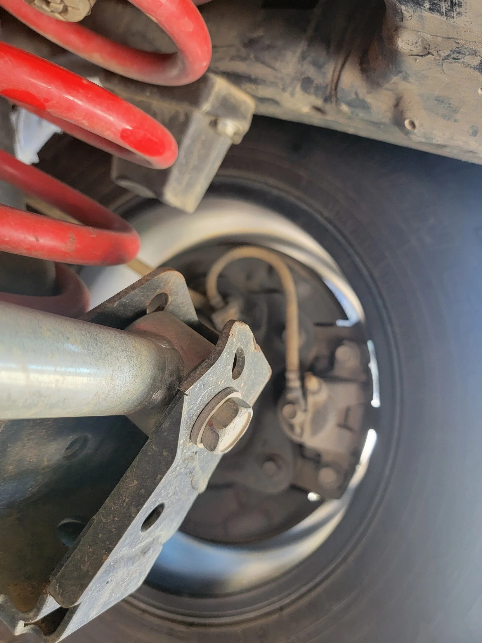

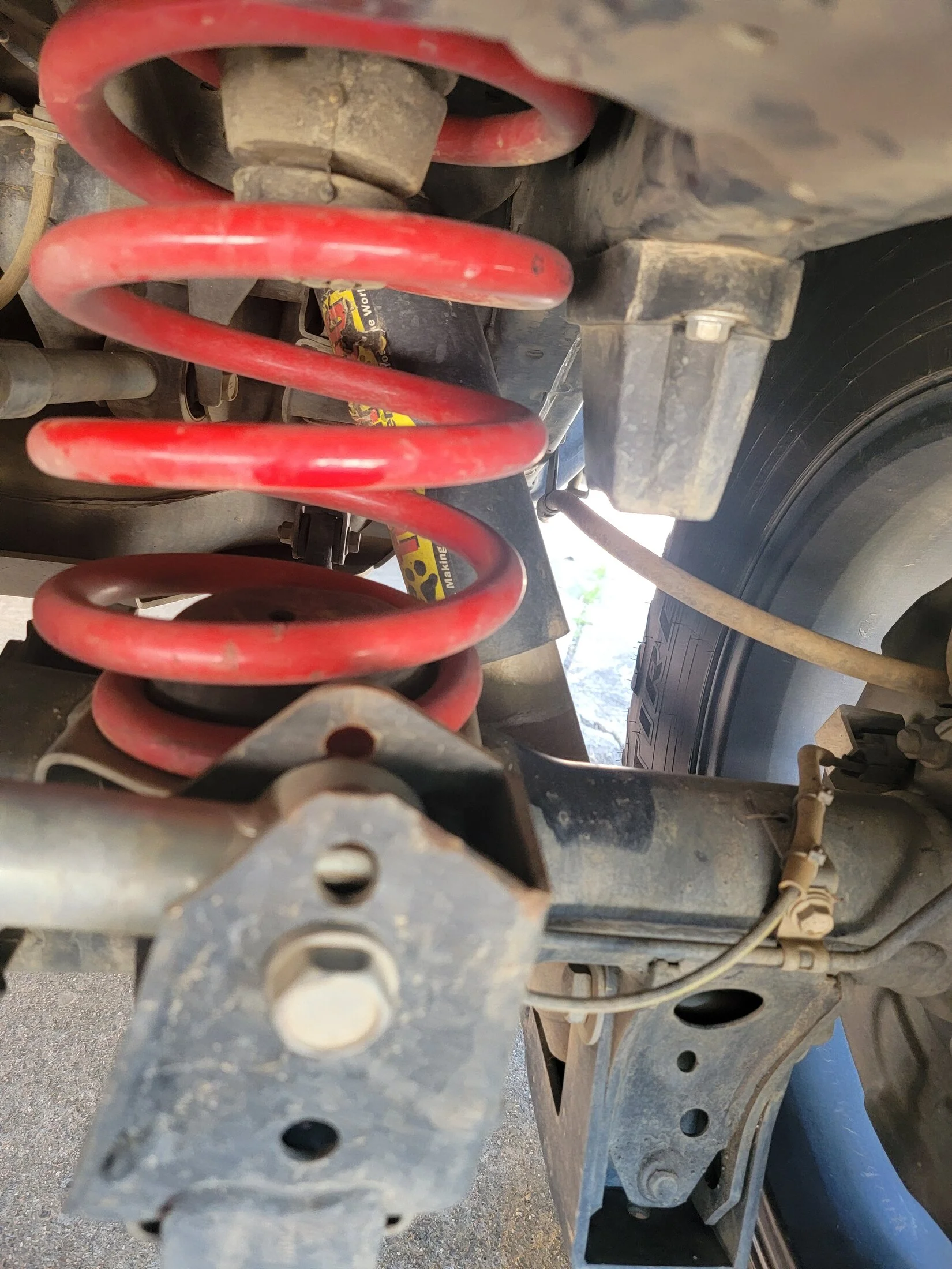

Progress report.
I moved track bar to the lower hole on the DRKDSS bracket, based on the drive afterwords this is the correct one for me. There is about a half inch more rear tire sticking out the passer side versus drivers side, looks like to get the rear end perfect I’ll be looking at adjustable track bars, would trailing arms also need to accompany this?

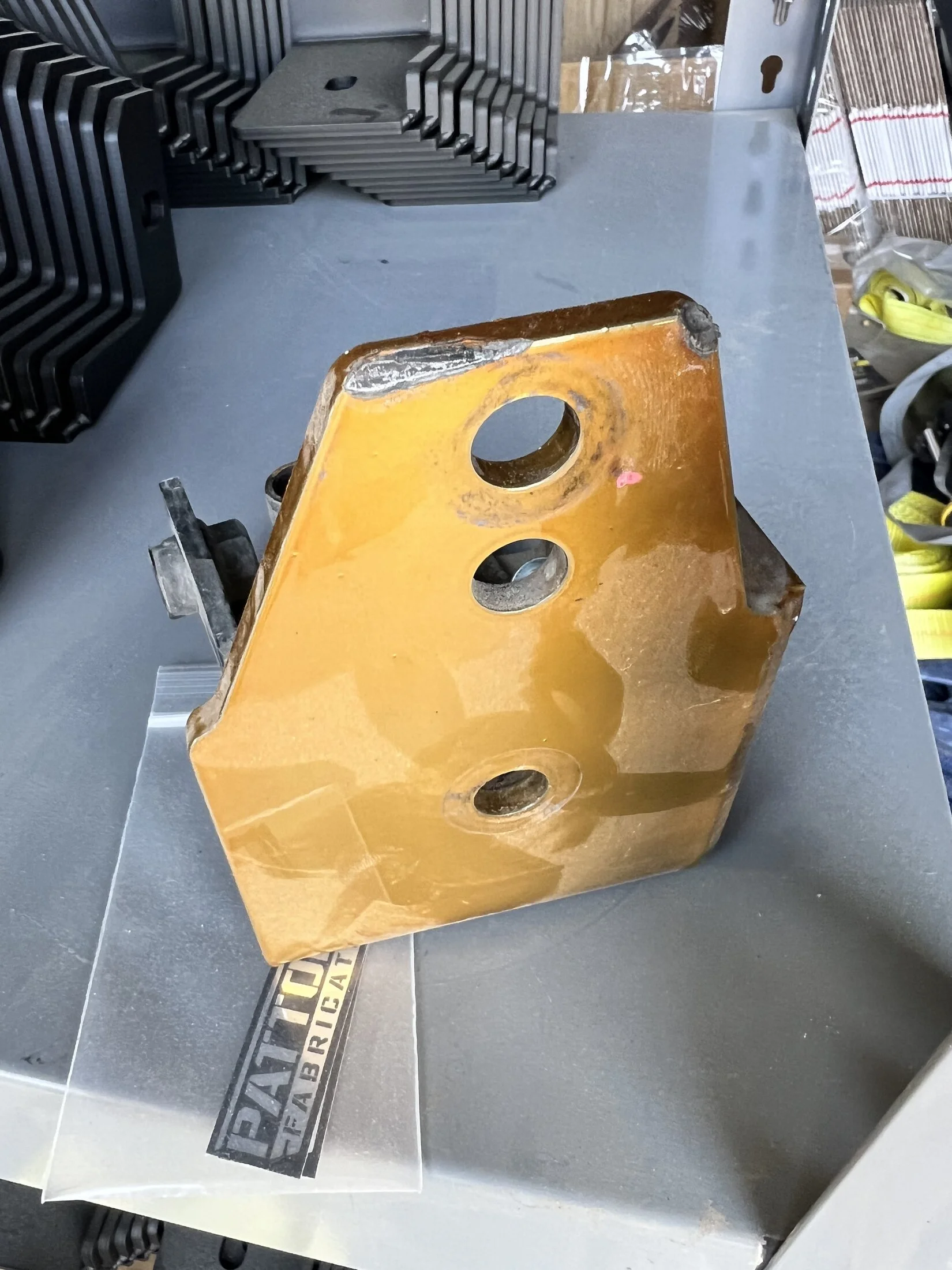

I am running the @eimkeith drop bracket and i have contacted the cross member of the frame, and bent the drop bracket a smidge. No witness marks on the driver side just the passemger side with the drop bracket. Hard to tell if there is anything other then a superficial scratch on the frame from where the drop bracket contacted it.
hey, sorry - haven't had a lot of SM or forum time this year, so I've missed some tags around here.
Yep, there is not a lot of overhead clearance on this platform compared to other Toyota models—it sort of tells you what the company's use projections were, considering they expect these to carry some load more or less daily. Position-wise, it's a fine line between kissing the cross-member without extending bump stops and missing the coil if the mount were angled to slide past the cross-member. (I like that you've retained the inner coil bumps, btw - I retain those as well as they don't really interfere with articulation but improve bottoming on square hits.)
Design-wise, I have to deal with some compromise here to get a height-adjustable (and therefore tunable for different loads/setups) part, so this variant is shaved down as much as I feel comfortable with while retaining both mounting heights. In this scenario, you could trim the rearward ear to clear, but I'd probably leave it as-is now that it has found and defined its operating space unless it bothers you, so as to retain the upper hole option if you ever change it up suspension-wise. From what I can tell, it doesn't look like the in-use contouring you've done there has limited the movement of the joint. ;)
The installation looks good. :)
Are /were you getting any noise on contact that you're aware of?
