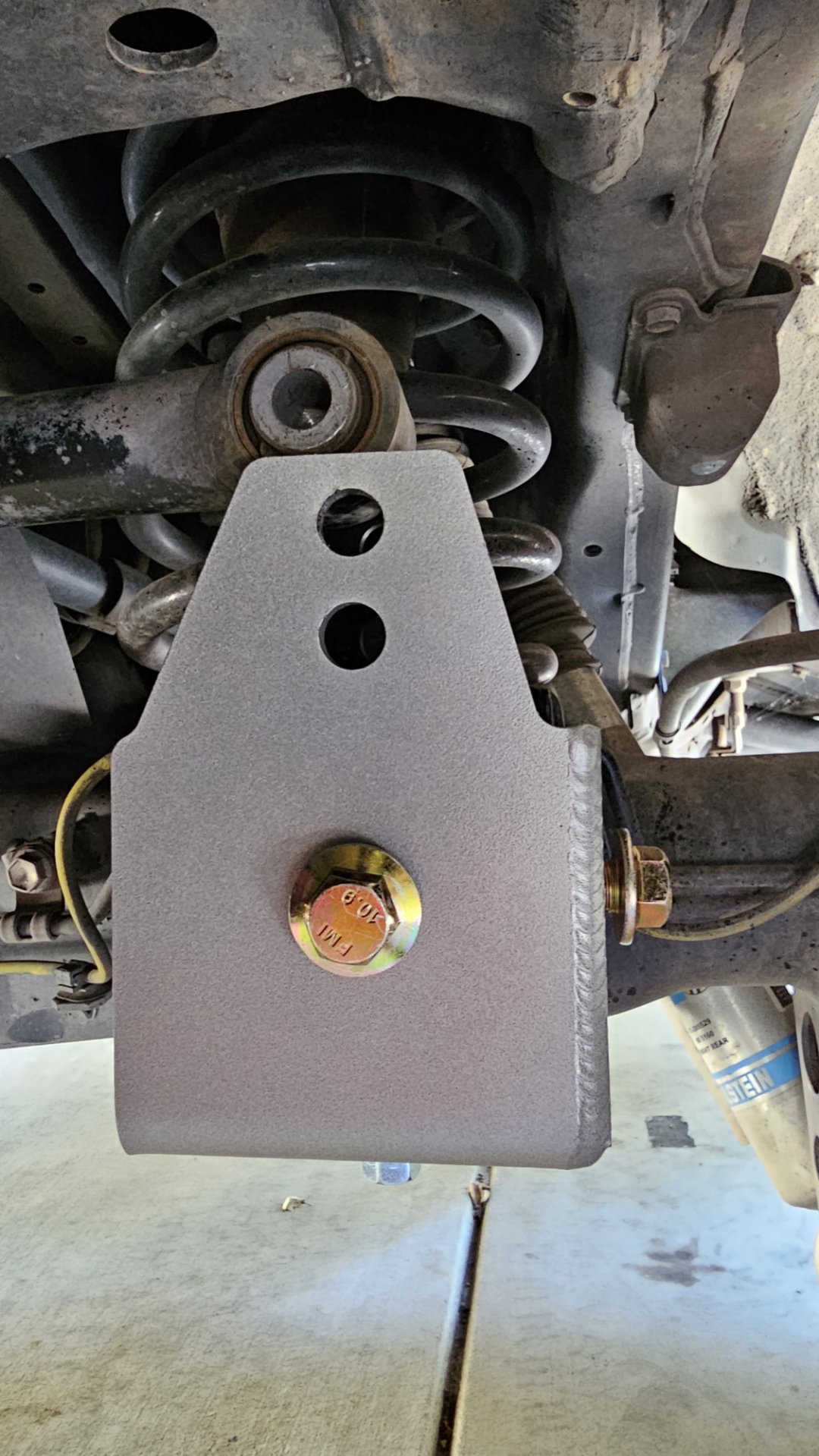

Does the rear spring need to be removed to weld on the Opt Offroad bracket?
Not necessary. Only thing that needs to be removed is the panhard bar so the bracket can be installed.

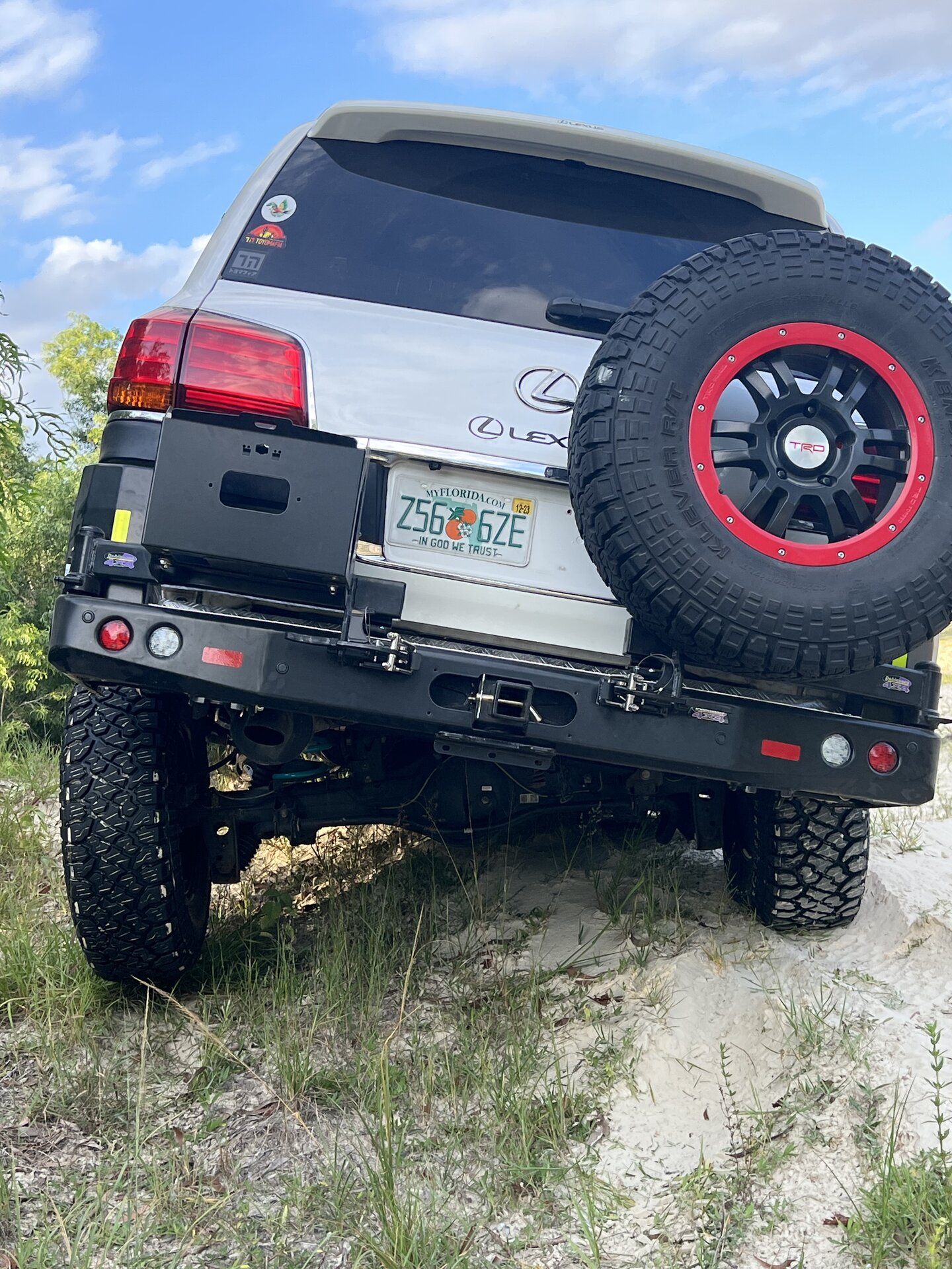

DRKDSS has lovely brackets for 200 Series. I have the first prototype for the LX570 installed on my vehicle. The left side spacer plate is prototype and Dom is working on getting it a bit smaller and more of a direct fit.

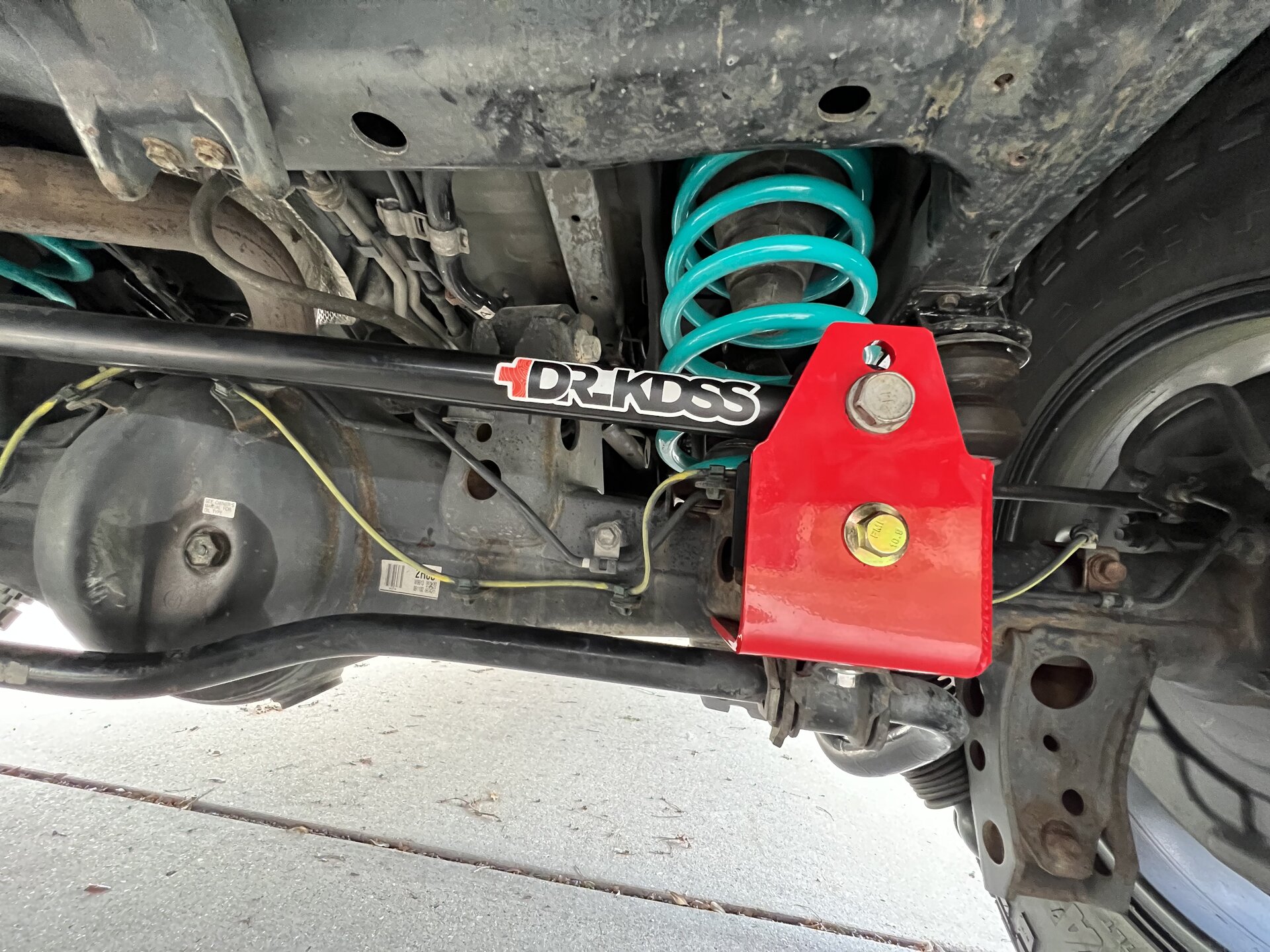

Done. Didn’t enjoy bending the stock bracket open to set the back plate in, but otherwise it only took about 35 minutes once I got into it. Initially, it seems flatter in tight turns. need some speed bumps to drive over to see if it cuts the rear-end waggin.
Installed mine over the weekend, finally. It's only been sitting on my shelf since August. Mine is black, so not as pretty as @Txoverland above but otherwise it's the same installation.
Holy cow this makes a difference. Despite having more lift in the rear I had less wobble with my medium duty Ironman springs than with the standard duty Tough Dog springs (which had a bit more spring height difference between left and right), but it was still there and particularly noticeable going over those gradual speed bumps at ~20-25mph. I won't say the wobble is gone now but it's 98% improved for sure. Oddly I also feel like the rear spring bounce is softer, and I almost want to turn my BP51's up one notch (I'm currently C2/R6). Yes everything is torqued correctly. Could just be in my mind or it could be because there less wobble means the shocks are now working together instead of against each other.

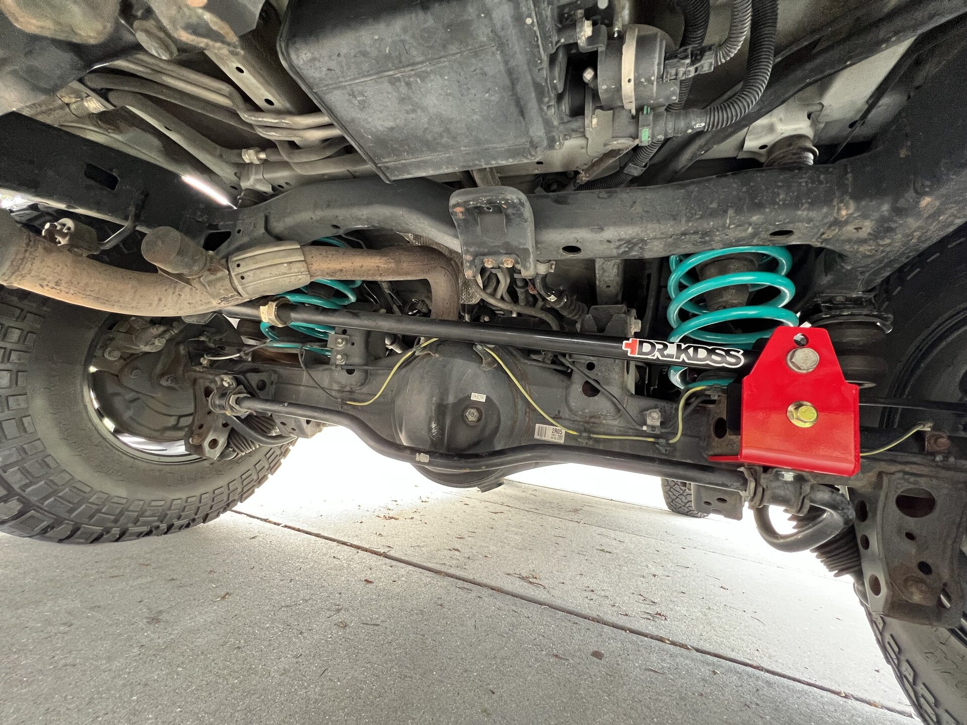

My only concern with this setup is will there be any panhard bar contact with the exhaust or diff breather on full stuff? I think it'll be ok, but would love confirmation from others.
I noticed an improved steering feel, not only is the rig a bit flatter in the turns but the steering wheel feels like there is less resistance, not sure on the mechanics of that. I still feel a slight wobble in the rear over slow speed bumps in parking lots. As far as the full flex question, should be able to answer it in a few weeks after a trip to Merus.

No, ive slammed it buy bleeding AHC on factory bumps and no interference whatsoever even with a 33" underneath.

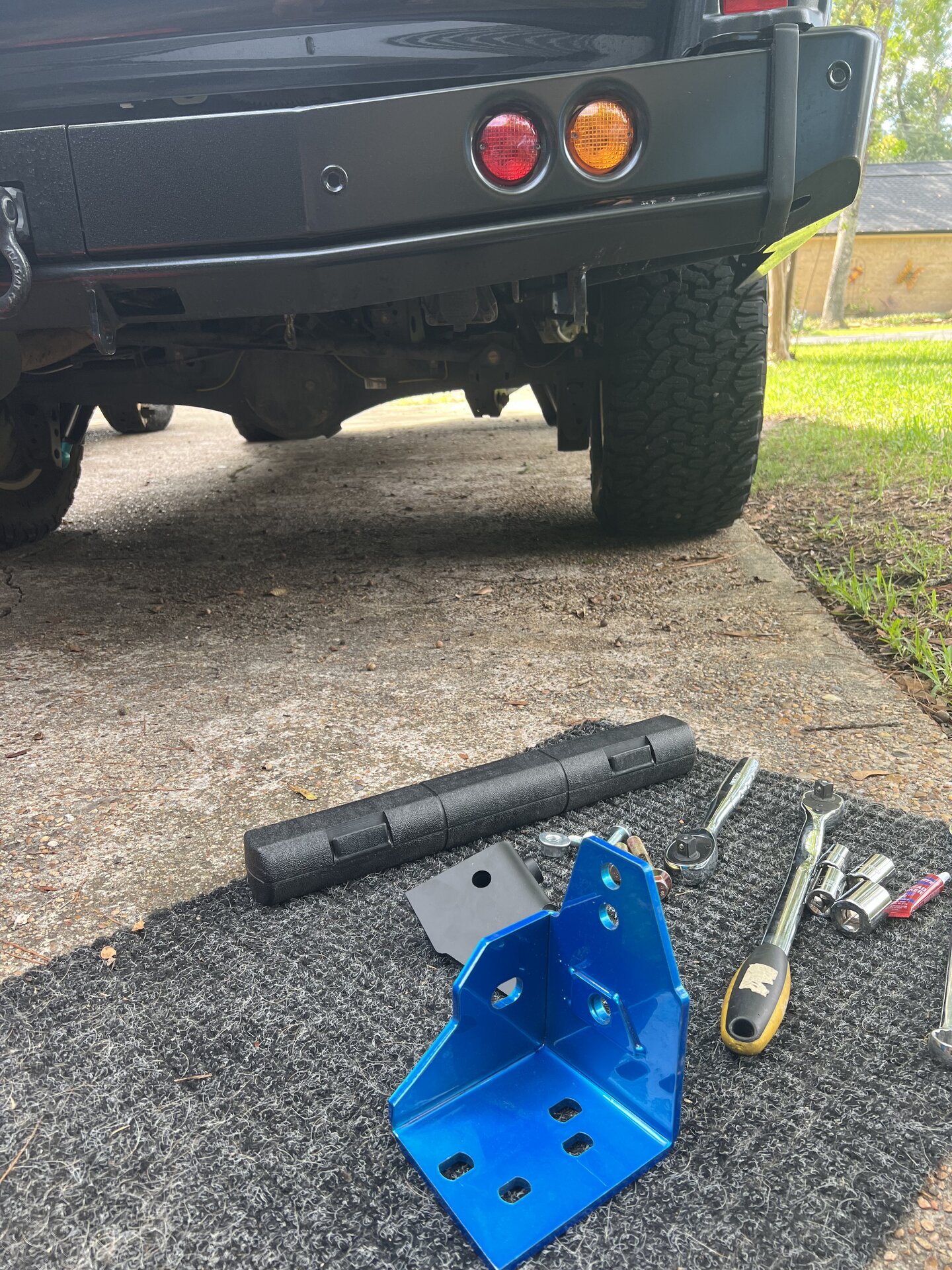

The bolt on version moves the panhard rearward enough that it compromises room to carrying larger spares. I need the room for 35s.

If anything the bolt on PCK was easier to drop in at N ride height. It was perfectly designed.
