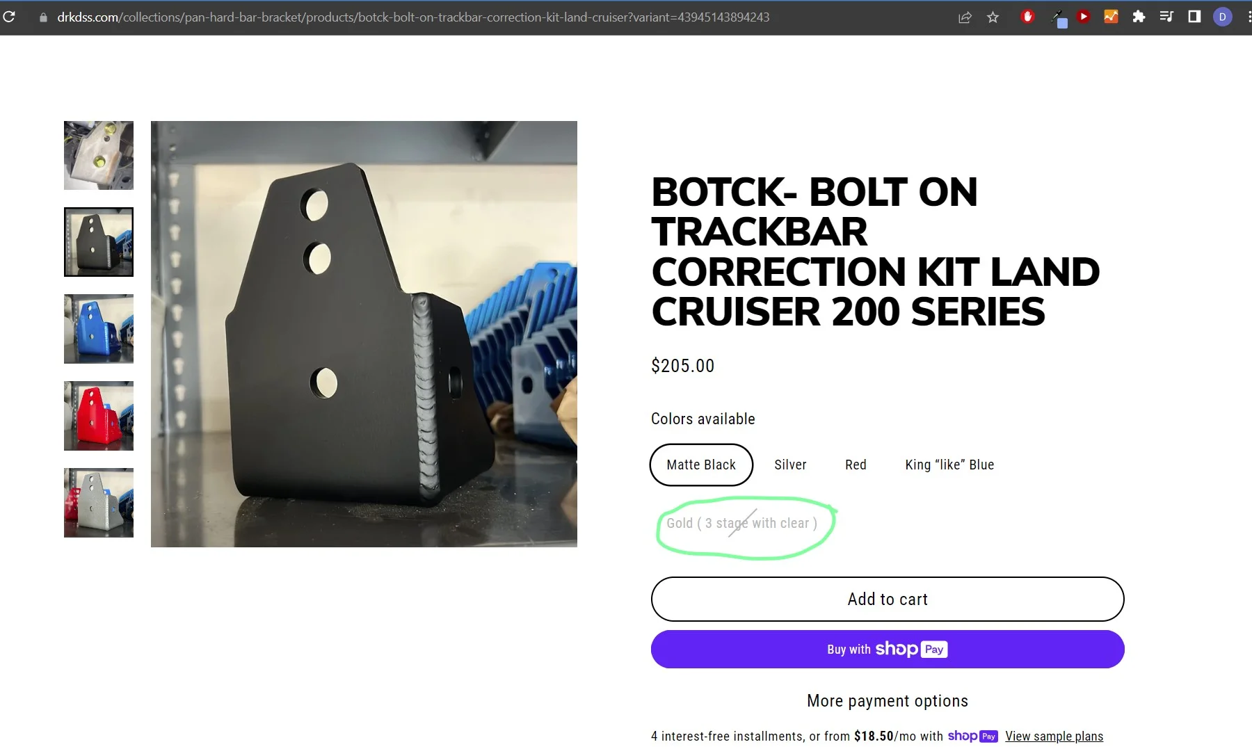

It shows as live but when I tried to order it says my shipping address isn't valid. I'm assuming it's not actually available as I think that's how Shopify rejects an order for something out of stock...
No it’s available. It’s weird I’ve notice some addresses are not picking up. Send me an email with your full shipping info and I’ll check what’s going on.
It's likely just address validation via Shopify. If it's out of stock it's grayed out as an option and you can't add to your cart.
I've had address validation burp on my zip code which was changed here several years ago. Just depends on the source of the data that they are using for validation.

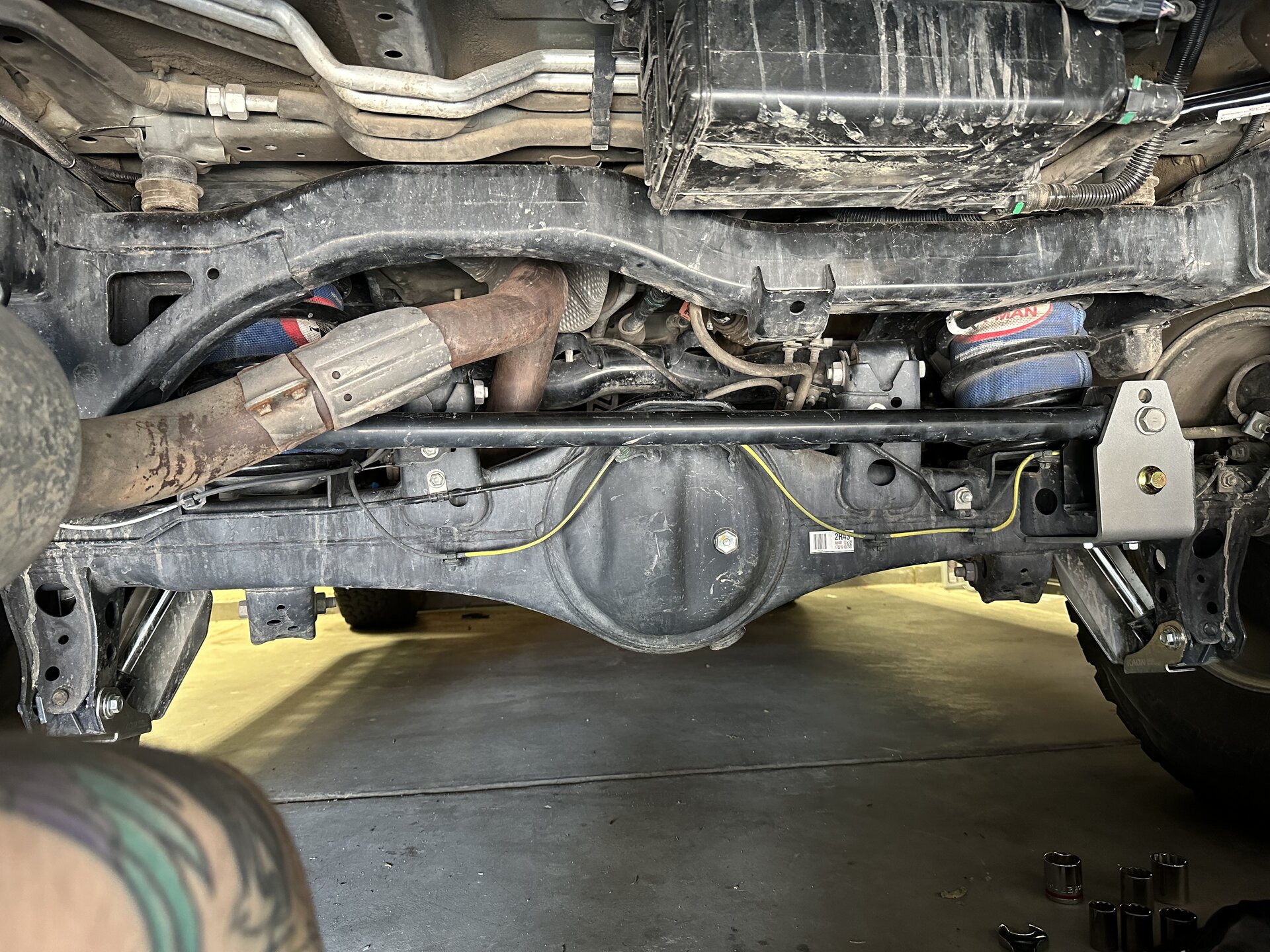

rec'd mine late last week and I'm looking forward to a window to bolt it on and give it a run.

Does the track bar typically mount right up or do I need to break out the ratchet straps to get the factory bar aligned in the hole?
You install all of it loose and the last. It will all line up easy because it’s all loose and if the bar or cab is shifted. It’s easy to get it in. Then you tighten bolts in a specific sequence. It will prob be the easiest part you install on the vehicle that will give you the most improvement.
I was prepared for a scrap, but I didn’t have any issues at all getting it to line up. It was a pleasantly easy install.
