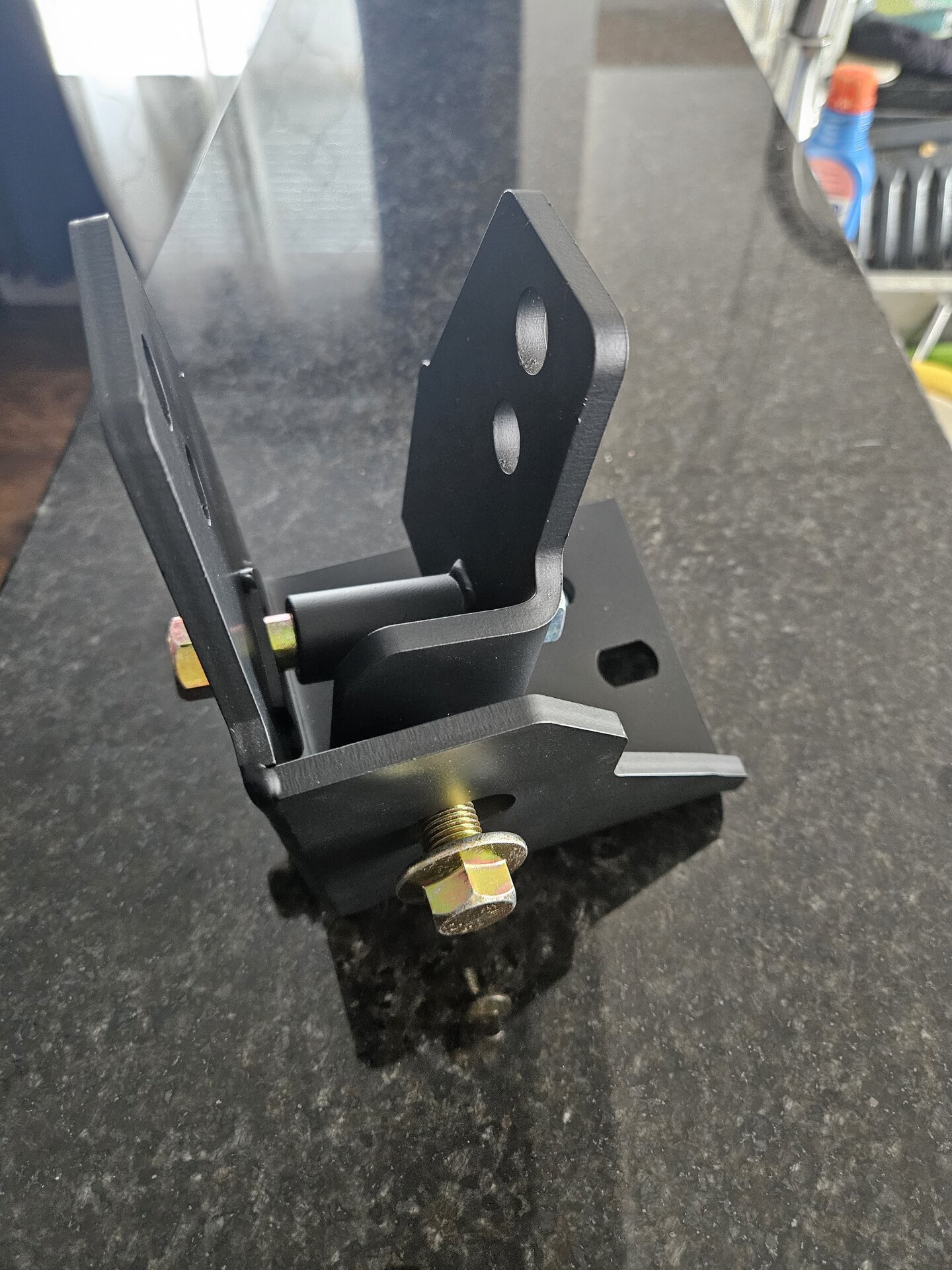

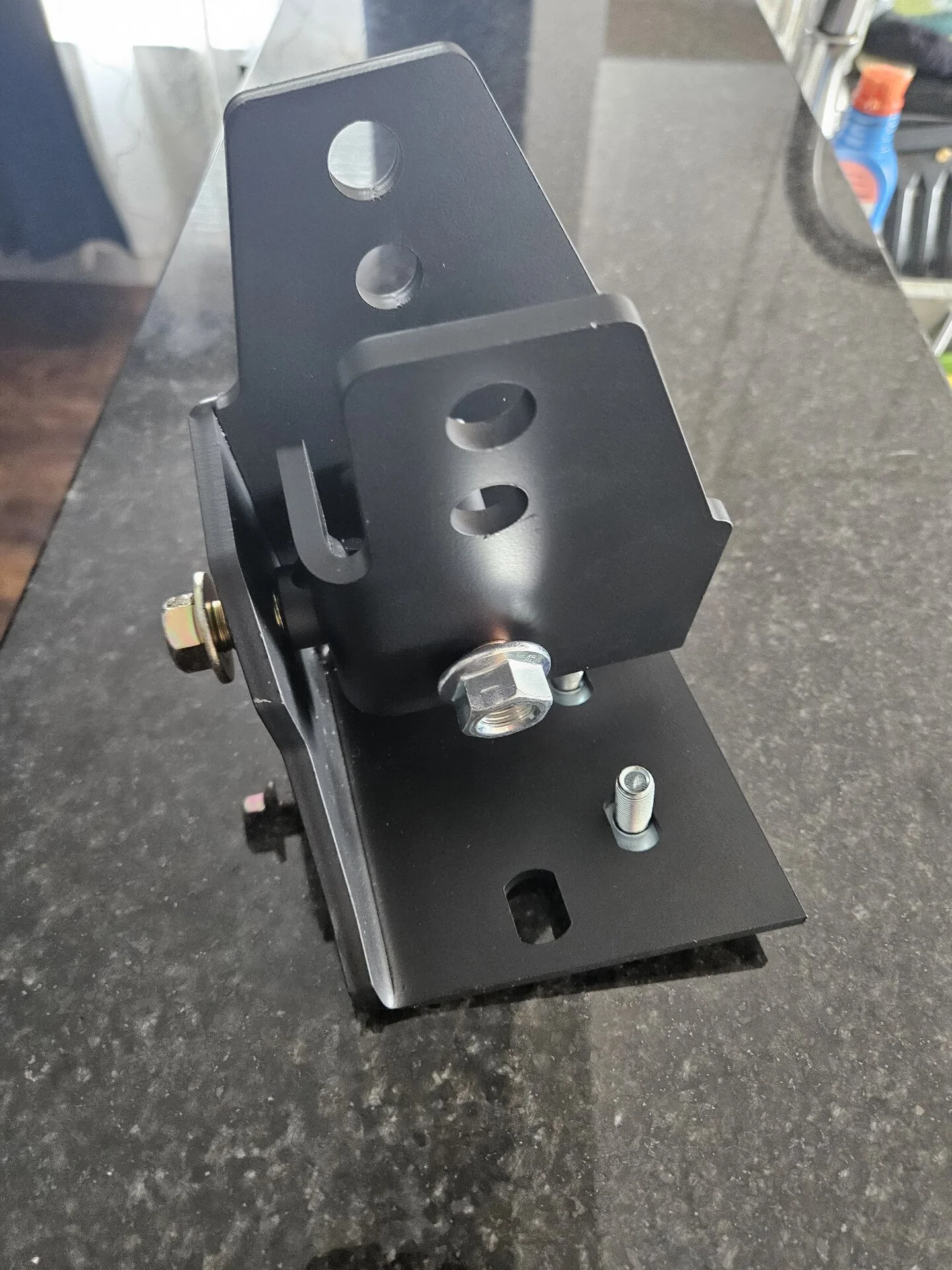

In case anyone was wondering what it looks like not attached to the vehicle.

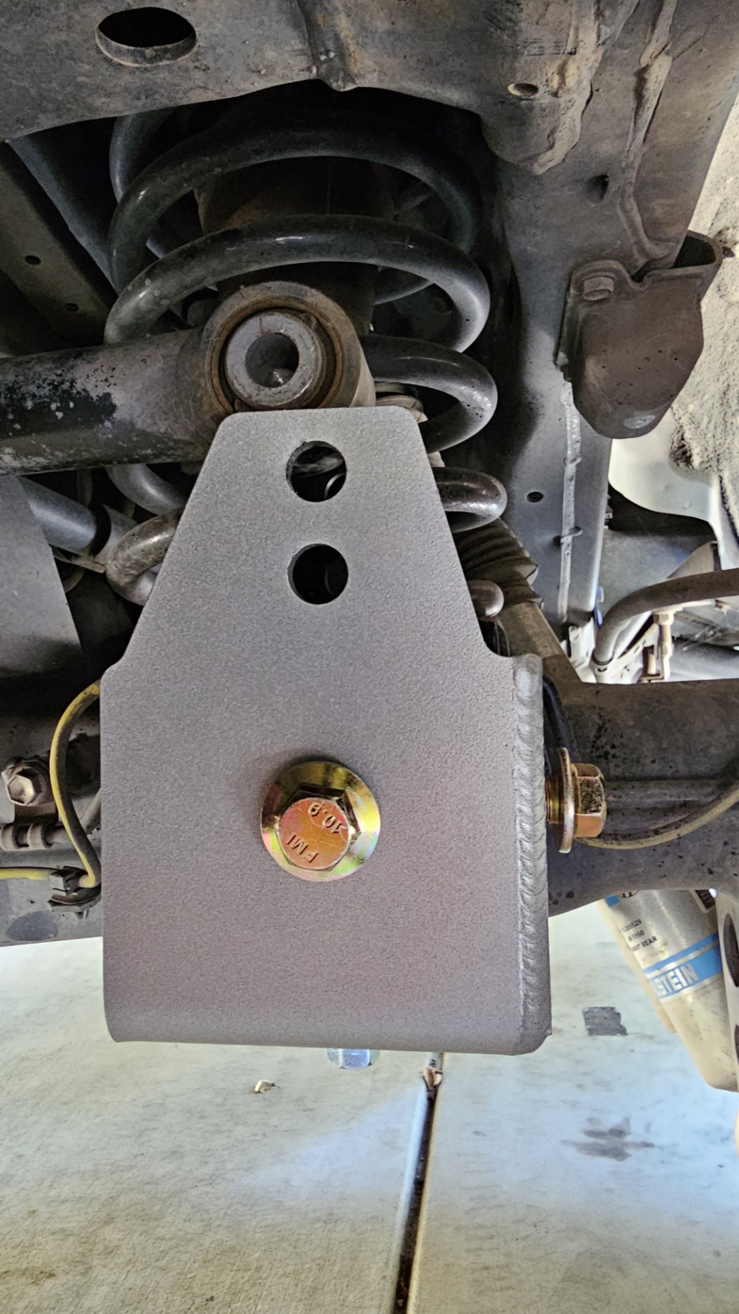

Installed the drkdss kit today. Very straightforward and went smoothly. A couple pics...
Before:
After:

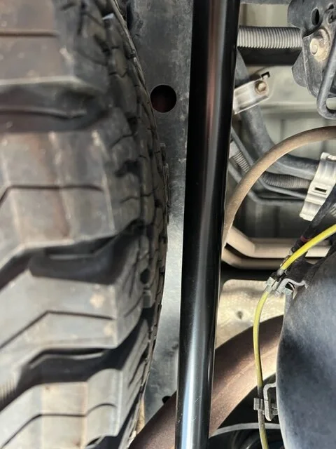

The kit and installation video are awesome! Well thought out. I took the 200 out on some roads that upset the suspension on curves and the improvement is quite noticeable. To me it feels like the stability improvement is the same order of magnitude going from stock suspension to OME. I know folks are interested in clearance, so I took a picture with my K02 265/70R18 tire in place:
My tire spec is 32.6" diameter. I'd bet I have at least another 3/4"-1" available if I were to pull the tire towards the rear of the vehicle as I raised it into place. Overall quite happy with this kit!

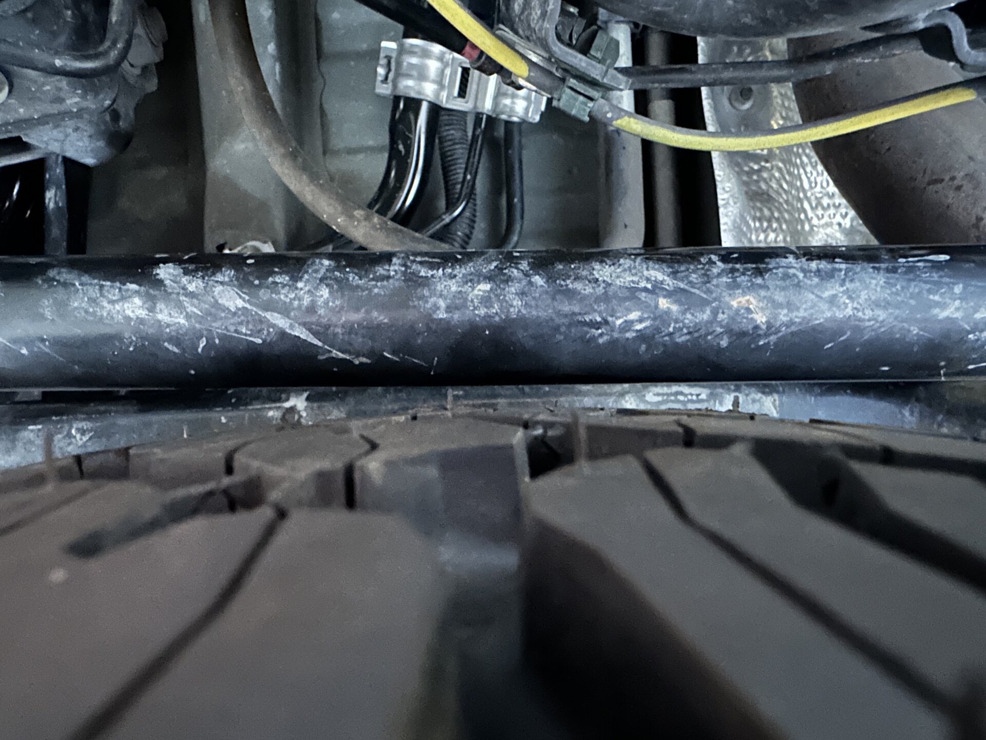

Sweet. Thanks for the pics and feed back. This is how close I was with out my bracket and a 295/75/18 ( 34.8”) . And yes I pulled it back towards the rear as it goes up. Just so happens that the bolt on bracket scoots it back about 1/4 and that was enough to make contact. I might make a really skinny billet trac bar to make it work.

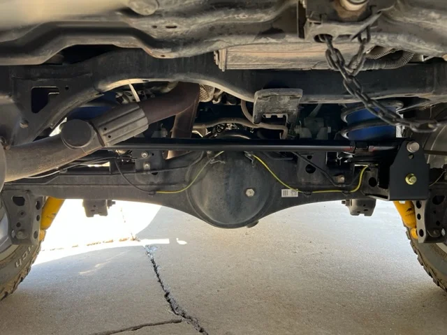

I’ve got a 285/75r17, and I’ve got plenty of space.
Edit: @reddog90 Photo added for posterity.

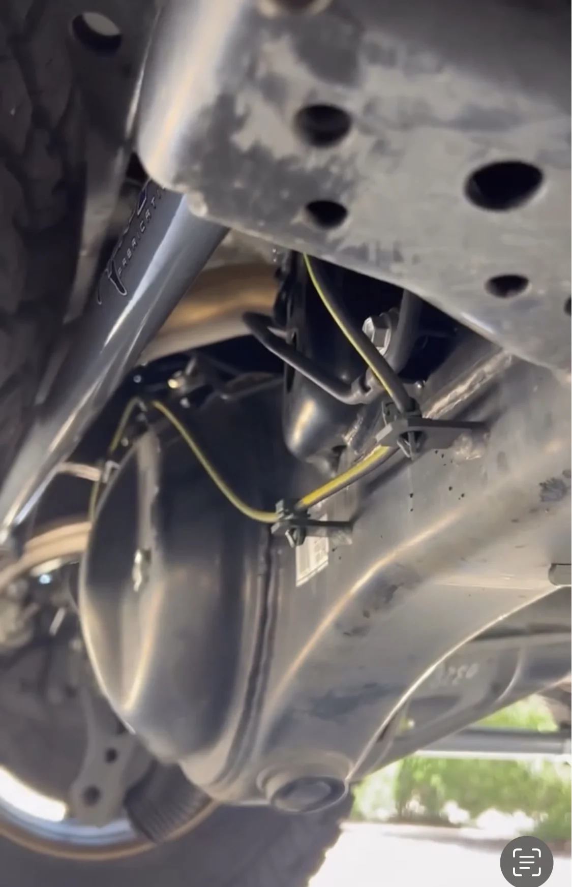

Was your trac bar hole off when you went to install the stock bolt? Mine is off about 1/2 inch??
This is the 2nd bracket from drkdss for me, I've got one installed on my sons 5th gen 4Runner and it was an easy install
They can’t be off they are all cnc laser and cnc brake bent. I mean it can be off but the chances are very very very slim. I replied to your email. Call me.
Edit.
Based off this pic you sent me. I’m positive your cab / frame just shifted over a good amount when you unbolted the trac bar. If it’s short on the upper home on the bracket , if you remove the bracket and try to rotate it back to oem whole , it’s going to be really shorty now. Grab a strap and pull your cab over from the tow hitch or jack up the axle on driverside
