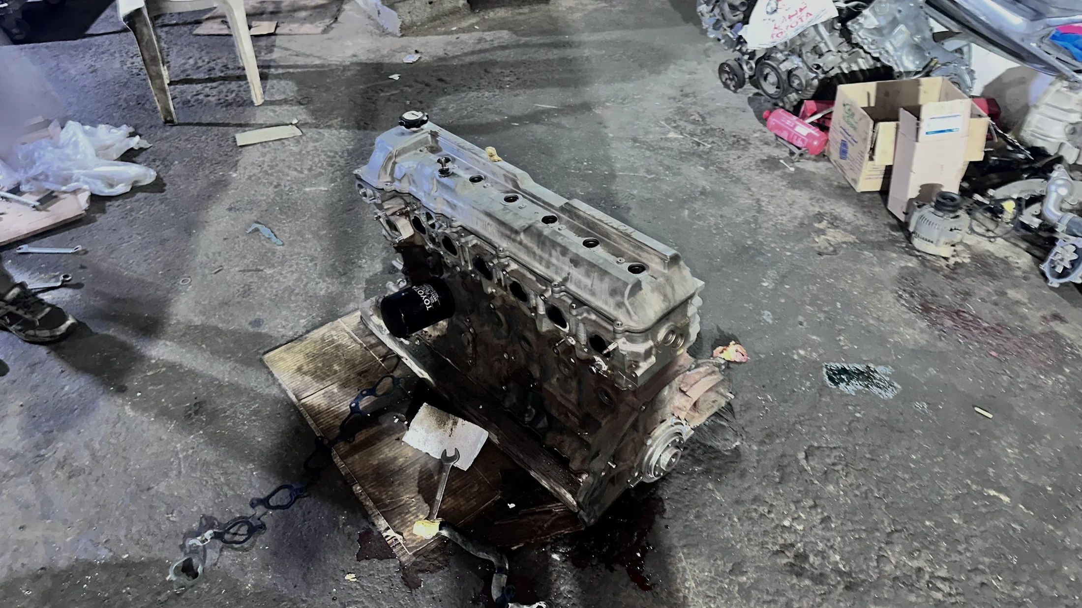

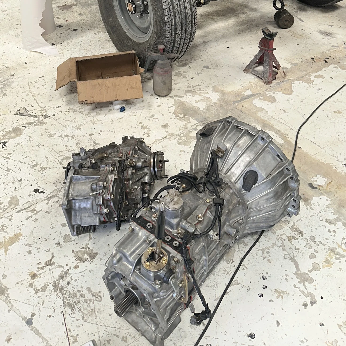

What's up with the engine and trans?
The truck has about 130k km, so there is no need to rebuild, but I treat it pretty well with a new gasket kit without using the head gasket. Also, many of the new parts have been installed. Both the engine and transmission will be washed and painted, including all black parts. The aluminum will be treated with a hot bath to remove all deposits.
Unfortunately, I did not document many of the engine processes, but I'll include parts of what has been replaced:

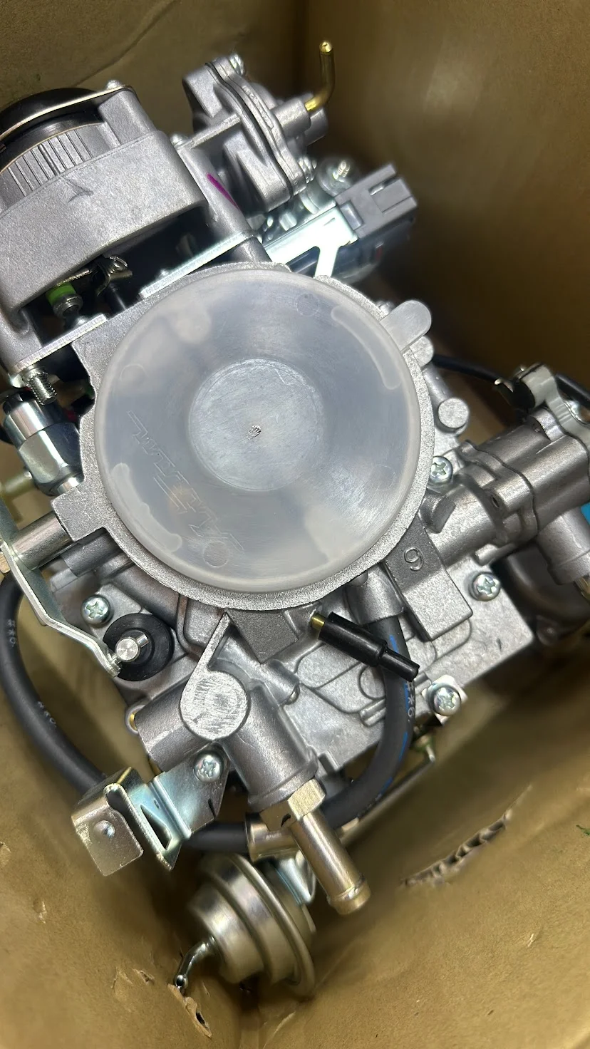

CARBURETOR ASSY
2110066012

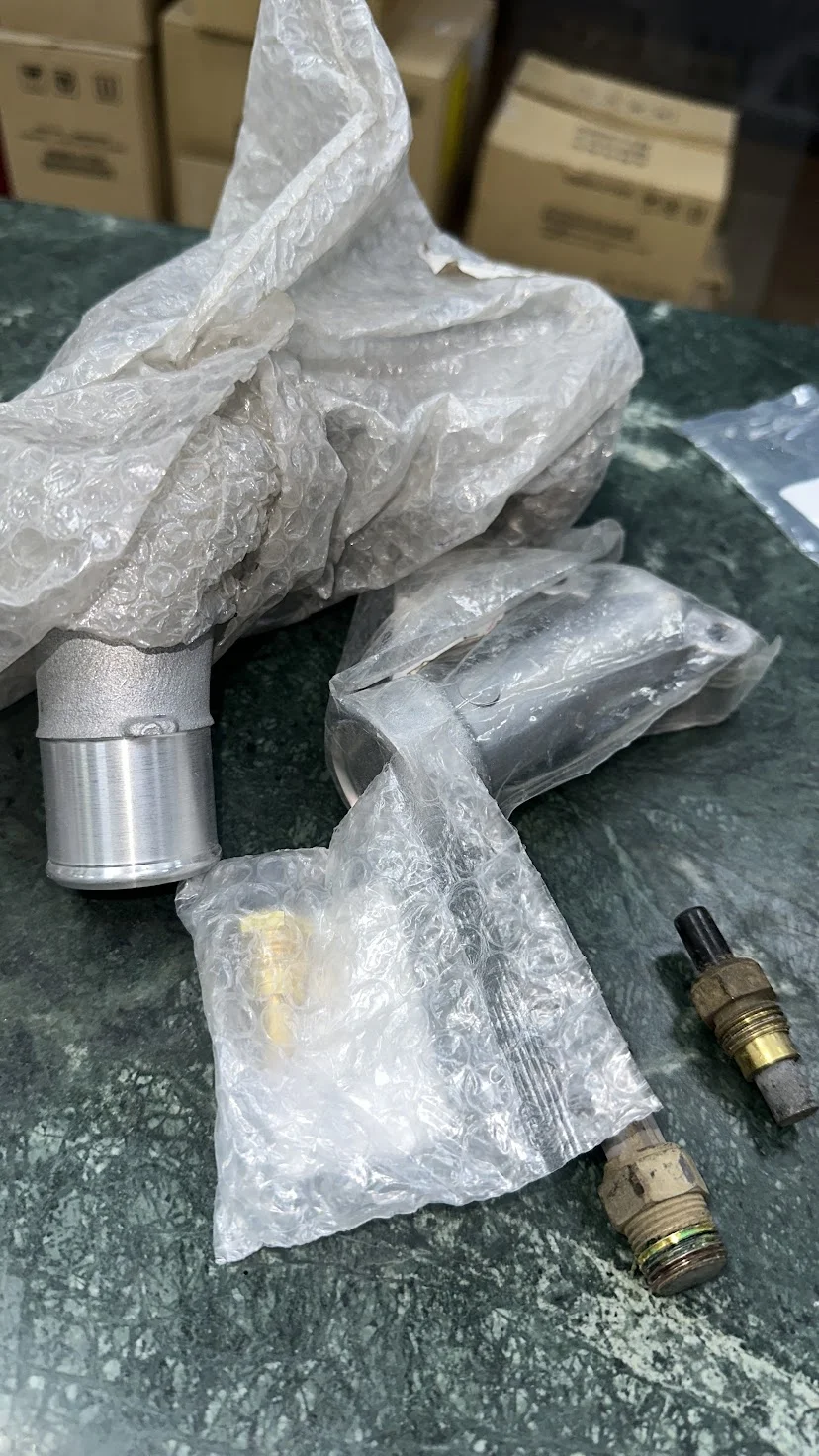

PUMP ASSY, ENGINE WATER
1610069325
INLET, WATER
1632166011
OUTLET, WATER BY-PASS
1635166010
OUTLET, WATER
1630466010
PIPE, RADIATOR
1657766011

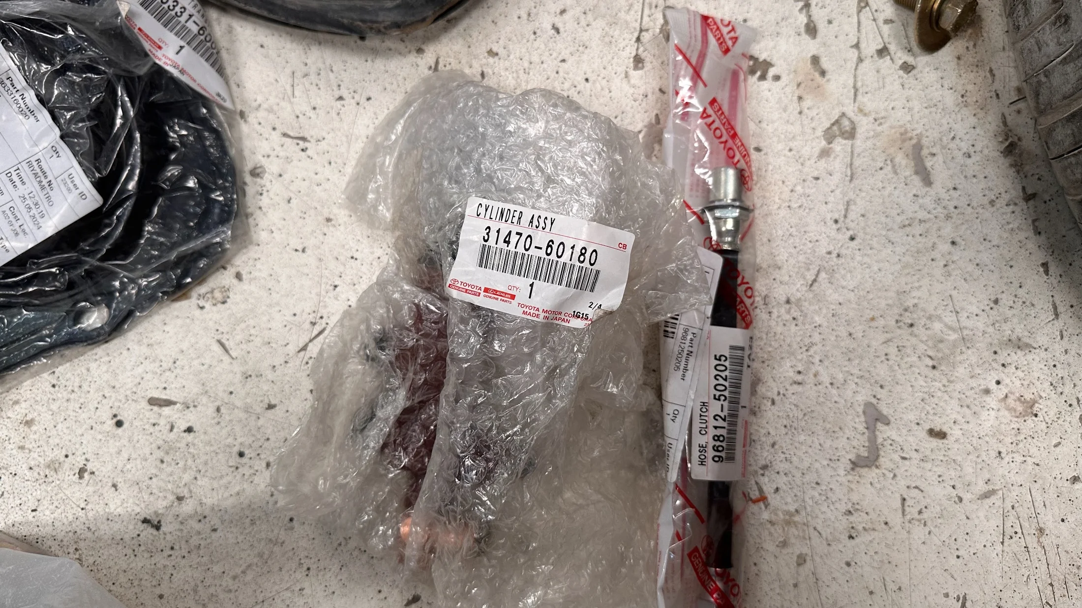

3147060180 cylinder, clutch release
9681250205 hose, clutch release
Parts photos

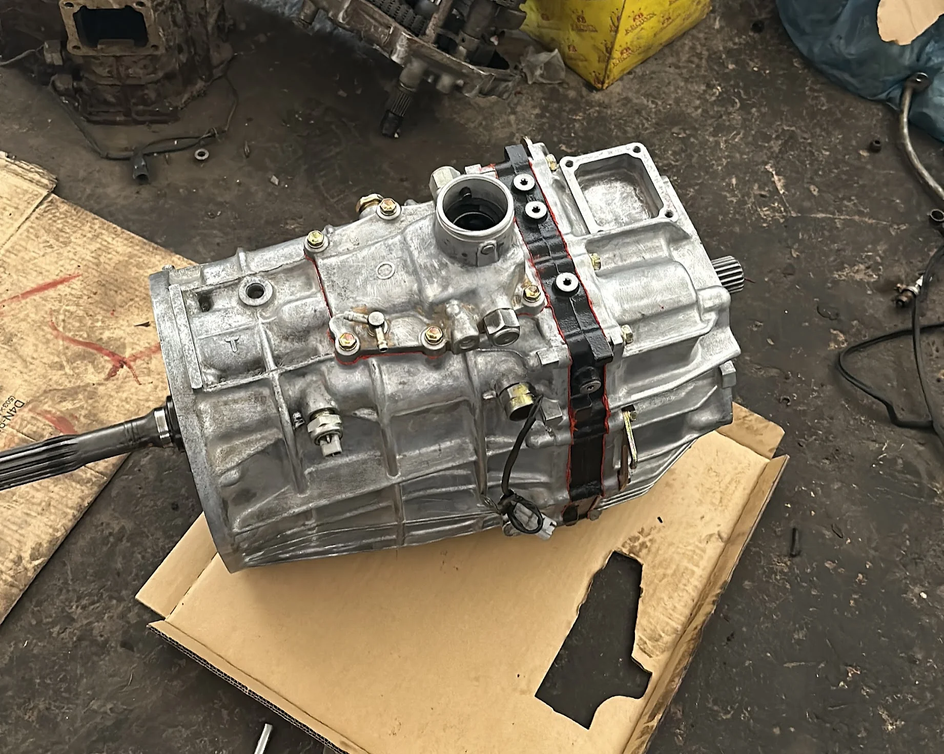

Here is the trans after the refurbishment; it was almost new from inside, but we replaced small parts
TRANSMISSION PARTS
3112660050 boot
3112160040 cover
9031148016 seal
9031158008 seal
9031148025 seal
8422212010 switch
8421052050 switch
8421060030 switch

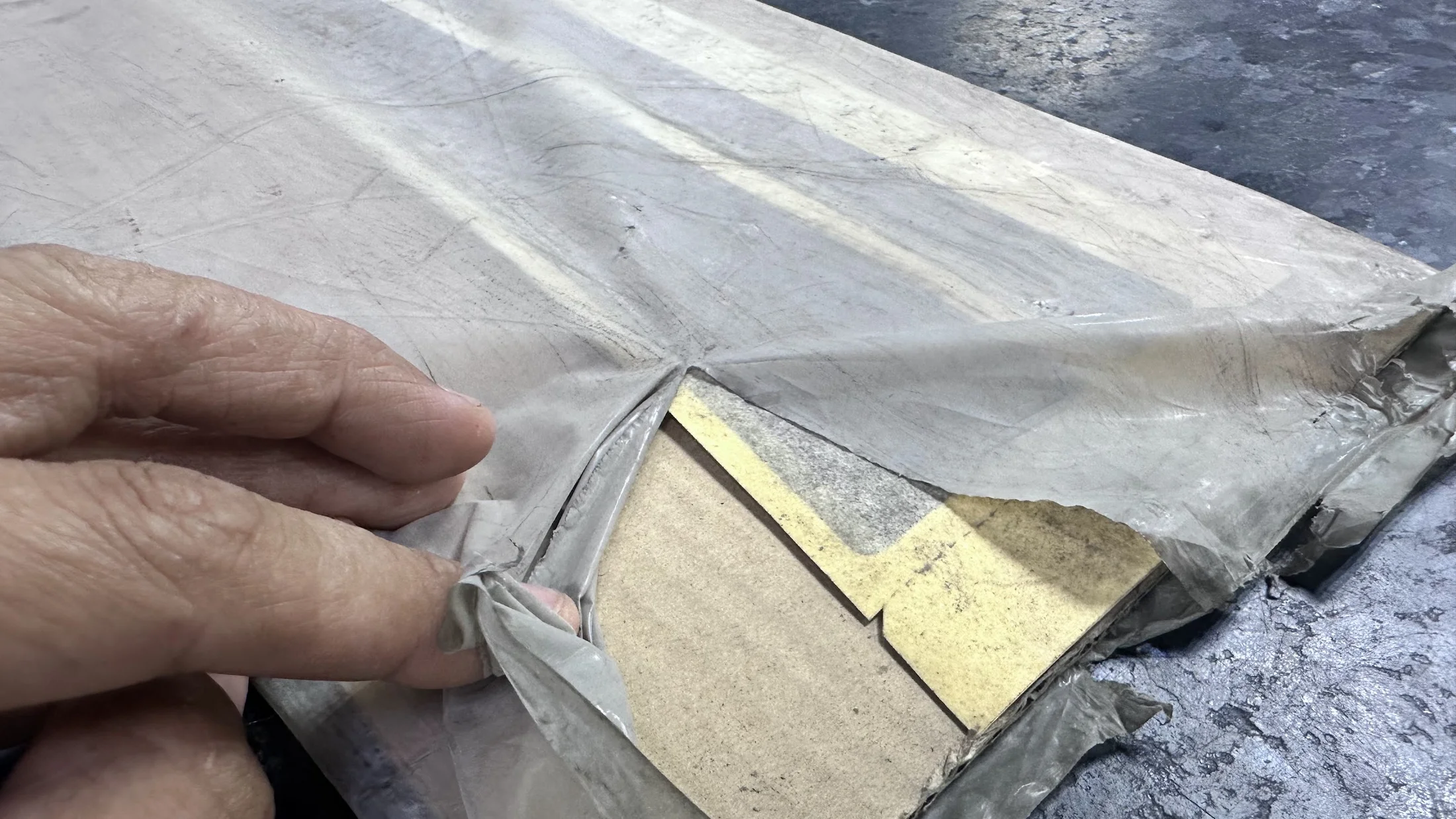

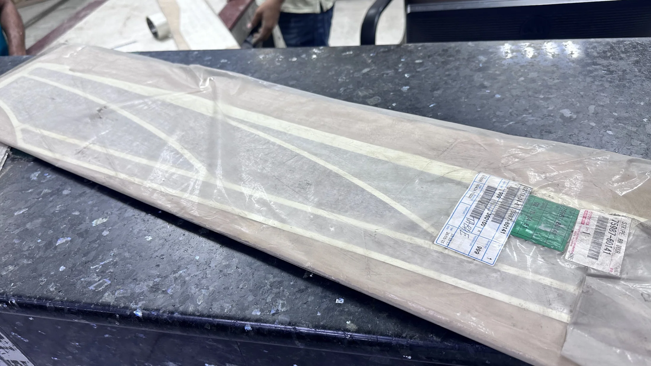

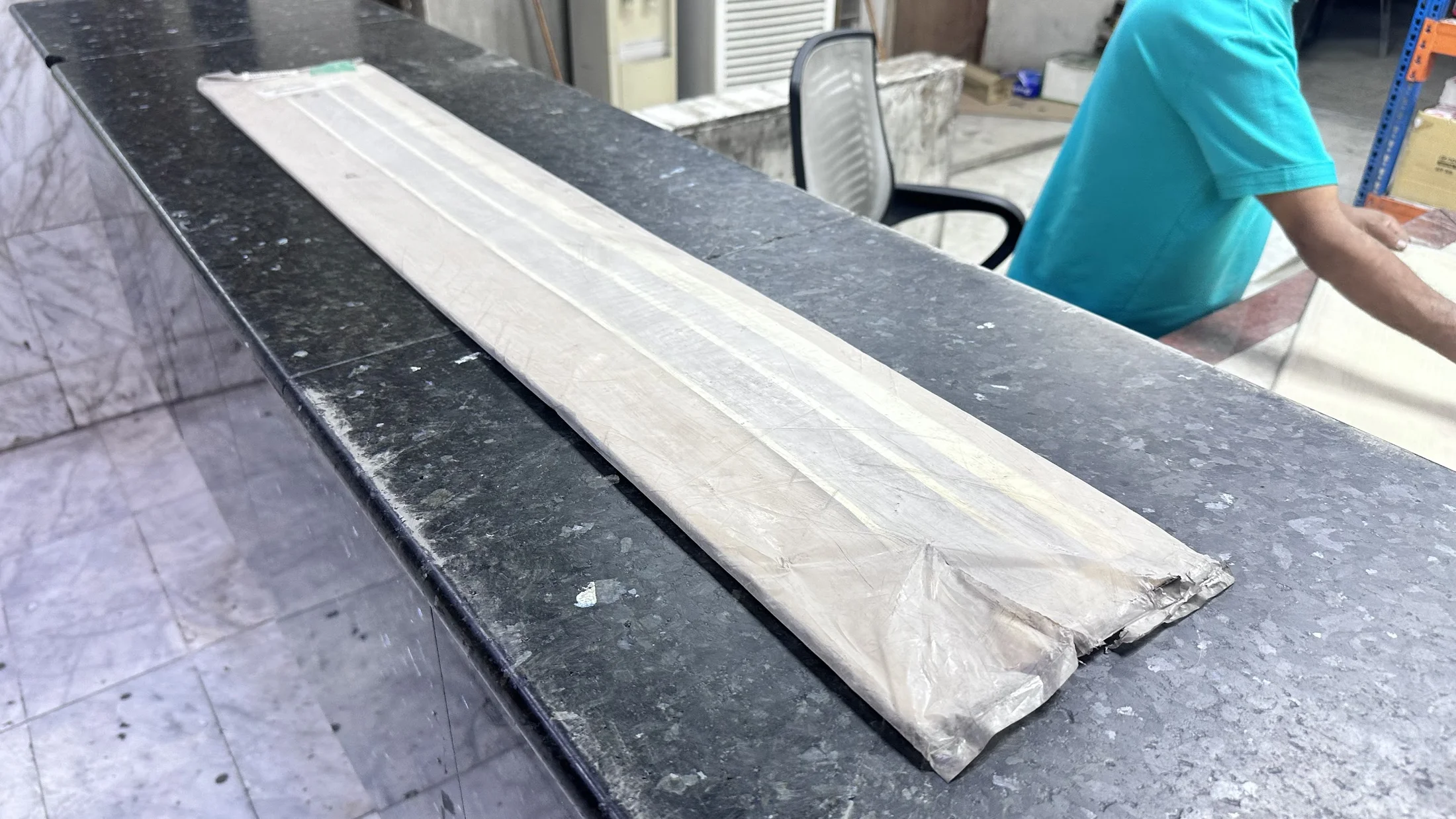

The first thing I did was collect a complete set of the body stripe, and it was not easy at all. Collecting OEM stripies is a curse by Toyota

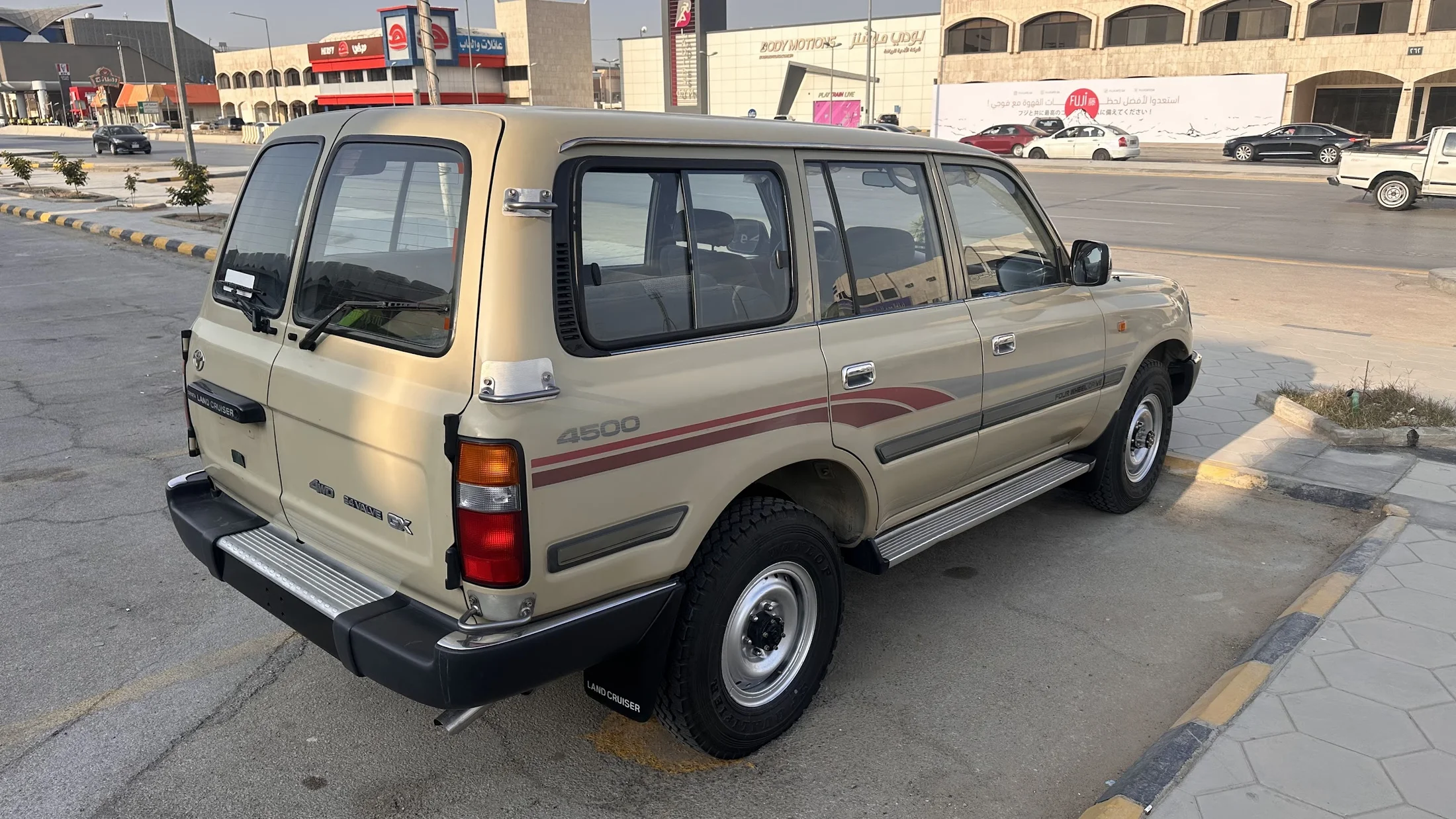

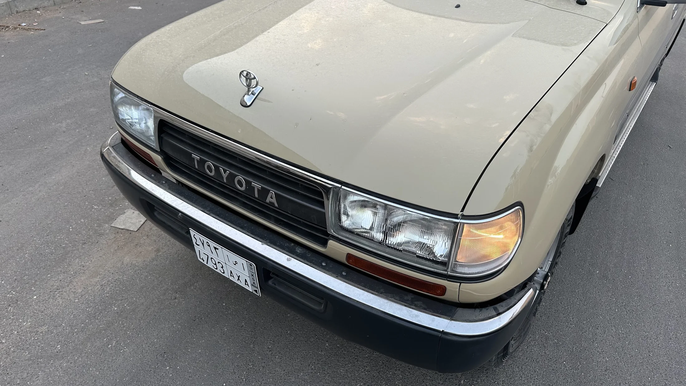

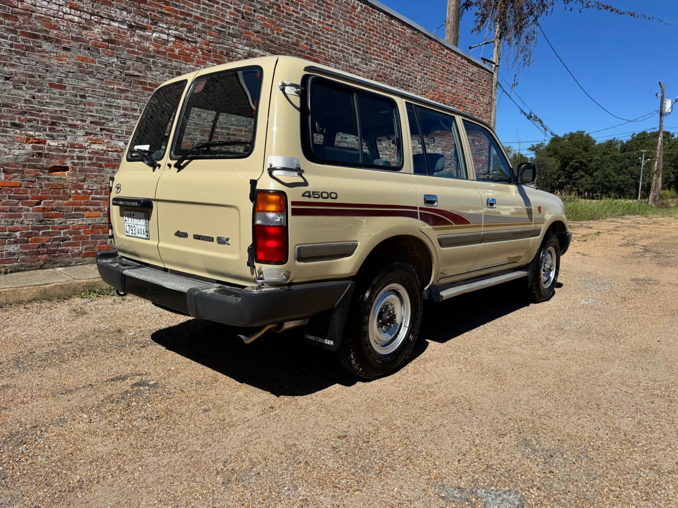

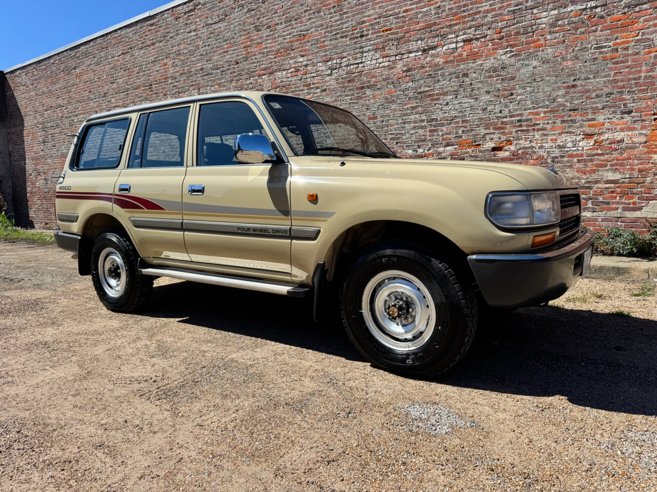

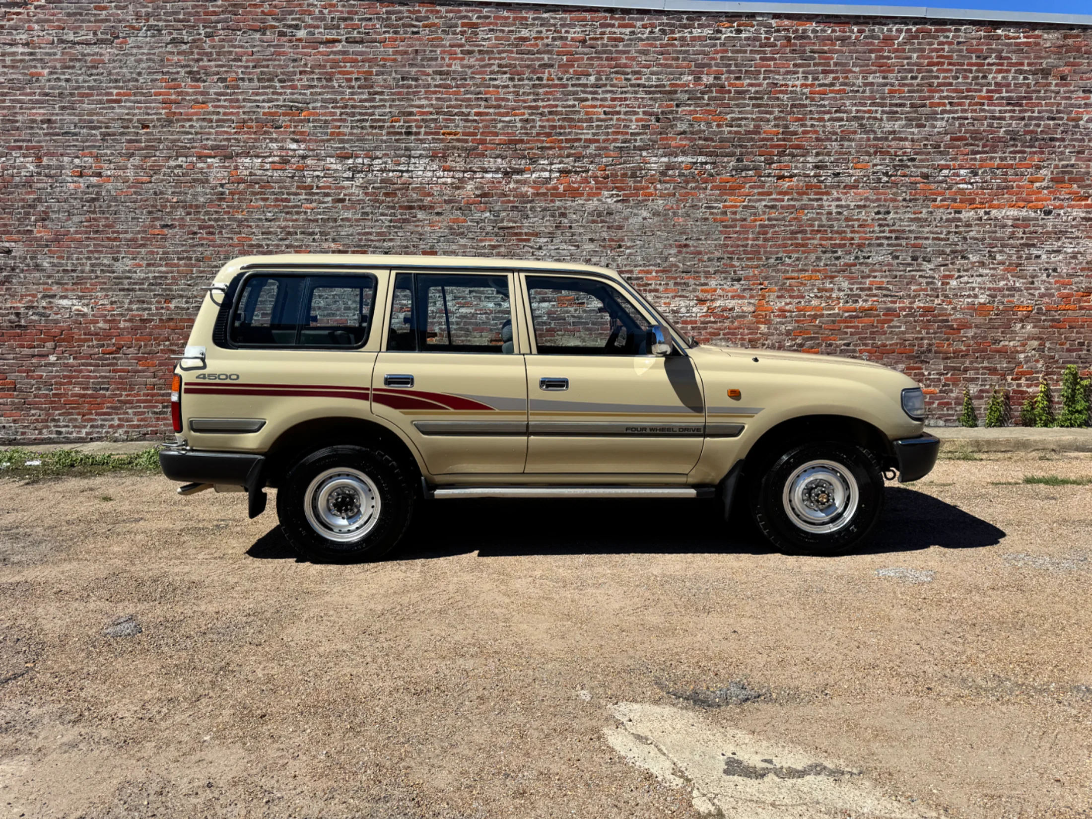

The face has been replaced with new parts! This bumper is a brand-new unit, and I regret sending it to the USA, haha. Those corners are bare plastic.
Headlights are brand new, paired with new chrome and all indicator lights.

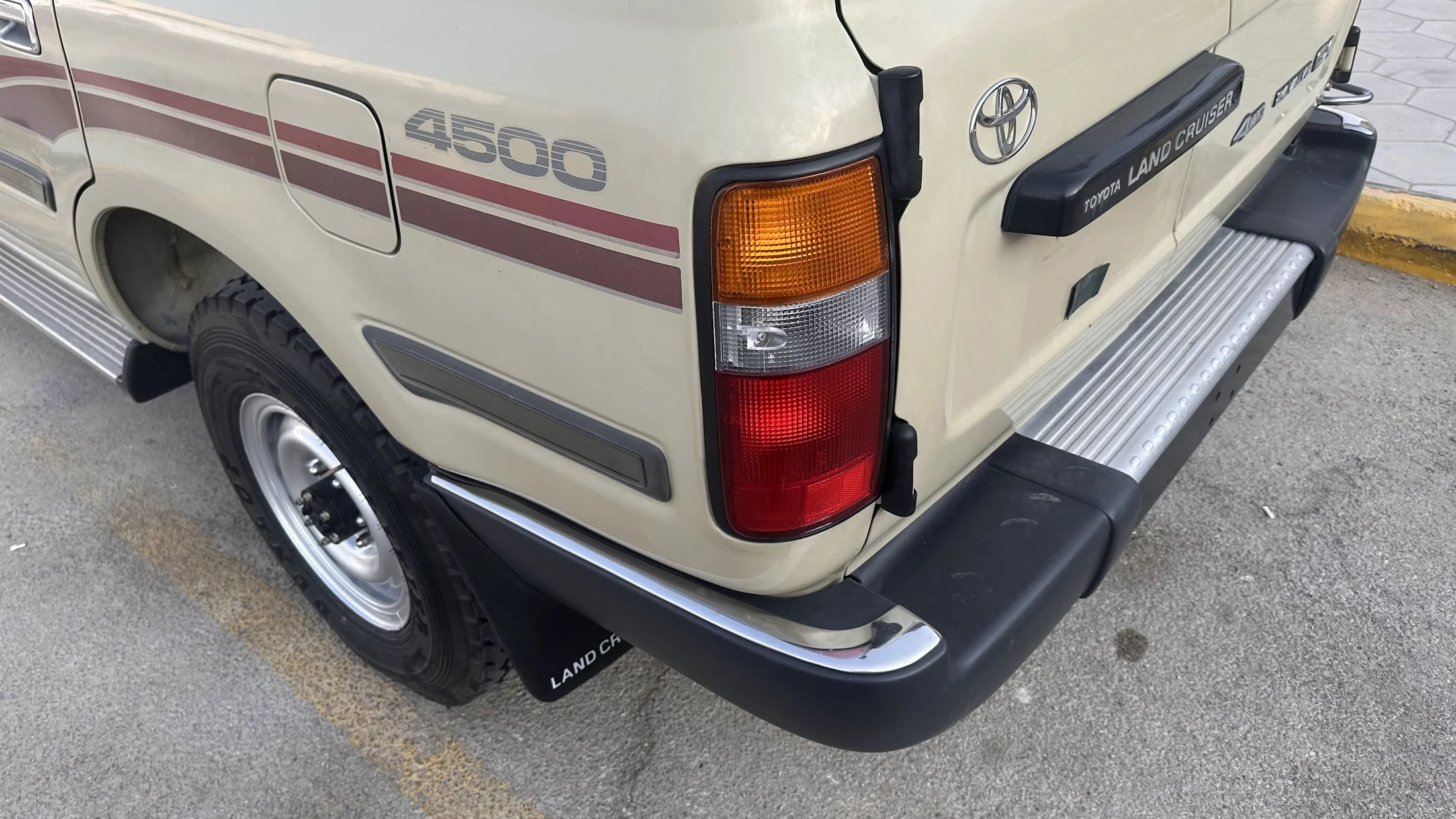

Additionally, the rear received all those beautiful, brand-new chrome bumpers along with brand-new, bare plastic bumpers. I am a fan. Rear tail lights are new as well.

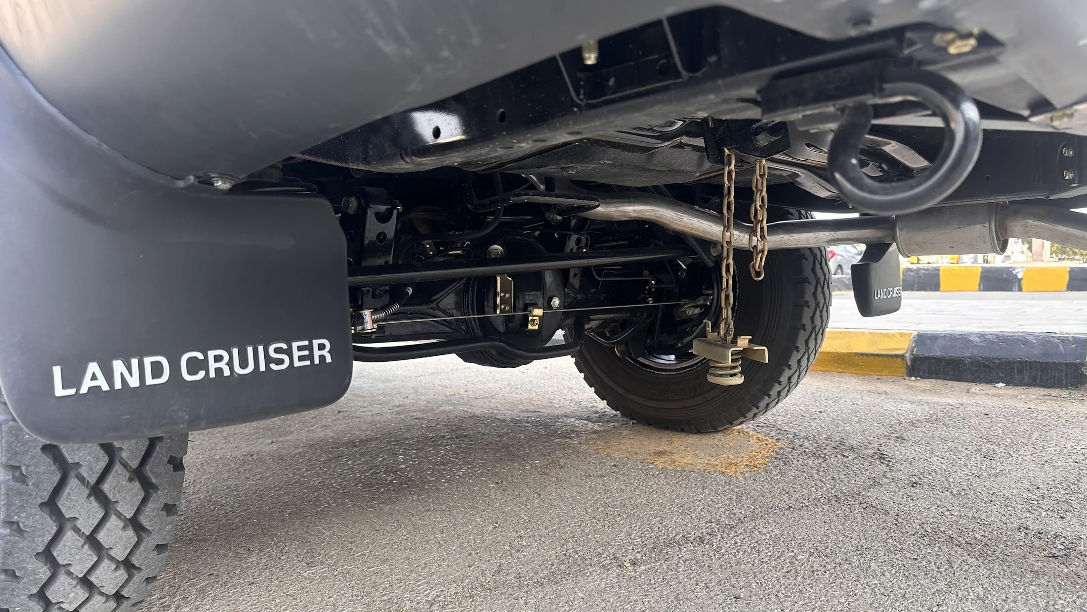

This mud guard is an old part number for the J80, used from 1990 to 1993; after that, it came in all black. I picked them for this project, especially since it is discontinued and only all black is available.
For the love of sliding windows, we replaced all seals to keep them tight from water.

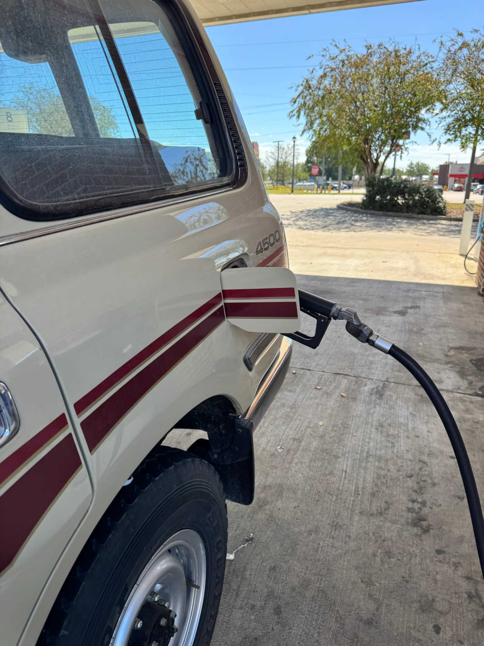

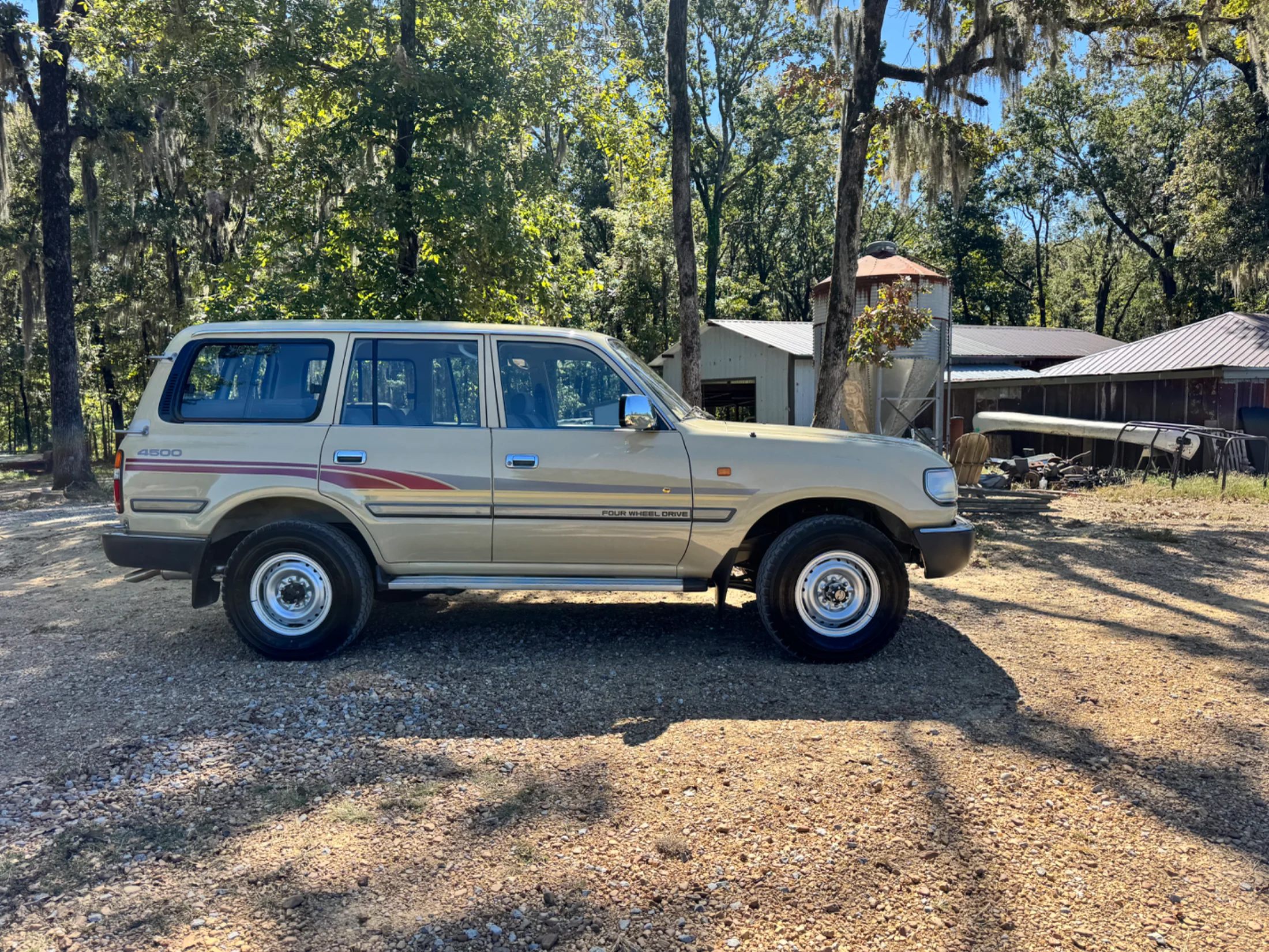

Finally got time to drive this one to town, gas it up and run it through the car wash.
This thing drives like a dream. Since it belongs to Meshal the tires are actually balanced, something mine never are

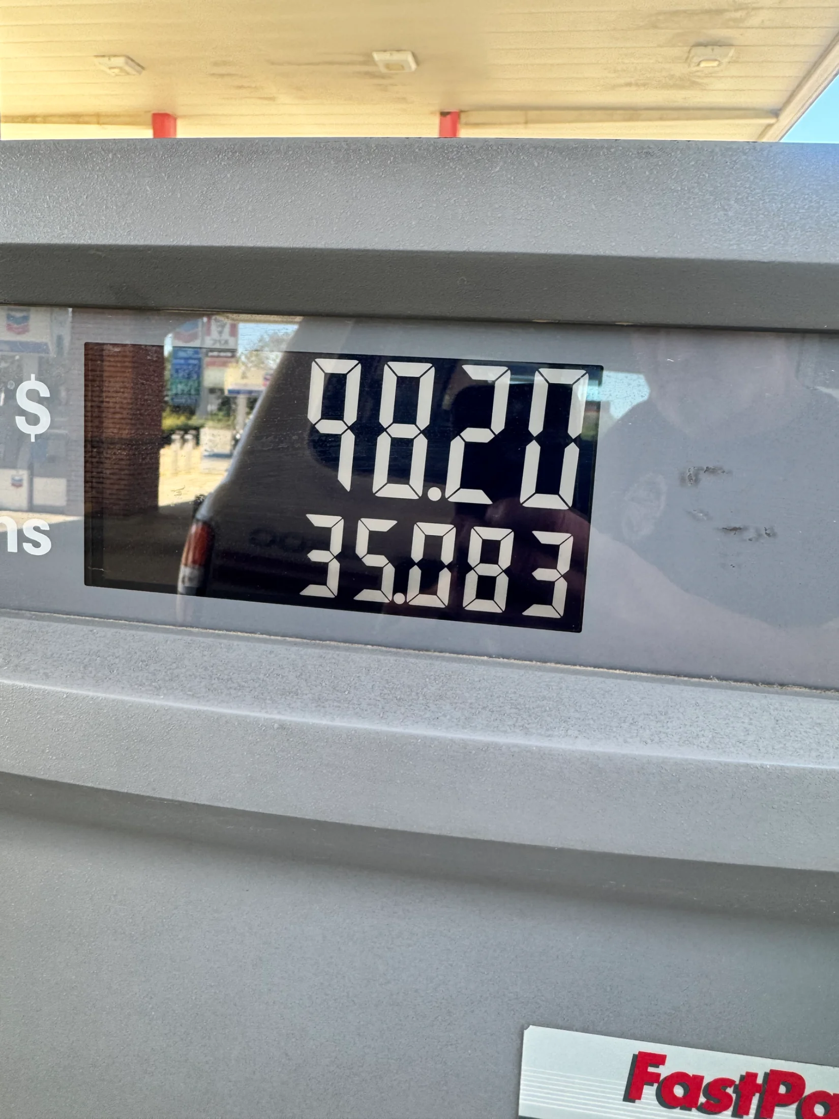

Can someone confirm exactly how much gas these things hold? I think that's about it
Poser pics
Where did you find a pump in the states that shows liters instead of gallons? That converts to about 25 U.S. gallons. Which is about what a 80 stock tank will hold.

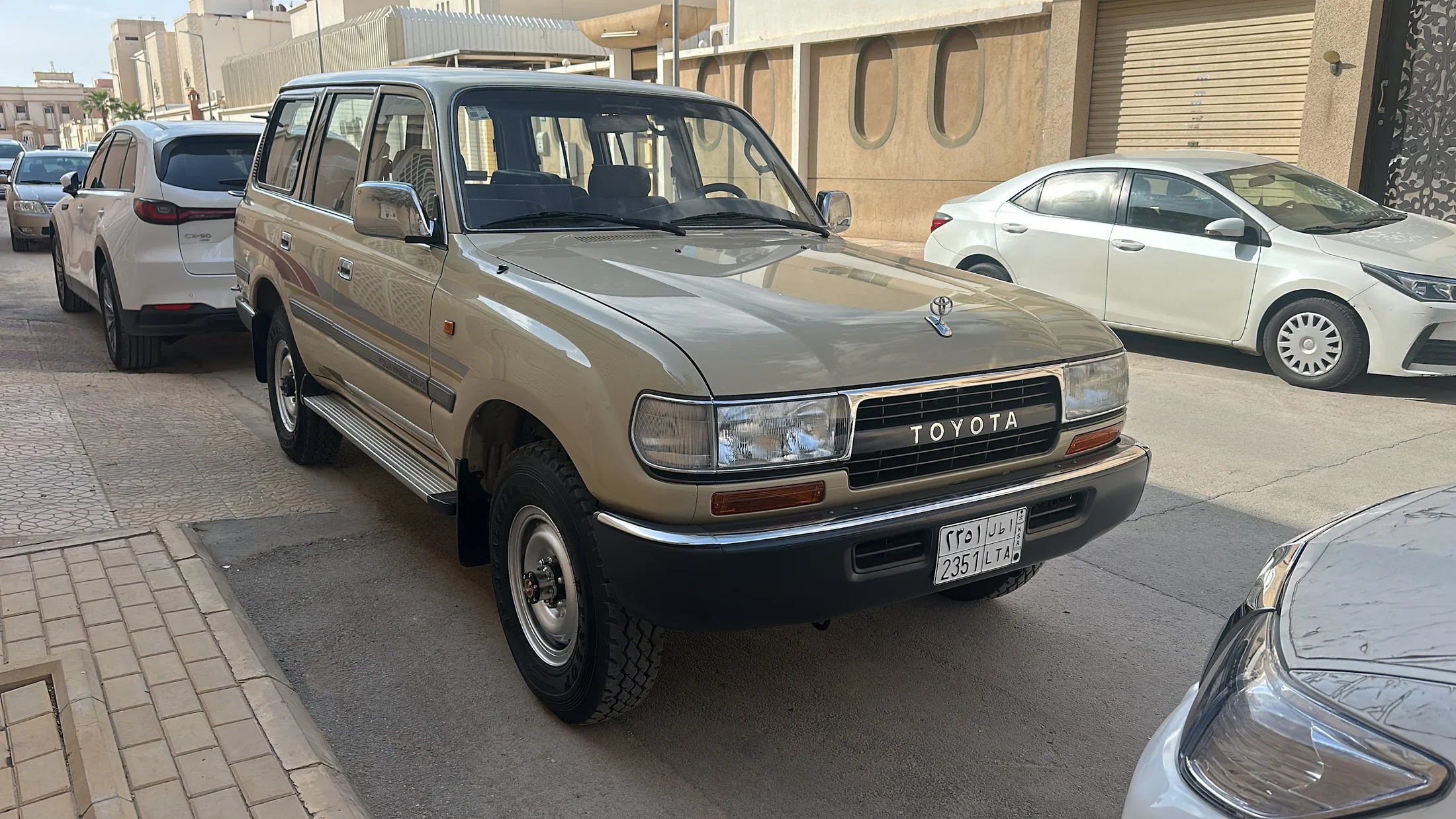

Meshal got his licence plate today
