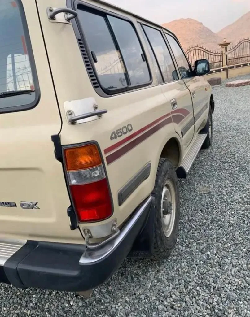

I am refreshing a low-mileage, rust-free, Saudi Arabian FZJ80. What makes it unique is not only it is a rust-free truck, but also a LHD too.
Please keep your eyes on it; it might be for sale later!
Those are the specs if someone wants more info about it:
FZJ80 LHD
GCC Specs
1994
GX
Tan with original body

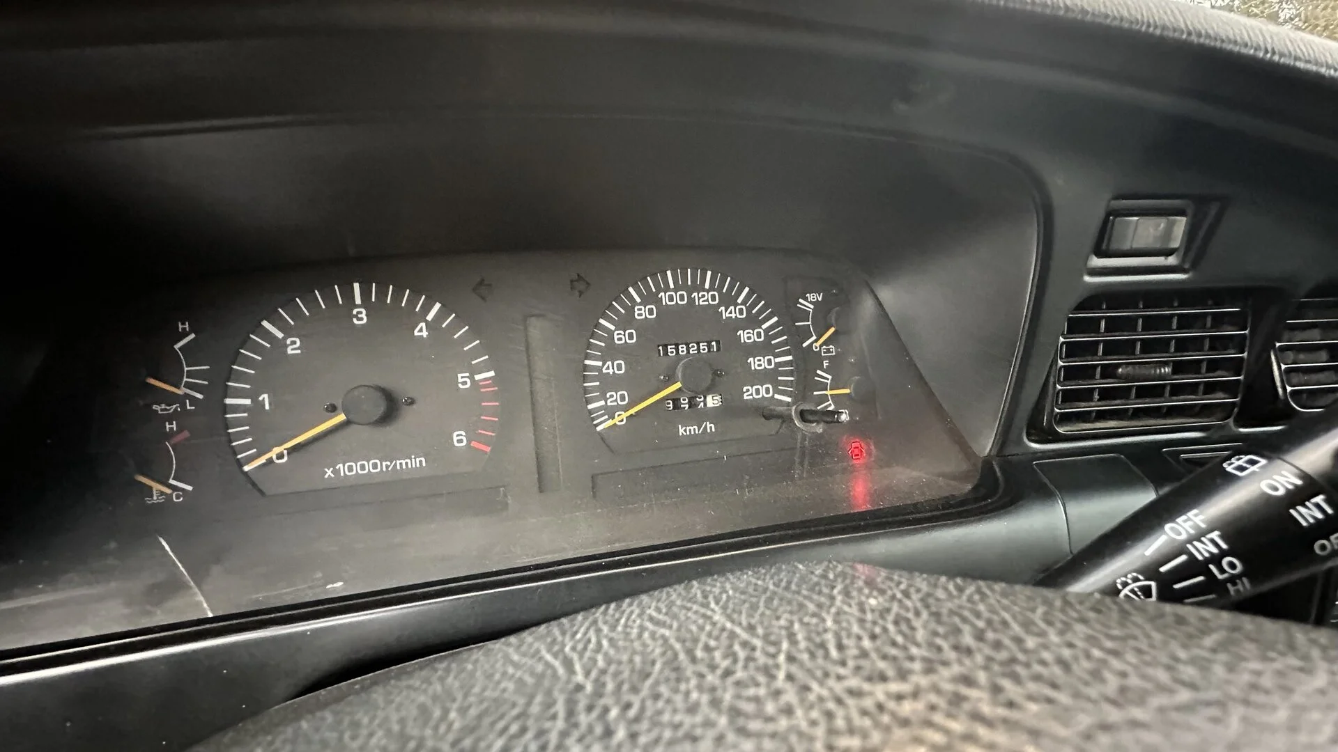

About 150k km "93205mi"

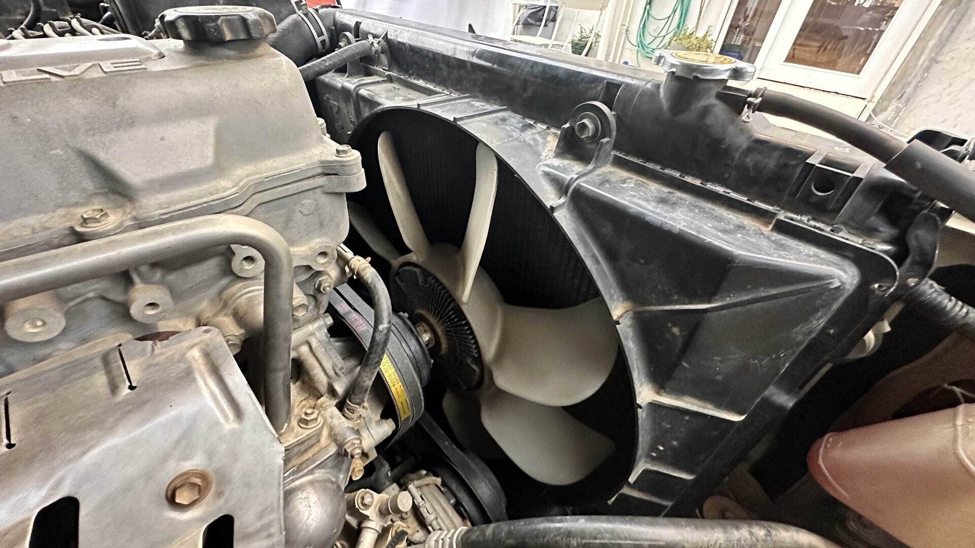

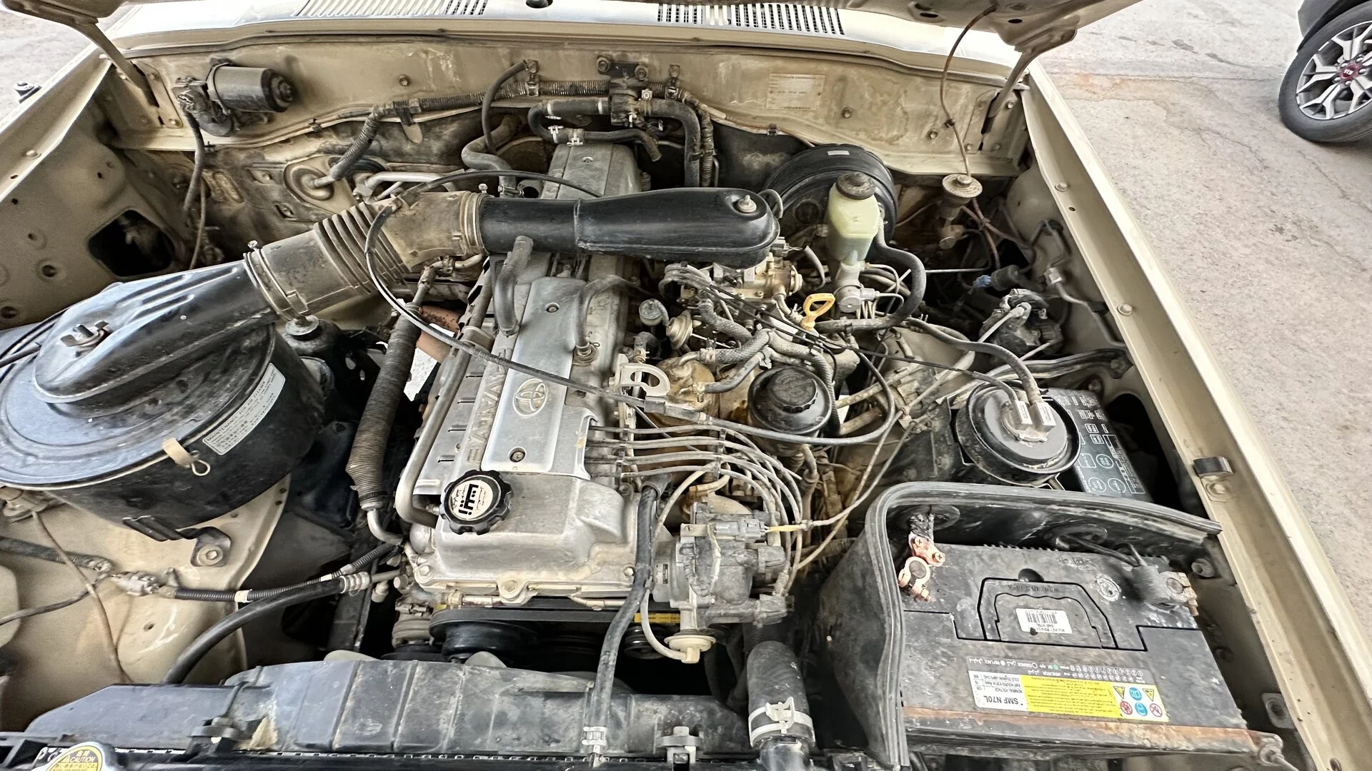

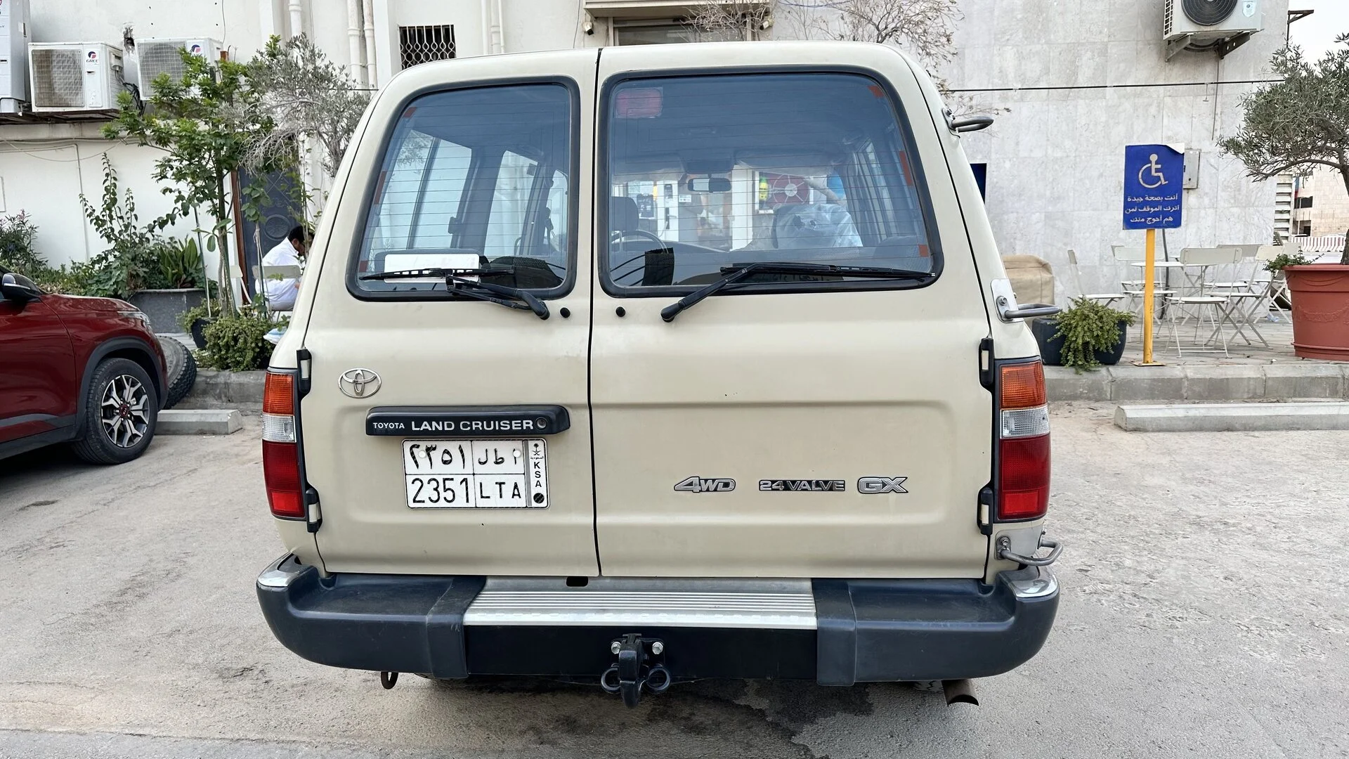

We received the truck from the transposition company, and the first this we did was clean up the cooling system because it is about summer and we don't need any surprises.

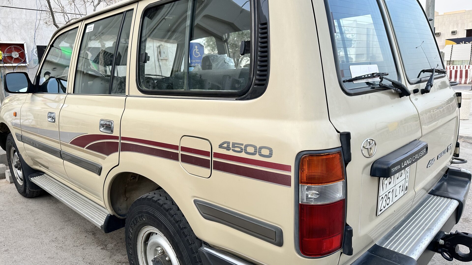

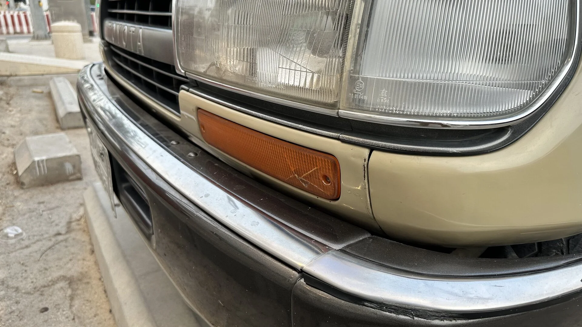

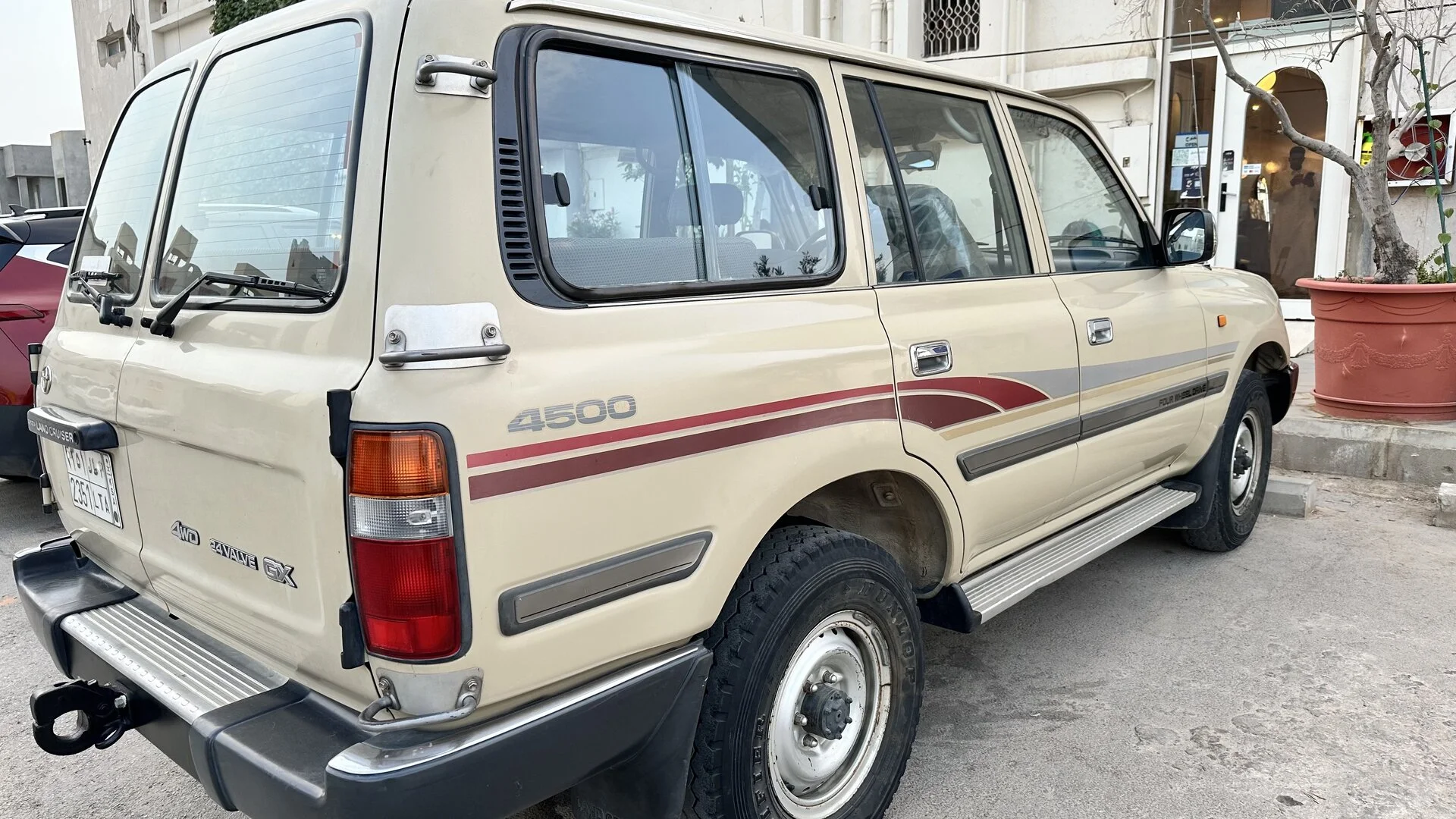

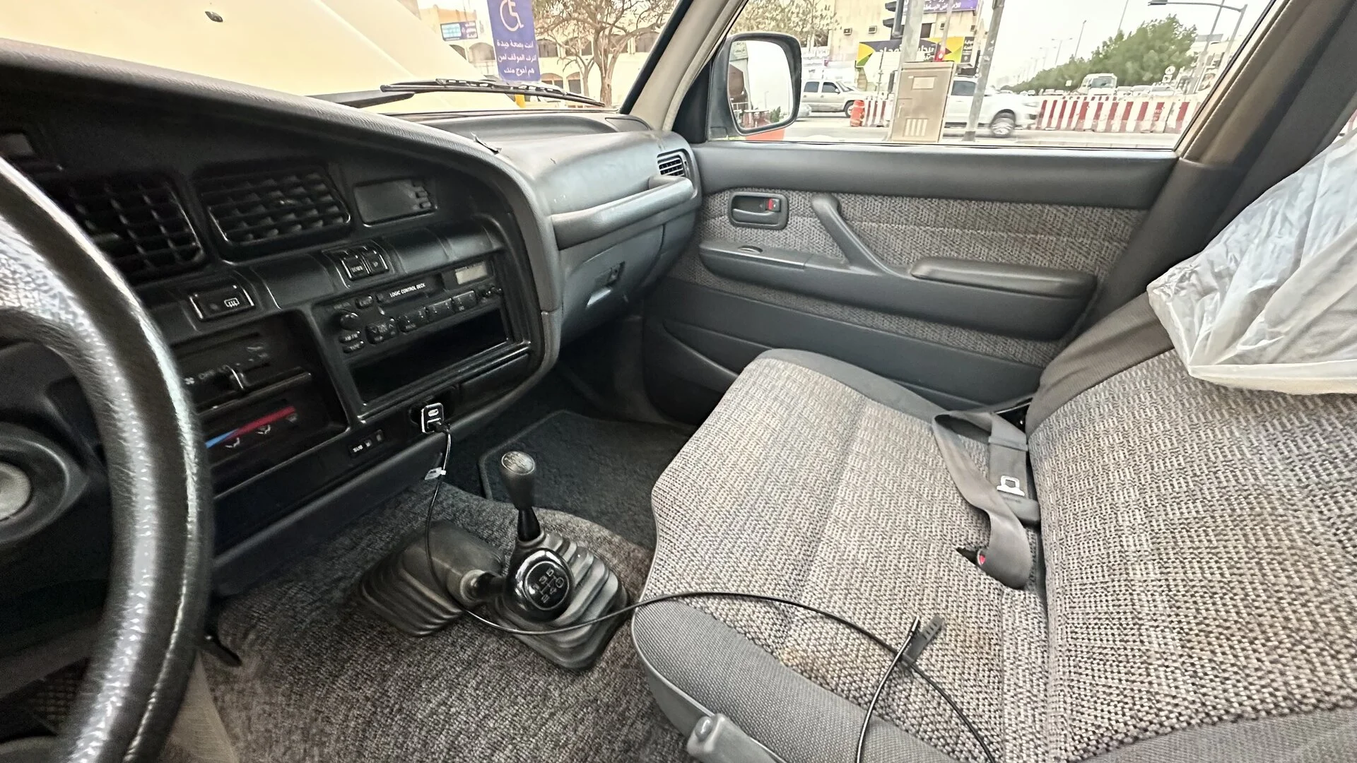

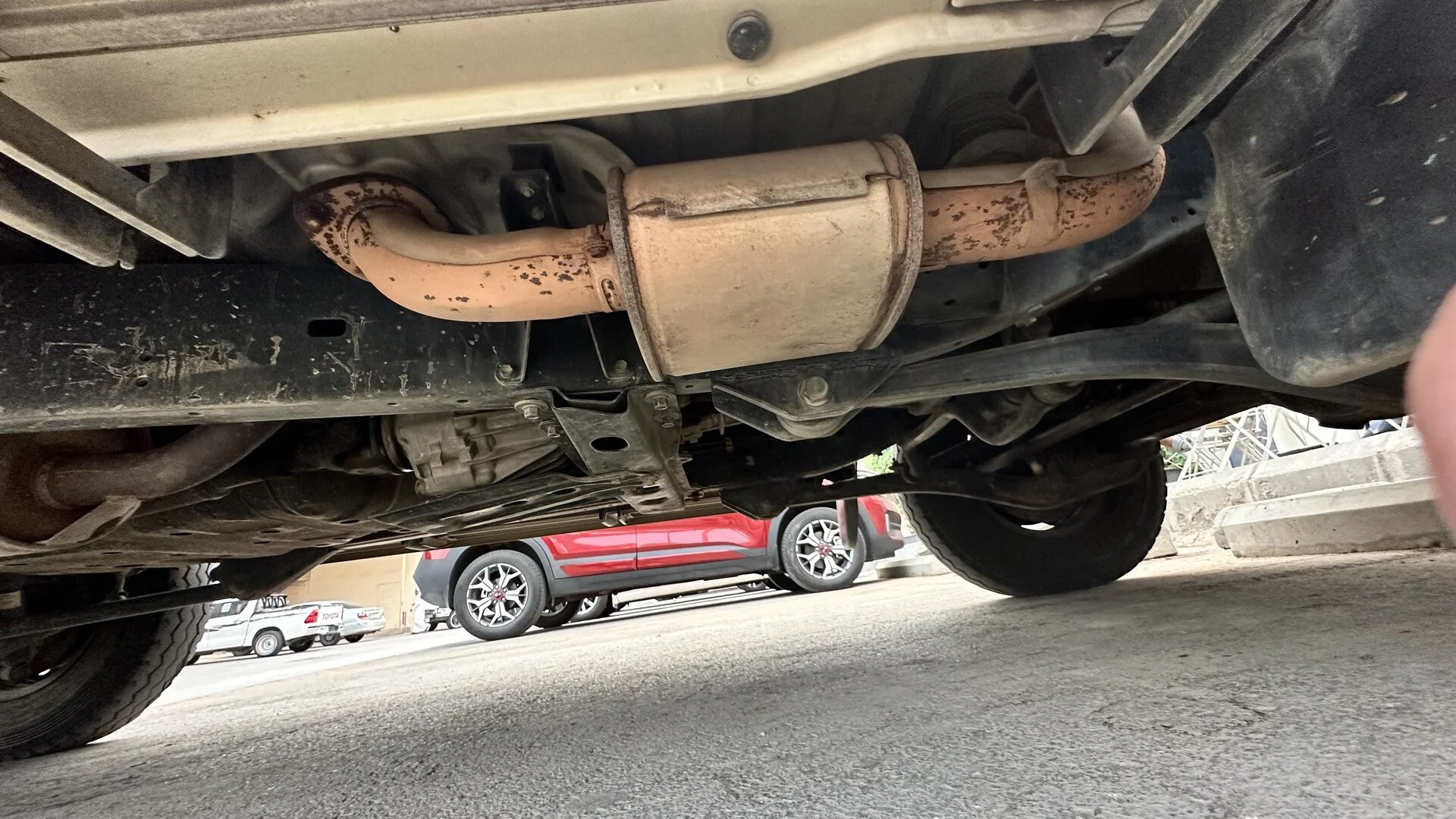

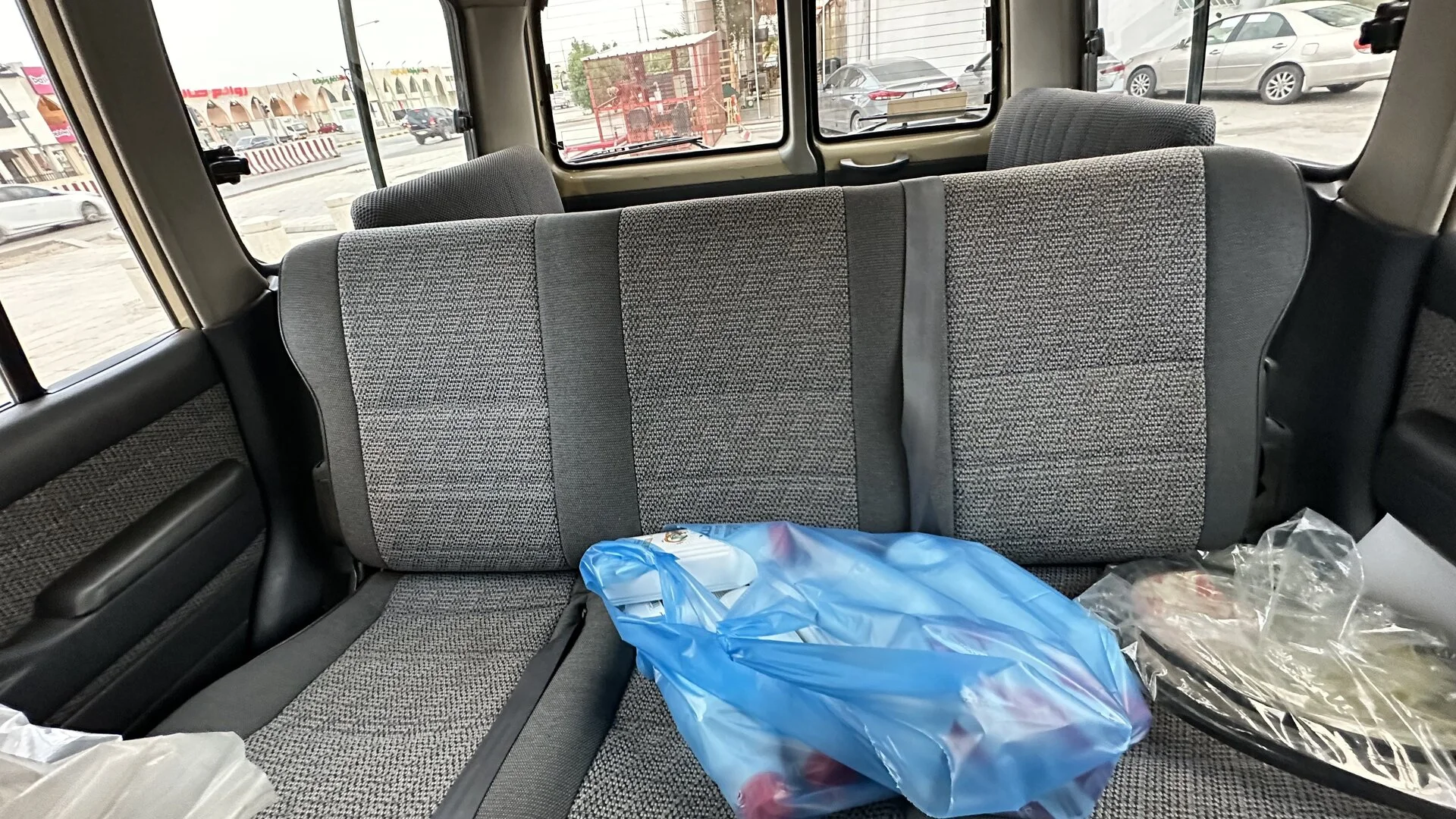

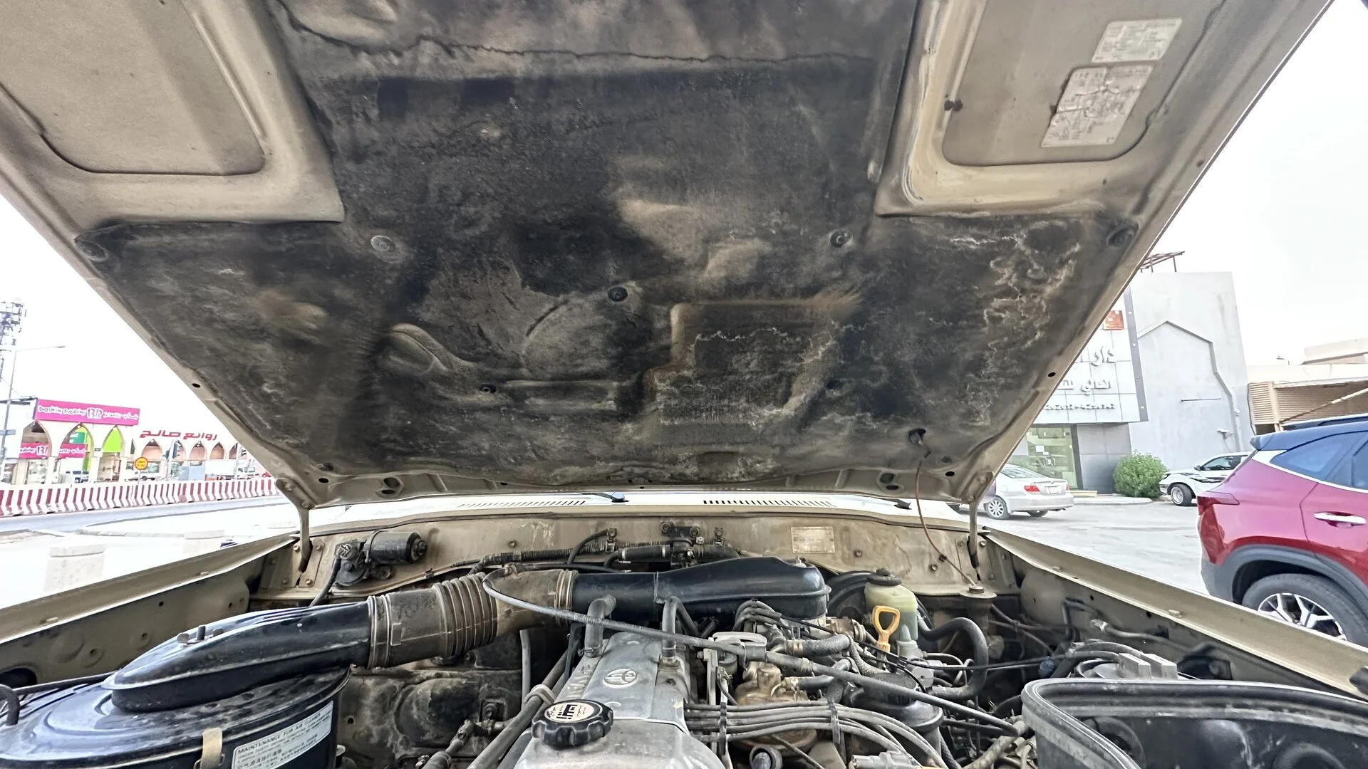

Let's start with a couple of general shots of the current condition if of the truck.

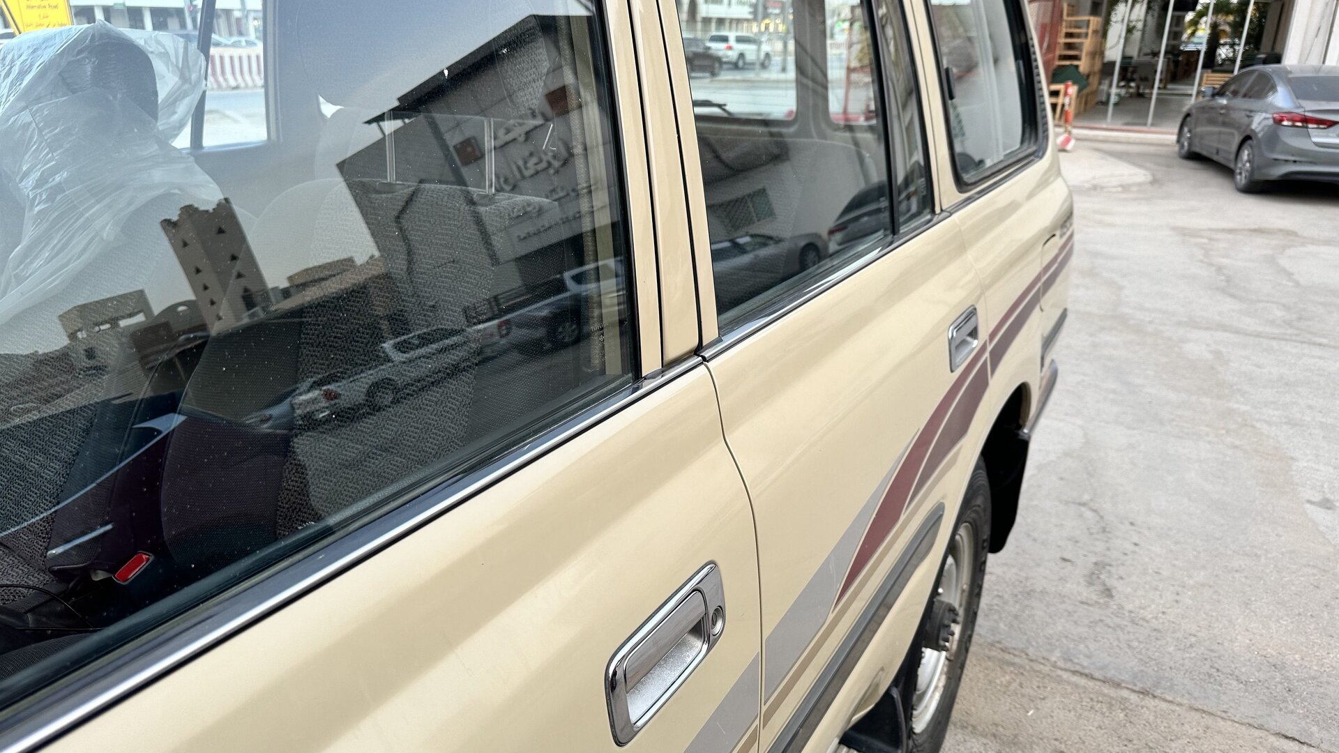

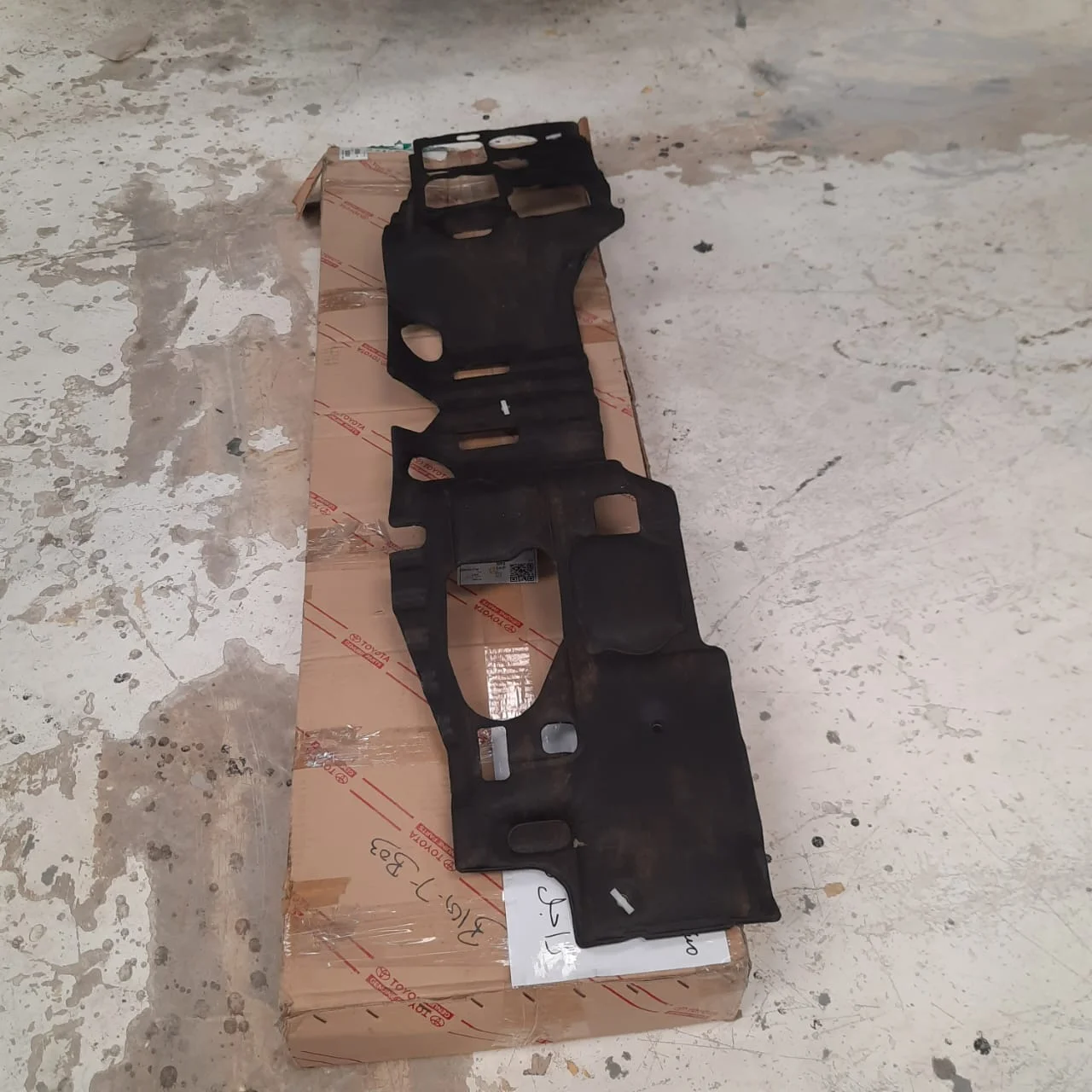

The next step is to collect OEM parts for the mechanical and body. For the body parts, this includes most of the plastic parts and rubber stripes. also, we are going to get a brand new OEM front bumper to get the exact color match "I hate repainting fj80 bumpers, I don't like to match colors haha" Good thing about GX's corners that they come with a black plastic finish.

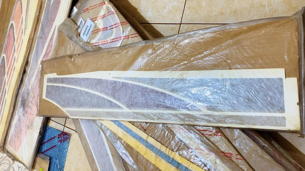

About body stripes, I'll do my best to collect a full set from over Saudi. Yes from over Saudi because they are not easy to find and Toyota is not really interested to make them again.
Here is a part that I found 9 hours drive from where I am located, haha

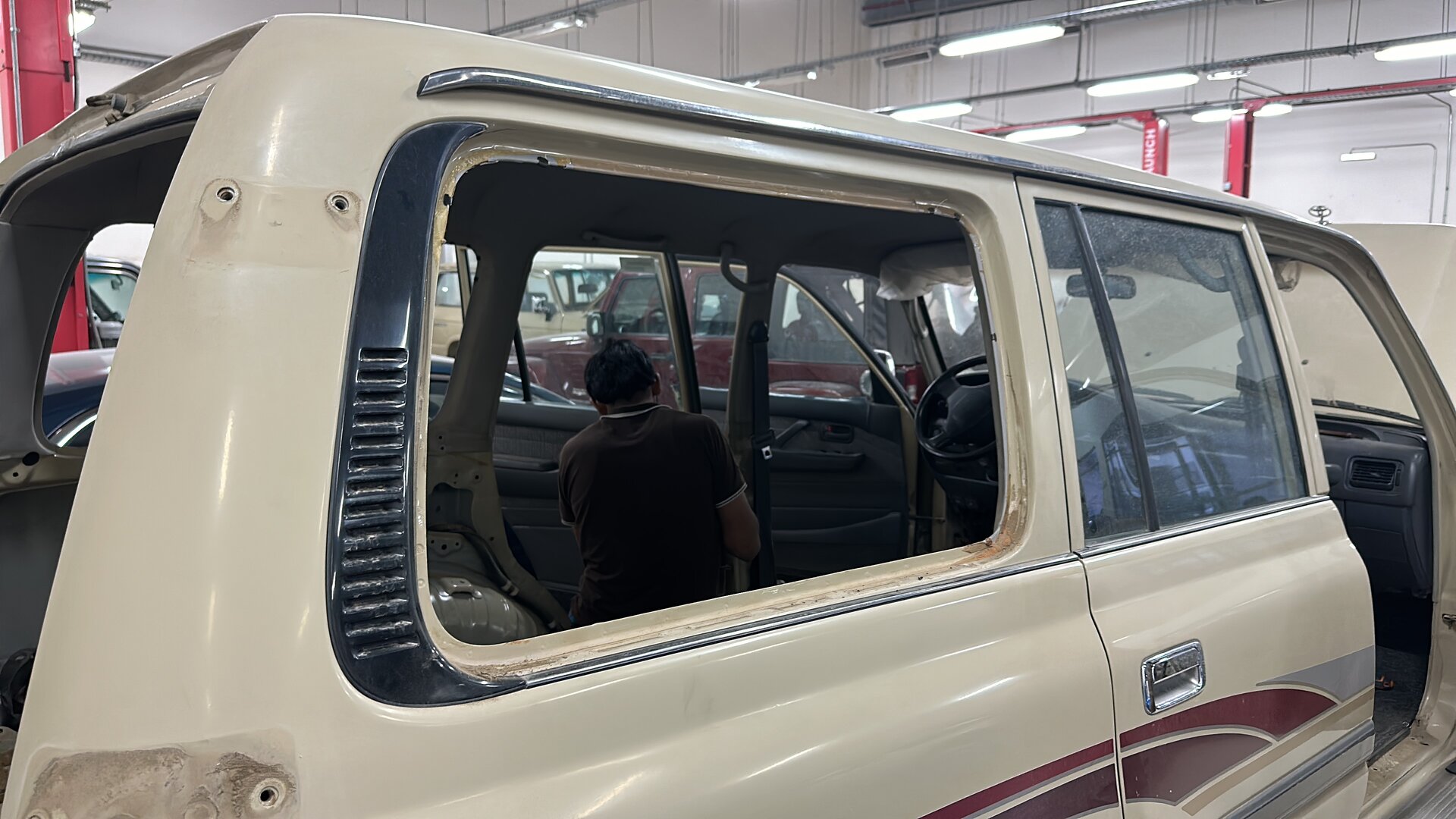

This restoration will be as much OEM as possible. All parts you will see in the future are original Toyota, except the end rods. The plan is to perform a body-off restoration while retaining the original paint on the body. This involves walking through most of the compartments underneath and then replacing most of the accessories and straps.

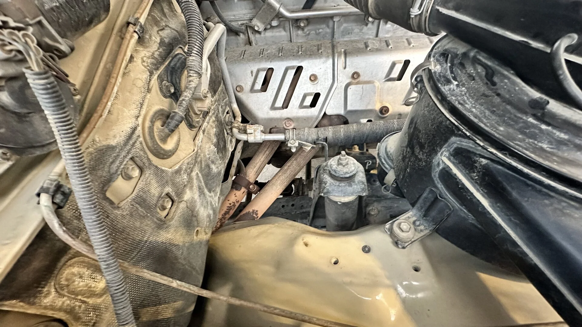

All the front of the trash

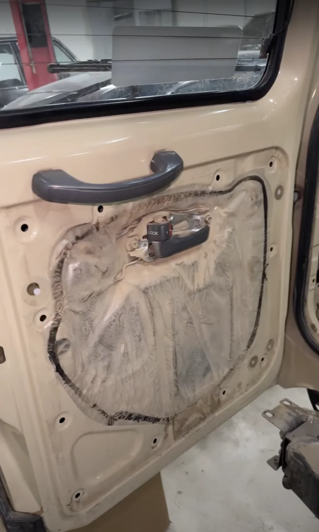

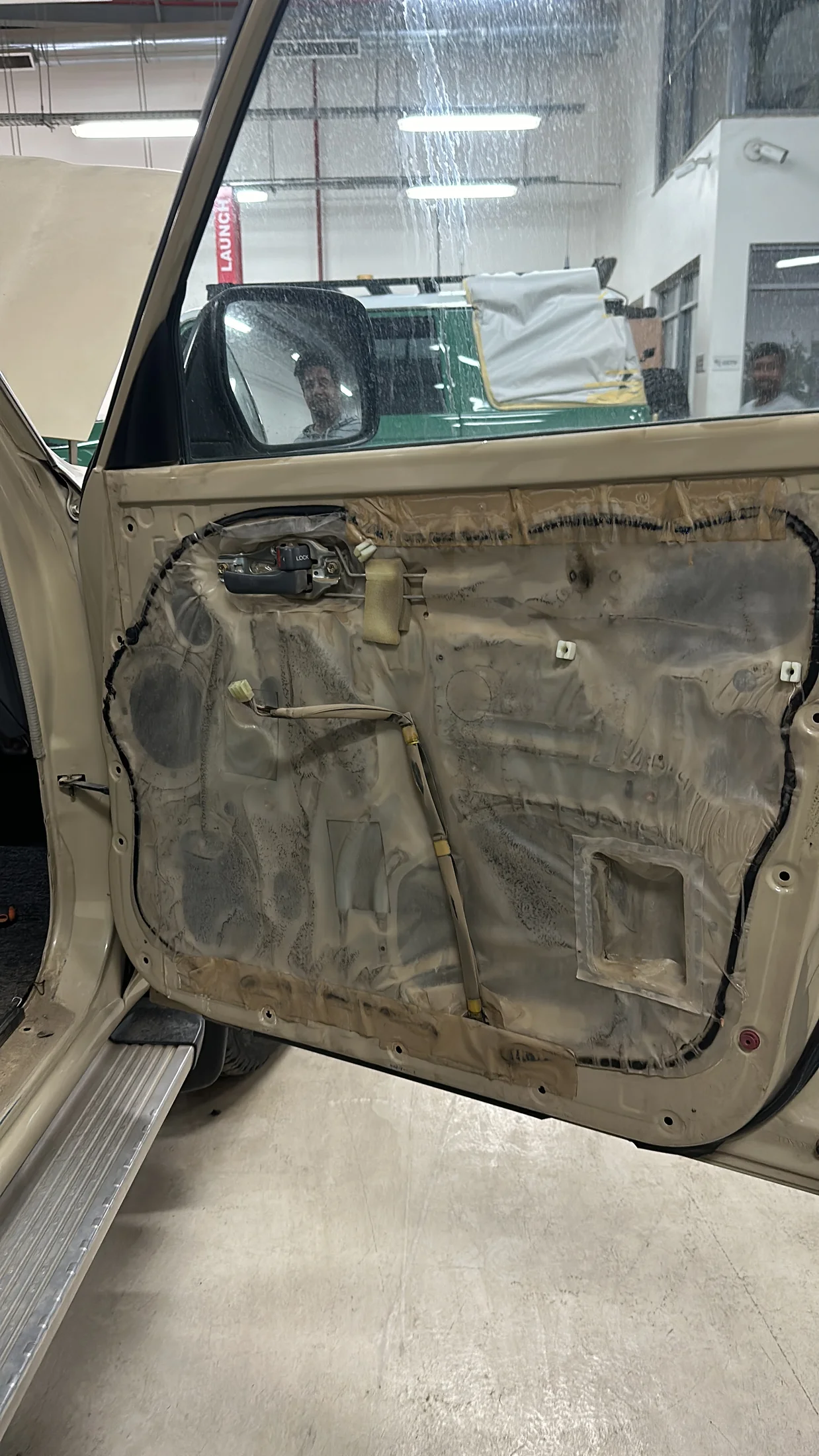

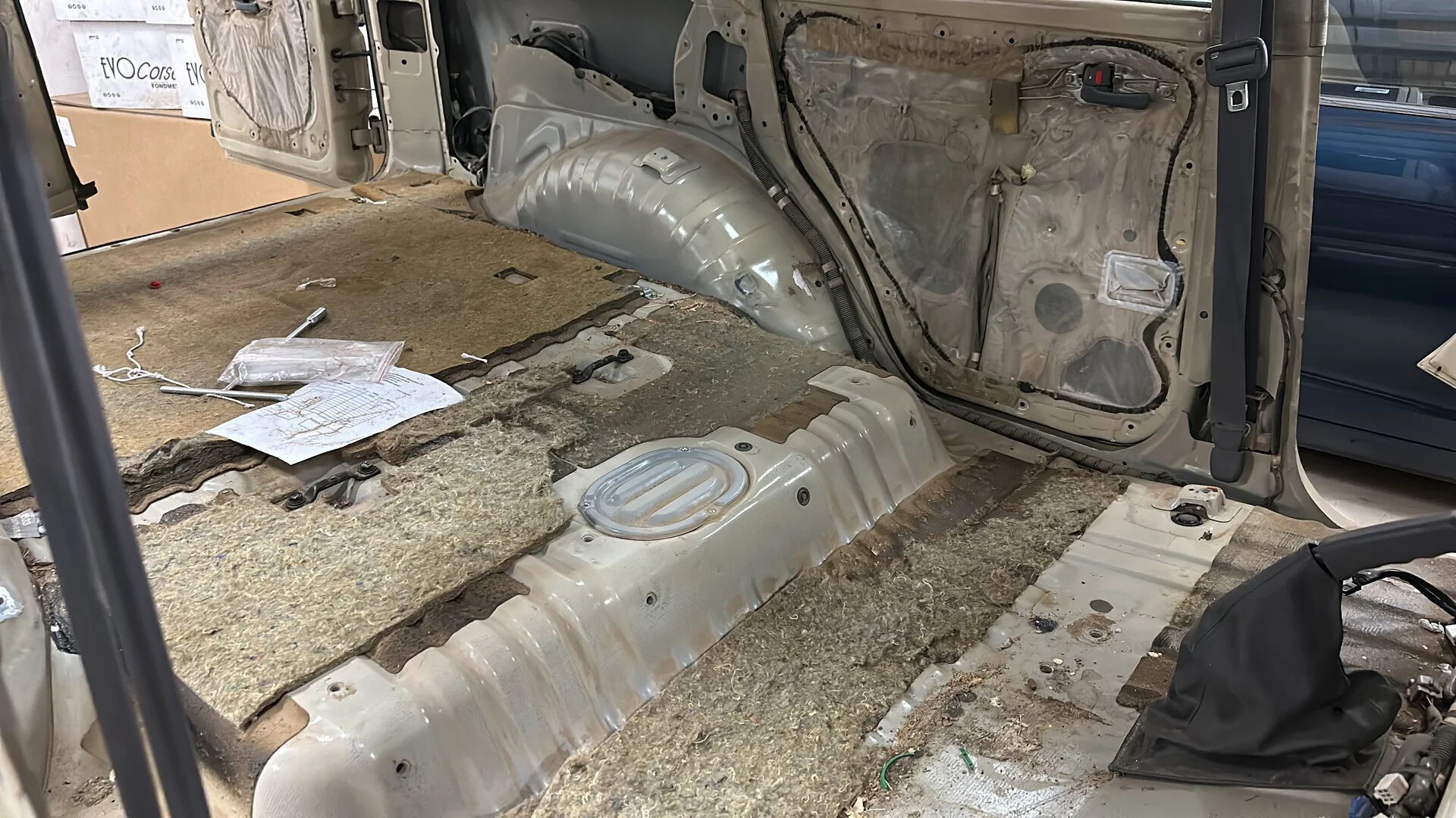

The inside of the body was collecting dust only. It is satisfying to wash this dust

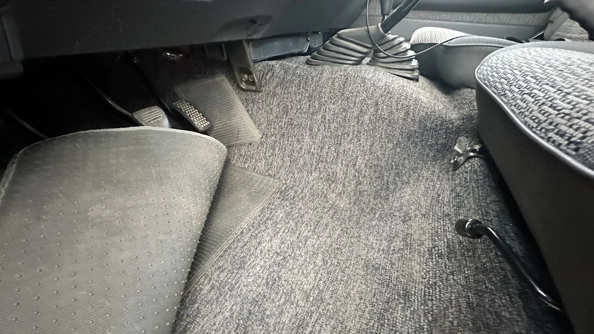

The floor has had spills and dirt from the 90s until now!

All straps will be installed new. I like sliding windows, but they must be serviced with new runs to perform well.
Two vents showed up.
Door dust covers are still available from Toyota; but unfortunately, the barn door covers are discontinued

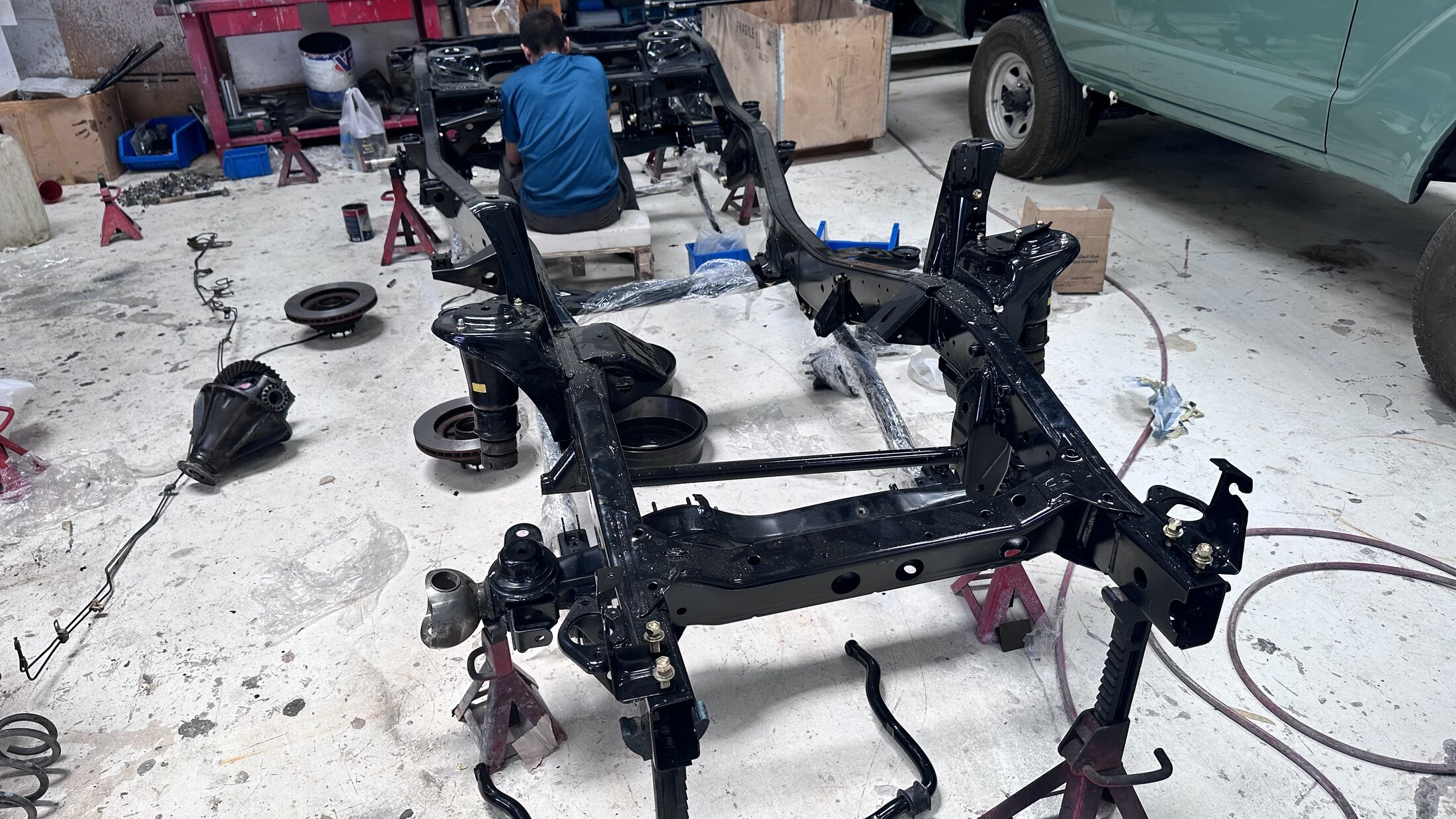

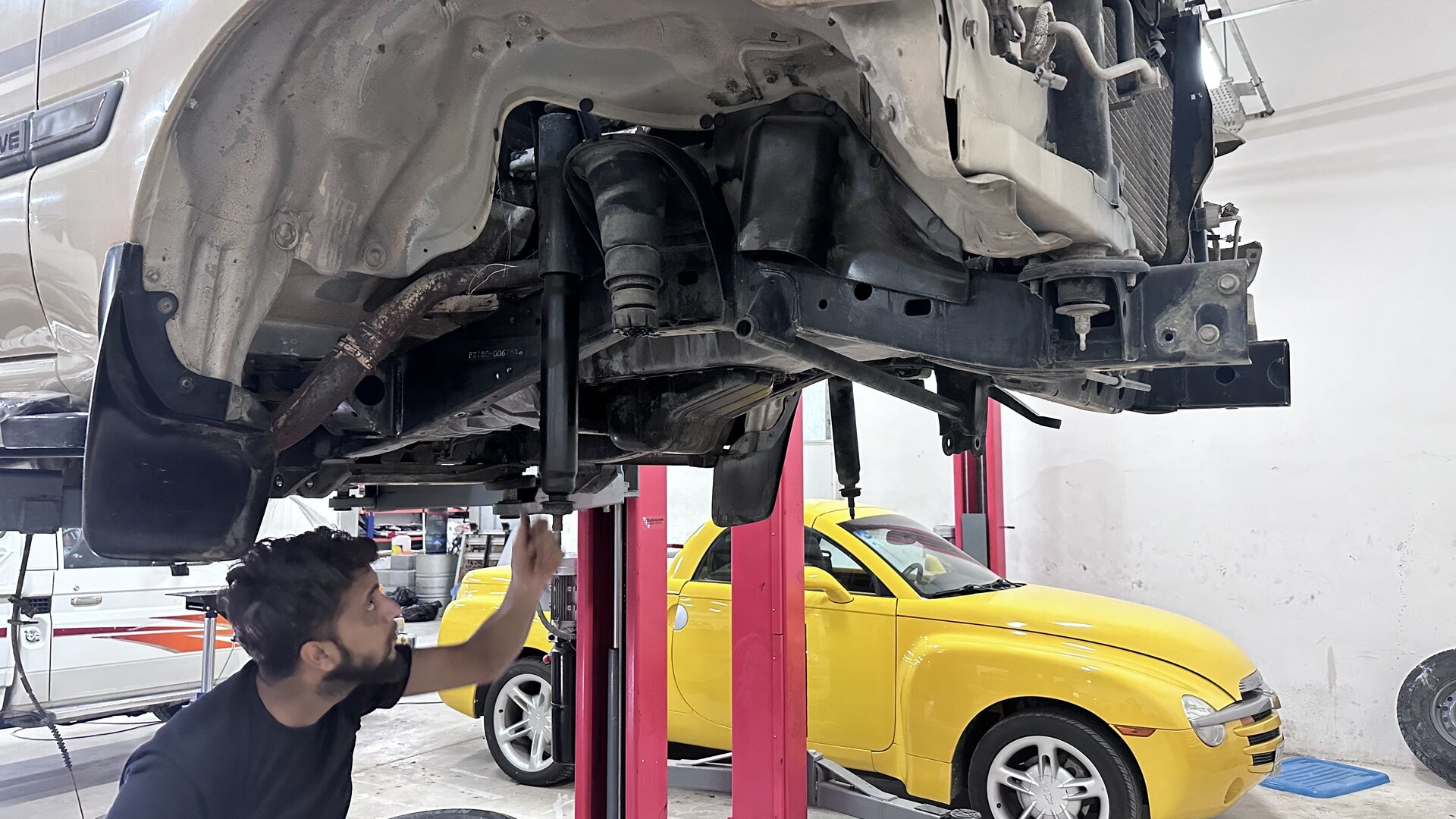

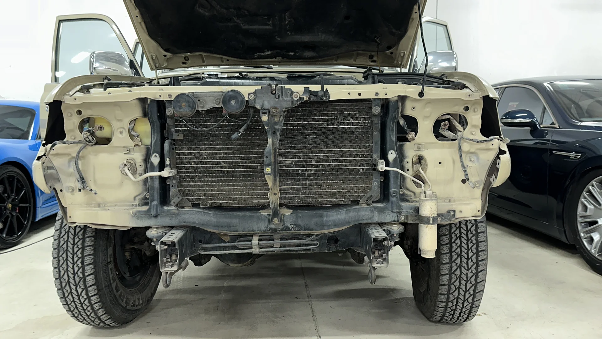

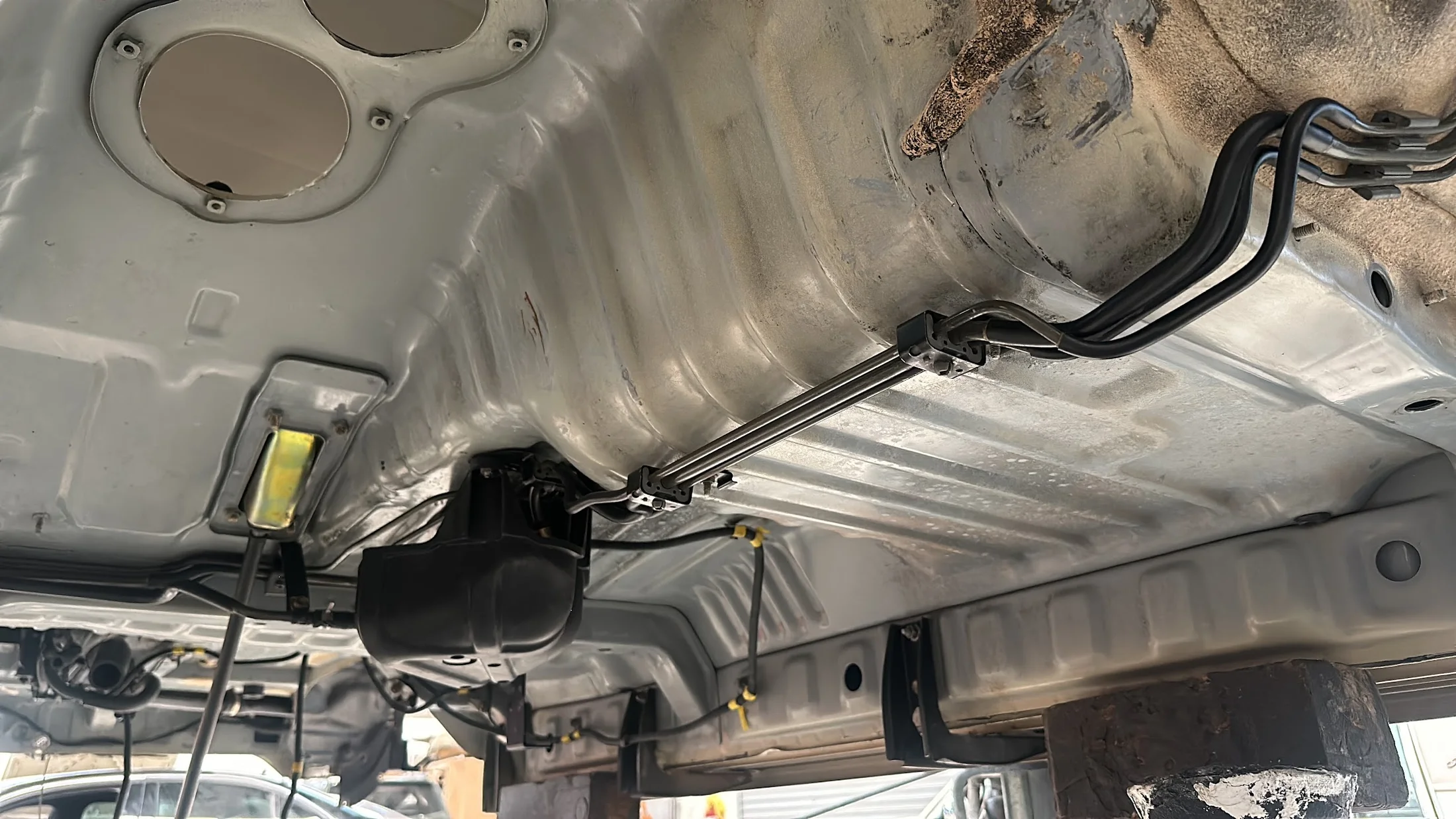

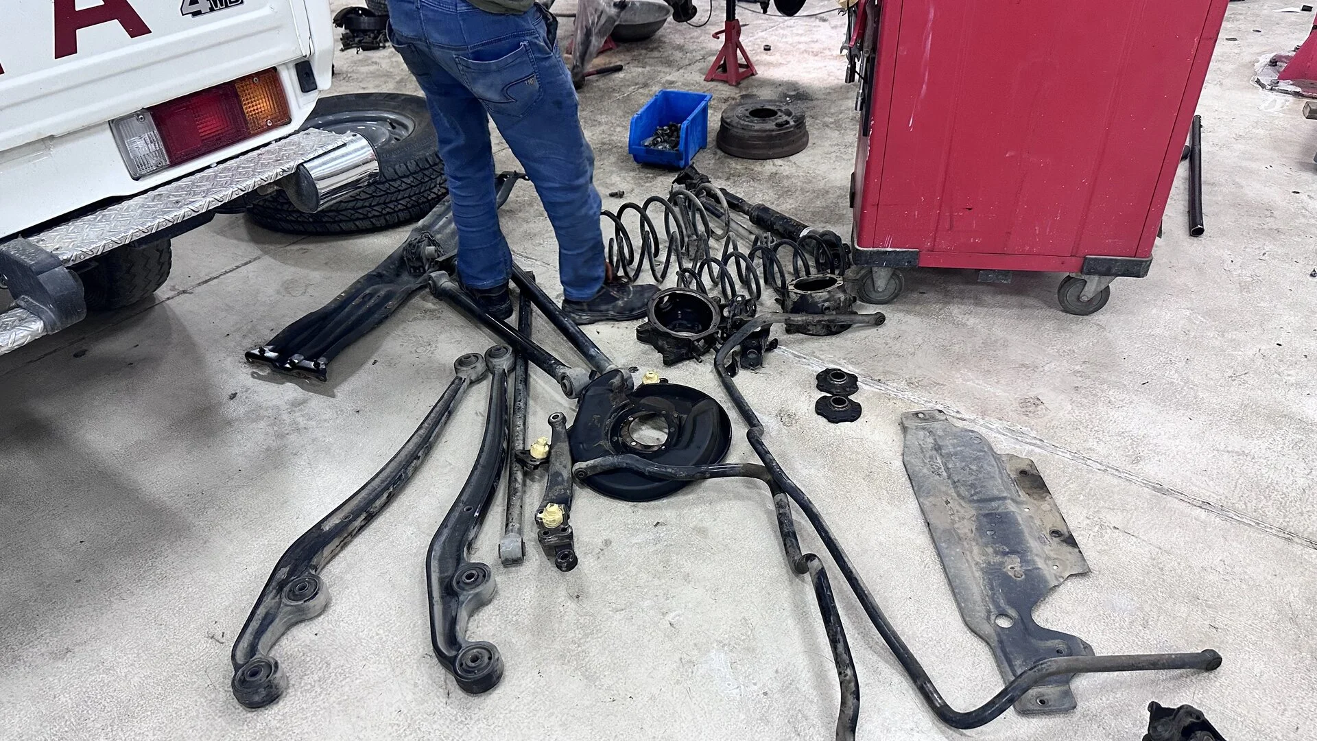

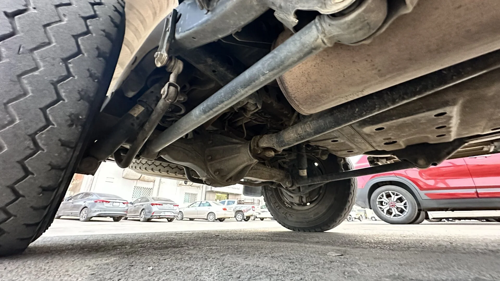

During this week, we removed most of the underneath; then, the body will be off the body soon, so we can walk through the mechanical points.

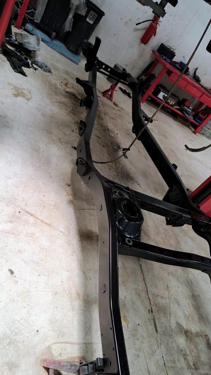

Powder coating:

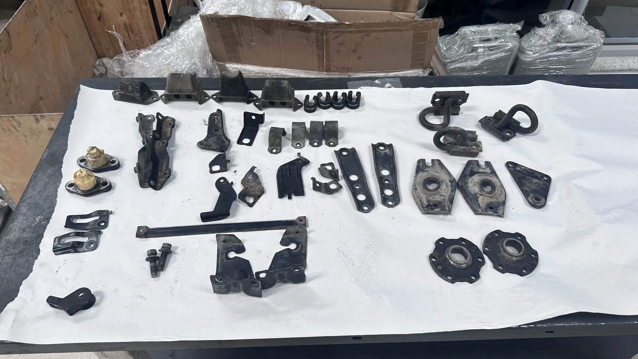

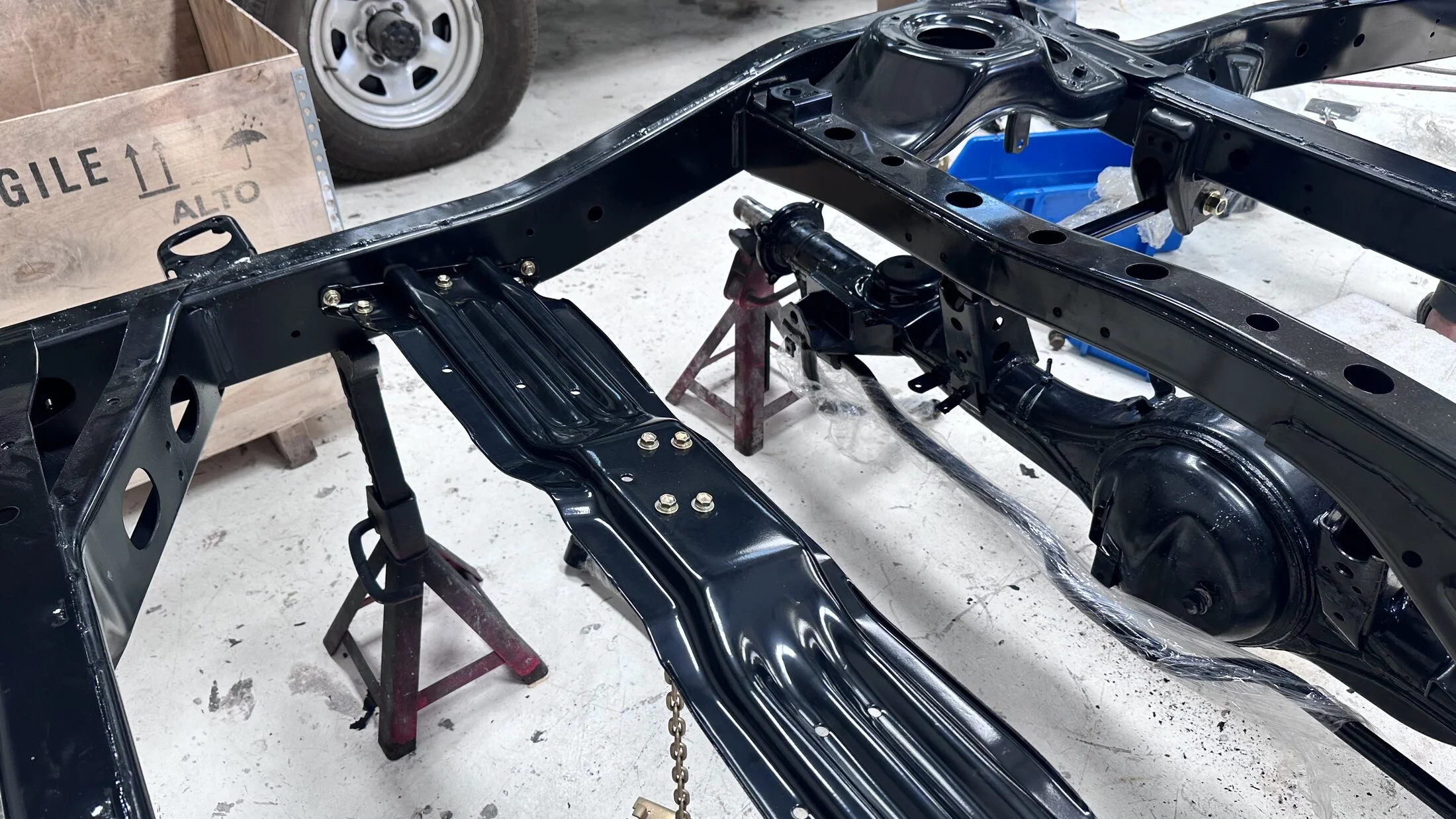

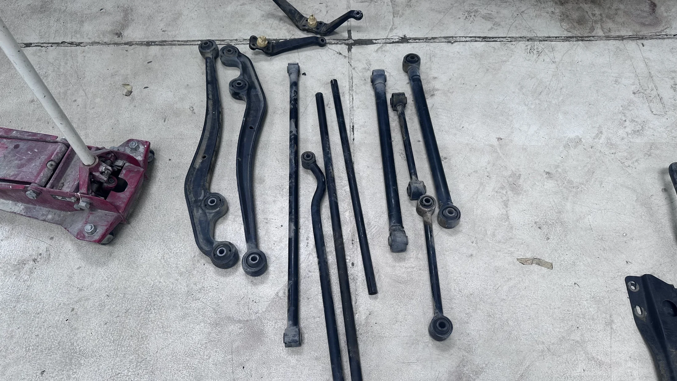

I have a style that I like to use with J80s, where I powder-coat all the small parts in glossy black and make the significant parts and the frame half glossy.
All bushes have been removed to be replaced after the paint.

I do believe that Toyota has a stronger chassis paint starting from the 90s models. So we only polished the paint and painted any areas affected by road sand.

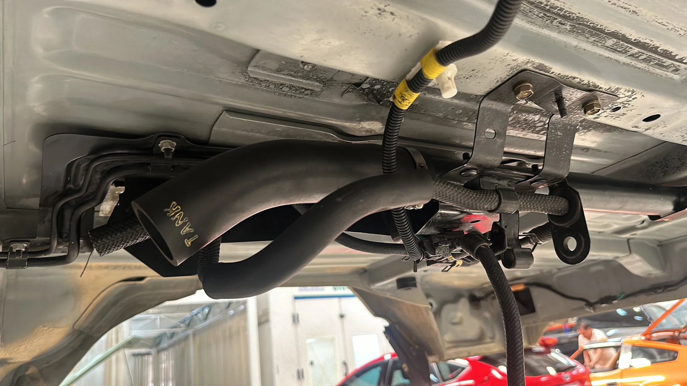

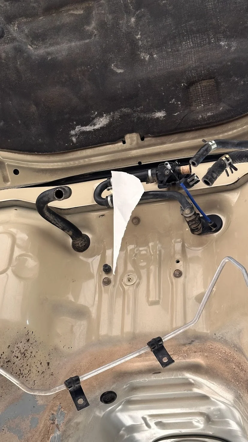

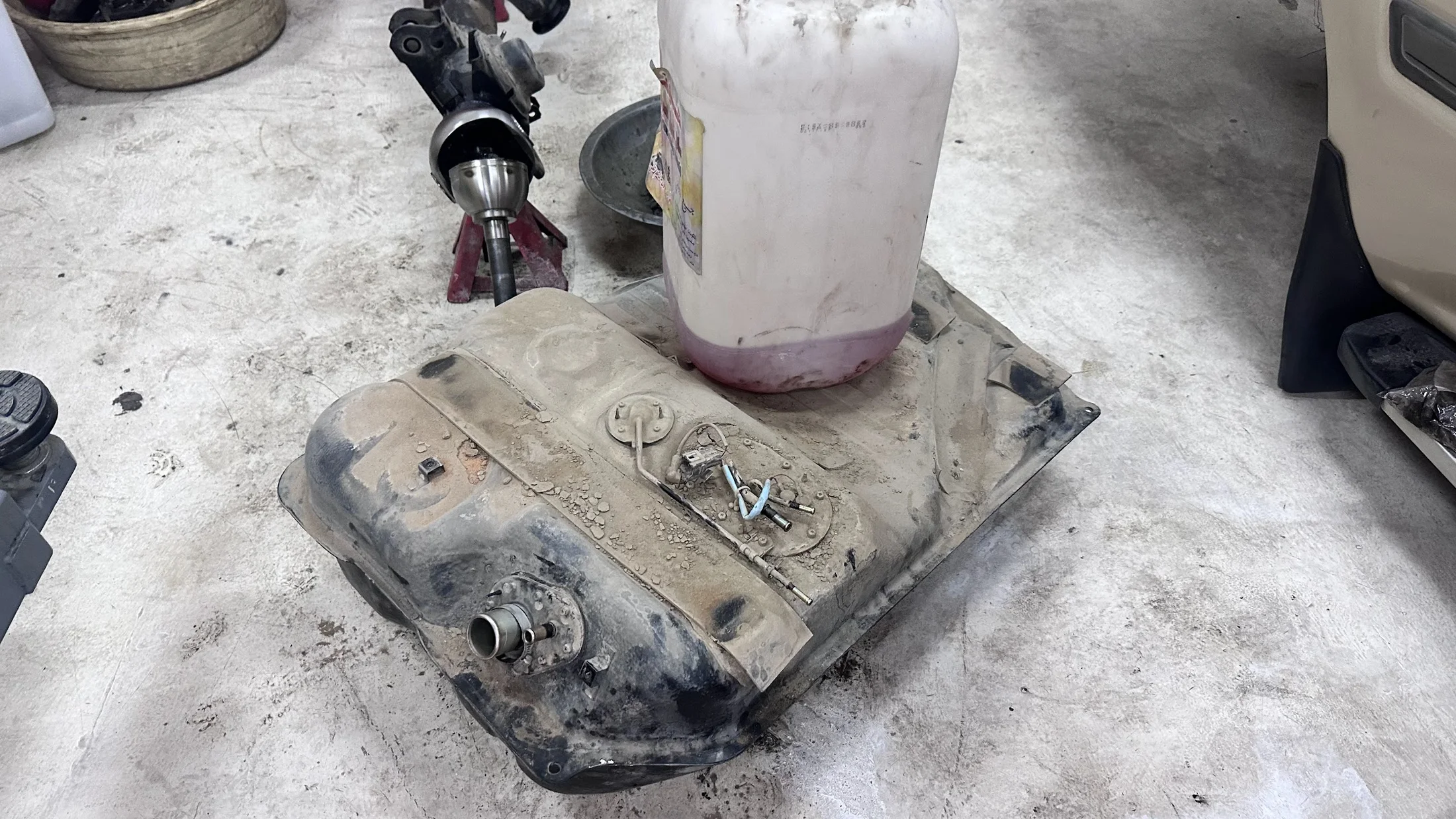

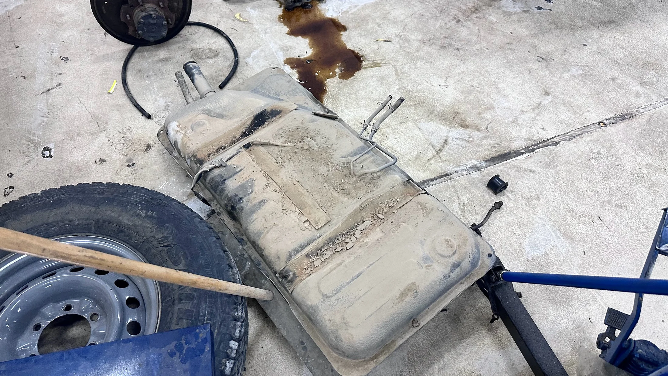

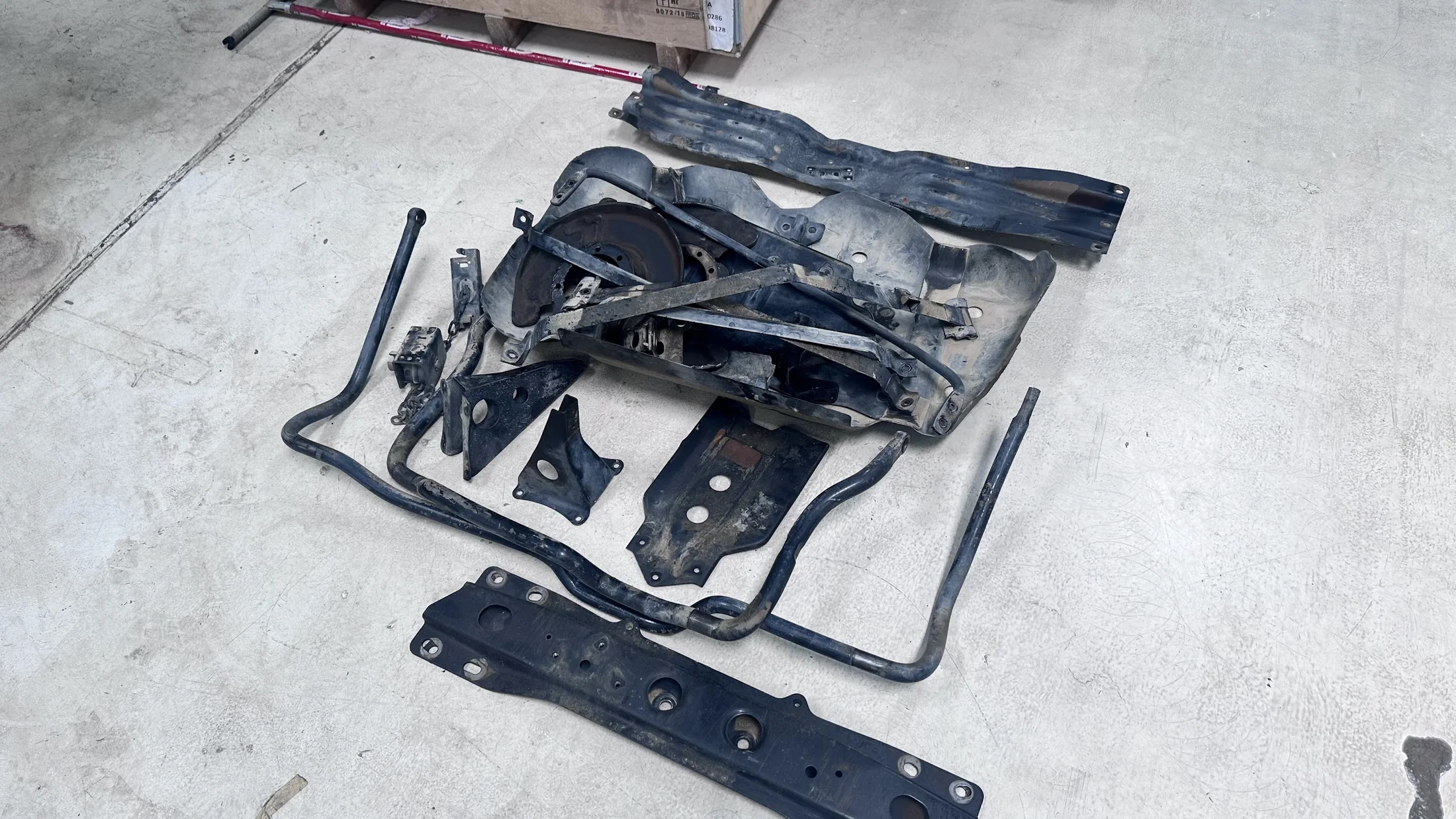

While the boy is up, we are washing the gas tank "tank guards are all to the powder coating," then I replace all gaskets, and try to provide as many hoses as I can.
Sub tank
Main tank

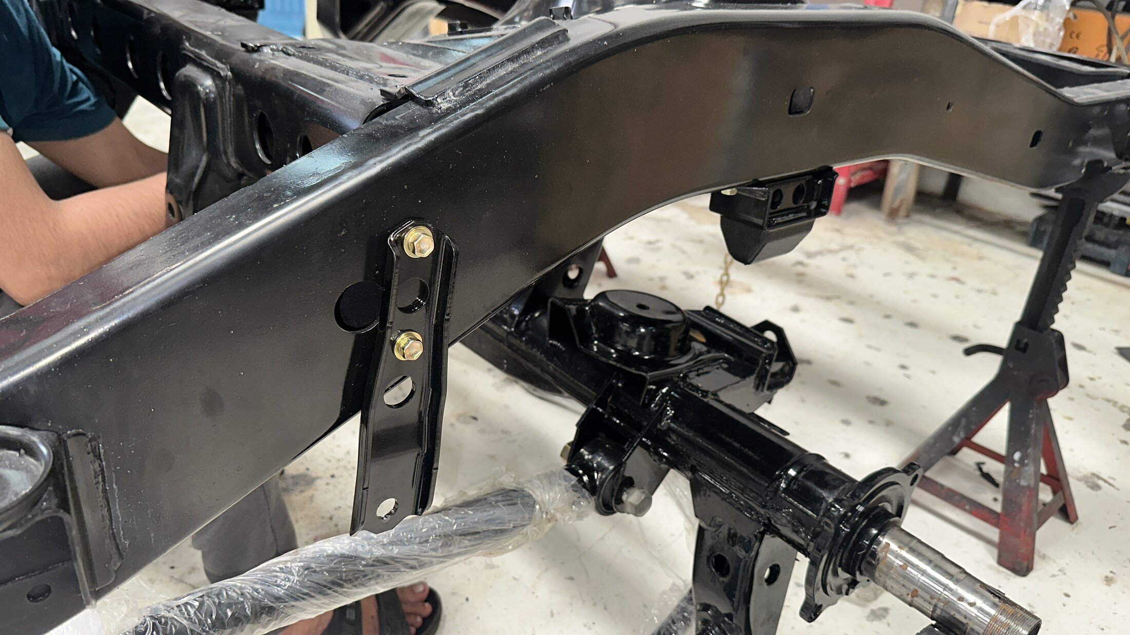

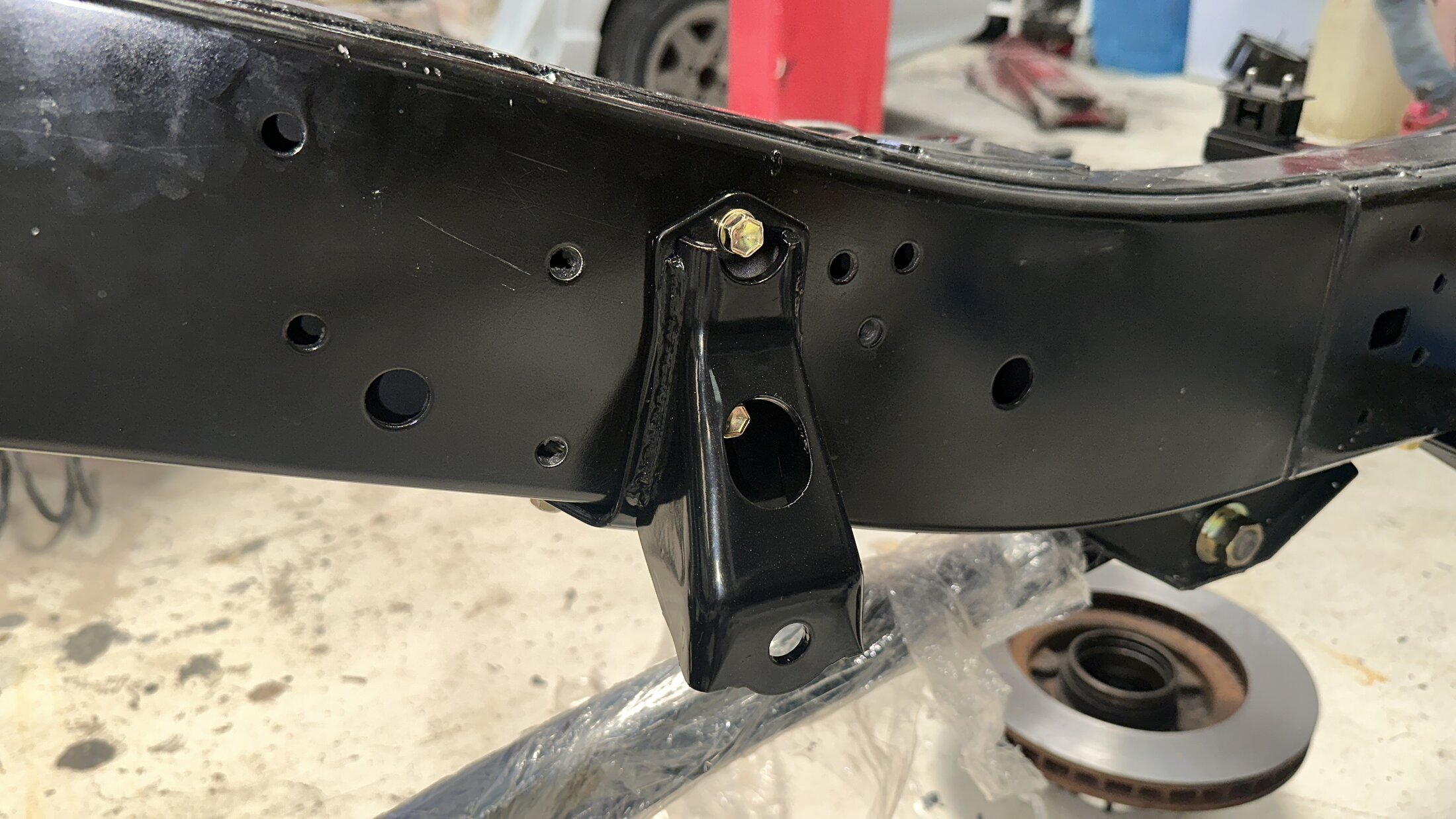

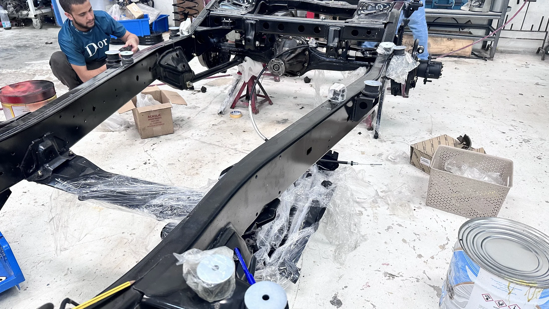

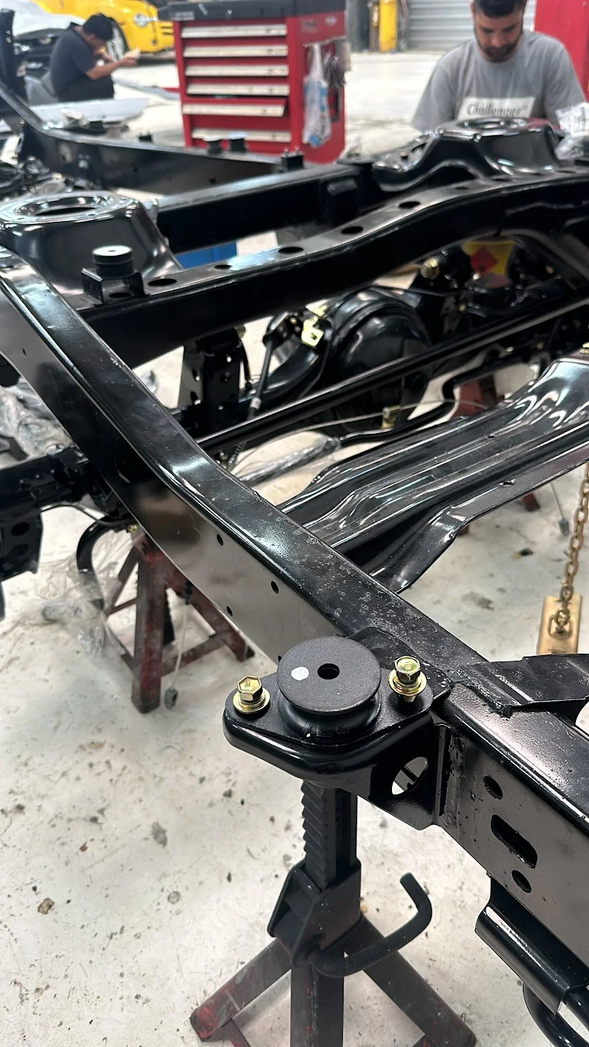

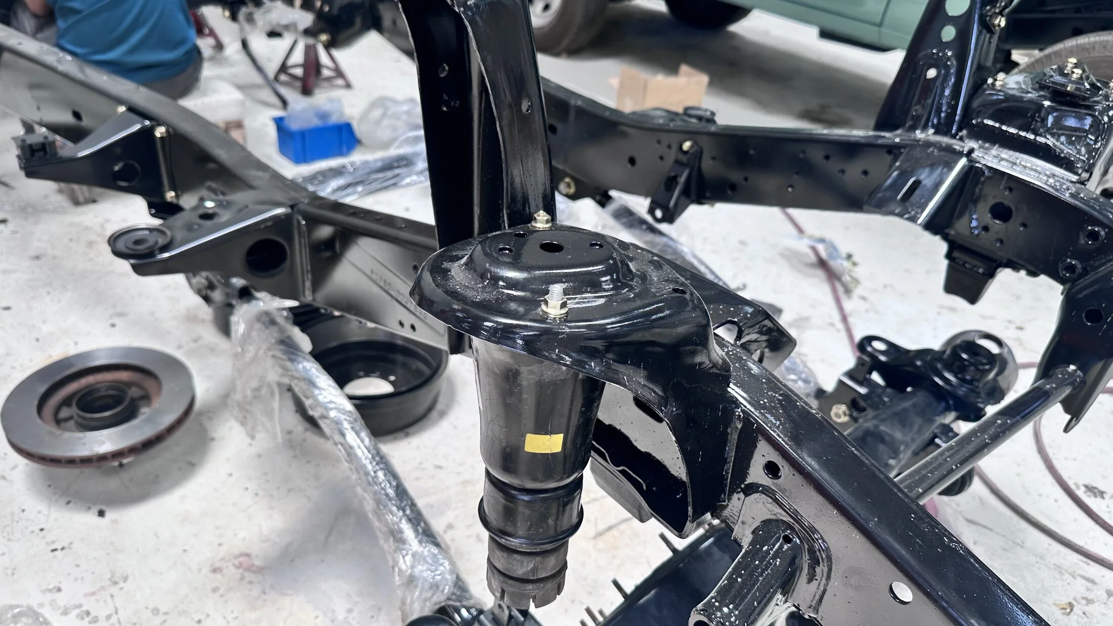

The chassis is being assembled with zinc screws and new parts.
CHASSIS
4870260050 bush, front arms, set of 4
4806160010 bush, front arms, set of 2
4870260031 bush, rear upper control arm, set of 4
4870260040 bush, rear lower control arm, set of 4
4870660030 bush, front control rod, set of 2
4870660040 bush, rear control rod, set of 2
4831060030 front suspension hollow, set of 2
4880260120 link sub-assy, front stabilizer, set of 2
9038511021 bush, front/rear stabilizer bar link, set of 4
4881560070 bush, front stabilizer bar, set of 2
4881526020 bush, rear stabilizer bar, set of 2
4825760020 insulator, rear coil spring, set of 2
1740566020 pipe assy, exhaust, tail
1756717010 cushion for exhaust pipe, set of 3

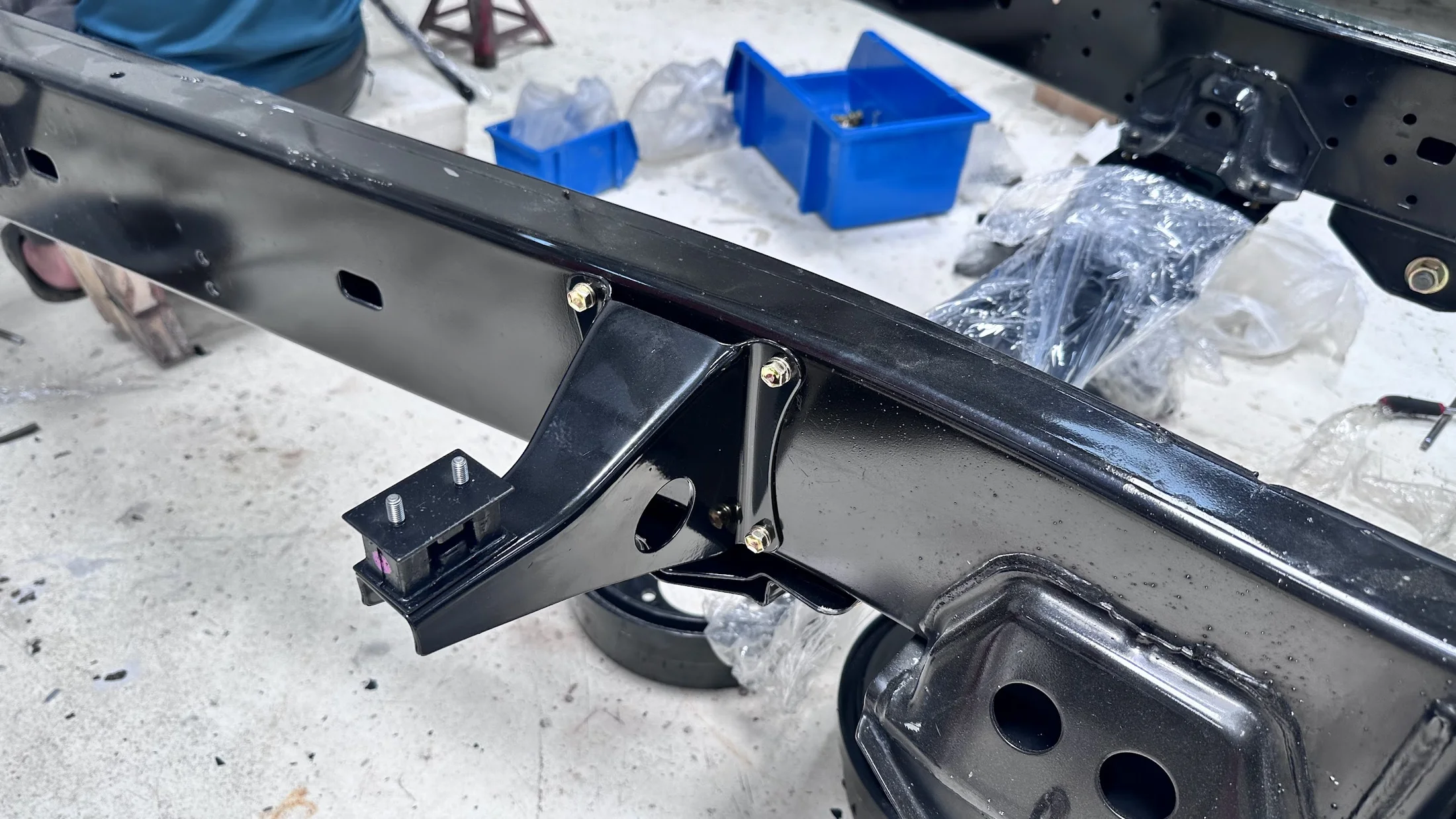

BODY MOUNTS
No. 1
5220160021 cushion, mounting, set of 2

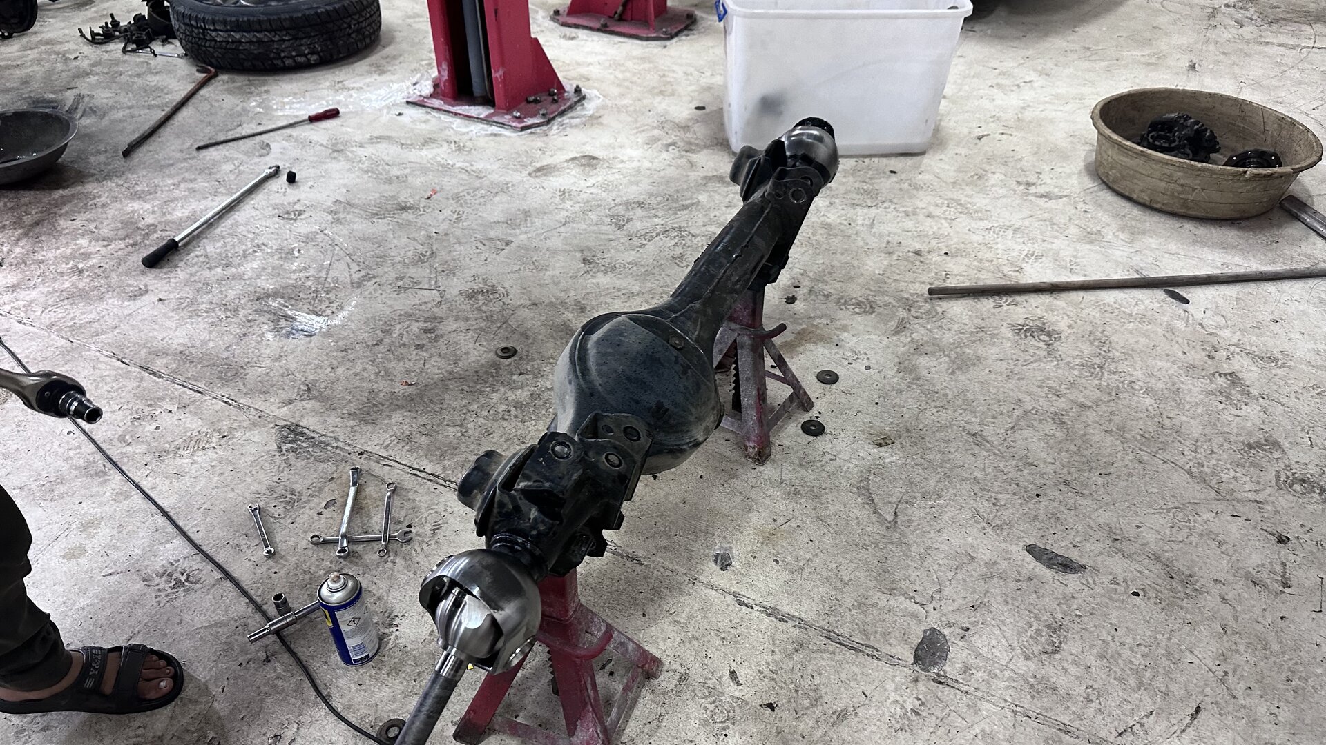

FRONT AXLE OVERHAUL
0443460051 knuckles gasket kit

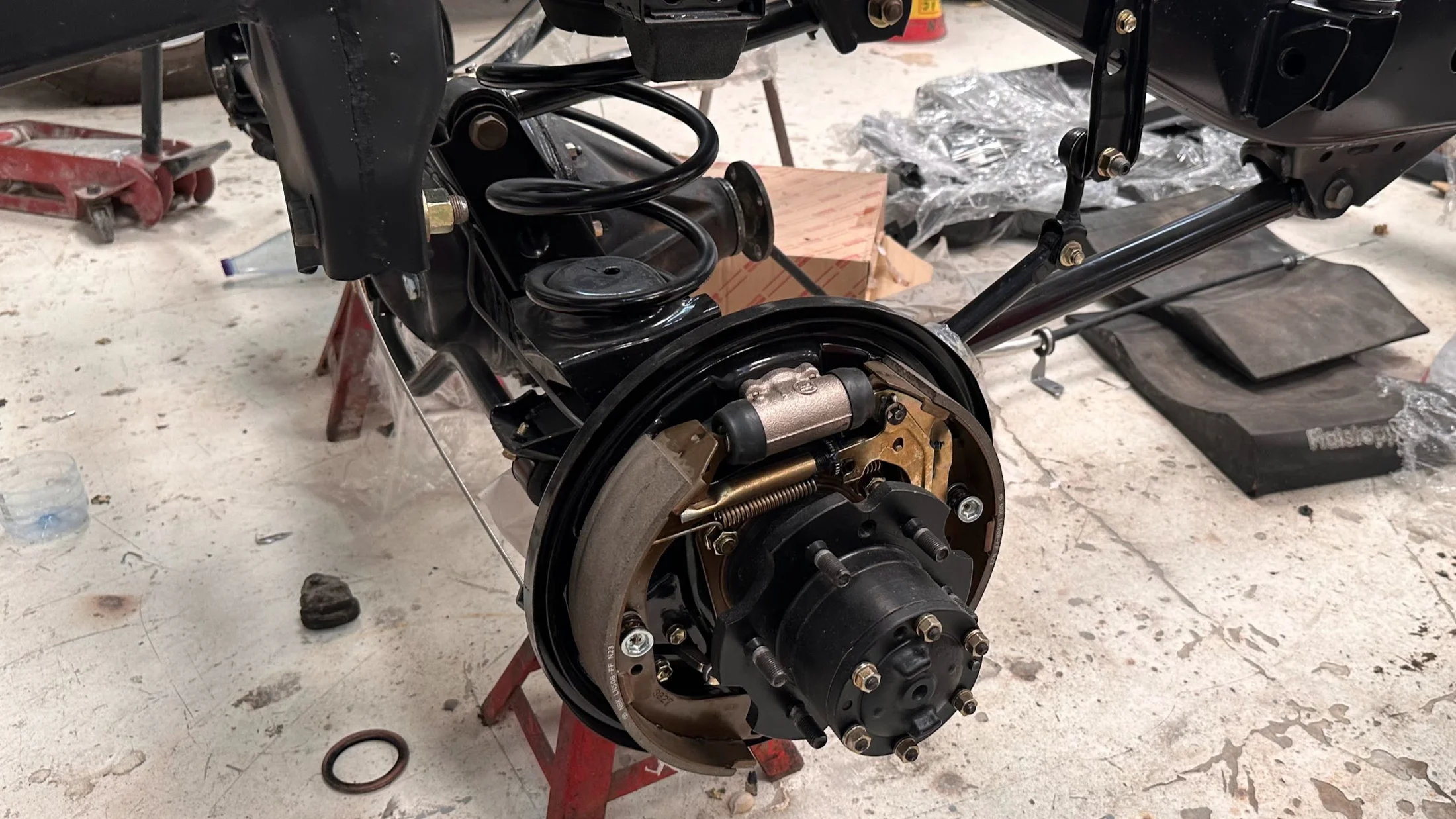

REAR AXLE
4320960050 hose, rear axle breather
4218160070 gasket, rear differential carrier
9031393001 seal, rear axle, set of 2
9031036003 seal, rear shafts. set of 2
9031162001 seal rear hub, set of 2
4342260040 gasket, rear shafts, set of 2

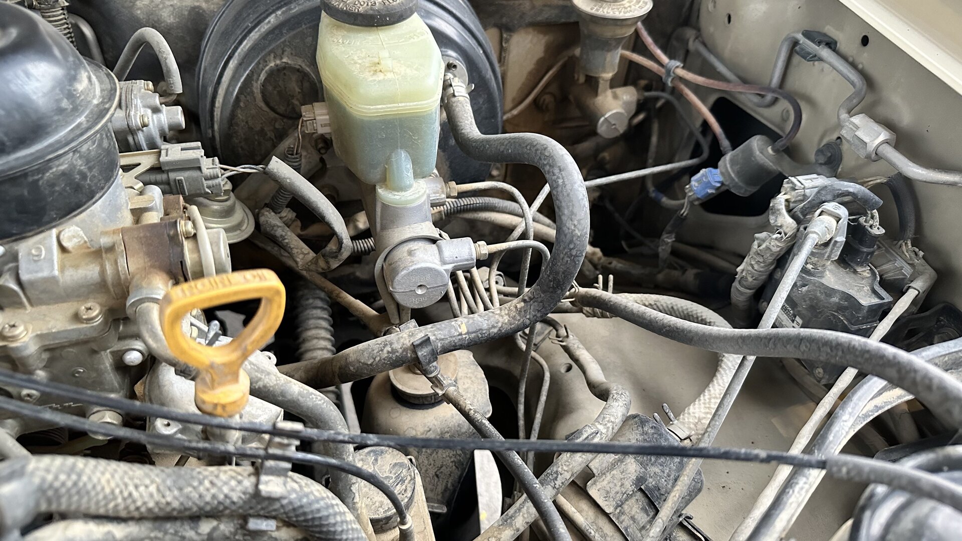

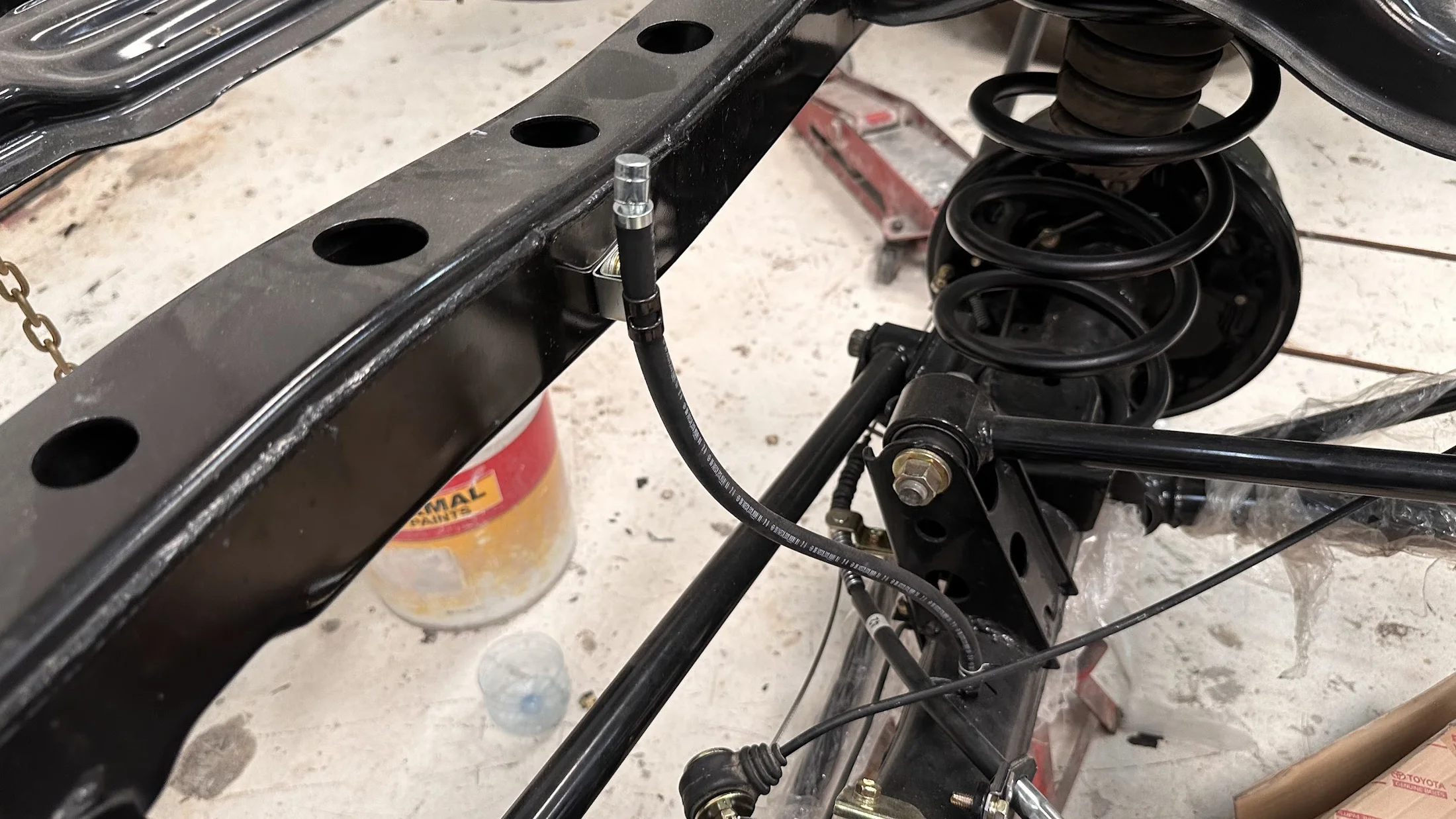

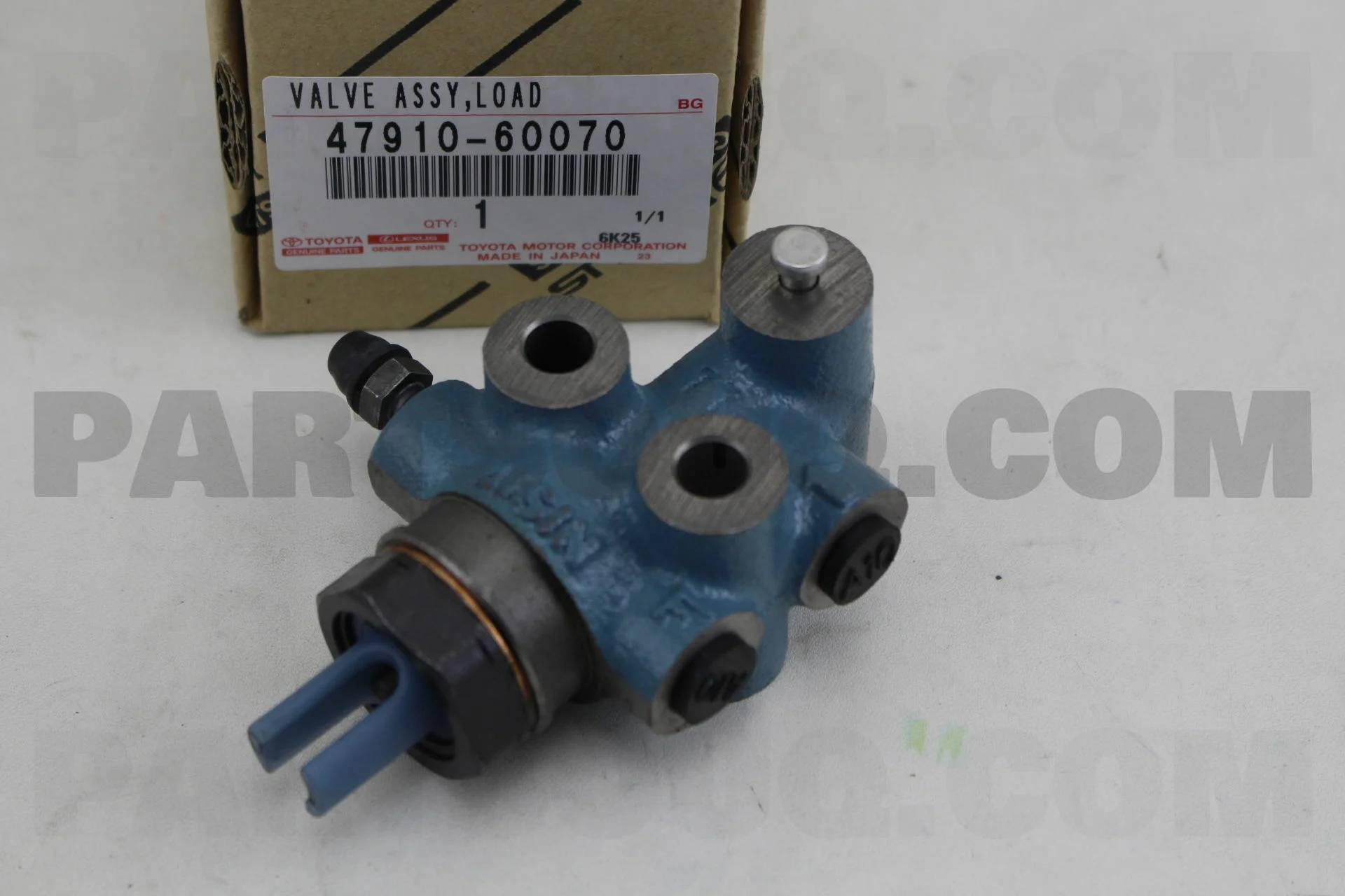

For the brake system, we replaced all components except the front disks, rear drum, and front calipers; but we replaced all components for the rear drum brake, the hand brake cable, the VALVE for LOAD SENSING PROPORTIONING, and more.
BRAKE PARTS
9094702612 hose brake, lh
9094702613 hose brake, rh
9094702a18 hose, brake, front
9094702933 hose, brake, rear
4791060090 valve assy, load sensing proportioning

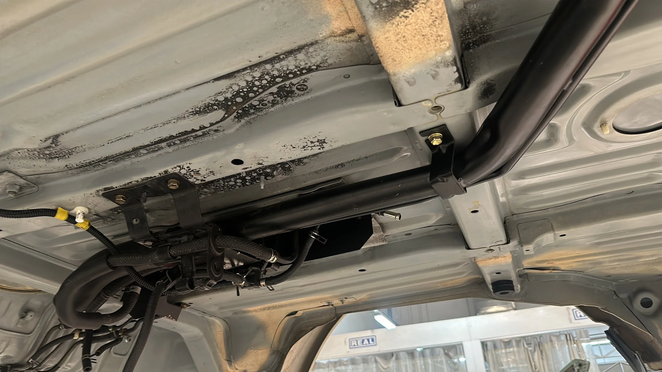

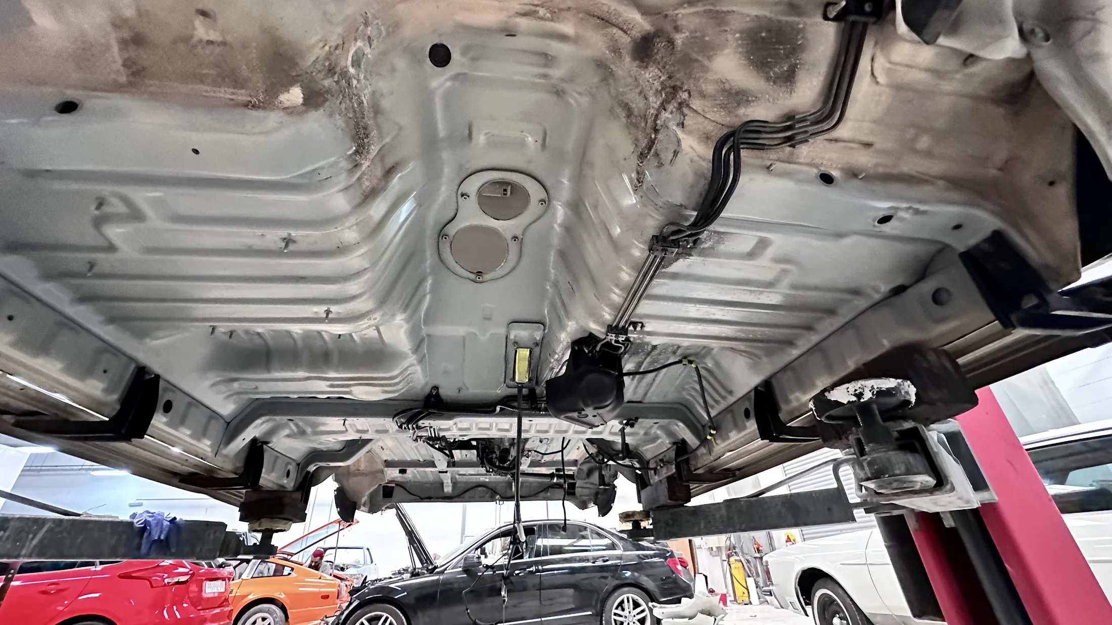

Additionally, while the mechanical team works on the chassis, the body shop team is cleaning the underside to restore it to its original condition. The main chemical that I found in my city is this powerful product:
