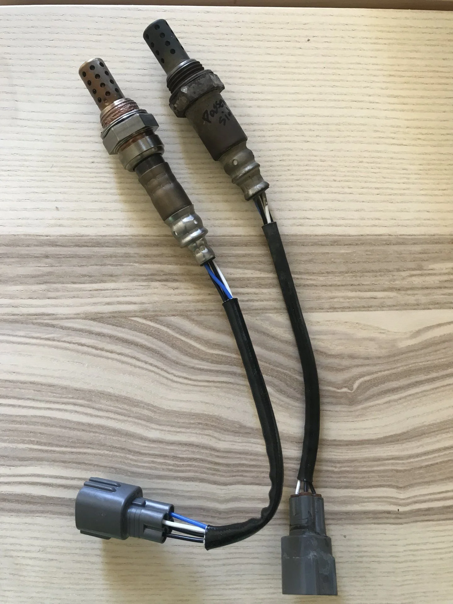

Pulled out the O2 sensors and this is their current condition:
Update on my upstream O2s (or AFs in other terms). I installed these new ones (damn these are expensive from the local toyota dealership cost me around $505 for both) and CEL went off immediately as soon as I started the engine.

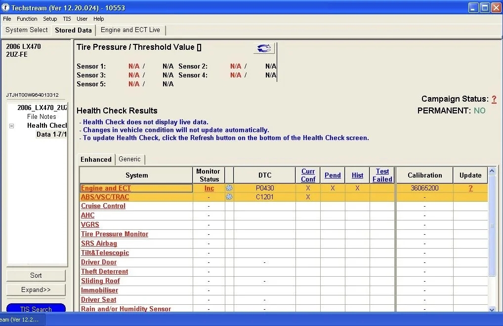

However it’s been 3 days now I am getting P0430. I am able to clear it using Techstream but it keeps on coming back every time I use the truck for short 20-30 miles errand trips.

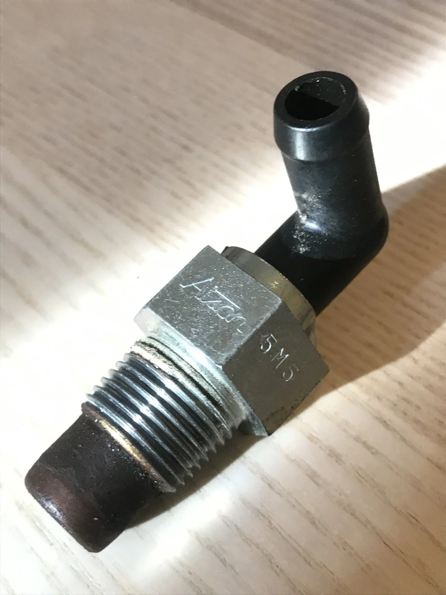

• checked PCV and discovered it’s not oem anymore

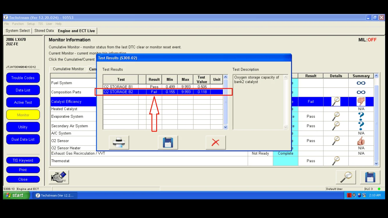

Update on my P0430 2006LX470:
I have the same issue for past 2-3 weeks now, here’s the list that I have performed so far:
P0430 error:
• cleaned MAF and Throttle: P0430 still
• replaced all 8 spark plugs with Denso Iridums: P0430 still
• sprayed battery cleaner: P0430 still
• replaced PCV valve OEM part # 12204-50030: P0430 still
• poured CATACLEAN on 1/4 remaining gas: P0430 still
• poured Berryman on 1/4 remaining gas: P0430 still
• replaced downstream O2 sensor Bank2 Denso 234-4260 (OE with plug): P0430 still
- replaced Fuel Pump Denso # 950-0210: P0430 still
- used downstream O2 sensor from Bank1 (known to be working): P0430 still
**gas cap recently replaced with OEM genuine gas cap
**added a condenser fan to help ventilate the AC system
What else am I missing gents?

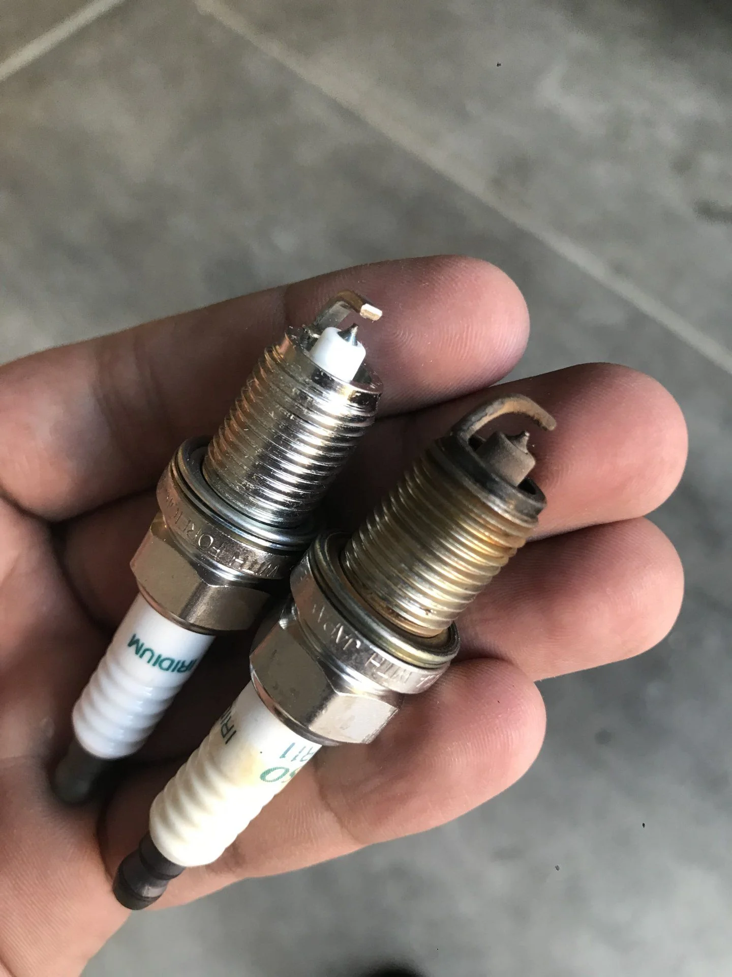

IDR, what is your year and miles?
@2001LC 2006LX with 235k miles
Good question @white_lx . Gap would be telling. If 235K miles on plug I'd bet over 1.2mm gap even 1.3mm.
