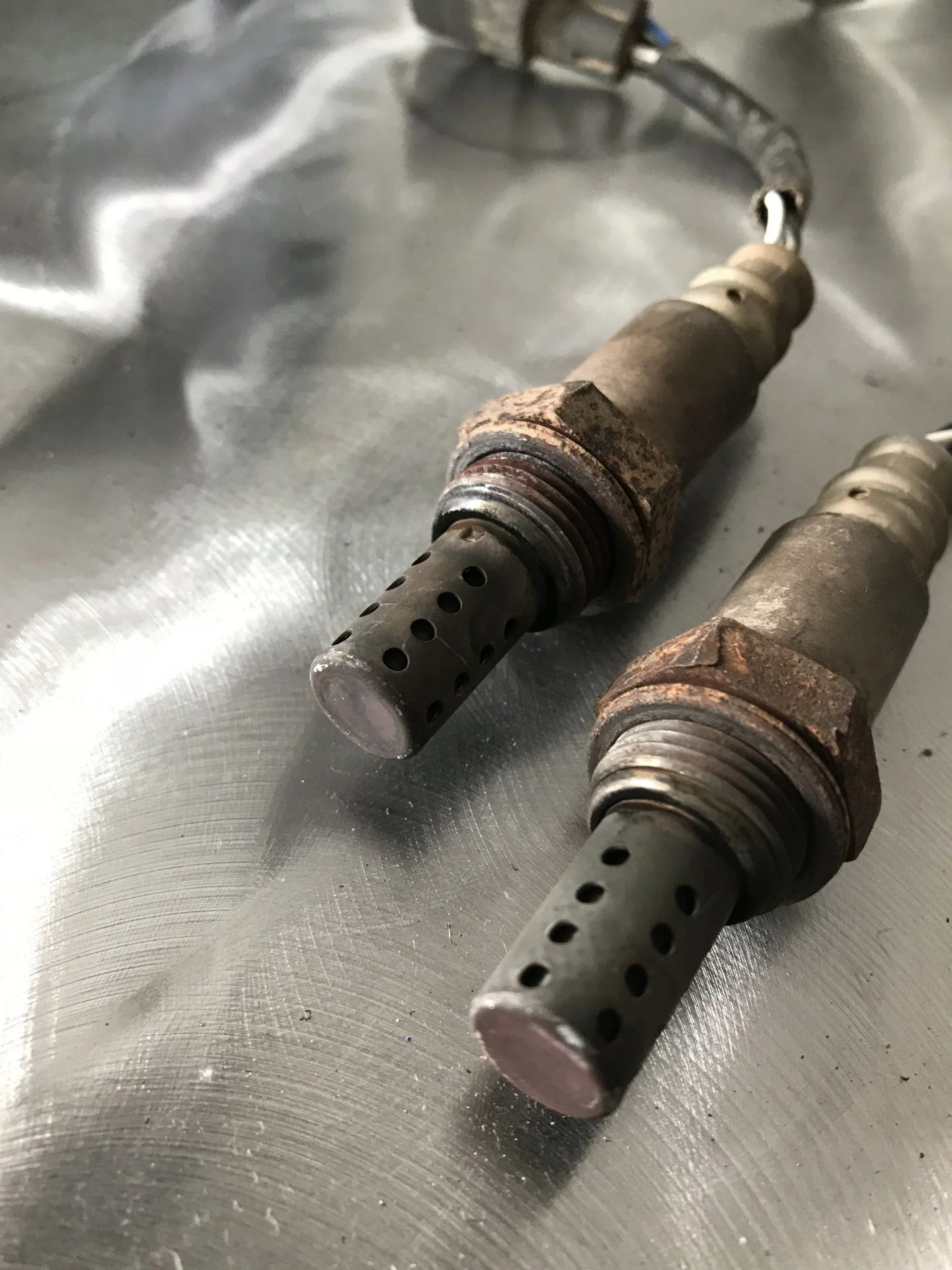

Here are pics of the old downstream O2 sensors.
5f33ee76-47f4-4d95-8b92-341a26659568-jpeg.1639409

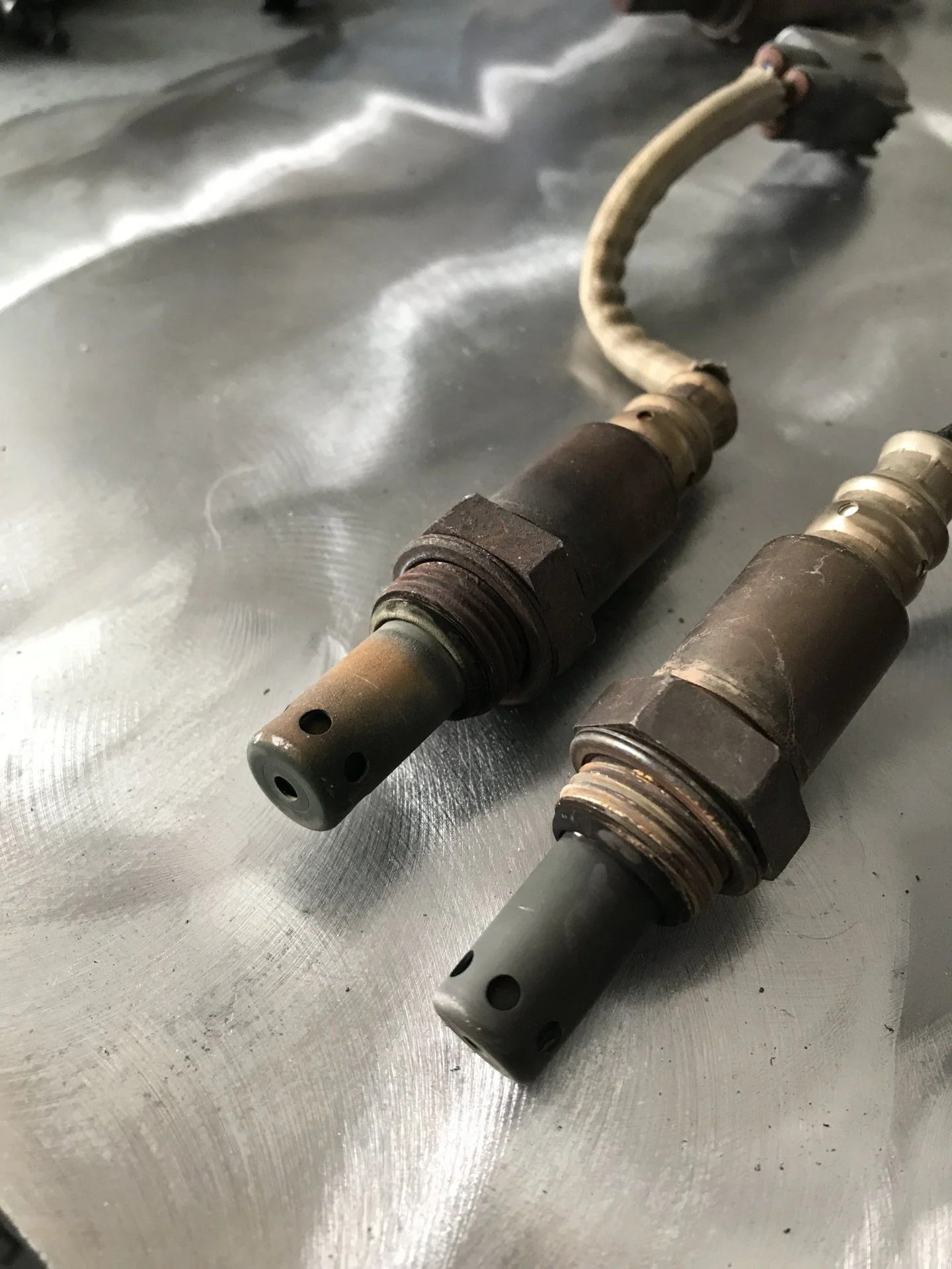

Here are the old upstream O2 sensors.
5b40bc72-a33a-48d7-9984-85be3a191a1f-jpeg.1639410
As you can see, the upstream were in better shape. Not sure if I needed to change them or not, but I did.
