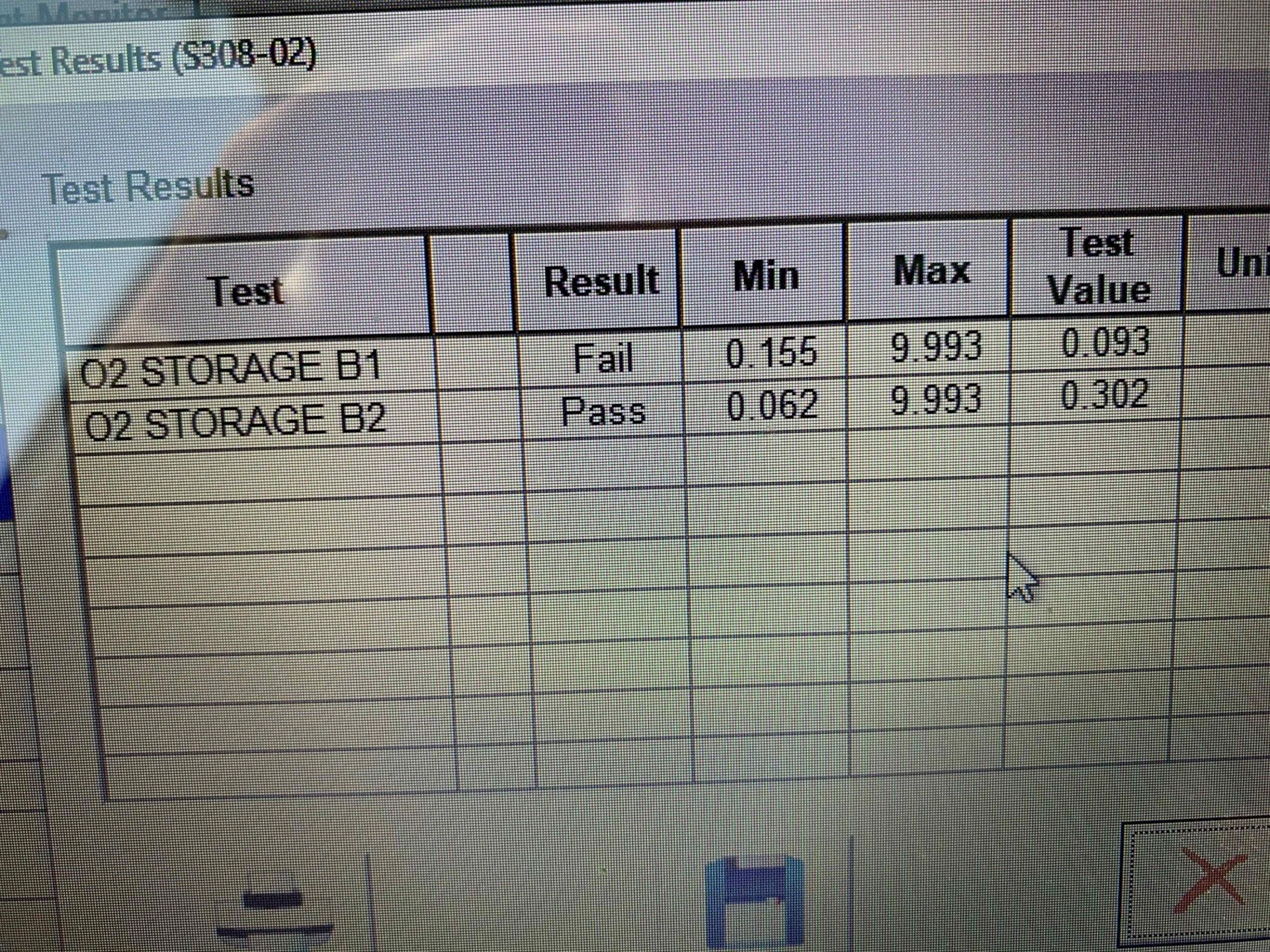

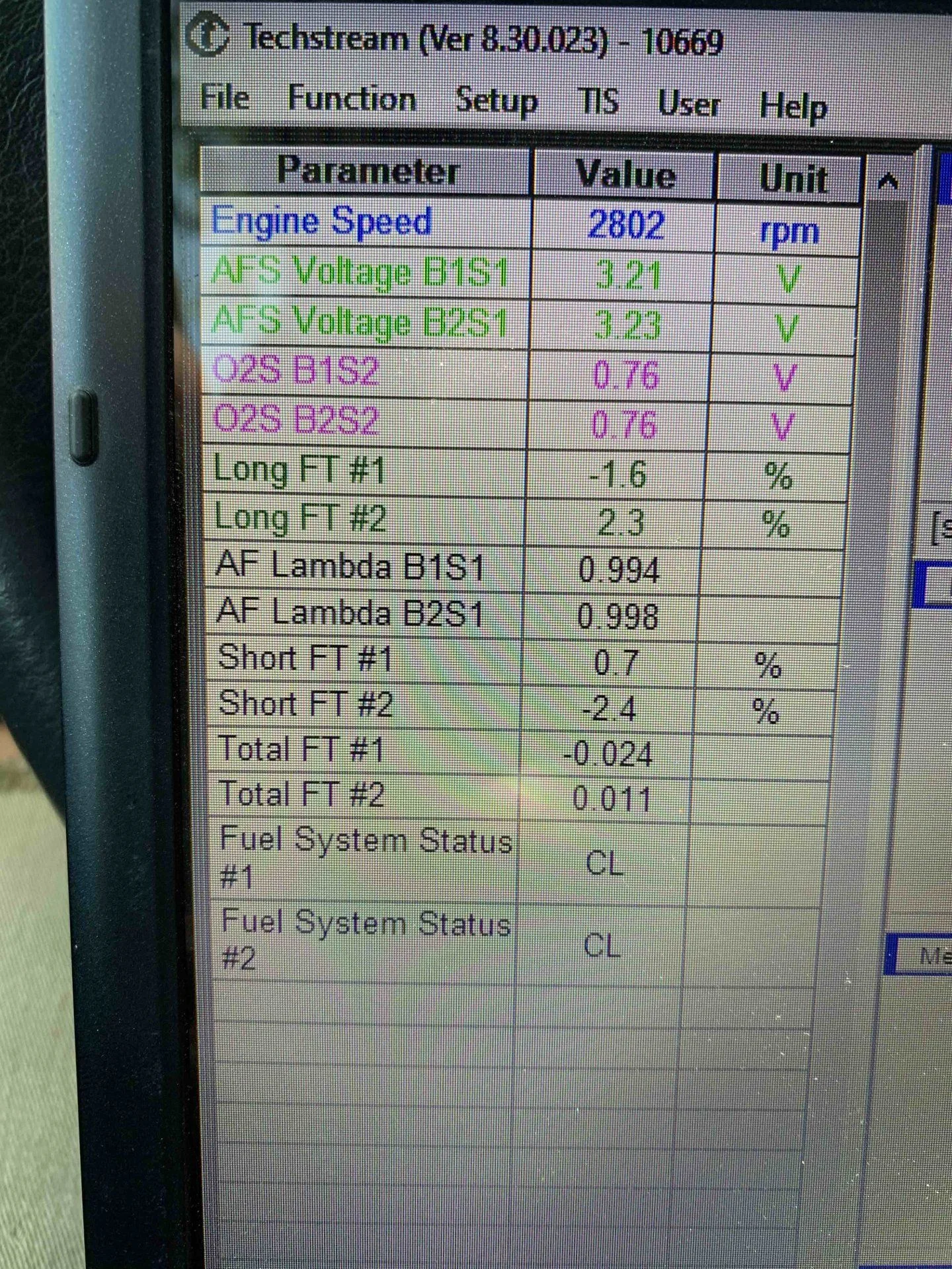

Borrowed a TechStream but way beyond my abilities, foreign language to me...Does anything jump right out? Still have a persistent PO420. All four sensors, new.

Looks like your fuel trims are good on both sides....should be close to 0 and at max negative or positive 8....but close to zero is great.
Your left post cat O2 sensor (bank 1) is indicating a lean condition at the sensor...hence the P0420. The voltage should be right in the middle...or close. Like .4 to .6. low voltage means lean (air is getting in there) and high voltage means a rich condition ( more fuel than air). Since your fuel trims look good, air is getting in somewhere after the intake (e.g. exhaust system).
Looks like your right side (bank 2) is ok...voltage is close to middle
It helps to see live stream of post cat sensors to see how they are behaving. If they hold steady then you know the cat should be okay...need to find the air leak.

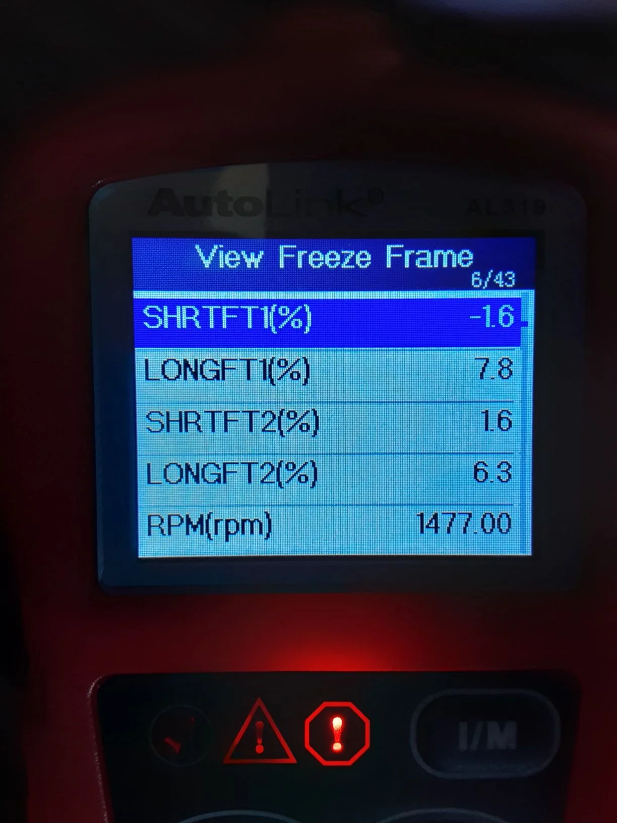

I keep getting a P0420. I clear the code and it returns the same day. Attached is some info i pulled my my cheap code reader. Something looks off. Anybody want to translate that into layman's terms for me?
Let me ask me ask; With what did you read the read the code (DTC) and any other codes now or in recent past?
Any other issues?
CAT can be difficult to diagnose. If a bad O2 or A/F sensor(s) you should get a DTC (code) indicating that. But not always. If CAT bad, you must find what the upstream issue is first. Than once upstream corrected, recheck CAT.
Unless you've tech stream and experienced at diagnosing. You'd be best off finding a 100 series specialist that understand how. Not just some corner shop.
