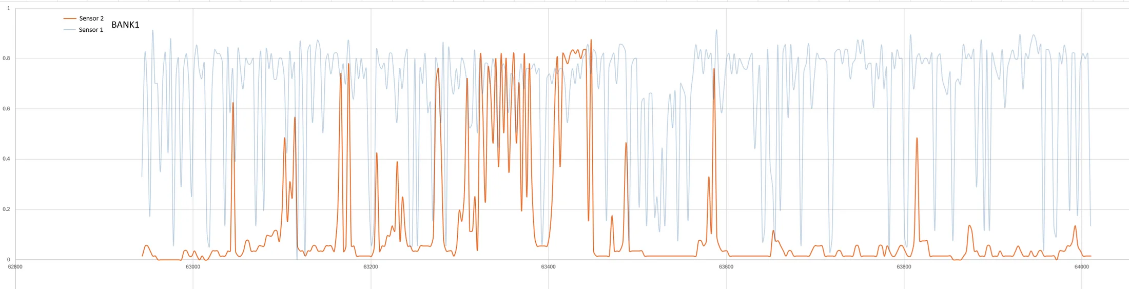

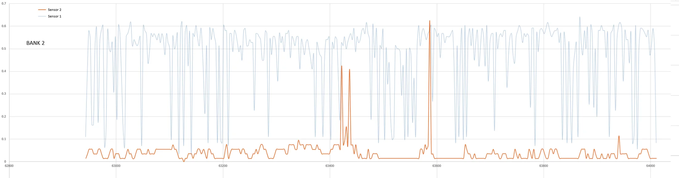

Jumping on this threadnaught just to get some perspective. I have a 2003 4.7 UZJ100 that has about 185K miles. I previously had a p0156 code and replaced that sensor and it went away. I then have had p0420 coming up sporadically. Just out of curiosity I bought an OBDII reader and started recording O2 sensors (both upstream and downstream). Did a 10 minute drive with car already heated and had the following results. Sensor 1 on both banks looks normal, but the Sensor 2 and bank 1 is definitely more noisy than bank 2. Also, for both, the average voltage seems pretty low compared to what I have seen with others on this thread. Could that be because of different year of car? How would you interpret both of these graphs.
Bank 1
Bank 2:

o2 don't go bad often, on their own. But happens, and usually just one. If two (Toyota Denso or Denso) go bad, something is more than likely taking them out, loading them up or it's the CAT. I always look to see if a reason, can be found. Such as mud on o2 and wiring. Even grease, mud, water, crud, etc. in wire housing. or something in how engine operation.
If CAT indeed bad. Again look for the why.
Prolong idling.
MAF sensor is a leading cause.
Bad compression.
Coolant leak into combustion chamber.
Exhaust leak before or at 02.
Vacuum leaks.
Engine coolant temp.

My understanding is that bank sensor 2 should generally be stable and flat. It looks like there are periods of lower than expected performance in Bank 1, spikes in Sensor 2 Bank 1, which would align with P0420 code? I am running into a similar issue on my truck as I try to get the readiness monitor for O2 sensor (last one) to go into ready mode.
