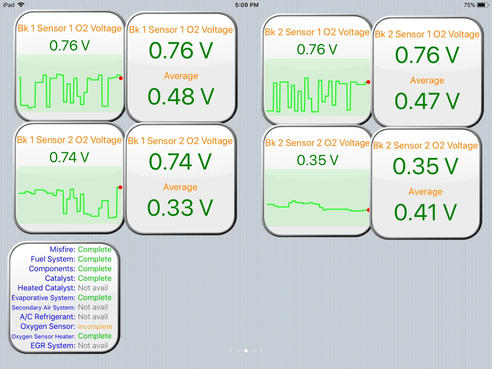

I just ordered O2 sensors. My obd2 reader said the issue was with bank 1. Do these voltage readings reflect that?
SICARIO: Is your truck having P0420 code? B1S2 should have flat voltage as like B2S2. The issue could come from bad downstream O2 sensor. In order to check it, you can install PS's O2 sensor to DS's one. If it still shows the P0420, the issue would be DS catalytic converter or some leak on DS' exhaust pipe. I'm having the similar issue(P0430), PS catalytic converter efficiency. I swapped downstream O2 sensors, but still having the same P0430 code. I tried to check any leak on exhaust pipe, but it is difficult to find any leak. So, I am planning to swap catalytic converters between PS and DS to confirm the issue from PS catalytic converter.
It is the P0420 code. I believe I had a 430 as well, but I haven't seen that come back in a few weeks.

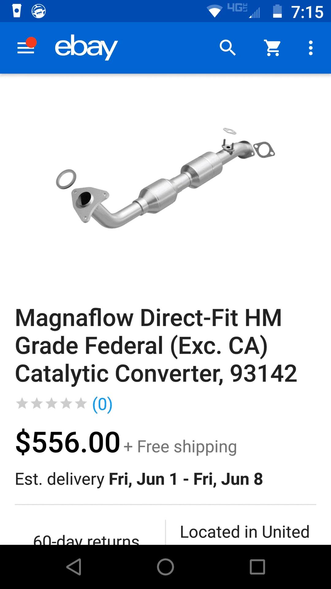

So two weeks after installing the new cats (see above ebay photo) there have been NO check engine lights. For a total of $800 ($275 apiece for the direct fit cats and 150 labor) my problem is fixed.
If you go this route, make sure that you fix any "Upstream" problems first or they will eventually overwhelm your new cats again. For me this was a overlooked and clogged PCV valve and what looked to be the original spark plugs (200,000 miles on them probably), new air filter.
Did you replace any of the O2's?
I had both 420 & 430 codes so I replaced both sensors on the driver's side (bank 1), they all looked like they had already been replaced by the PO, but regardless I did it anyway and, no change. The 02 sensor route should always be tried first (at least on one side) to see if any change occurs.
It is an awesome vehicle and for $800.00 I went for the jugular of repairs and got it done right!
